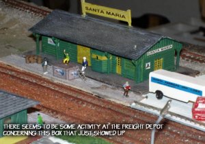

Here are a few more shots taken around town. There seems to be some confusion about some freight that was just dropped off.

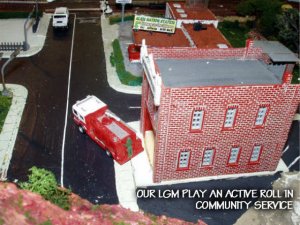

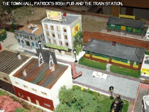

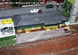

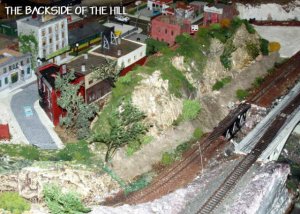

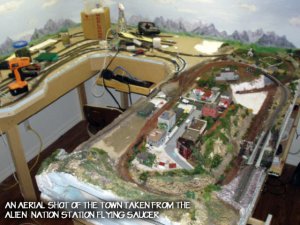

Overall, I like with the way things came out. What I’m most pleased with is the red rocks on Sedona Mountain. If you’ve ever been to Sedona you might agree that I got reasonably close to the color and look of some of the formations there, well, as best I could at 1:160 scale. What I don’t like mostly is the way the cobblestone and wooden sidewalks down Main St. turned out. I tried to replicate an old western street. I guess I can always pave over it with blacktop or concrete if I get to upset with it.
If anyone’s interested, here are a few things I did during the construction of the town:
  • The street curbing is .030 styrene glued in place.
  • The sidewalks are cut from two layers of cardboard that were painted and the lines and cracks were added with a pencil. Joint compound was used to pave the sloping driveways.
  • Both train platforms are made from strips of balsa wood glued together and distresses with a wire brush, then weathered with acrylic paint and an ink wash.
  • The trimmed bushes in front of the gas station and train depot were made from green Scotch Pads soaked in diluted white glue and dipped in W/S light turf.
  • The cobblestone street and wooden sidewalks were printed on my computer.
  • The mountain is made from strips of blue foam covered in paper towels soaked in plaster, then detailed using joint compound and a putty knife. The rock spires are simply balsa wood strips pushed into holes punched in the plaster, then covered with the joint compound.
  • The weed grass on the backside of the hill is some furry cloth that I found at the Wal-Mart fabric dept. I tried some of Harold’s Faux Fur, but it doesn’t look right at N scale.
  • My friend and fellow Gauger Jim Currie made the tree in the Train Park and the one behind the gas station. I am delighted to have them on my layout.
  • All of the businesses in Santa Maria except the hotel are named after family members. The hotel and the town itself are named for a very special lady that we hold in high regard.
  • And for those of you that asked, I got the town hall building to float off the ground by placing it on a cylinder of clear acetate; the same with the flying saucer floating over the gas station.
The easiest thing I did was making the mountain. That’s an art form in itself and a lot of fun. The hardest was getting the color mixed right for the red rocks.
The thing I liked doing the least was building the Bar Mills snack stand. I love working in N scale, but at 1” x 1” x 1”, that really was a bit difficult. The thing I enjoyed doing the most was finding suitable homes for all those LGM and their life partners, those LGGs (Little Green Girls).

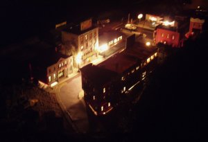

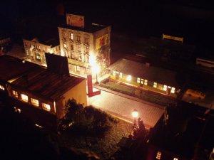

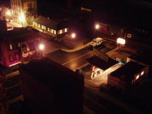

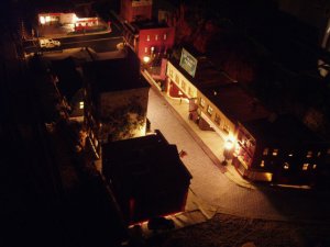

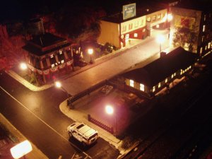

We took a spin around the town at night in the "Newshawk12" telecopter borrowed from our non-operational local TV station. Seems like they went out and bought a helicopter, but forgot to apply for the broadcast license. :rolleyes: :rolleyes:
Anyway, here are a few shots we took on the tour. The Feds have bought off the whole project with the exception of the Main St. paving and sidewalk. They are insisting we take out the cobblestone and replace it with brick and redo the sidwalk in real wood this time.:eek: We will keep you posted on this project, but the pressure is off for now since we now have power to all the buildings. If you note, we did opt for underground utilities at the insistance of the Feds.:D :D

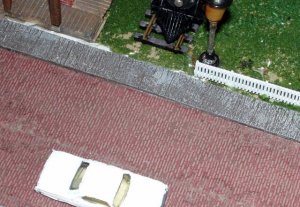

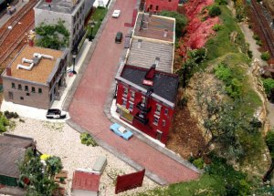

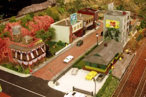

OK, I finally got the "texture" that I was looking for on Main St. I couldn't find what I was looking for at the LHS, I'd even have taken HO brick for my street paving, but had to settle for some "N scale, 1/200" brick that I bought a few years ago. They were very difficult to work with since the "bricks" were so small they did not dry-brush well, but at least you can tell there's some texture to it and is not flat-looking like the cobblestone. I also replaced the printed sidewalks with .032" balsa wood. I distressed it with a wire brush and some really course sandpaper, and "aged" it with acrylics and an ink wash. Using balsa allowed me to turn the corner and go to the end of the street instead of stopping before the corner. Fortunately, I was able to build the street up on the bench and just glued and dropped it in place when it was ready. I amazed myself that it fit the space as well as it did. :rolleyes: :D :rolleyes: :D
