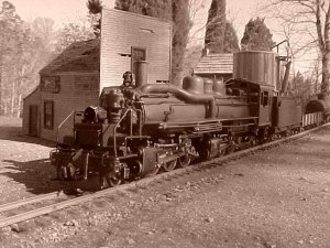

yah the Greensboro club had a small HOn3 part but it was in bad shape and would not run. when they took down the old layout they said never again with narrow gauge. and the Winston Salem SouthBound club is HO only. I know there are a few of us Narrow Minded Rail Heads around here but they seem to be in hideing. As of now i have 5 working HOn3 engines and this little guy and i have the Sumter Valley engine on the way here in the mail. when i get it i am going to add a new tender and another cab to it to make the ET&WNC 2-6-6-2.
well guys I got the Sumpter Valley 2-6-6-2 today in the mail. spent the last couple hours working on getting her to run good. as when i got her she would not run at all. now some 2 hours later running good but need a new Pony truck as this one is damaged bad.
well here is the first pic of her.
