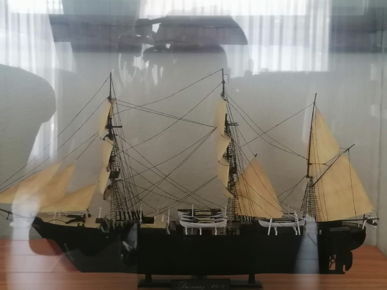

England Expects...

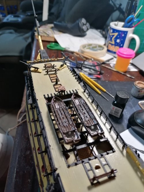

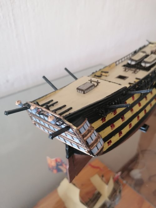

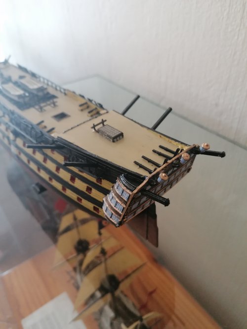

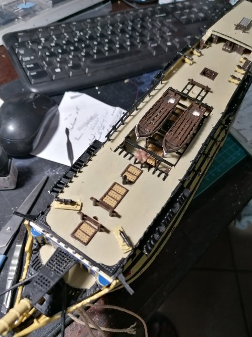

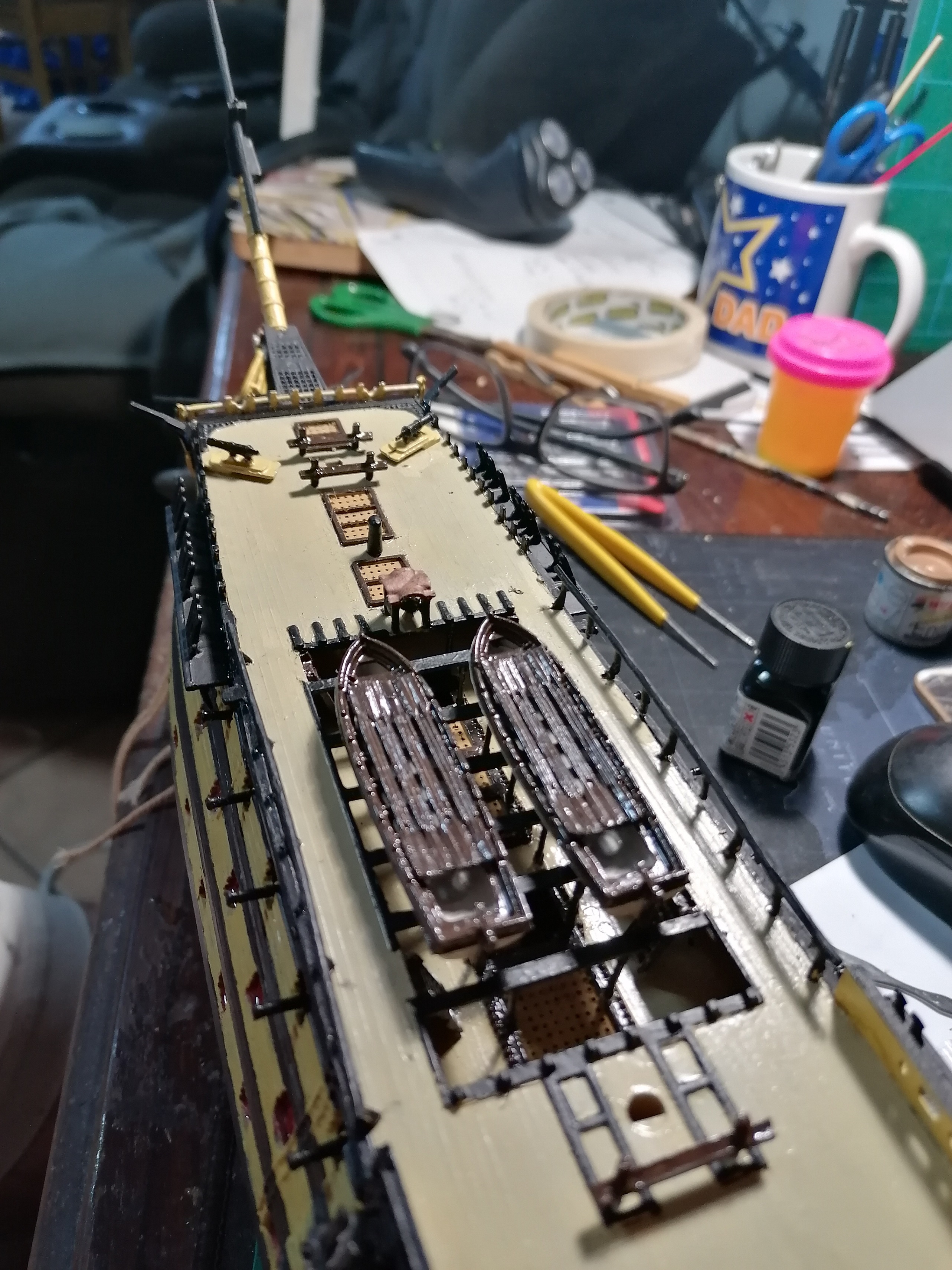

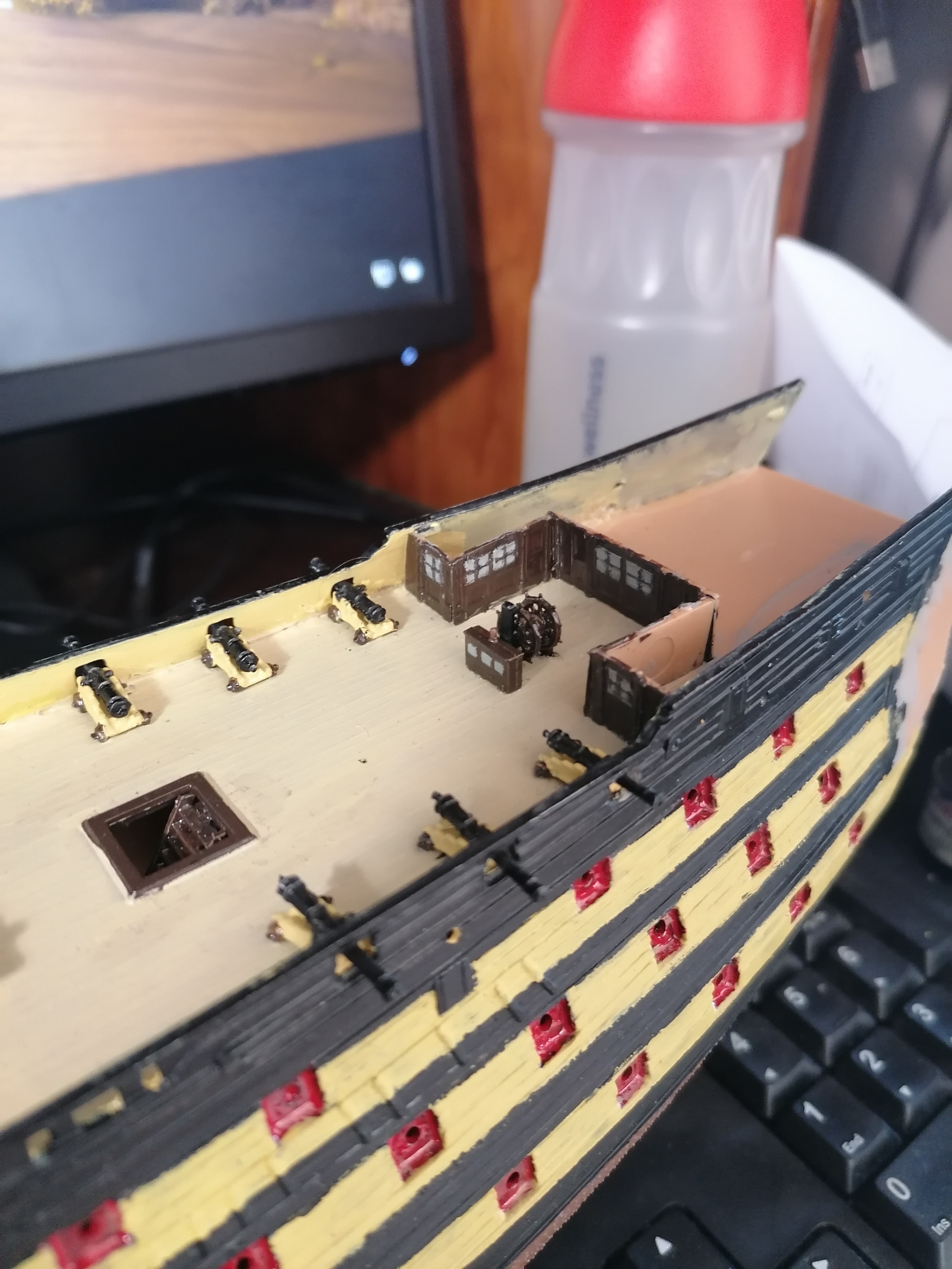

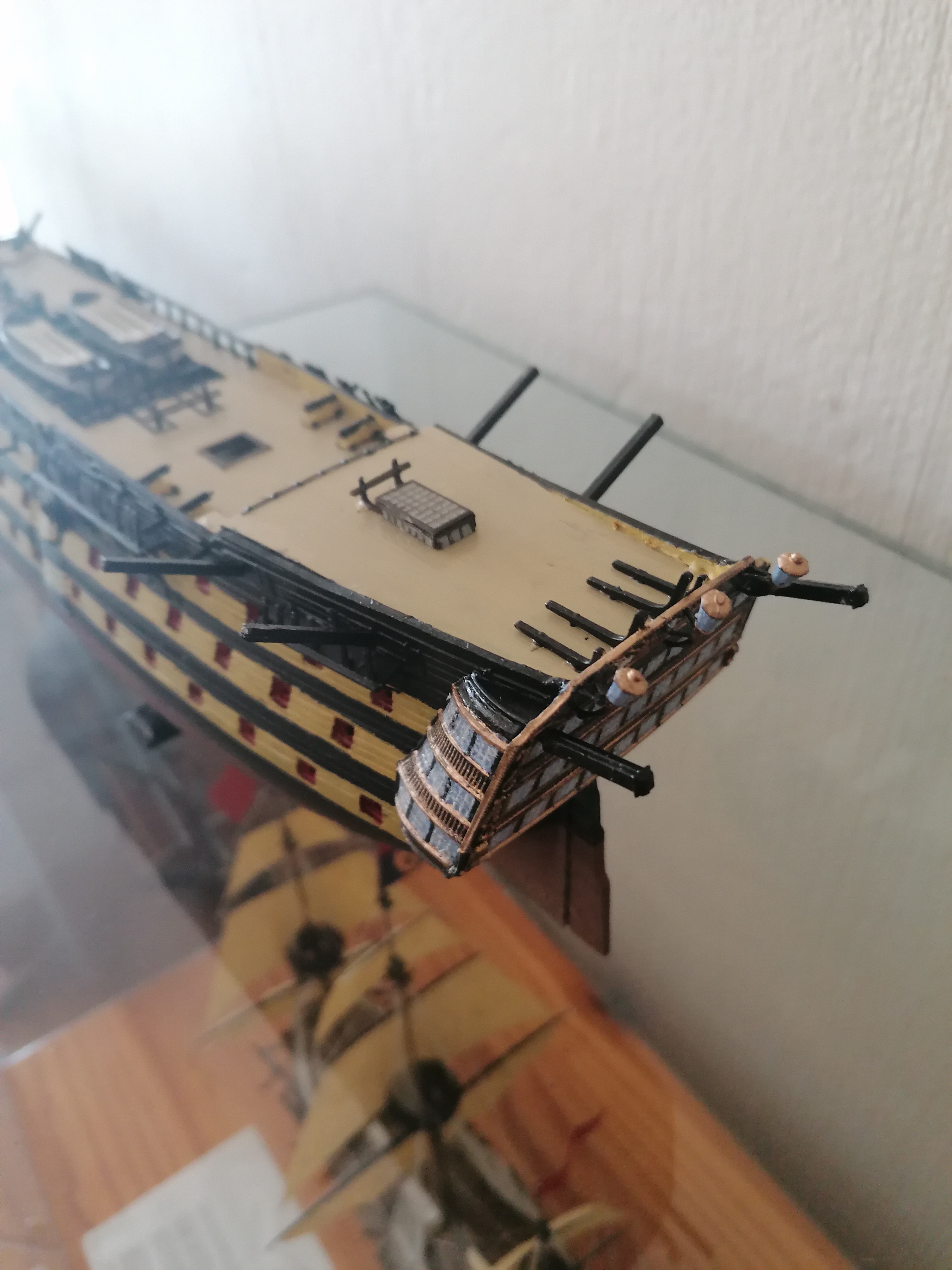

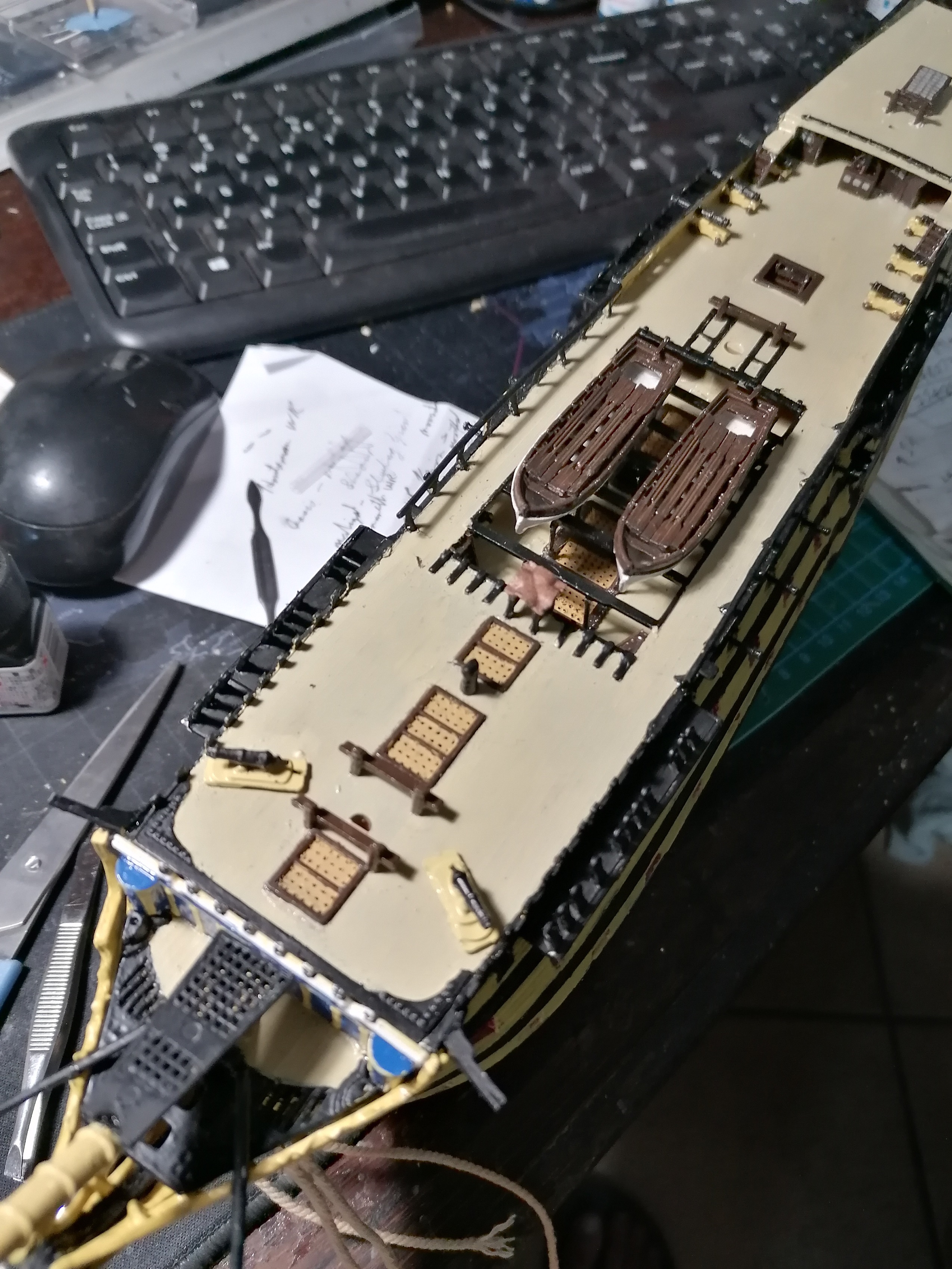

Now the for'ard and midships parts of the deck complete, deadeyes attached (you can see the poop deck attached. Stop sniggering @Chuffy!)
I would paint the oars on the life boats an "off white". that would make them pop out, and they were usually the color anyways. :)

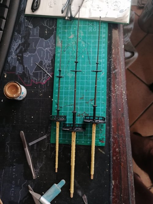

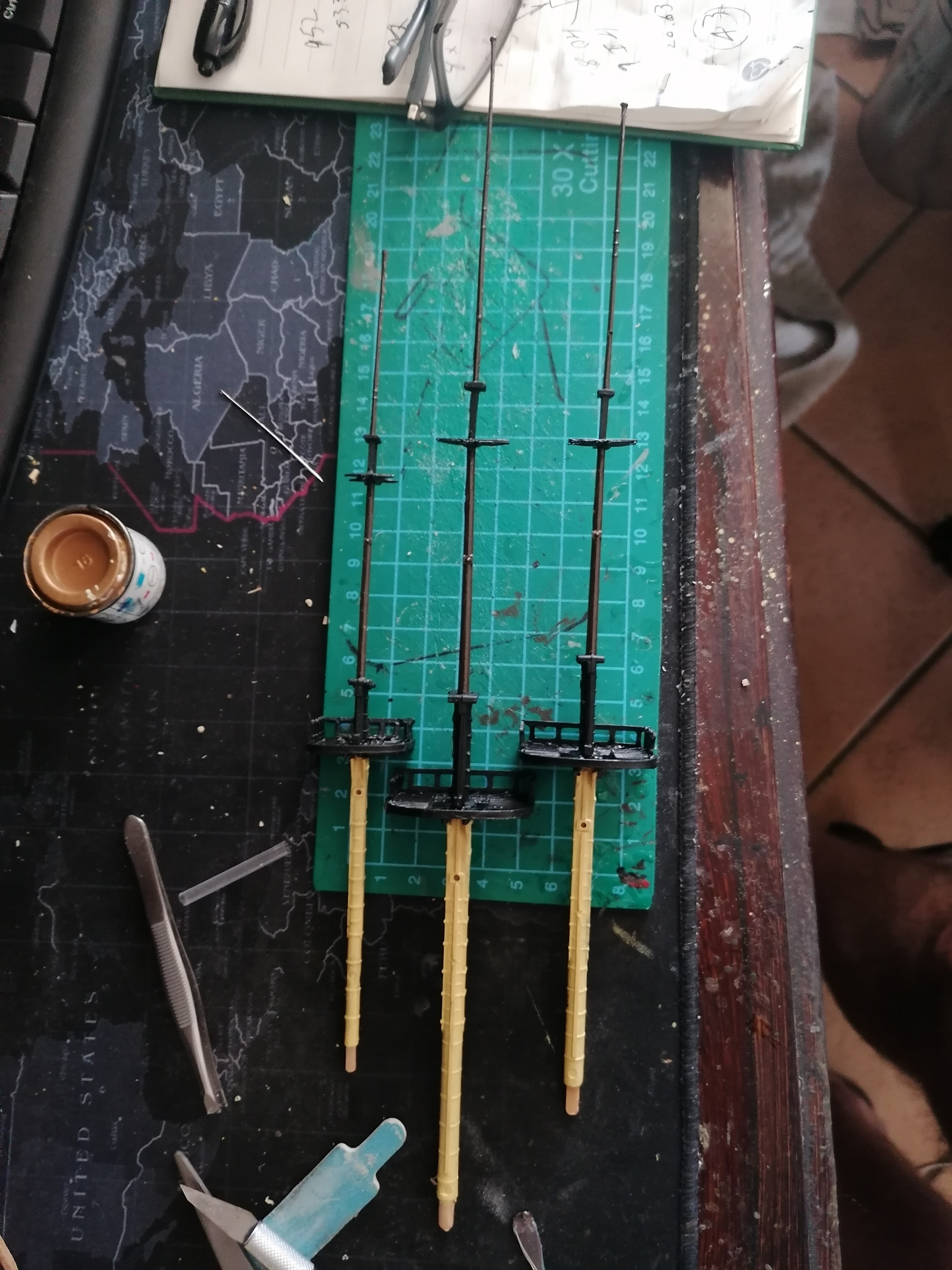

So here we go, masts assembled
Now I'm going to deviate from the instructions which call for the yardarms to be attached now. Since I'm doing cloth sails they need to be stitched to the yard before attachement. I think I may do the standing rigging I can before this step.

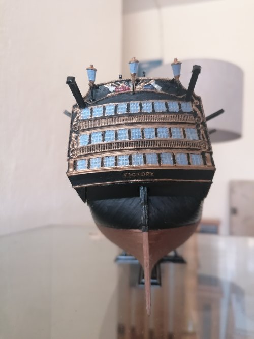

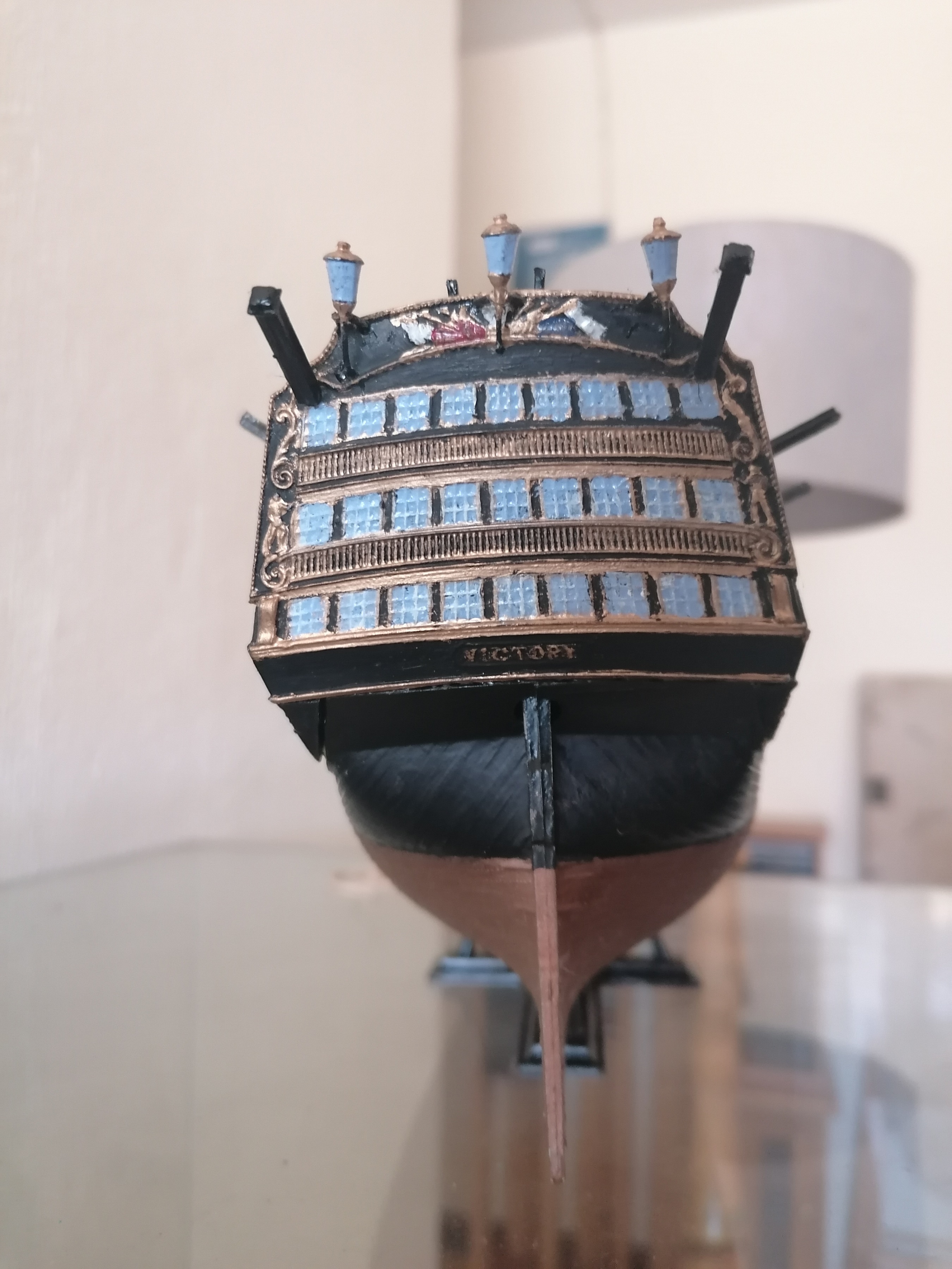

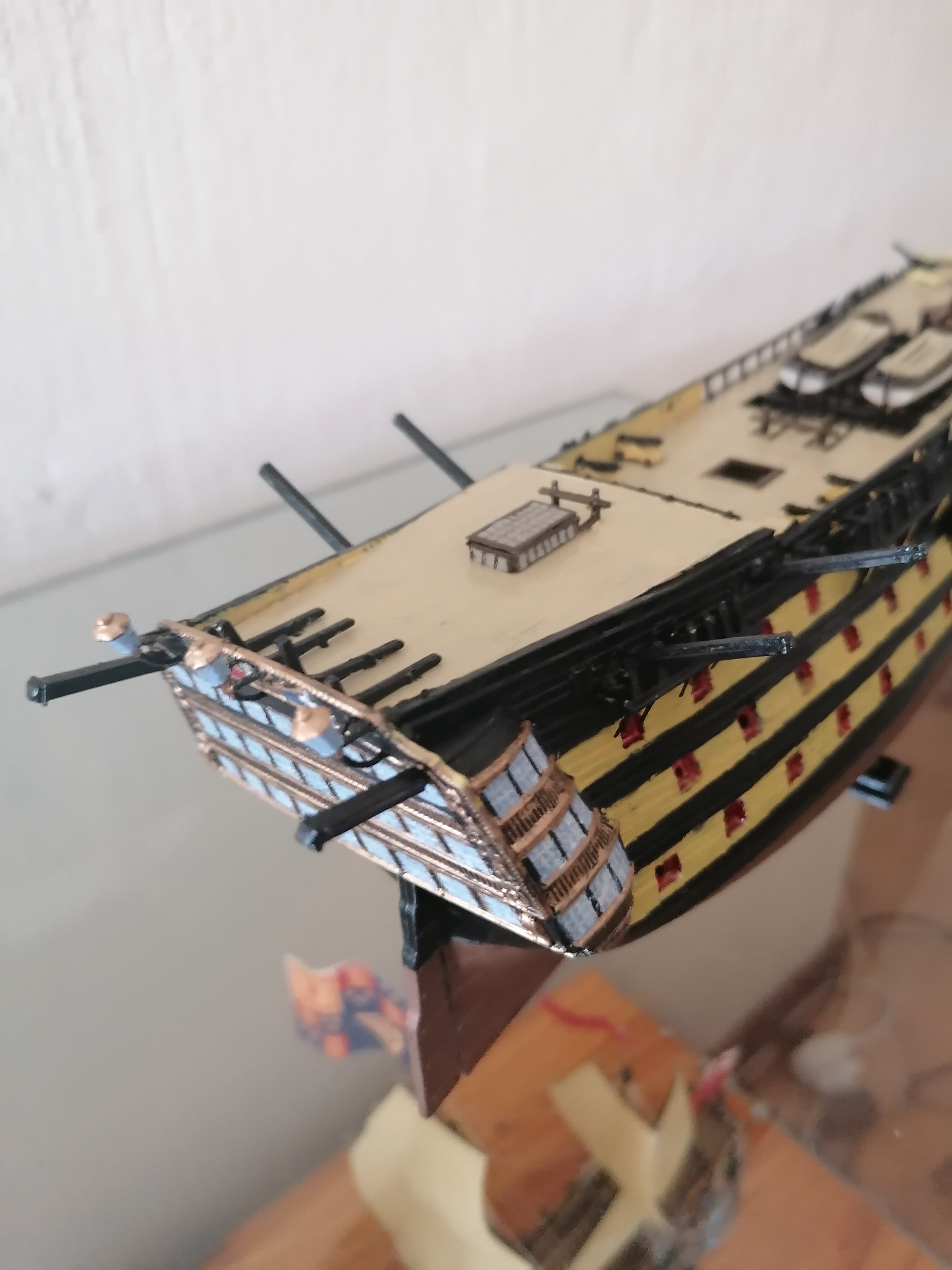

If you're curious about the stern, I'm not completely happy with the paint job on the transom/windows.
Now the stern is complete!

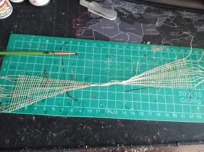

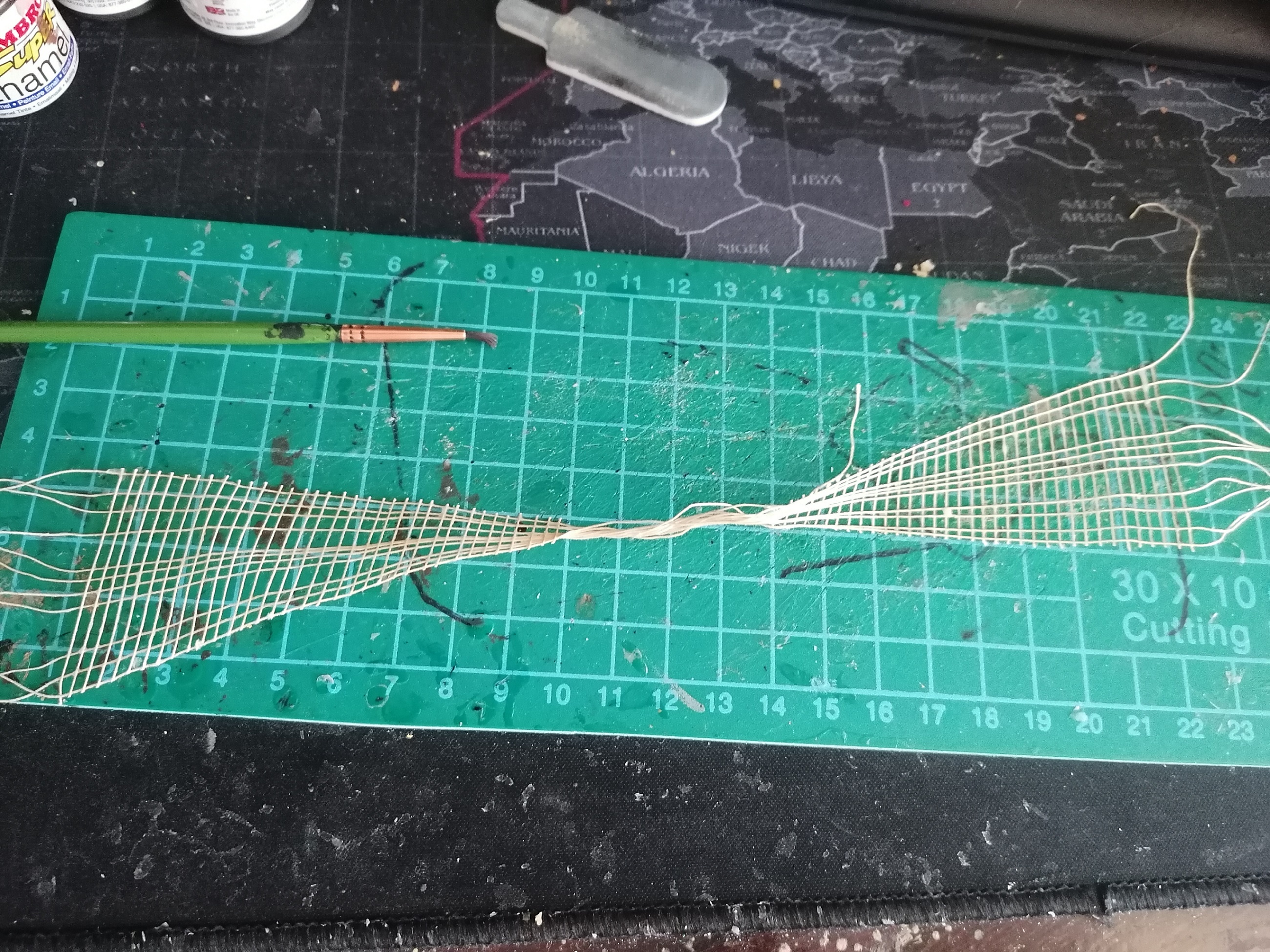

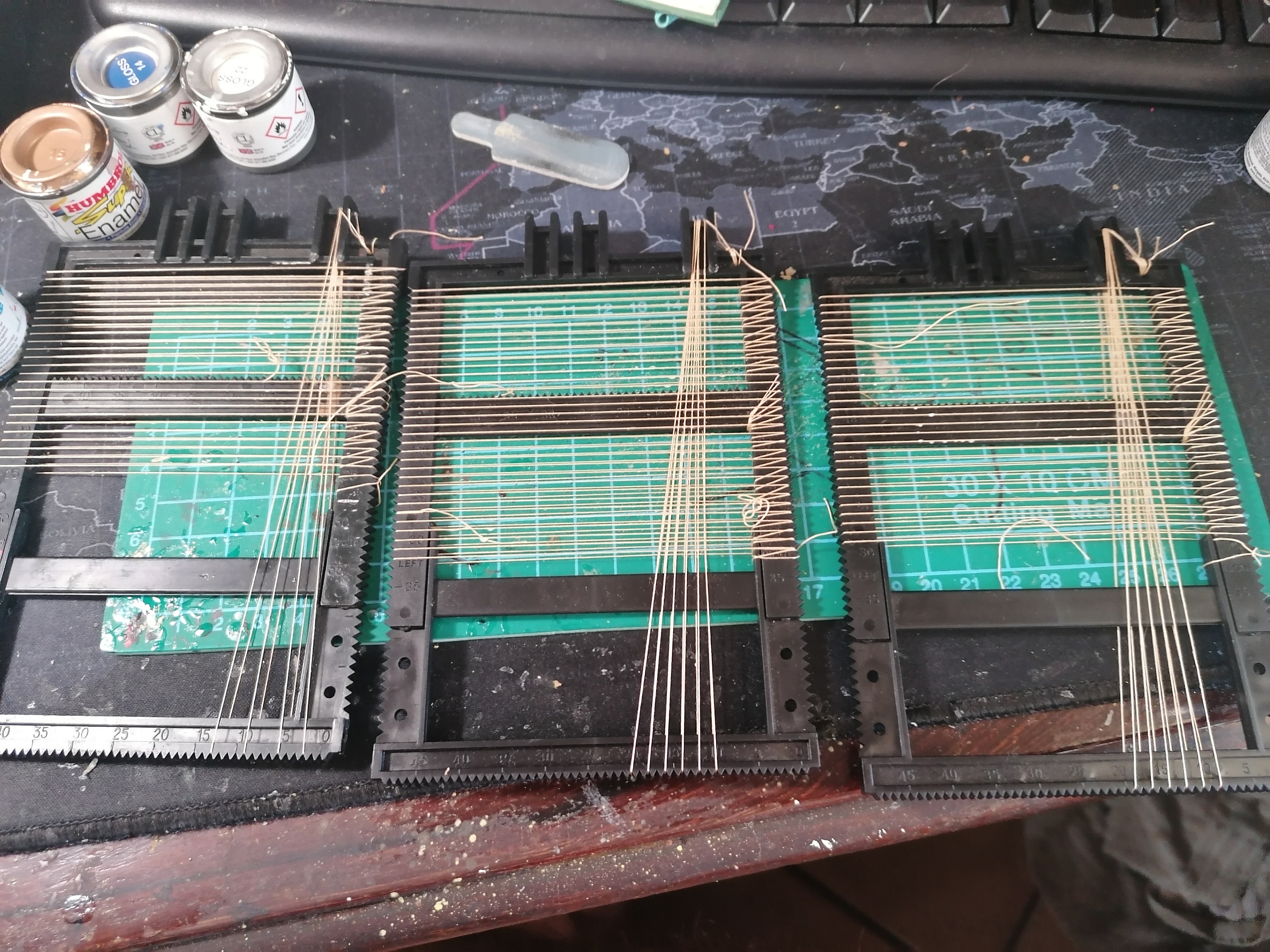

Moving onto the rigging, first the upper shrouds

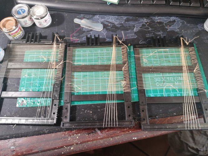

Airfix provide these lovely jigs, as you see I have 3 (from the Victory, Wasa and an old one). The instructions give you the guide which notches to use, and ta-da. I then use wood glue, liberally spread over where the vertical overlaps the horizontal
All you do is then snip the strings and end up something like with this (a tester from earlier)
Any guesses on how I coloured the string?
