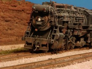

Thanks Nutbar, This photo is for all the plumbing fans out there. This model came with all this detail, none was added. It is a NYC H10a mikado. Paint by Blake Tatar.

I was sure, that Alco's A1 was first Super Power engine that was equipped first time with a 2axle trailing truck supperting an extra large firebox. The NYC H10a a Super Power engine? I know the story of train test with the new Alco A1 and a parellel running freight train hauled by a NYC H10a. I think in result of this test the term "Super power" engine was connected to this new loco type with the 2axle trailing trucks and the larger fireboxes. First time engines didn't running out of steam!
Or was is my mistake?
Bernhard
Bernhard, you are correct: the H-10 was an attempt to utilize many of the improvements that were later used to create true Super Power. The first H-10, No. 8000, was built by Lima for the Michigan Central subsidiary of the NYC, in 1922. Compared to a similarly sized H-7e Mikado, the 8000 produced 15 to 28 percent greater drawbar horsepower at all speeds above 15mph, while consuming the same amount of coal and less water. The firebox of the H-10, while the same length as that of the H-7e, was wider and the H-10 used the more efficient type E superheater. Not only was the type E more efficient, it allowed a rearrangement of the flues which increased the net gas area of the boiler. The increased grate area and net gas area taken together accounted for 10% of the performance difference. The H-10's boiler pressure was 210 psi, 10 psi higher than that of the H-7e, and this increased pressure, along with the more efficient superheater, contributed another 6% increase in power. No. 8000 was also equipped with an Elesco fwh, which accounted for another 8% of the performance difference. Finally, there was a gain in performance of about 2% by using superheated steam to run the appliances, like the stoker, generator, and air pumps. All of these improvements could have been added to almost any reasonably modern locomotive of the era.
Another important feature of the 8000, although it didn't increase horsepower, was the use of a booster on the trailing truck. The use of the booster at low speeds allowed a 2-8-2 to have the starting tractive effort of a 2-10-0 by using excess steam not required by the cylinders at that speed.
In 1924, Lima built, on speculation, the A-1 demonstrator, and in early 1925 it ran in a series of tests through the Berkshire Hills of NYC subsidiary Boston & Albany. The A-1 bettered the drawbar horsepower of an H-10 by 26 to 30% at all speeds, and, as a result, the B&A ordered 55 copies, dubbing them Berkshires. All of this information is taken from the May and June 2000 issues of Trains Magazine.

hi all---gary,that h10a is a beaut---makes the cn locomotives almost look naked---hey doc,aren't you glad i don't model the NYC and i didn't ask you to build one of those(although i bet you could)---thanks to all the contributors,especially our international friends(even though the swiss did beat canada's hockey team at the olympics)---hope to hear from everyone again---long live steam,cn nutbar
