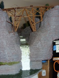

I have done some blending, stuffing tiny pieces of wet paper towel in the cracks between the foam scenery and the layout proper.
after that I added some ground foam, and some ballast to make my primitive road all though I haven't secured all of the ground cover yet, I like the result so far I took two photos from odd angles, where a camera can be held, but your head can't reach.
one shows the back side of the church, and the track going down to the Gizzard-Terrapin tunnel. since you can't see the layout at this angle , you can see spots in the rocks, where I missed crevices when I painted the rocks.
the other odd angle photo I got by holding the camera up above the benchwork for Gegokayoosa (the 5th level- where the benchwork is a shelf, hanging off the sloped ceiling.) It shows a view showing Sander's gorge, and then the Gizzard in the background.
I'm not done with this scene, but this whole exercise was an experiment with foam scenery, to answer the question, can I build with foam scenery and get results approximating the quality I get from carving plaster. I'm believing that the answer will be yes.
while the foam strata is a little blocky, and less detailed in places than what I do with plaster, I was working quickly. with some more practice and different tools, I'm thinking this foam stuff has real potential.
another photo shows the joint, on the left is the plaster, on the right is the foam, and a little lichen is stuffed in the crack to hide it, This is going to work!

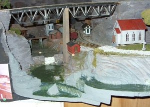

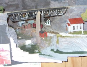

I think I've carved all the foam I'm going to, so this is the extent of the new land form.
I have to make a run by hobby lobby, I'm, out of the gray I using for my starting point for the rocks (Payne's gray), and also for the green that is the starting point for the water. it will be easy to correct the cocks, while the water I'll have to mix some of the correct color green in with the acrylic gloss medium. I do that anyway, as it helps create the illusion of depth.
The steel bridge in the background is begging to be removed and get a better paint job. The bridgedeck would be a candidate for repacement as I've gotten much better at bridge decks over the years. I hesitate though, as there is a vicious micro S curve at the right hand side of the bridge that used to cause a lot of trouble, and I'm afraid to touch it, as I forgot what I did to minimize the problems I used to have, but whatever it was it took me many tries.

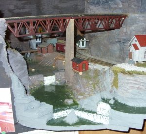

fixing the bridge

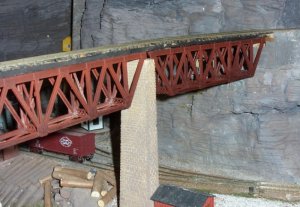

When I had built the bridge in the gizzard that shows here (there are four others (two of them narrow gauge). the bridges were silver. I decided that wasn't right, and attempted to hand paint the spans black, but missed a few spots, that I could never see when I had a paint brush in my hand, but could see all the rest of the time.
This afternoon I went up with an exacto knife, and carefully separated the spans from the bridge deck, and shot the trusses with my auto body primer and flat black mix. I stuck them back in place, but with much less glue, so I can take them out if, for instance I want to get rid of the shine they have in the photos. that doesn't show in room light, but some dullcoat might help it behind the flash.
I'm getting there, the new creek water just needs to get about another 30 coats of acrylic gloss medium, so that it reflects like the rest of the creeks in the Gizzard.

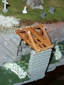

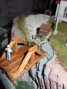

I got some work done on the road bridge. The glue on it is drying until it is strong enough to drill for the tension rods, and NBW castings. After those ore in I can touch up the stain on the cut ends of the timbers, and add decking. I will probably trim some off the foam rocks and re paint them to get the area where the bridge fits in there to look a little better.
a litle more work
I did a little more work on the road bridge, adding a deck and touching up the stain on the cut ends. I also subtracted some foam from underneath the bridge, on the cliff, to try to make that a little more natural.
In this Photo Ronnie Jones inspects the new bridge, before he tries to cross it with his model T. If he declines to drive over the bridge, the only other way to get that little truck out of the Gizzard is on a flatcar.

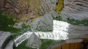

Got acrylic modeling compoud.
I Got acrylic modeling compound! I have some @ the club, but I keep getting so wound up with the subroadbed for the sawmill area that I keep forgetting to bring it home. I was at Hobby Lobby the other day getting some picture frames and getting one of my dad's large photos of monument valley matted and framed, so I picked up some acrylic modeling compound. this lets me add some texture to my new waterfalls, and I can use it to build up the last 25 feet of Sanders's falls, so that the falls reaches the new scenery extension. it still will need some fine layers to improve the texture, as well as some gloss with tints and hint's of green and blur to get it right, but it is a start.
Bill Nelson
That's what I like about the acrylic technique. You can keep playing with it and tweaking it over and over. it takes a long time, but I think the results are incomparable.

Acrylic modeling compound.
The stuff is called acrylic modeling compound, and you find it at the art supply store usually near the acrylic paints.
Oil paints are usually much thicker straight out of the tube than acrylics are. When you are painting with the oil paints, this will allow you to put the paint on really thick, so you can sculpt it with a pallet knife ( a little painter's tool that looks like a miniature masons trowel - pallet knives are my favorite plaster carving tool) to add some visual depth to the paint surface, which can add in a little 3-D effects.
Since acrylics are thinner, you can't get those effects with just the paint, so you get the acrylic modeling compound which is thicker than the paint, and you can build up the shapes you want, and then paint it later, or mix it with paint to get something thick enough to fake the 3-d effect you can get with oil paints. so the acrylic modeling compound is something us artist types use to force some of the effects we could get by painting with oils when painting with acrylics.
I have two kinds the one I'm using on the falls dries white, and so after I have the basic shape I'll tint it with some light green and a touch of light blue (you can see this in the upper part of the falls, and then add white highlights over the tint to represent the froth.
The other kind ( I think I might have some at the club); dries translucent, and that can get some really cool effects as it can be mixed with a tint of color and pasted in in a shallow space @ the near edge of a creek and get a fabulous depth illusion.
I have one waterfall I haven't attempted yet higher up in the Gizzard. The top end of the falls is near eye level, about an inch from the edge of the layout. The flume for the water mill starts right next to the top of the falls, and due to the height of the layout, and the bizarre topography, the falls is almost invisible, which is why I haven't modeled it yet. The other is it has a deep undercut, so unlike most of my waterfalls the water will fall free away from the stone face, I'm thinking of trying to use some of the translucent stuff, to start working flat on some wax paper. Once I have the basic structure I"ll peel it off the paper, and build up the flat back side . I figure If I make something slightly longer than the falls , I can trim it down to fit, and then goop it into place with more of the same stuff.
If I can do it right, it will make a spectacular scene, which almost no one will be able yo see.
On this recent scenery extension I have used the acrylic modeling compound to fill in the gaps between some of the foam chunks used to build up the rock shapes. It is handy stuff.
