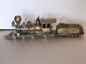

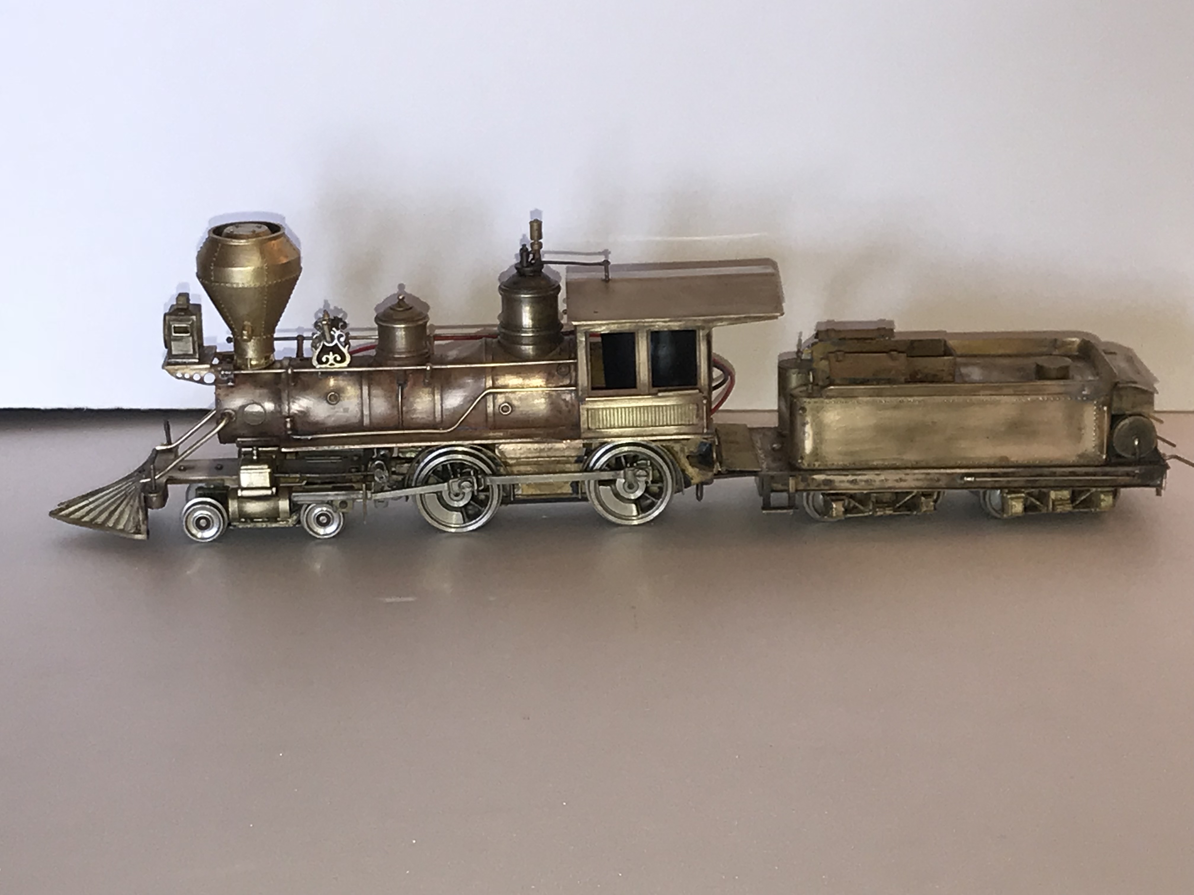

Very odd, I just uploaded a photo off my phone on my On3 Locomotive shops thread without a problem, but files off my phone are too large when I try to post on my main thread.
Yet I posted this photo off my phone with no problem.
Most of my recent photos don’t show
Did Y’all break Zealot? Can you fix it?

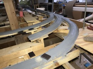

Ok a photo loaded! The roadbed @ Montgomery Furnace.

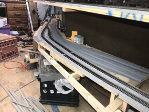

The mainline in the logging area.

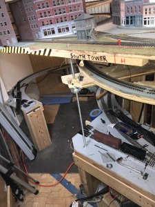

My standard gauge mainline is completed, with all the switches in for Montgomery Furnace, and. The log camp.
The return loop and it’s passing siding are in , but the photo won’t load.

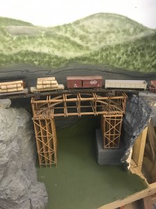

The old Cave Cove Bridge is in place, this photo is one I had posted earlier, but the link seems broken.

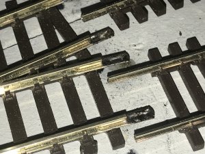

Making a joint between a code 100 switch and code 83 flex track.
If this seems random it is, as whatever photo will load I can show. Don’t see how two consecutive photos taken withe the phone makes one too large to upload, while one will upload.

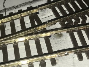

The completed code 100 code 83 joint.
I have code 100 in the return loop at the bottom of the helix nook, and at the switches on the left (north) side of the log camp, as I’m out of code 83 switches.
