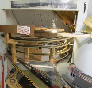

The  helix  is  tricky,  I  benefitted  from  knowledge  of  two  helixes  on  our  old  club  layout.  the  first  rule  is  to  use  the  largest  radius  possible.   It   helps  to  use  thick  plywood,  as  any  vertical  curves  (changes  in  the  grade)  on  the  helix  will  cause  problems,  and  the  thicker  pieces  of  plywood  are  stiffer;  and  thus  it  is  easier  to keep  the  grade  even.    I'm  not  a  math  whiz,  and  figuring  the  grade , rise  over  run,  or  to  be  more  precise,  change  in  elevation  divided  my  the  length  of  the  elevated  track.      To  be  sure,  the  english  measuring  system  is  going  to  put  you  into  fraction  land,  so  I  figure  my  grades  using  centimeters.   I  have  a  measuring  tape  with  metric  on  one  side,  and  english  on  the  other,  so  I  can  switch  gears.
A  problem  that  often  gets  missed  is  keeping  the  roadbed's  cross  section  level.   I  have  a several little  levels,  designed  to  be  a  line  levels.  as  I'm  building  the  helix  (or  any  roadbed  for  that  mater),  I  check  the  level,  ninety  degrees  off  the  center  line  of  the  track.   It  should  be  dead  level.     some  lean  to  the sub road   bed  you  can  get  away  with,  but  it  is  more  problematic  in  a  curve  or  on  a  grade,  doubly  so  on  a  helix.   a  slight  elevation  of  the  outside  rail  in  a  curve  is  a  prototype  practice  called  super elevation.  This  makes  the  car  lean  inward  some.  the  goal  is  to  balance  the  force  of  gravity  tipping  the  car  inward,  and  centrifugal  force,  pulling  the  car  outward.      Super  elevation  helps  a  little  on  the  model;  but  not  as  much  as  it  does  in  real  life.  it    is  only  worthwhile  where  you  can  see  it,  as  it  is  a  cool  effect,  but  it  is  best  achieved  with  tiny  shims  under  the  outside   rail  of  flex  track;  we  want  to  stay  away  from anything  but  a  dead  level  .

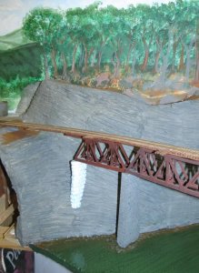

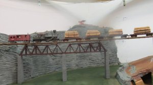

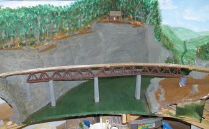

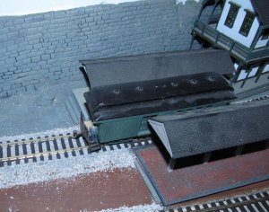

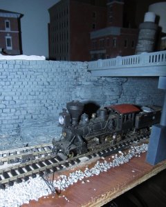

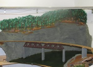

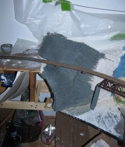

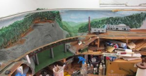

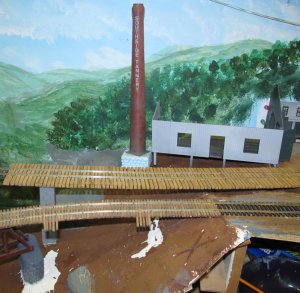

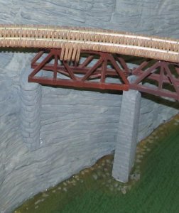

I  painted  the  foam  bridge  pier,  and  put  the  first  protective  coat  of  polyurathane varnish  on  the  river.  the  gloss  acrylic medium  looks  beter,  but  has  a  fragile  surface .  when  the  varnish  on  the  river  dries,  I  can  start  installing  foreground  trees  along  the  cliff,  and  making  the  primordial  forest  floor  back  to  this  corner.  that  is  going  to  make  this  area   my  most   most  scenic  spot,  until  I  get  to  my  upper  deck.  I  have  also  shortened  the  bridge deck  stolen  from  the  club,  and  removed  the  code  100  rail  (leaving  the  spikes  in  place,   so  it  should  be  super  easy  to  get  the  new  code  83 rail  installed); I  need  to  cut  out  some  holes  between  the  ties  to  dump coal  for  the  tannery.  I should  be  able  to  start    extending  the  track  onto  the  Sander's  switch  block  soon.
