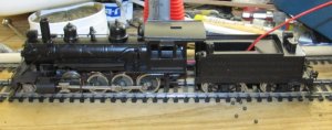

I have added two wipers to the 2-8-0. both made from .015 phosphor bronze wire; which is a good size for Ho. as the size increases the stiffness does as well and the springiness decreases. I'm not fully satisfied with the fit of the wipers, but they are close. from here I will need to drop the axles, and fine tune them with the wheels out, so there will be the right amount of contact when the wheels are reinstalled. a tricky process, but electrical pick up is the Achilles heel of many locomotive mechanisms.
I want good contact without causing too much drag, and this is a pretty good size for a compromise. on lightweight HOn3 locomotives, where drag is more of a problem, I am likely to use .010 wire. This locomotive is has a good strong motor, and a good drive system, so drag won't be much of a factor.
The front wiper picks up off of the front insulated driver, and the second picks up off of the two center insulated drivers. I'm studying to see if there is room to add a third wiper for the rear insulated driver.
I have also found a way to re route the wire off of the cover plate (My addition- I like to get the electrons into wires as soon as possible), so that it is both much less visible and is tucked safely away
The white and brown striped vertical wire next to the motor is the frame wire. the bare copper wire off of the rear wiper pad is the insulated wire (there is a jumper to the front pad). If I don't add a wiper for the rear insulated driver, then all I have to do is to experiment to find out which way to hook up the motor termianls so that the locomotive runs in the same direction as my others; add the two wires and a plug that will go to the tender, which will eventually be wired for pick up off of the insulated side as well (can't have too much electrical pick up ). I like to get as much of the electrical path as possible into wires, my theory old brass doesn't conduct electricity well!
Should I wish to add DCC at a later date a decoder could be placed in the tender, and the power wires to the motor could be run with a separate plug. The brass castings for the headlights on this locomotive are primitive solid chunks, so If I want to make provisions for lighting I need to replace them or drill them out.
This locomotive has some real potential, it is very handsome, has a good mechanism, and I have packed a lot of extra lead into it, so it will be a heavy SOB, and hopefully will be a good performer on the 3.3% ruling grade on my valley division.

I have run #1 on the test track, to determine witch direction this locomotive will go (double heading is important to my future operation plans).
after establishing which direction it should go I hooked up jumper wires to the motor leads, and noted which orientation got me the proper direction of travel. I then wired the motor to the ground and insulated leads, and added wires to a two wire plug that will go to the tender, to get the insulated and the ground pick ups from the tender (once they are built) to the locomotive. I will endeavor to get wires attached directly to the trucks, so on the ground side I will only have the rolling contact point between the frame of the truck and the axle, before those pesky electrons get herded into a wire, where they will be safe from the resistance they otherwise would have encountered at the truck / bolster, and at the slip joint to the tender. remember old brass does not conduct electricity well.
With the locomotive wired, I test fit the body. with the shell on it it runs off of the rails without the tender, indicating that my insulated pick ups are working , and the boiler didn't short anything out. I now have it upside down in a primitive cradle made out of a supermarket Styrofoam meat tray; powered off of the tender plug, and I am running the **** out of it to break it in.
So far I have only one disappointment, the motor is such a tight fit that it touches the boiler structure on both sides, this transmits all the drive train noise into the boiler. the mechanism is quiet without the boiler on, but it is noisy with the boiler on. This is too bad. the next smaller motor is considerably smaller, and with the extra lead, this locomotive can use the power of the larger motor. Thankfully the slow speed operation is verry good, and it doesn't get real loud until it is run at higher speeds. If I were building this as a sound locomotive, or didn't have the 3.3% grade @ Tom's bend to contend with , I would consider shoping for a smaller motor. The basic rule is the bigger the motor the better low speed capability is, and I like them slow!

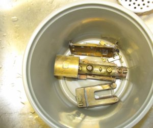

I am inside taking a break from cleaning off the front porch, and did a little work getting the Ma & Pa 2-8-0 ready for the paint shop.
in the photo the locomotive body , the tender frame and body, are in a margarine tub (clean) with some ivory liquid, waiting to get boiling water poured on it. The locomotive frame is already painted.
after getting several baths with boiling water, it will get soaked in vinegar for a half an hour or so to lightly etch the brass, get more baths of boiling water , be allowed to dry . and then after masking a couple spots to preserve the electrical path, it will get some paint!

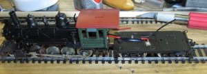

I am p the 2-8-0 together after getting it out of the paint shops.. I still have electrical work to do in the tender, mounting the locomotive-tender plug, hard wiring the ground side of the tender trucks, and and getting electrical pick ups installed and wired for the insulated side of the tender trucks, this locomotive is packed with lead, and should be a hoss.
It needs to get a red roof, a green cab and a front coupler It would be nice if it double headed nicely with some of my other rod power, we will see.

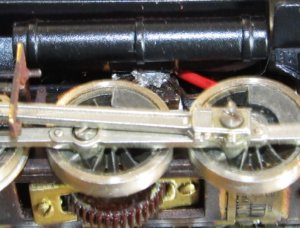

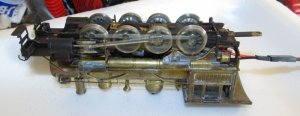

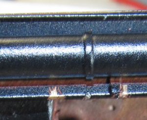

I'm getting ready to tackle the short I took a photo of the assembled locomotive, the contact is on the pad for the insulated wipers. It is not clear, but you can see the solder that holds the wiper to the pad just to the left of the red wire ( witch will need to be painted black) I have scratched the paint to either side of the contact as a reference to show exactly where the grinding will need to happen.
In the next photo the body has been taken off of the frame, I forgot how tight a fit that motor is, and I am ready to apply the dermil

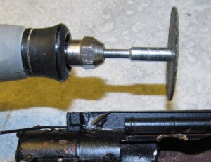

next shows the cut made with a dremil with a grinding disk, like a cutting disk, but thicker and stronger so they don't explode when you look at them hard.
This dermil has the flexible lead on in, not really needed for this cut, but my other dremil is set up for chain saw sharpening, and my chain is dull, and I have some trees down in the yard, so I want to leave it set up for chain saw use.
I need to do some touch up painting (including that red wire, and then get it assembled, and perhaps I can get back to the tender wiring

The notch I cut in the bottom of the boiler opening was sufficient to allow enough clearance to prevent the short, and the locomotive ran with the tender disconnected, the pick ups on the 3 insulated drivers doing their job.
