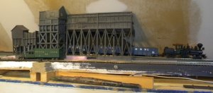

Eastern Tn logging on the DG CC & W RR 1928
right again
It looks really unnatural for that big steamer to go through such a tight area, but then again how often will that switcher go on the track closest to the station? I'm sure not much. . . . . . . .
Tyler
Right you are, that inside track is reserved for passenger trains, and this monster is the freight interchange locomotive. I had never even tried to get it down that track, but was inspired to try by getting the 2-8-0 onto that inside track, something that I had long thought to be impossible. The standard practice is for this locomotive to push a cut of freight cars up the helix. and for the cut of cars to go down the center (preferred) or the outside track, and for the locomotive to drop them without getting on to the stub switch at all. When it comes to make a pick up, again preferably on the center route, it might actually get onto the 3 way stub switch in order to couple to the string of cars before pulling it down the helix to the southern staging.
I'm sure the Southern doesn't like to come on to my track, they just don't want my woodburners on their track , ever since that unfortunate brush fire. I still maintain that their valuation of their depot, t freight house , and engine facilities was grossly inflated.

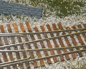

flangeway police in Southside
I have worked my way over to Southside. I'm sure I haven't cured all of my flangeway problems up to there yet, but I'm going after the most egregious ones first.
Over in southside I have a picture of a switch that needs some attention, and then a close up of the same switch.

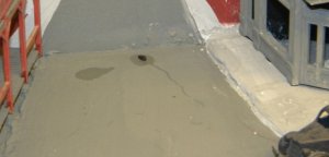

I also have two photographs up by the back drop where a mouse has disgraced itself in the road. Time for a glue trap!

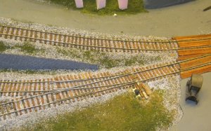

After getting some of the problems corrected in Harlow, I moved down to the Southern staging yard and tried to make some improvements there.
The track down to Southern staging has two switches, so it splits into three tracks, and then merges back to one making a three track double ended yard. the tail track then also has a switch with two more tracks.
where the two back tracks joined together on the back side of the tree track yard, I had a curved switch, that the Southern 0-8-0 did not like so I cut it out and spliced in a Peco switch (approximately a #6- Peco labels their switches by radius not #). The 0-8-0 likes the new switch, but it took a sudden dislike to a Walther's switch leading to the tail track. that switch has been trouble free for years but about half of the rolling stock in the staging yard, and the 0-8-0 suddenly don't like it. careful study shows it has some sloppiness in it's points, so I will need to replace that switch as well.
I'll have to study my stuff and see if I have any switches on hand. This is one reason I hate commercial switches, often they can't be fixed.

I figured that the three track double ended yard was much more useful to my Southern staging than the two track stub yard at the end of the tail track, so I robbed the switch, a Peco switch salvaged from a module I build in the early years of our club. I spliced in a piece of flex track so as not to shorten the tail track. when I get another Peco switch I can splice it in. this piece of roadbed is salvaged from my first totally inadequate Southern staging, and has Homabed roadbed, so If I get ambitious it would be easy to hand lay a switch in this location. I need to do some careful track alignment and glue the track down. Much of the track is on woodlands scenics foam roadbed, which is something I would not repeat. I like something more firm under my track that will hold a nail or a spike.
I will need to make two gaps on the rails of the center route through the staging yard before it gets put to use. I like the geometry of the tail end of this yard better than it's previous two incarnations.

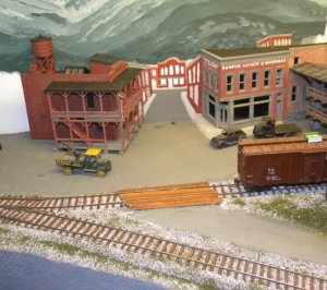

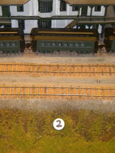

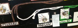

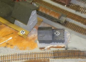

Harlow delivery locations
I have glue drying around strategic locations in the Southern staging yard, so when I cut the gaps hopefully it won't kink up too bad.
Ok the top picture is a detail of my centralized block control panel. Note: the blocks are color coded. white for Harlow, Brown for Murray, in loving memory of Father David Murray, longtime train budy and later my parish Priest. David claimed God is a model railroader, and backed it up with scripture from Issiah ". . . and his train filled the whole temple." also green for the Southern Staging. These colors correspond with the delivery tabs, so if an neophyte operator is unsure of what town a car should go to, he she or it can consult the control panel . The second photo shows the complete control panel, which is unfinished, Georgia staging, at the far right, needs to be assigned a color other than white, so it is not confused with Harlow, 150 miles to the Northeast and 1,500 feet below .
the third photo shows the #2 Harlow (white) delivery marker, a car with a white tab, with the number 2 on it would be delivered to this location.
The last photo shows the back side of Harlow, Southside. a car with a white tab and the number 10 would be delivered next to the sand house, and one with the number 11 would go to the freight house.
each tab is two sided, in each of the previous examples the other side could show Green for Southern staging, or blue for Georgia staging on the other end of the RR. If you get tired of the same car showing up in the same place every other operating session you change the tab.
The beauty of this system is if you want to run trains, and ignore the tabs you can. the cars might end up in odd places, but the next time you do operations, they will go somewhere that makes sense, as long as you don't have a log car tab on a coal car or visa versa.

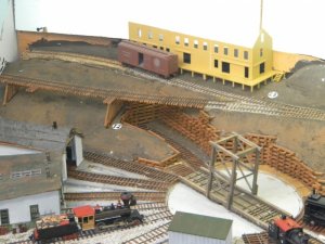

Back to kit bashing
With the Southern staging operational, and the Harlow track much more reliable , I'm looking at Harlow with an Idea of establishing operations.
Up on the hill above the engine facilities in Harlow I have been planning on adding a tannery. In the east , in may locations they peeled the bark off of logs before they got sent to the mill, the bark was sent to a Tannery where they were soaked in water, which released tannic acid into the water, later raw hydes were but into the tannic acid solution to tan the hide. Tanneries were not uncommon near big logging operations, so I though adding one to my operations would be an interesting diversion, much more unusual in the modeling world than it was in the real logging universe.

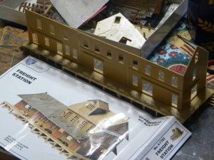

I had this IHC freight house. I had originally planned on using this as the freight house for Harlow, but changed my mind as it is just too ubiquitous. I have modified it to make a two sided two story flat , that will be the beginning of the Tannery.
BTS makes some kits for Civil war era cars, their open roof stock cars look just like cars used to transport bark, so I plan to get some.
Bill Nelson

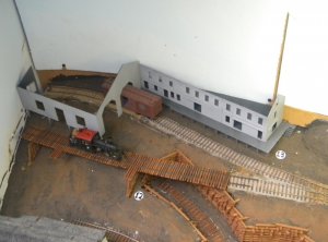

Test fitting the tannery
This two walled flat from the ubiquitous IHC freight house kit forms the first element of the sprawling Tannery complex in Southside. The walls for the next section are some scraps leftover from when Dr. Tom built his Railcamp building. the cuts on the end wall with a door for a railcar to enter the building will be very tricky, so I will recreate that wall in foam core to practice with, and when I know i have it right I'll cit the plastic wall. The next section of building will be complicated, as much of it will be on trestling, as will the loading docks that will be built around wooden vats that will hold the bark while water leaches out the tannic acid.
I figure this building will get two to three cars of bark a day, perhaps two cars of hides a day ( in dedicaded cars, once you haul hided in a car you can't use it for anything else) and provide two car of leather a day, which should make it the busiest location in Harlow

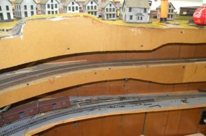

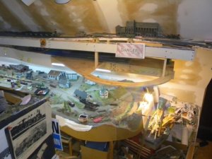

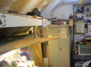

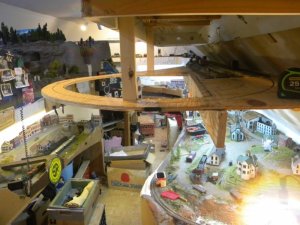

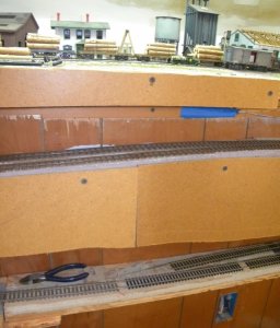

Progress on insane narrow gauge expansion.
Those of you who are unfortunate enough to know me personally know that model railroading has taken a back seat into what has turned into my most time consuming hobby, living in a 130 year old farmhouse on 21 acres. My farm house project was to install oak flooring in a nook of my guest bedroom that had once been converted into a closet for the master bedroom, utilizing a door between the two rooms. we removed the closet, and while the guest bedroom's floor has had oak flooring installed on top of it, the closet still had ugly linoleum added on top of the original poplar, which unfortunately is too cupped to allow restoration. Yesterday I was in there getting ready to add the oak flooring, a relatively easy job, when I realized the wire for the thermostat in the master bedroom was hanging out in the open area that sed to be the closet. I now had to rebuild a wall, and I figured I had best do that messy job before I installed new hardwood flooring. so to do that I had all of my powertools up in the house.

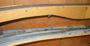

Having the power tools available, it made it a lot easier to do the long planned work to add a return loop to the narrow gauge @ Georgia Staging, and so I went for it, as I had allready breathed enough plaster dust to suit me for this or any other weekend.
So here it is the beginning of the Georgia loop on the narrow gauge which will give my narrow gauge operations a loop to loop capability. with the other loop (North Carolina Loop) just above it and to the right. This will allow narrow gauge trains to enter and leave State line GA. in both directions easily.
When I designed my RR I had minimum 3 foot wide aisles. when I added the log camp at Terrapin, that reduced the aisle there to 2.5 feet. this will give me my tightest choke point, as it is only 2 feet one inch from the outer point of Georgia loop to the corner of the Gizzard.
This will be fun though as there will be room for some removable foam mountain scenery that will fill up the space between the Georgia loop, and the Bumpass Coal and Iron Co. just above it on the fifth level. It is a shame I'm so close to the ceiling , or I could keep on going.
The football game is on so I may work on the tannery some if the spectacle of watching Tennessee's 3rd string quarterback in his first start isn't too painful.

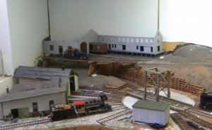

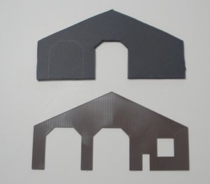

back to the tannery

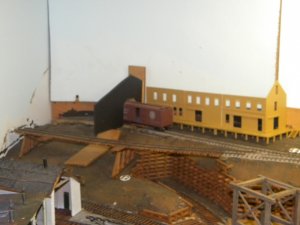

The next wall of the tannery will be tricky, as there is a door where the track goes into the building. the track is allready there. and since the building is a flat, one end is up against the backdrop, so the cut will have to be just right to get the door in the right place.
I cut a piece of foamcore to the shape of the wall, and used that to rest the fit, so I have an idea about where it needs to get cut before I start and it is less likely that I will mess up.
Bill Nelson
I got the second piece of wall sections in place. it looks like it will fit, and make a building that is big enough to be a serious industry. between the trestle and the building there will be a loading dock with vats. that area may be under a roof. I can paint some smokestacks and water towers onto the backdrop to make it look even bigger.
Thanks for the engine house pieces Tom, much faster than scratchbuilding.

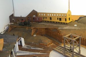

here are some pictures after the basic spray painting of the walls , flat black inside and out to kill any transparency, dark gray on the outside, and some white on top of that, while the gray is still when, and then a dusting on light gray on top of that to give we the optimum faded white look.
I took one photo from above to show how the flats are set up against the backdrop. probably more than 3/4 of the buildings in Harlow are flats, which helps make a cramped area look much bigger than it really is.

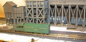

Looking at my photos of the tannery in Walland TN, and it has a big brick smoke stack, perhaps I can add Add a powerhouse in front of the trestle, and outfit a portion of the trestle as a coal dump, and get coal deliverys at the Tannery as well as hides and bark.
That cut off the turntable is necessary to feed the as of yer unbuilt coaling trestle. the hopper cars will have to take a ride on the turntable, the track in the cut will allow me to stash one switcher in the cut. another locomotive can then put a cpoal car on the turn table which can then be turned into position, and the the switcher in the cur can push the hopper up on top of the coaling trestle.
