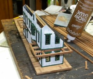

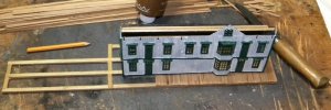

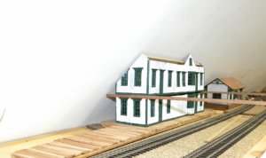

This afternoon I may return to some firewood cutting, but I am also preparing to return to work on the Crooked Creek engine house.

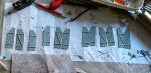

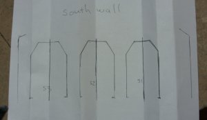

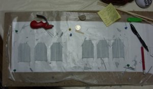

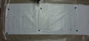

I had made templates of the actual door openings by tracing the openings on paper. I folded the paper to get the center line of each door opening, and this was drawn in with ink to be more visible. I then flattened the paper out, put it on my build board (a piece of homasote), and thumb tacking wax paper over it, so I can build the doors on the template.

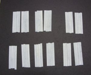

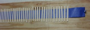

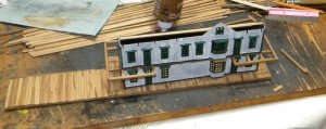

A couple of days ago I fired up my 4 inch table saw and cut planks out of the same pine I made the walls out of, except I cut the planks for the doors thinner. Yesterday sanded the fuzz off of that material and cut them to a length just longer than what I need for the door (you can always trim or sand some off- you can't add any more on satisfactorily)

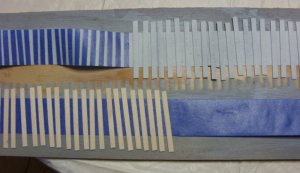

Next I pre paint the boards grey, and then begin assembly.
