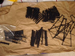

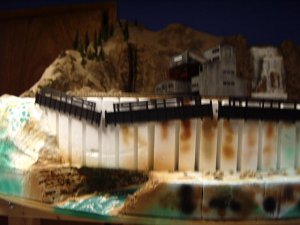

I just finished the Steel viaduct!!!!!
You know something?...I think I'm getting the hang of this modeling thing:thumb:
This kit was soooooo easy! and I think it looks awesome!:thumb: :thumb:
I was so exited when I took this picture, my hand was shaking! But I soon calmed down...I wanted to capture this masterpiece for posterity!

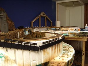

A little gap-age...you can hardly notice:thumb:

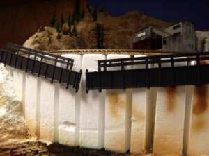

I'm usually not a rivet counter but I wanted this project to be "RIGHT"!
I have only one question...What am I supposed to do with all these "extra" parts?:confused:

Steve, you’ve reached the highest level of modeling skills. I have never seen a bridge like this before. Don’t care about the "extra parts", they are for beginners. sign1 What do you want to do to get a less artistic but more realistic bridge? If you use styrene, it should be easy to build curved girders. Then you could still use the "extra parts" for the piers. I wouldn’t change the style of the viaduct, because besides the fact that you need a curved bridge and the viaduct you bought ist straight, I think you made a very good choice. This steel viaduct will look great on your layout. Hey, and model railroading without any problems would be boring :D .
EDIT
No need to build curved girders. I just saw in yor steel viaduct thread that Wayne has the solution for your problem.

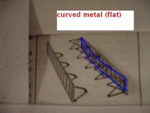

Here's the deal:
The 210' ft viaduct (which I bought) can only be built (according to instructions) for a 30" radius or larger curve. The curve I plan to use it on is 20". So in order to use it...I will have to curve the girders. The girders are pretty pliable so that part won't be a problem. My first thought was to cut a piece of plywood in a 20" radius the width of the inside dimensions of the finished bridge, paint black and "mold and glue" the girders to it. Fairly easy...but you loose the detail of the X-bracing that you would see from underneath. I honestly can't imagine anyone seeing that (except possibly a camera shot looking up).
Second option would be to bend two metal flats on edge to the appropriate radius, glue the girders on them and still probably be able to use the X-bracing.
Ideas or suggestions????
I did order the bridge flex track that I THOUGHT came with it:curse: ..but I have plenty to figure out before I need that....

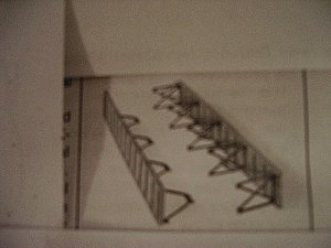

Steve, could you post a pic of the inside of the girders and of the x-bracing ? It might help to see how the bridge is supposed to be assembled to come up with an idea on how to change the construction.

here's a blurry pic of how the X-bracing works:

Lousy pic of "Flat metal on edge" fix:
perhaps this will show what I was thinking......perhaps not:rolleyes:
anyway, these were the first two "solutions" that came into my headhamr
Having not built one of these before (but hoping to someday) I can't really give you any detailed advice.
That said, here is my advice - go find a prototype and look at it! I've never seen a bridge with actual curved girders, but I have seen curved bridges with straight girders.
Yes, yes I know that real bridges have broad radii, but remember we are modeling in a high ratio of compression and I bet ME and CV have taken that into account.
Practically, wait till you get the bridge ties then place them under the rail (actually install them OR use twist ties to hold them under the actual flex track). See how that looks and let that guide your decision process.
Now, get over to my planning thread and help me out. I'm having tremendous planner's block right now.
Galen
Yes, Galen's correct, you can't have curved girders, and you wont see them either. The way a gircer bridge is built would cause a major loss in structural stability if the loadbearing girdes was curved. Think of any truss, suspension, deck, girder bridge...none of them make a curve in the middle f the span, maybe a bit of a turn at each abutment, piling or tower, nut never in the center, because the lateral force of the outward curve has nothing to support it, so it's bend over itself and break, causing a very nasty wreck. Just something to keep in mind. :thumb:
