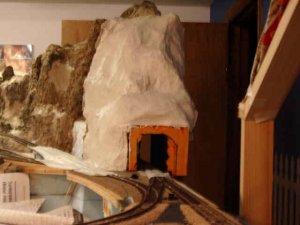

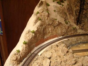

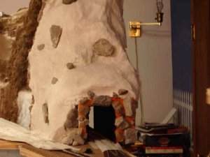

One aspect of this plan which I really like, and especially the way you've interpreted it with the high mountains, is all the tunnels. This makes it harder to follow the train, so to speak, and can give the impression of longer distance traveled. But it can also serve to divide the layout into scenes connected by the train as it travels over the layout, leading your eye from scene to scene as it follows the train. I think this is part of the 'magic' of model railroading, the intentional misdirection that occurs as we follow the train, allowing our mind to focus on scenes and forget the limitations of the dimensions and compression we're working with.
