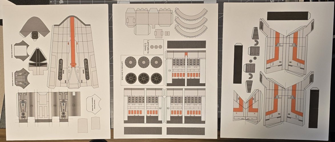

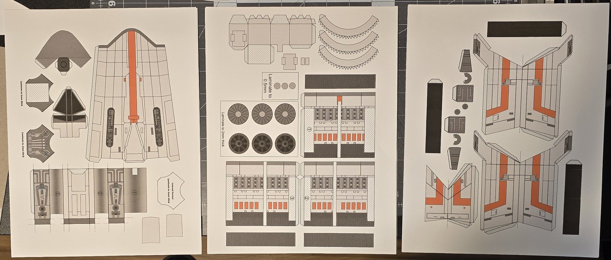

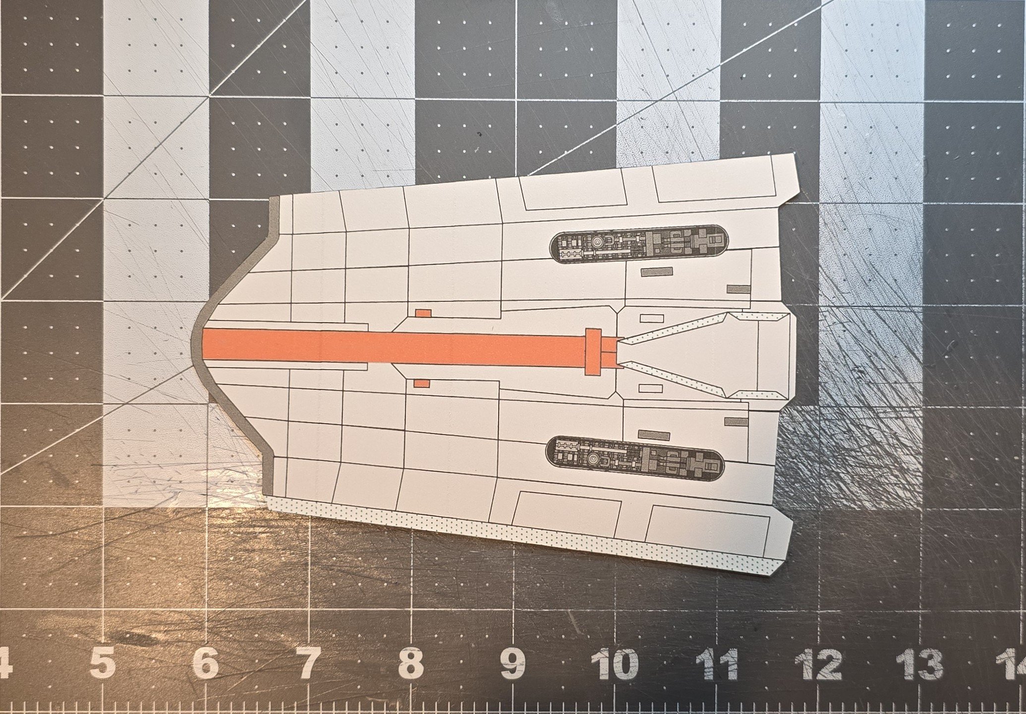

Here are the parts sheets. I have printed this model out several time, in order turn the printed texture into physical texture (which is the easiest for of greebling).

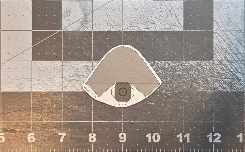

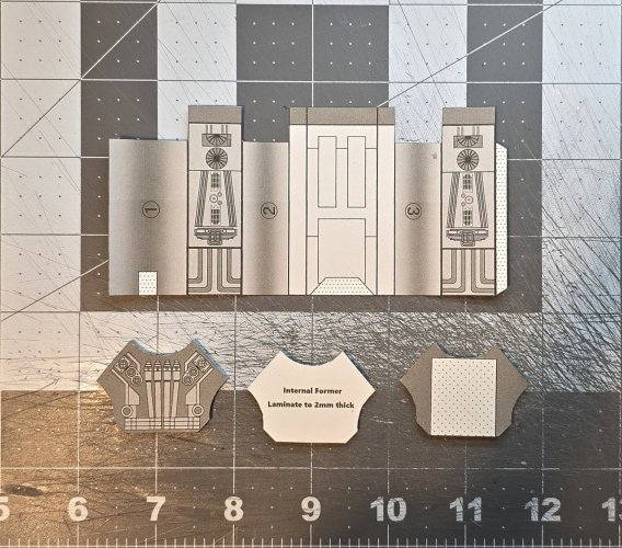

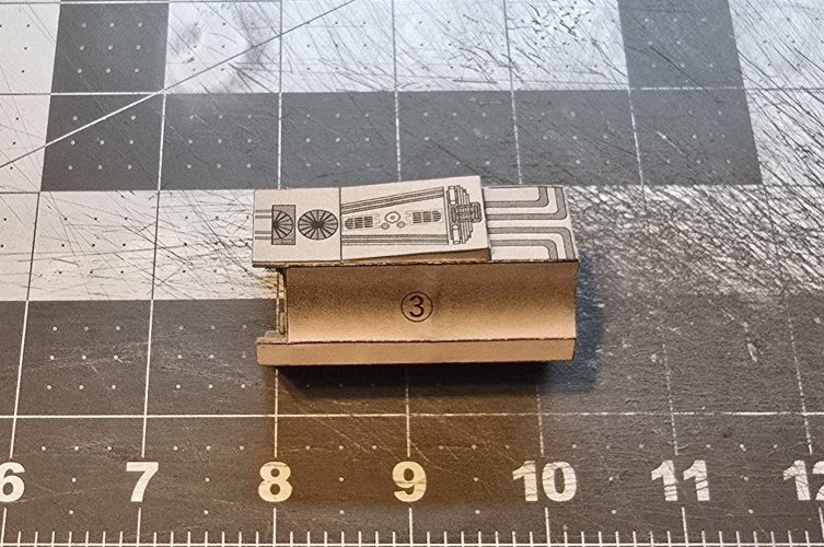

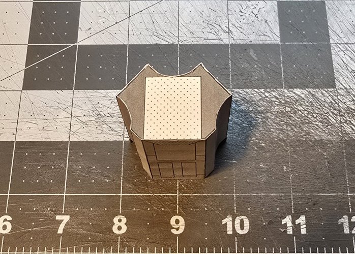

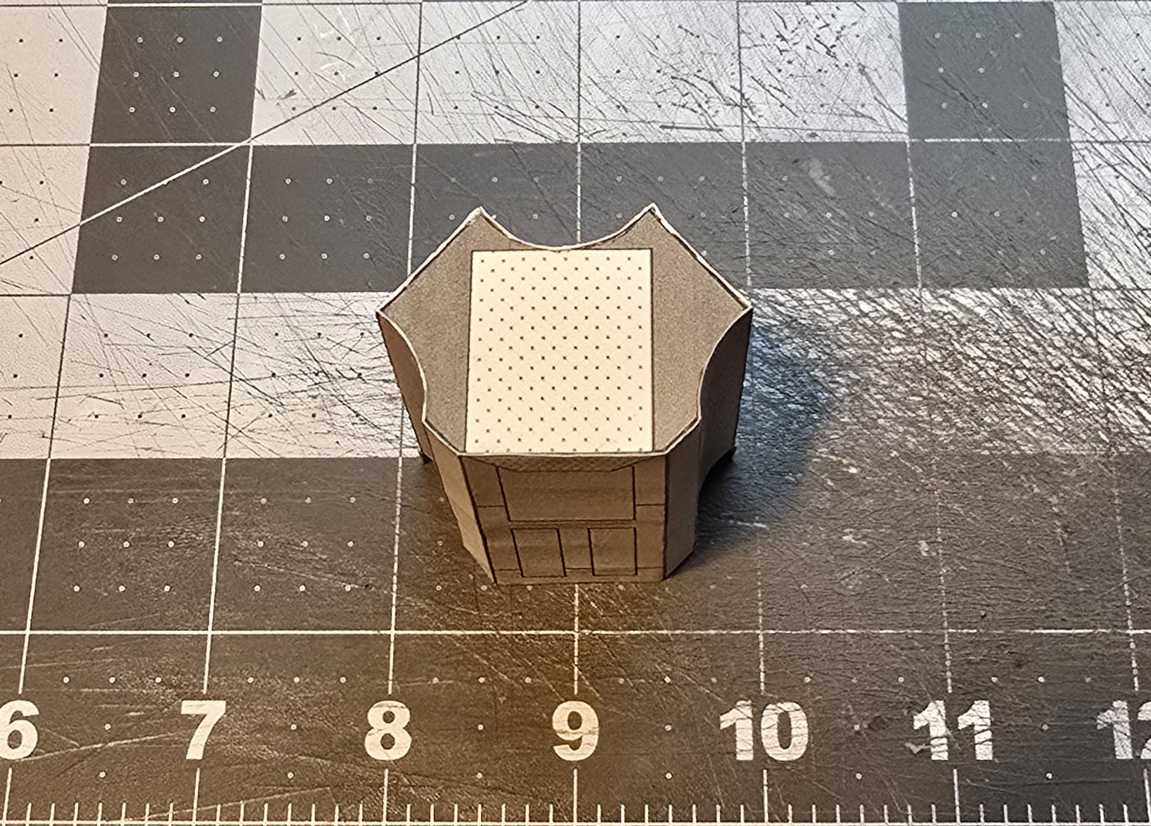

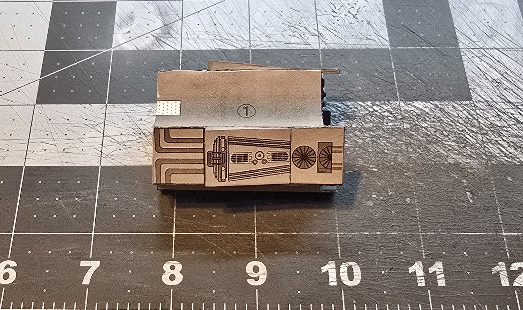

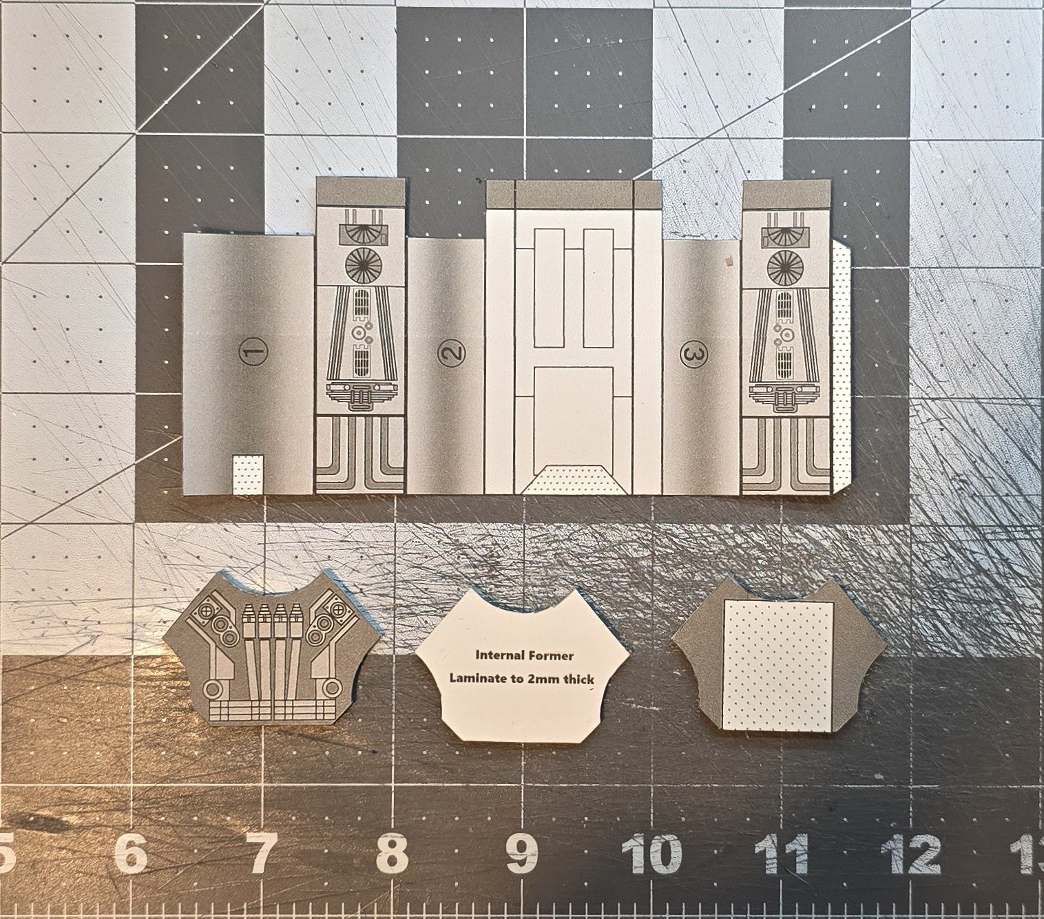

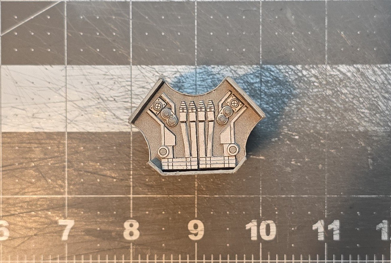

I start with the engine mounting block. I have laminated the end caps and center former to 2mm thick.
The end caps and center former are glued in place.

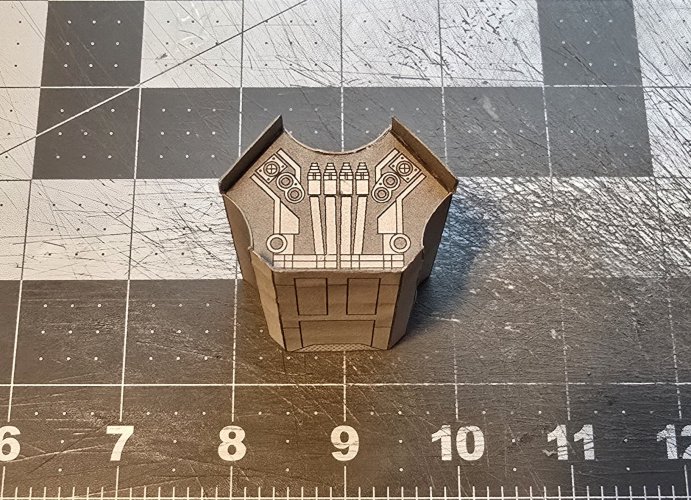

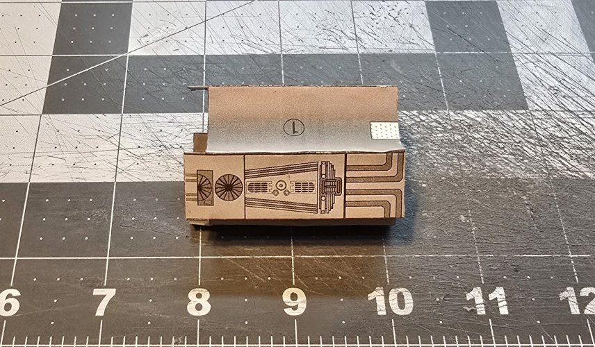

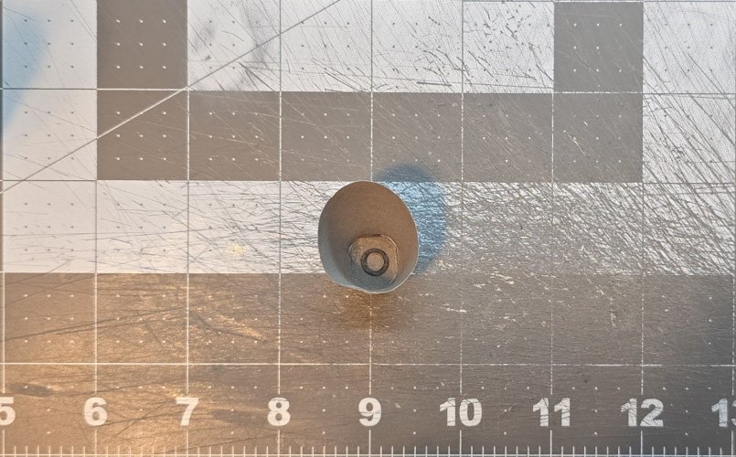

The engine mounting block is assembled.

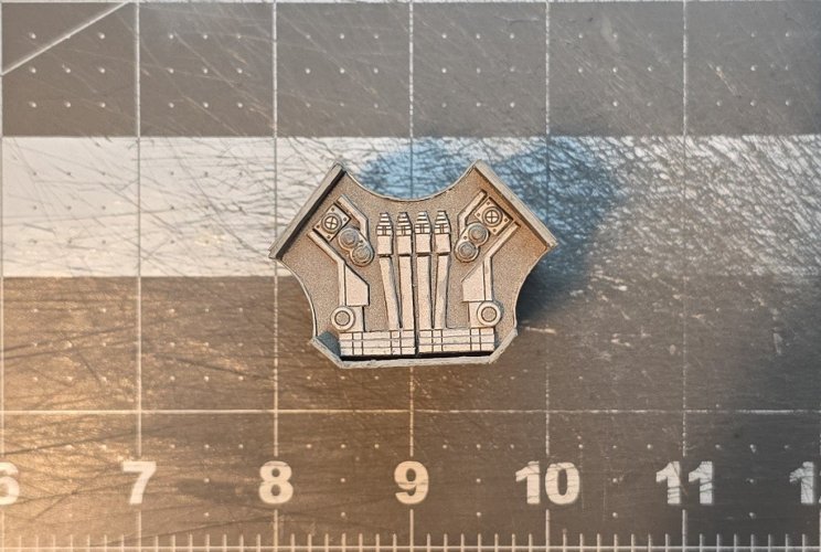

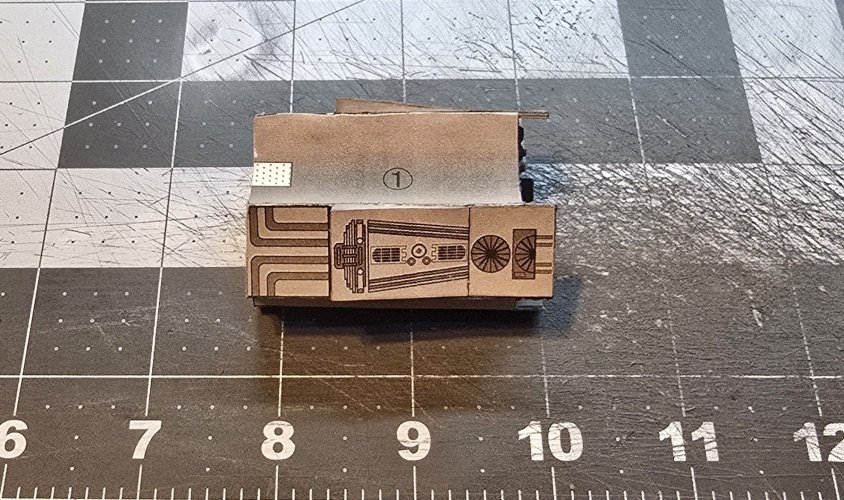

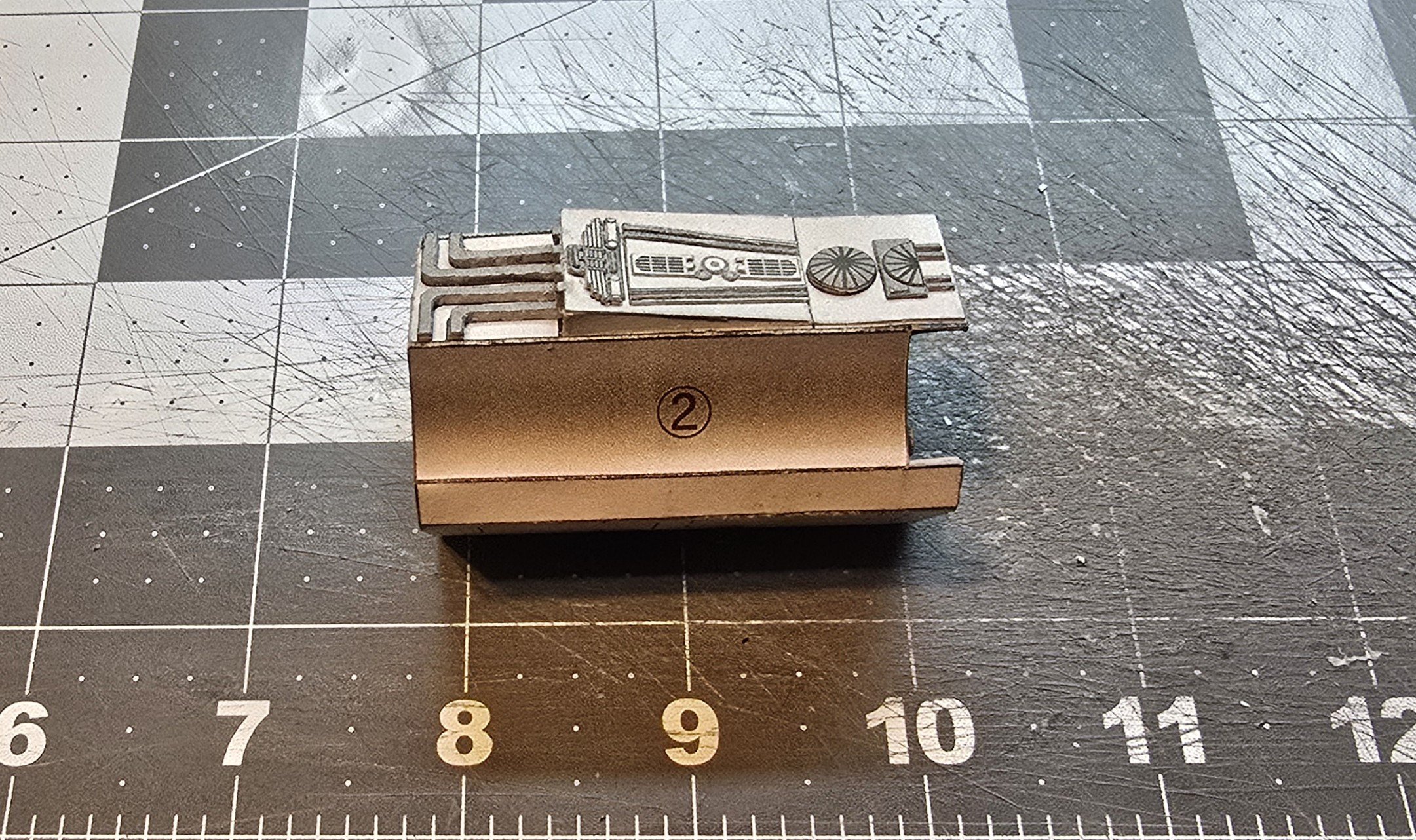

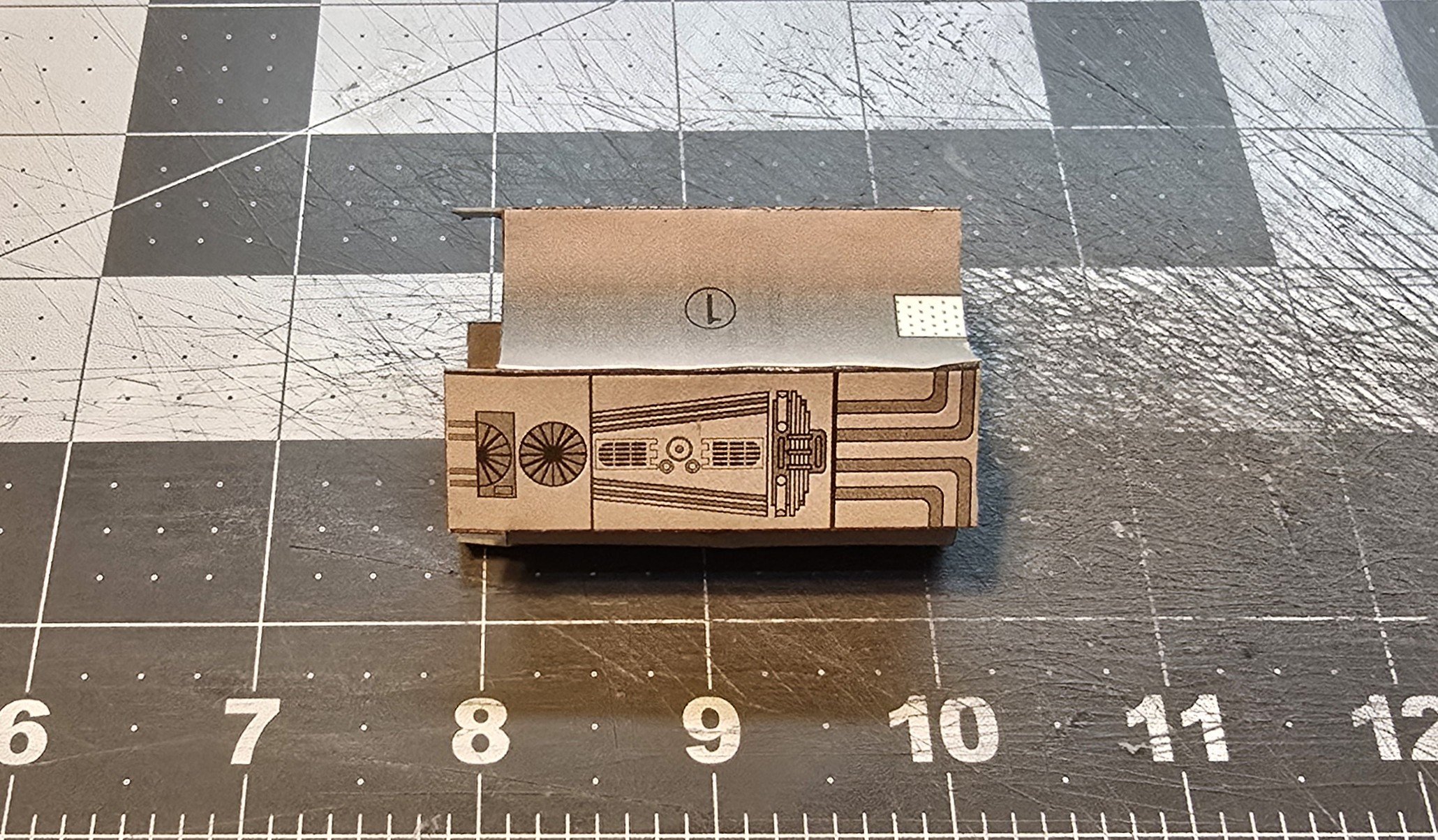

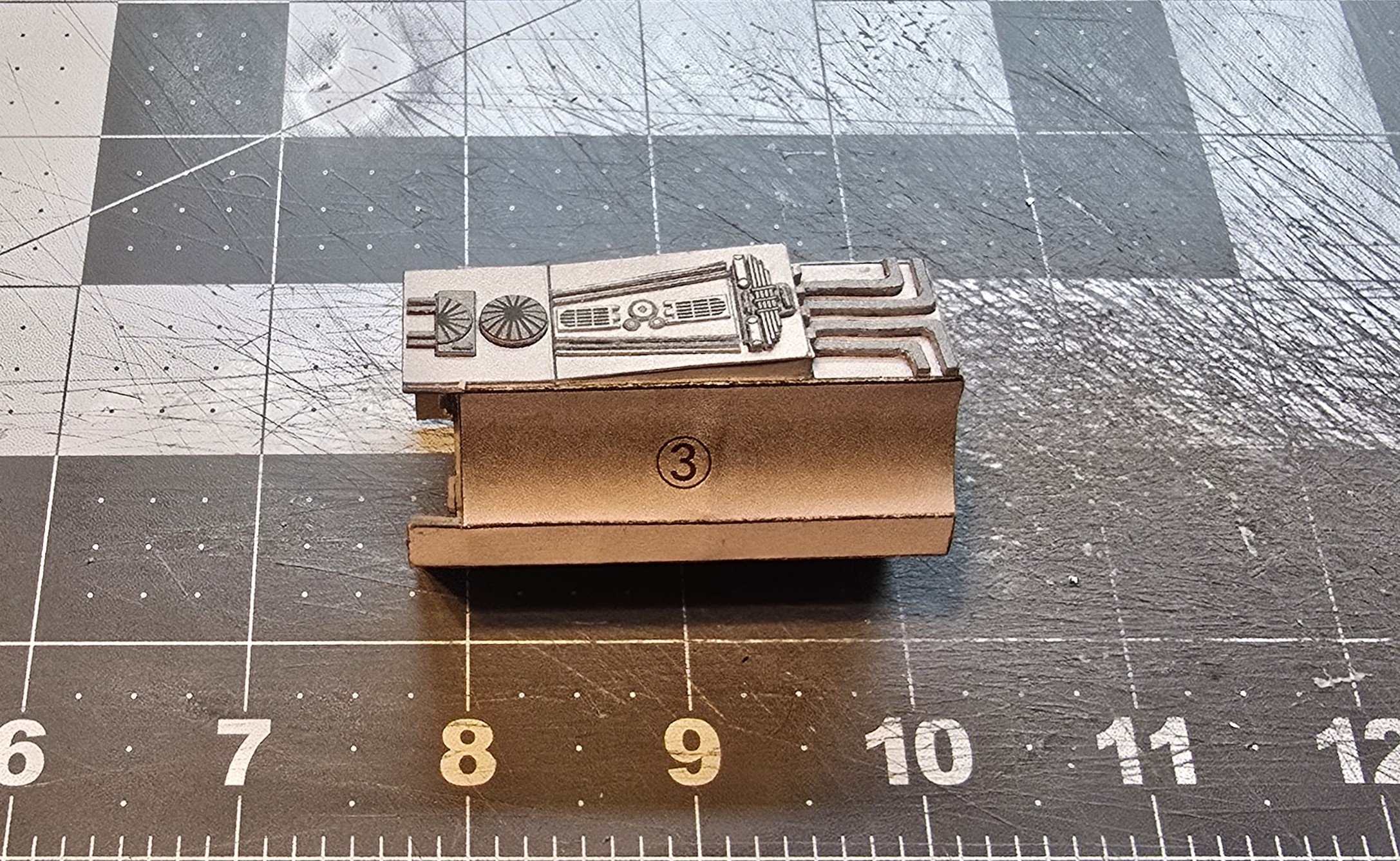

I applied the greebling by layering the printed texture, and turning it all into physical texture.

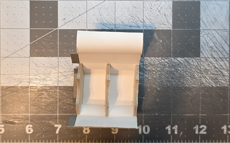

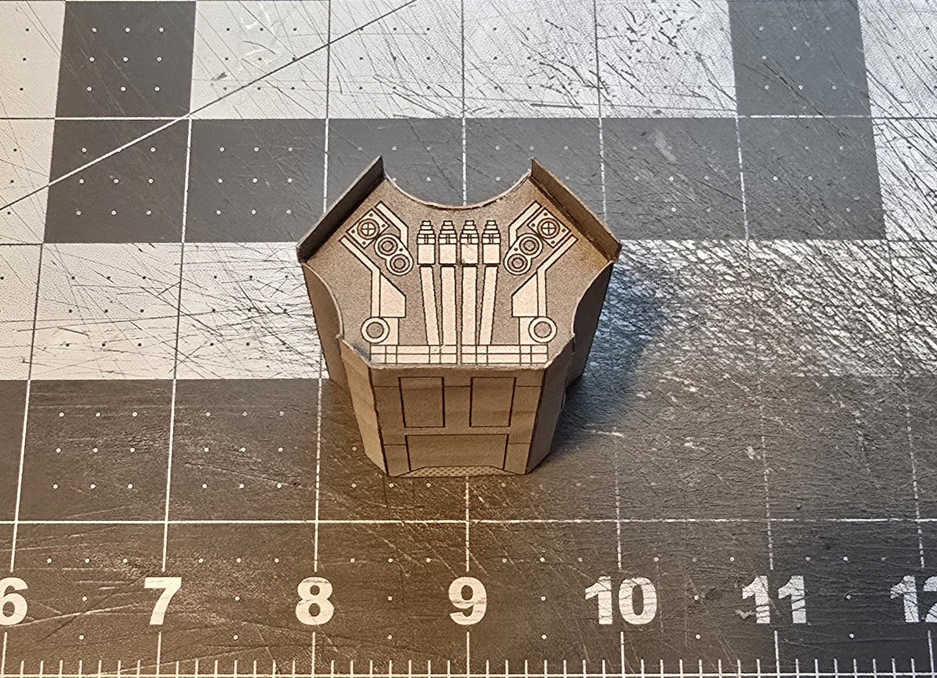

Here is the back of the engine mounting block.

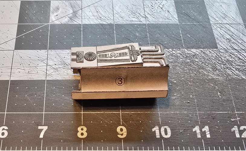

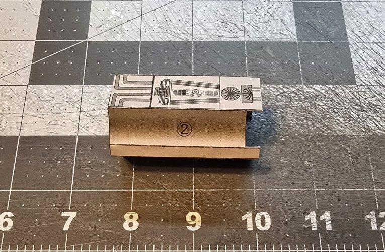

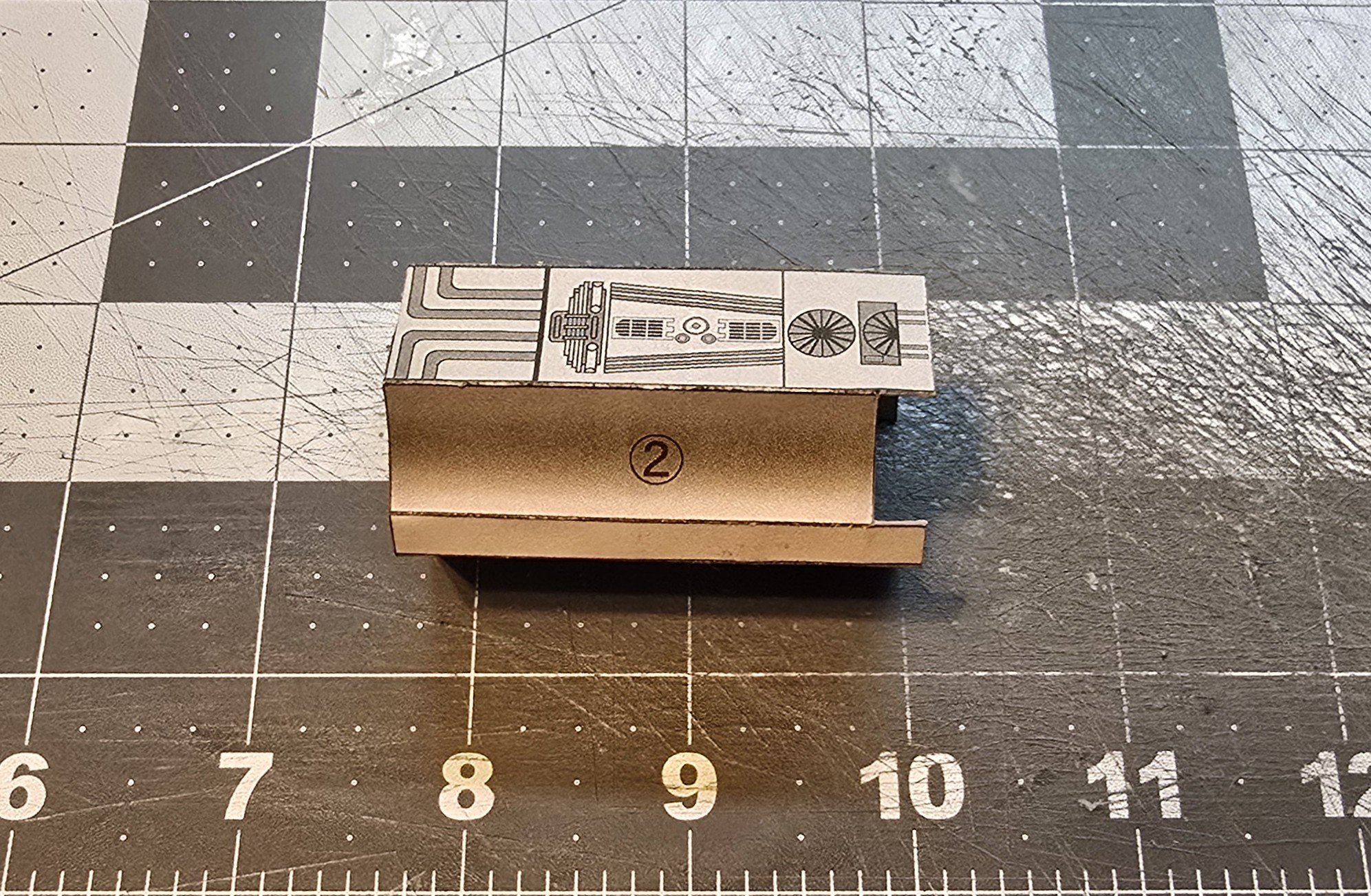

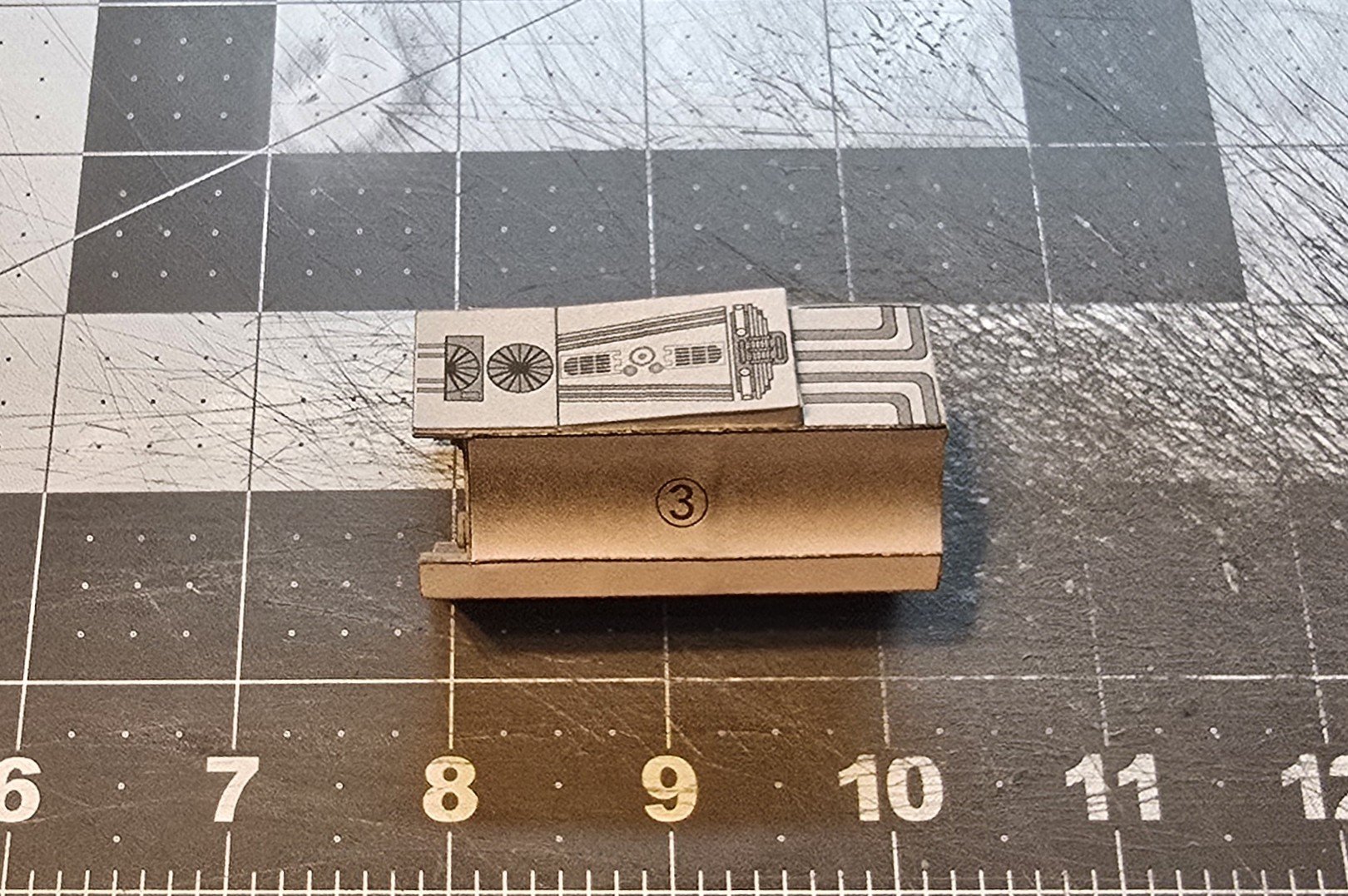

I angled the component for the "conduits to attach to.

A great start, how many copies do you print?
This is a very good question. The answer is determined on how many different layers you want. To answer your question more specifically, I printed the template (on cardstock) four times (and printed the template on (on regular) printer paper once).

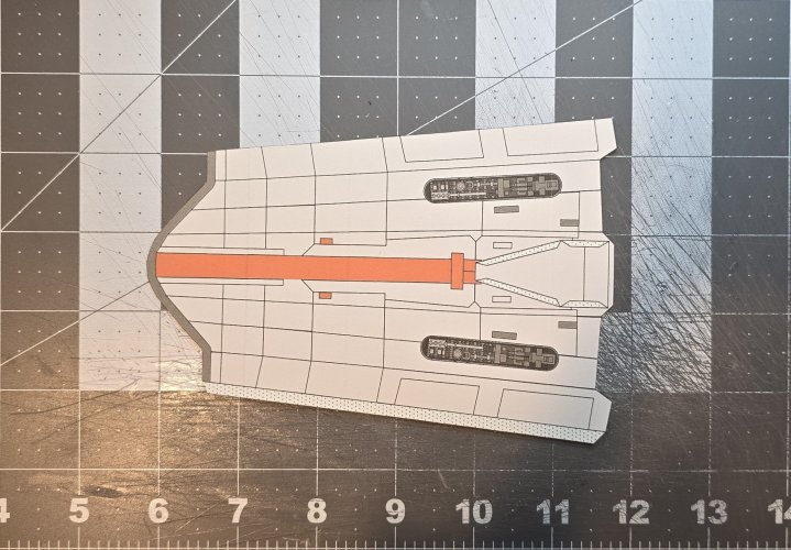

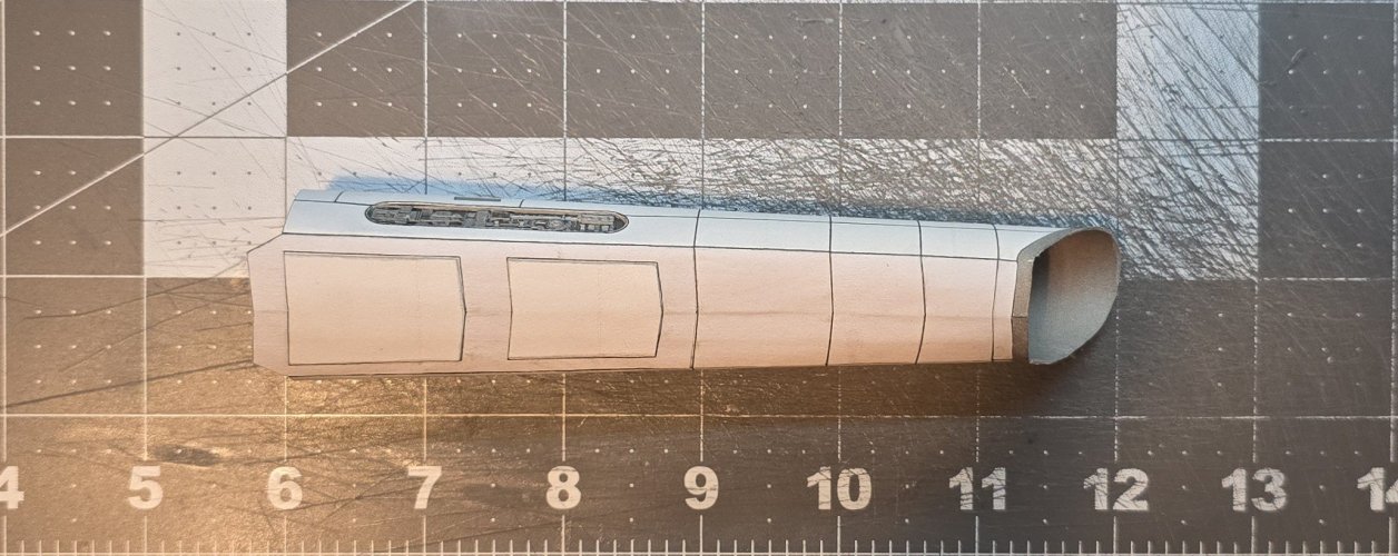

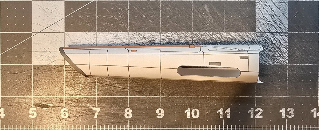

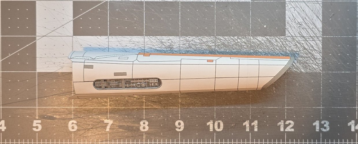

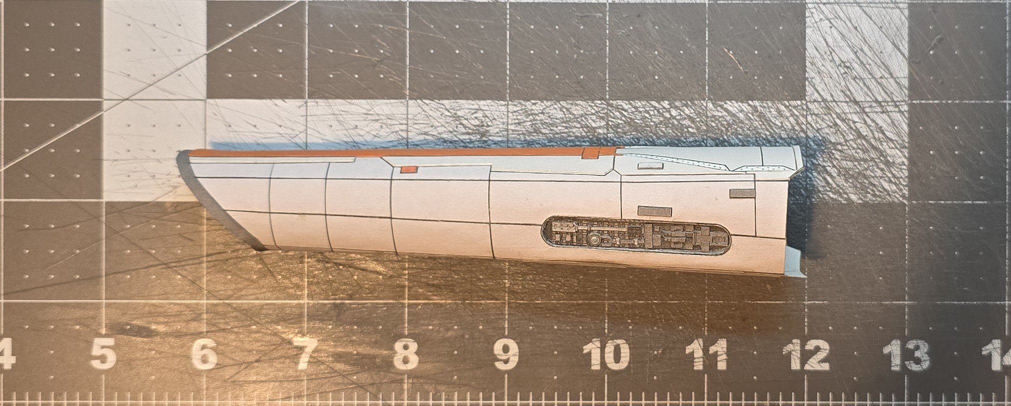

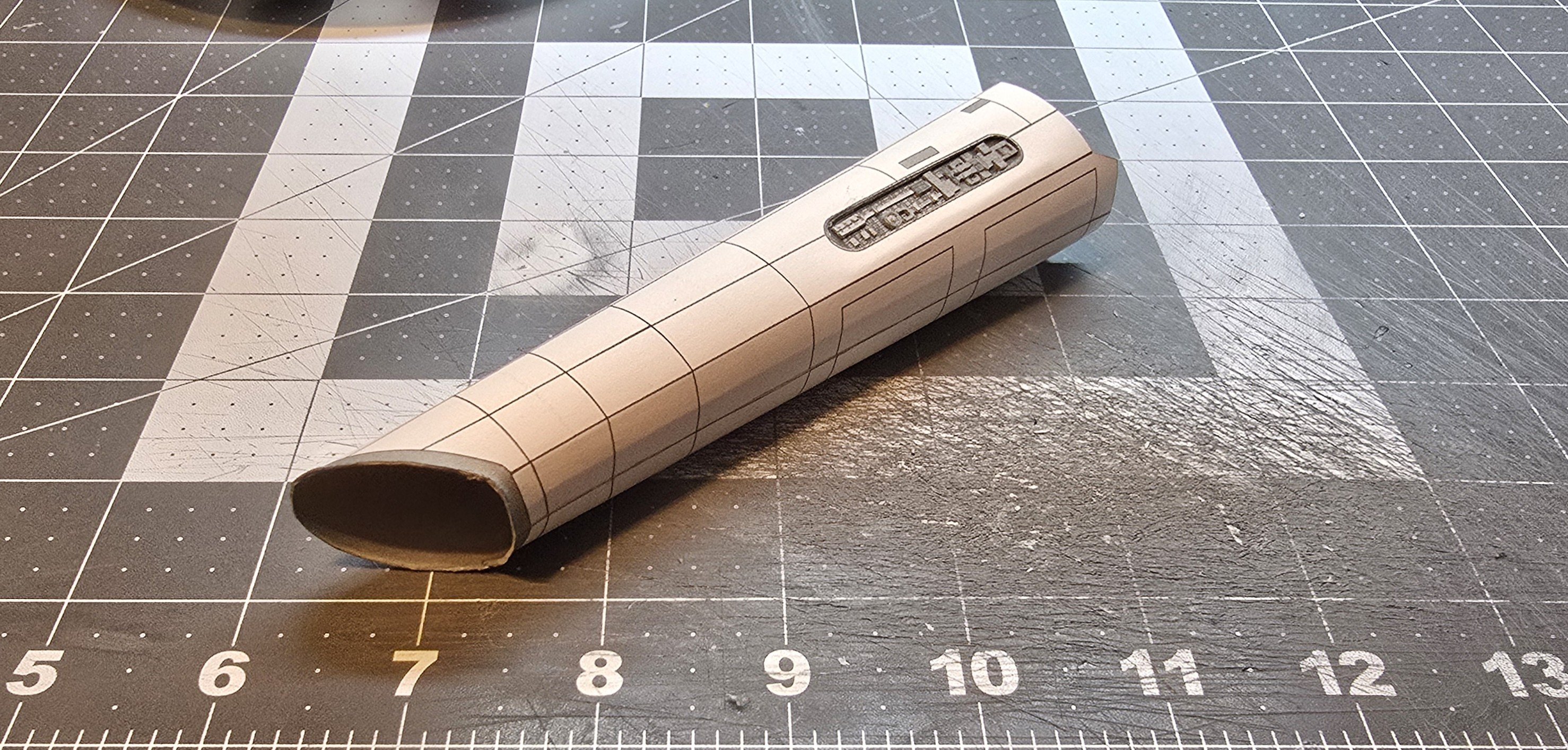

Here is the skin for the fuselage.

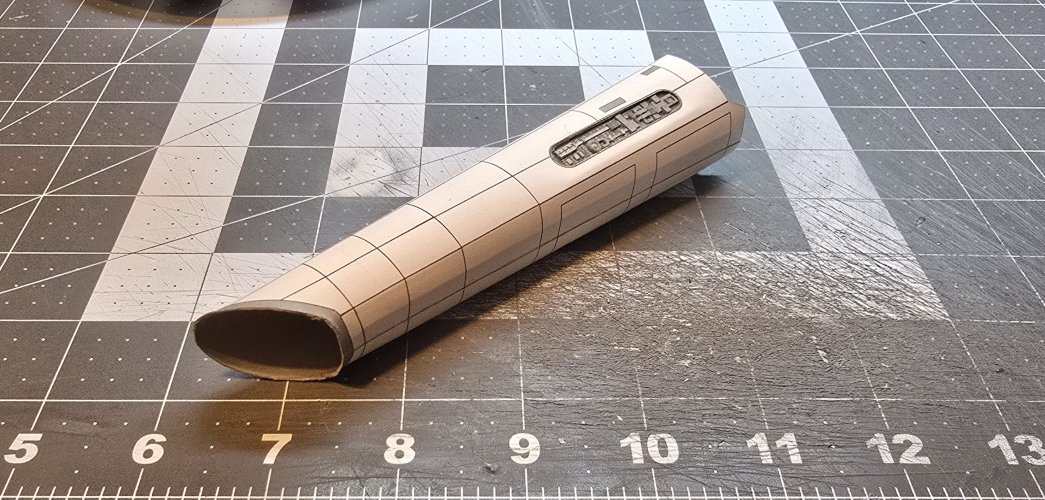

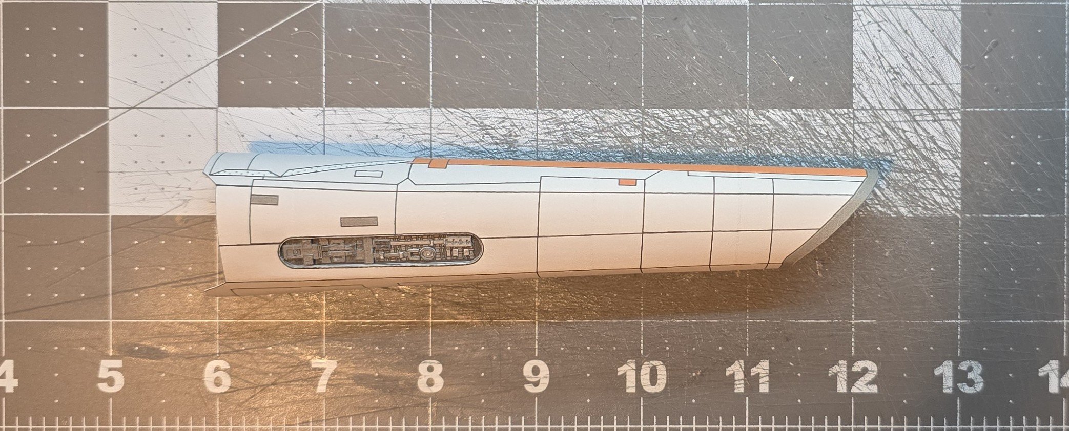

The skin id formed.

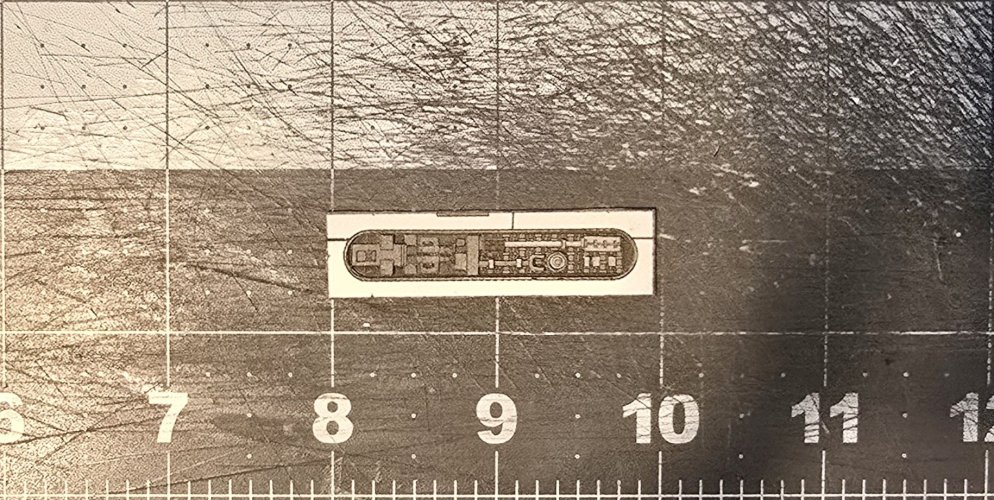

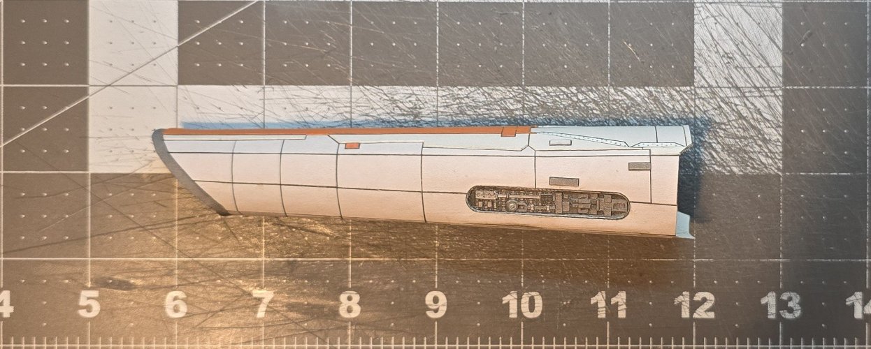

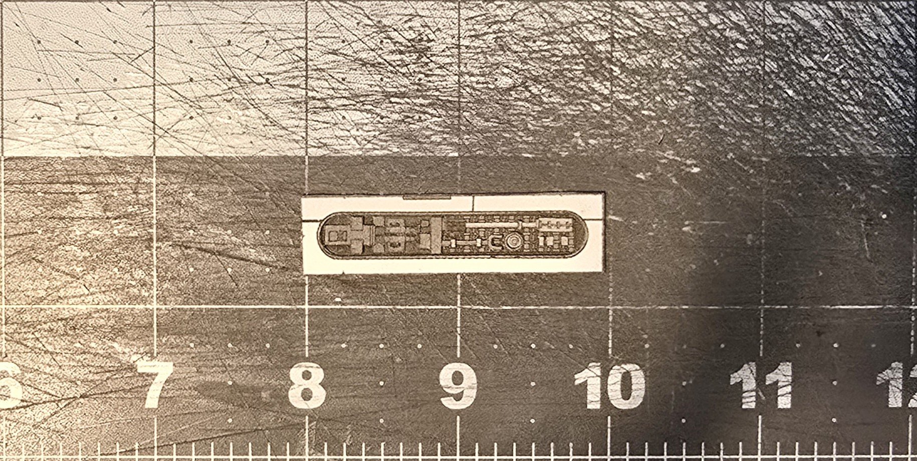

I removed the area for the recessed panels.
The recessed panels are assembled.

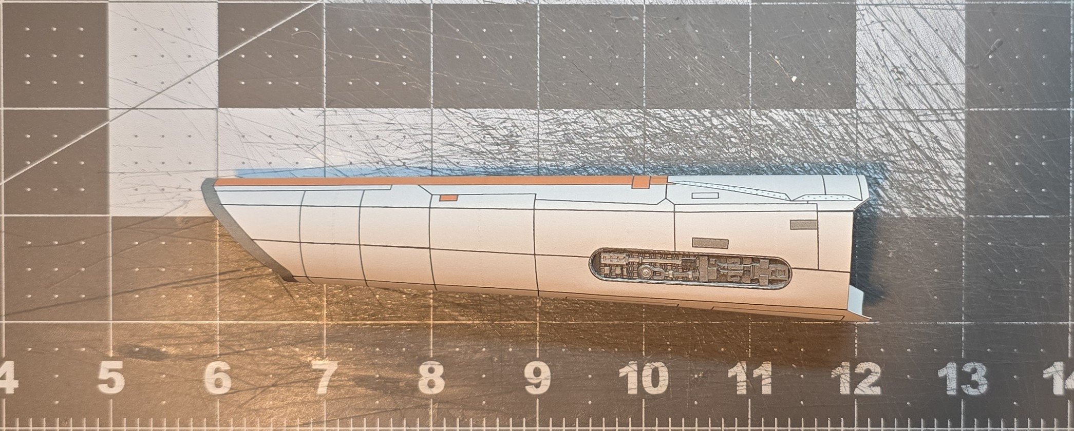

The recessed panels are applied in place.

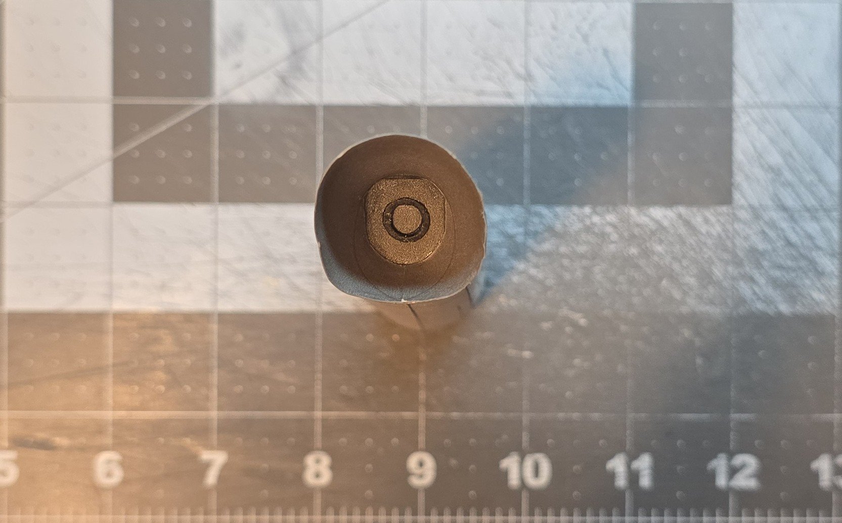

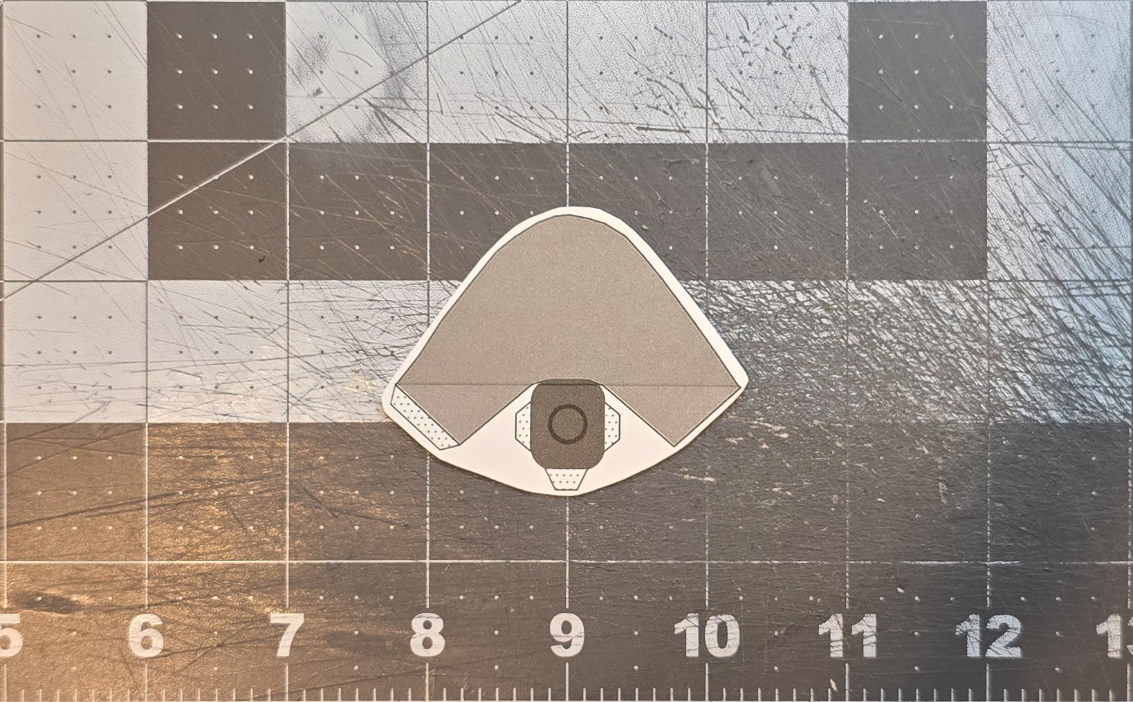

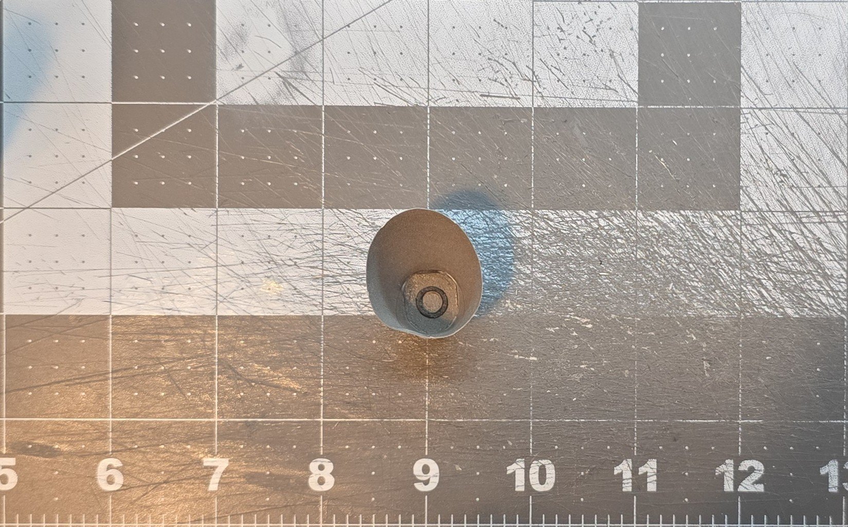

Here is the inner cone piece.
The inner cone piece is assembled.
The inner cone is attached in place.

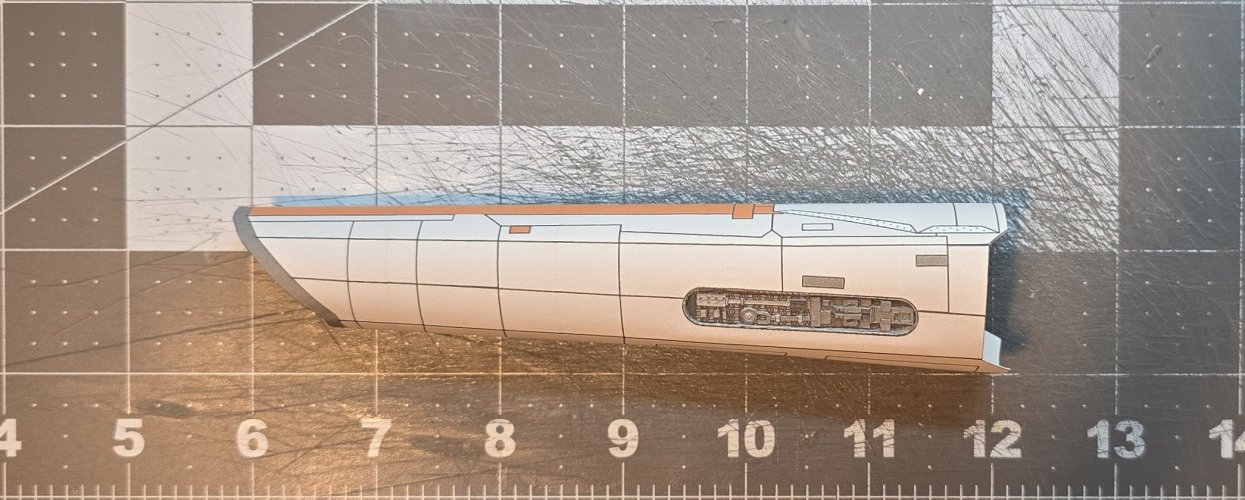

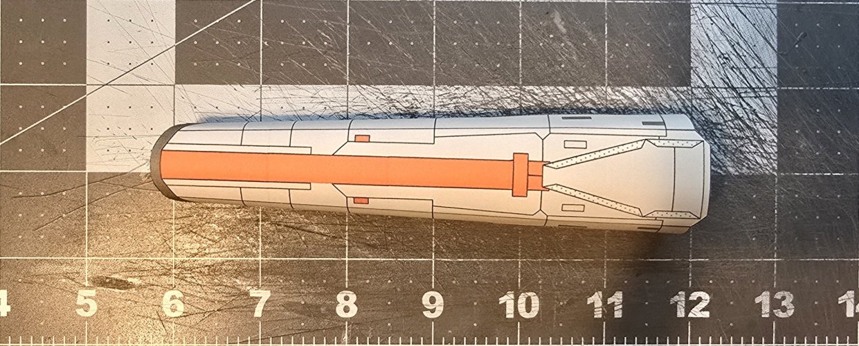

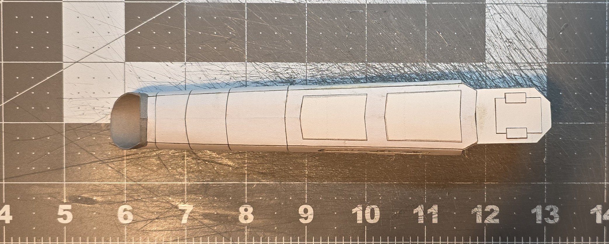

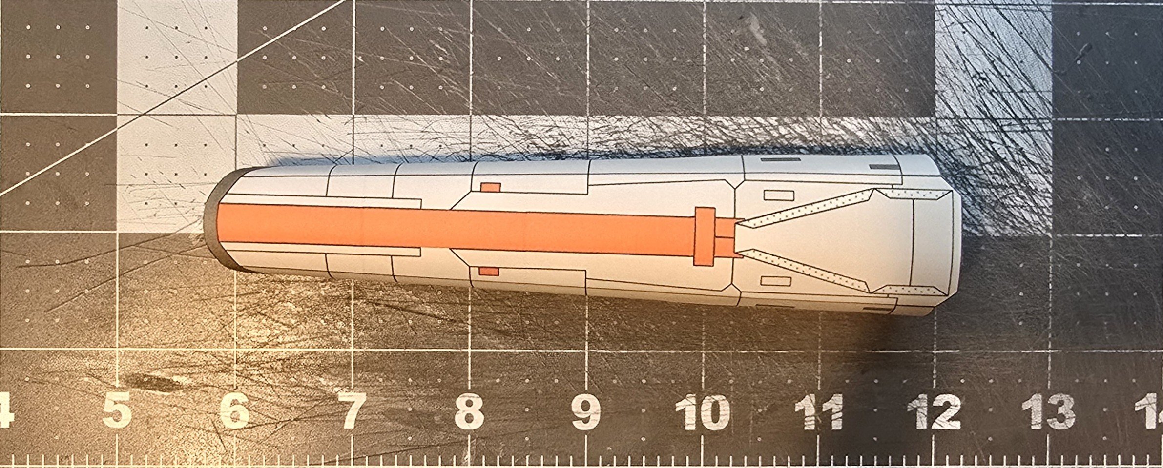

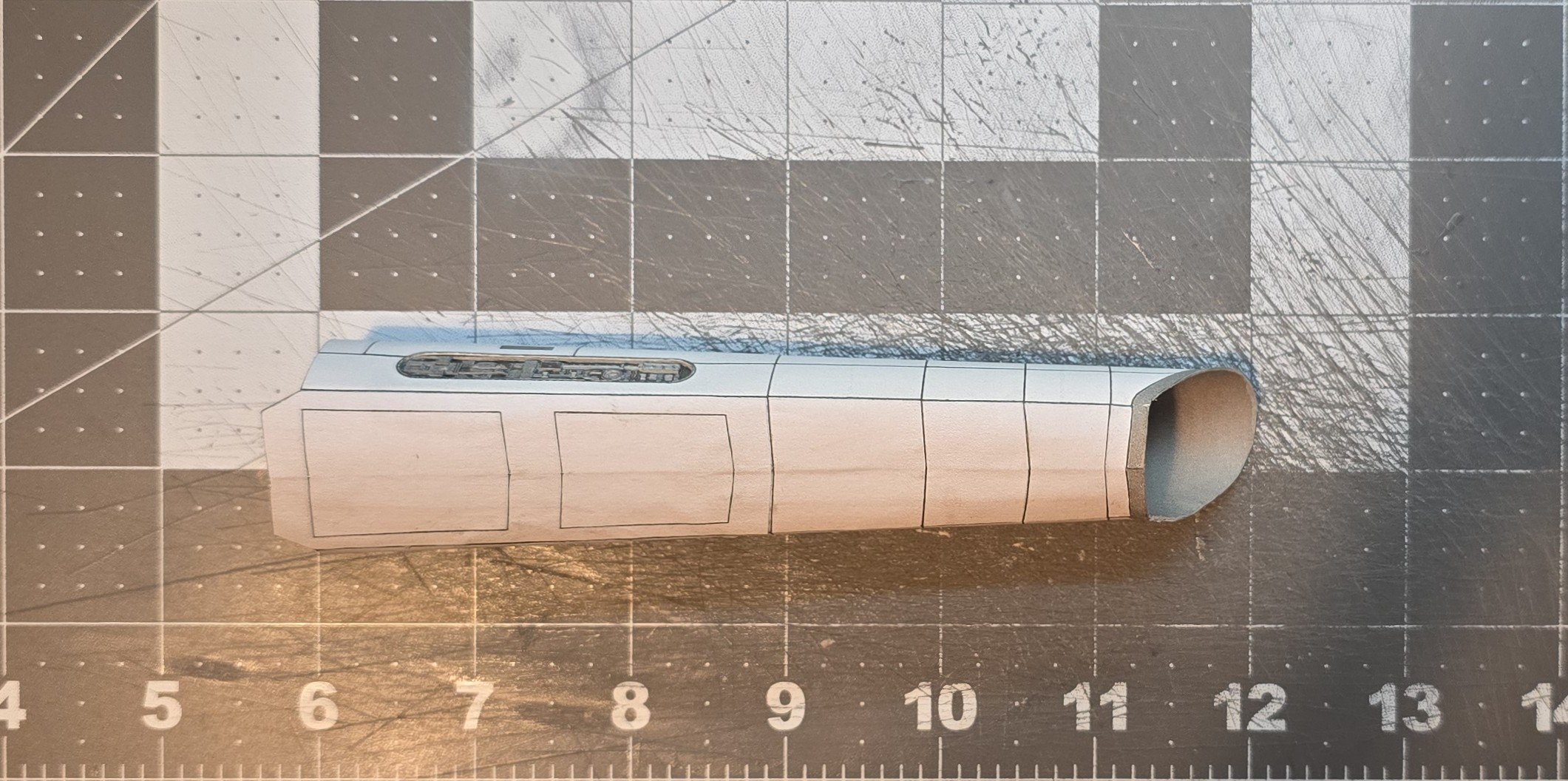

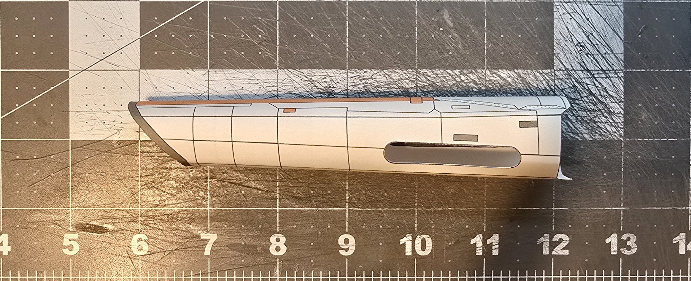

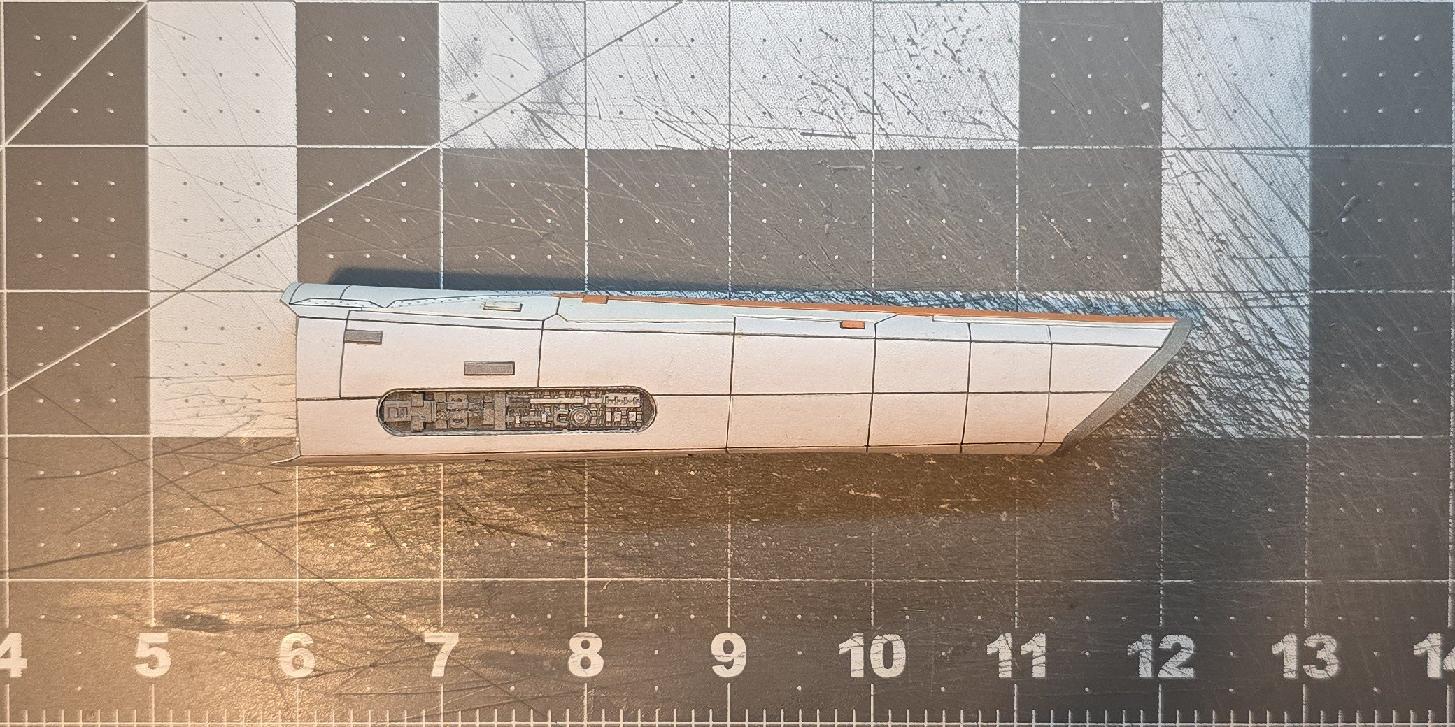

I have started to apply the panels (that were printed on regular printer paper.)
I raised the two smaller panels that are on the rear (main) panel.

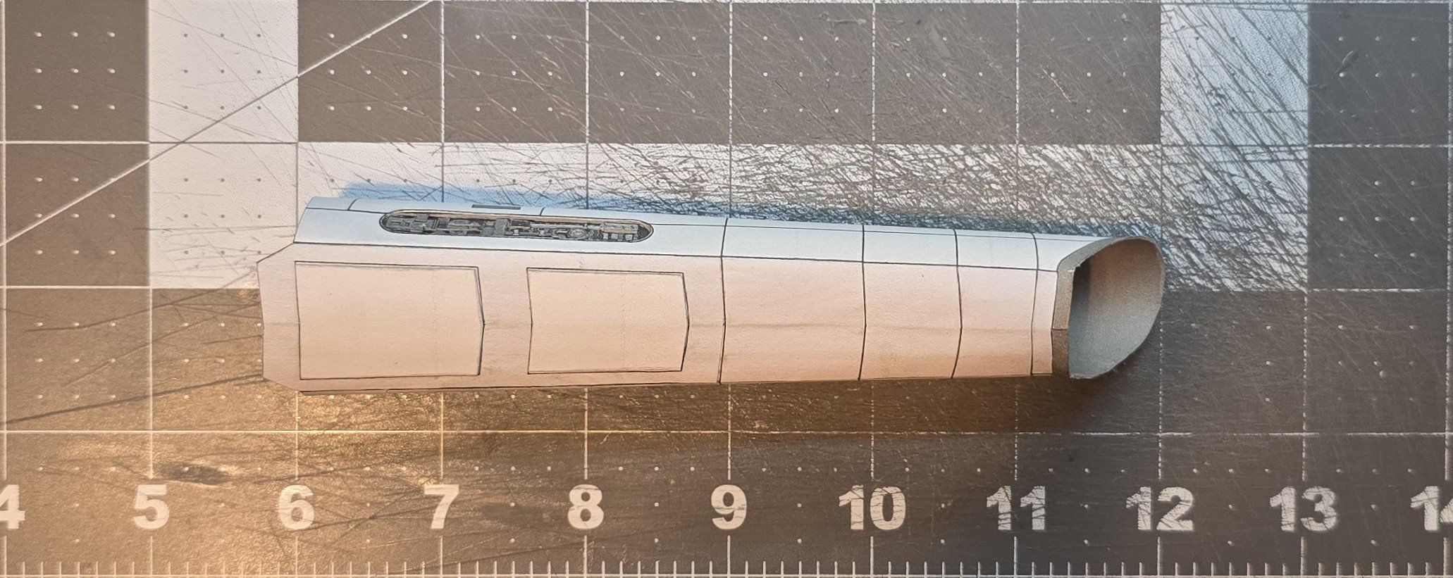

I continued to apply the panels (that were printed on regular printer paper.).

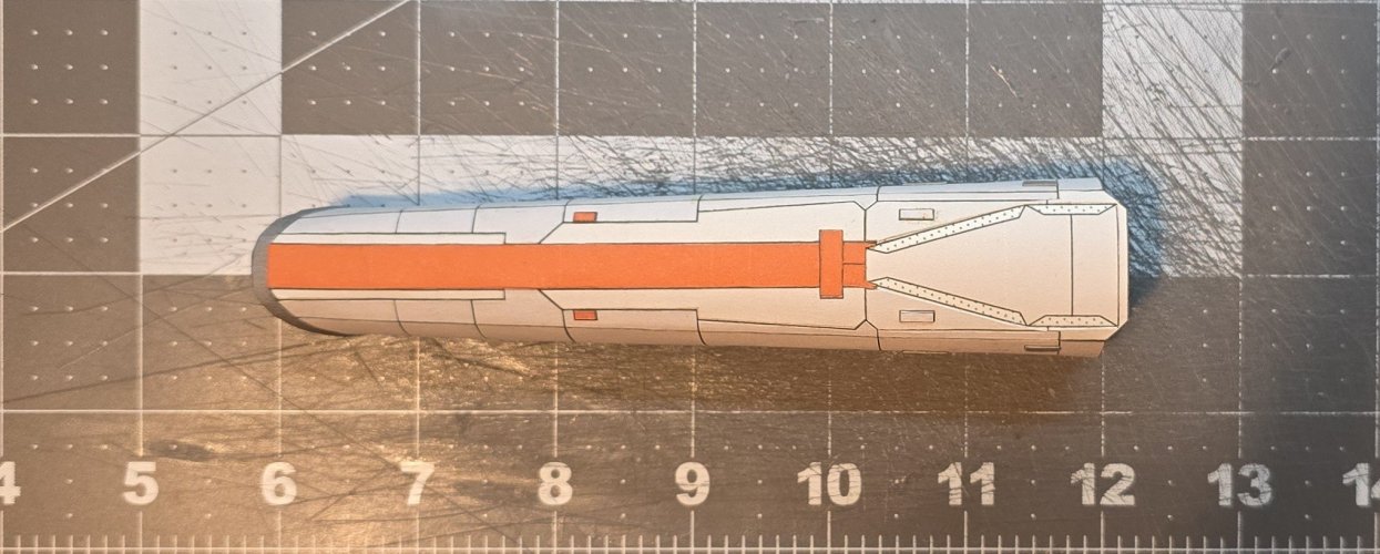

The other side is now complete.

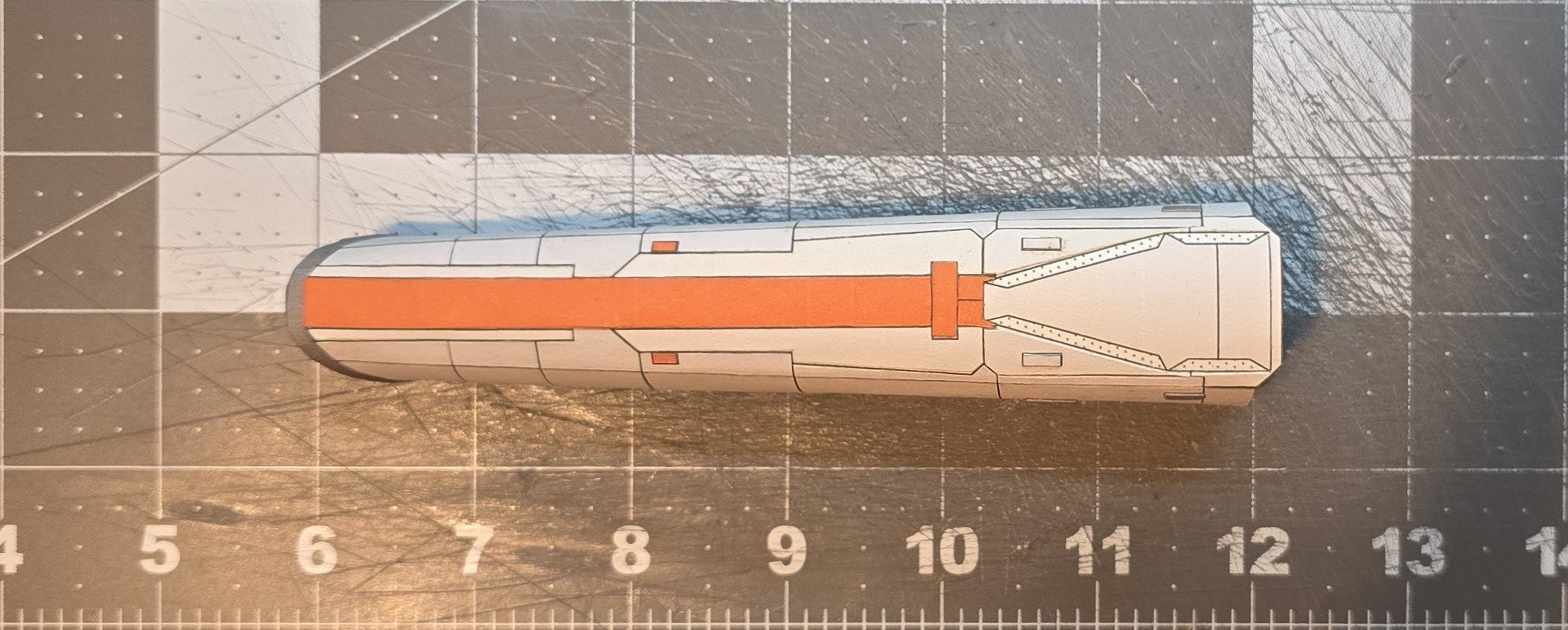

The top section is complete.

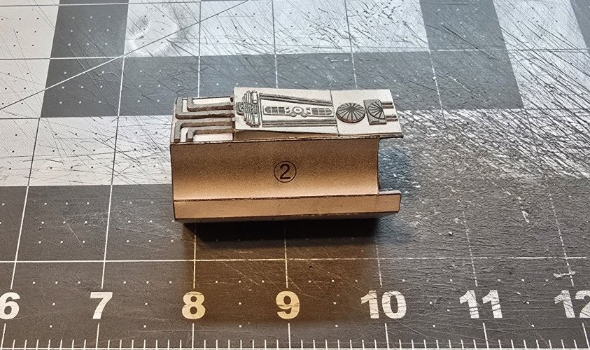

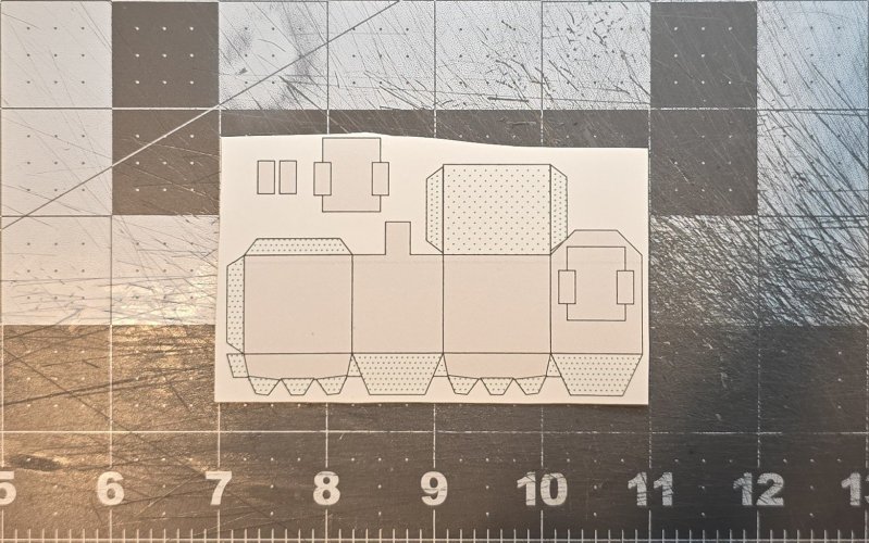

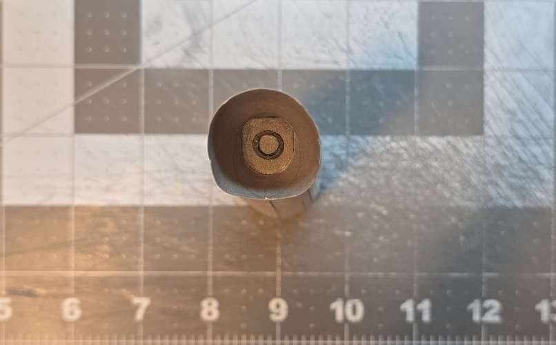

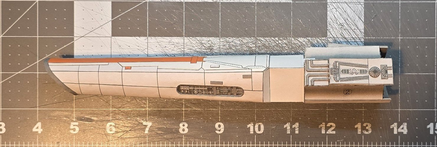

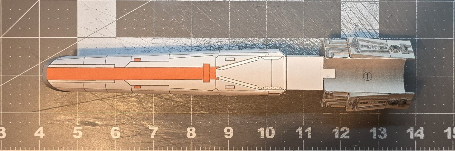

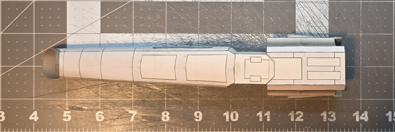

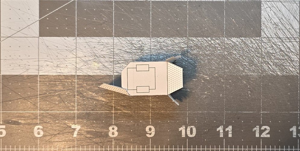

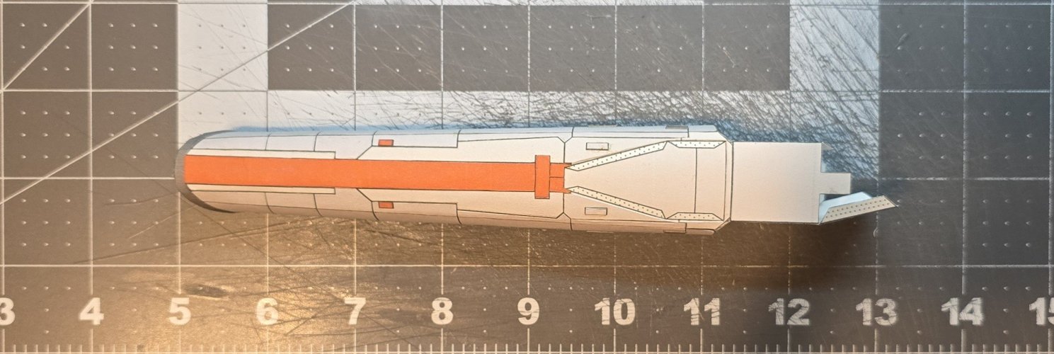

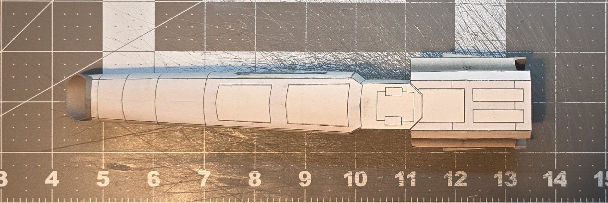

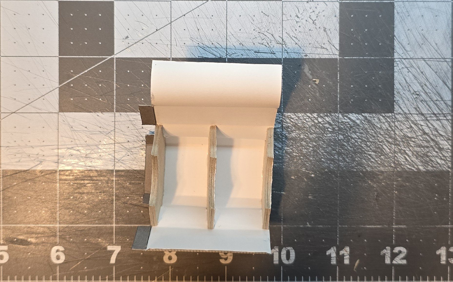

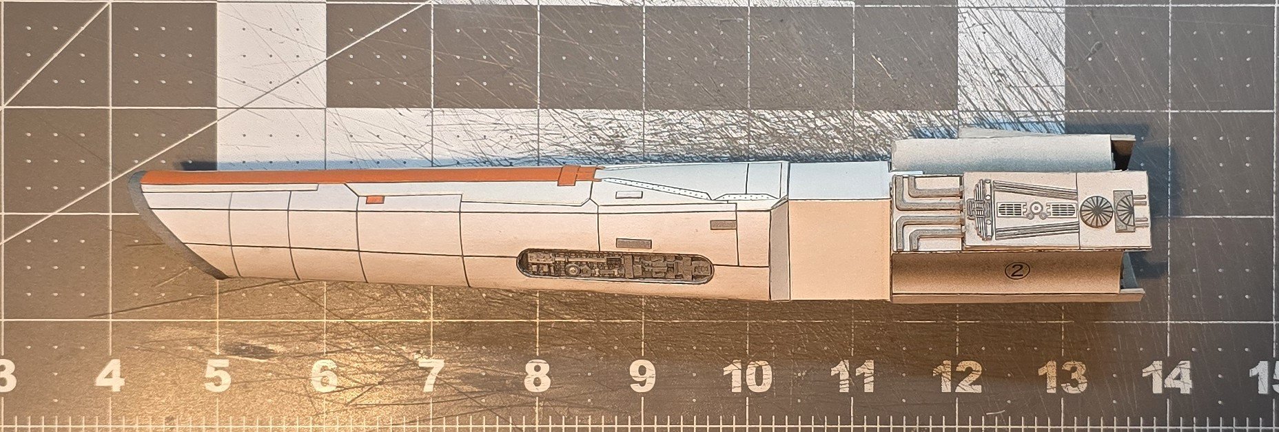

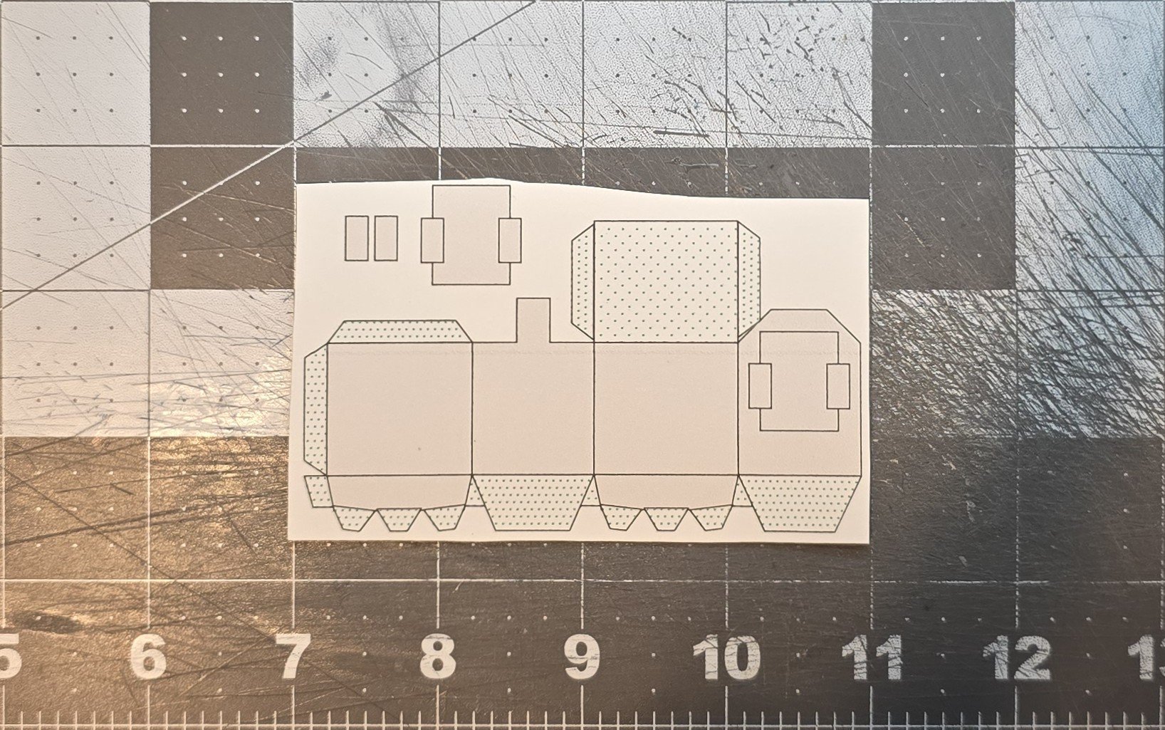

This is the box that connects the fuselage and engine mounting block together.

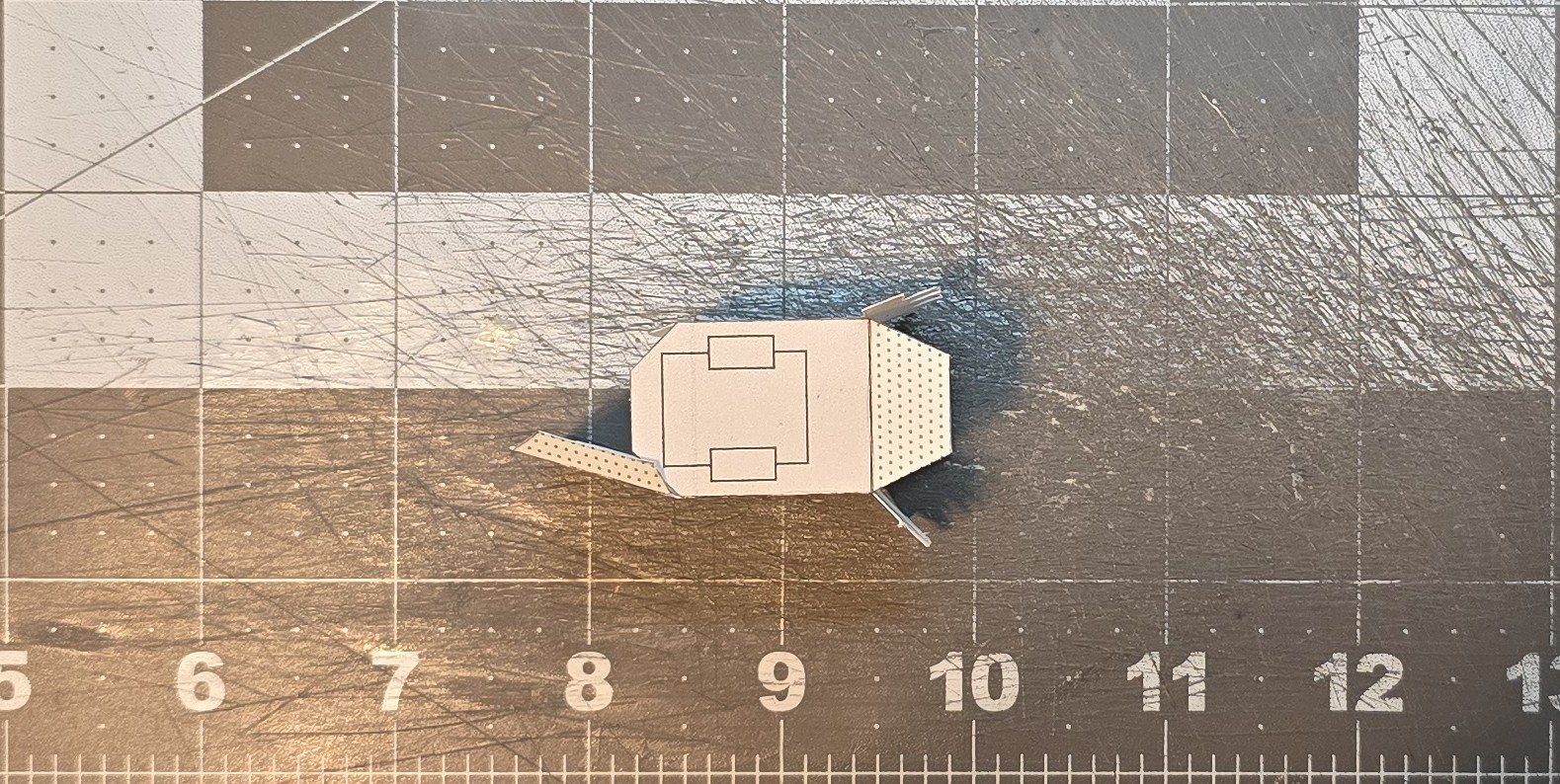

I assemble the box (but do not close it up yet).
I attached the box to the fuselage.
I closed the box.

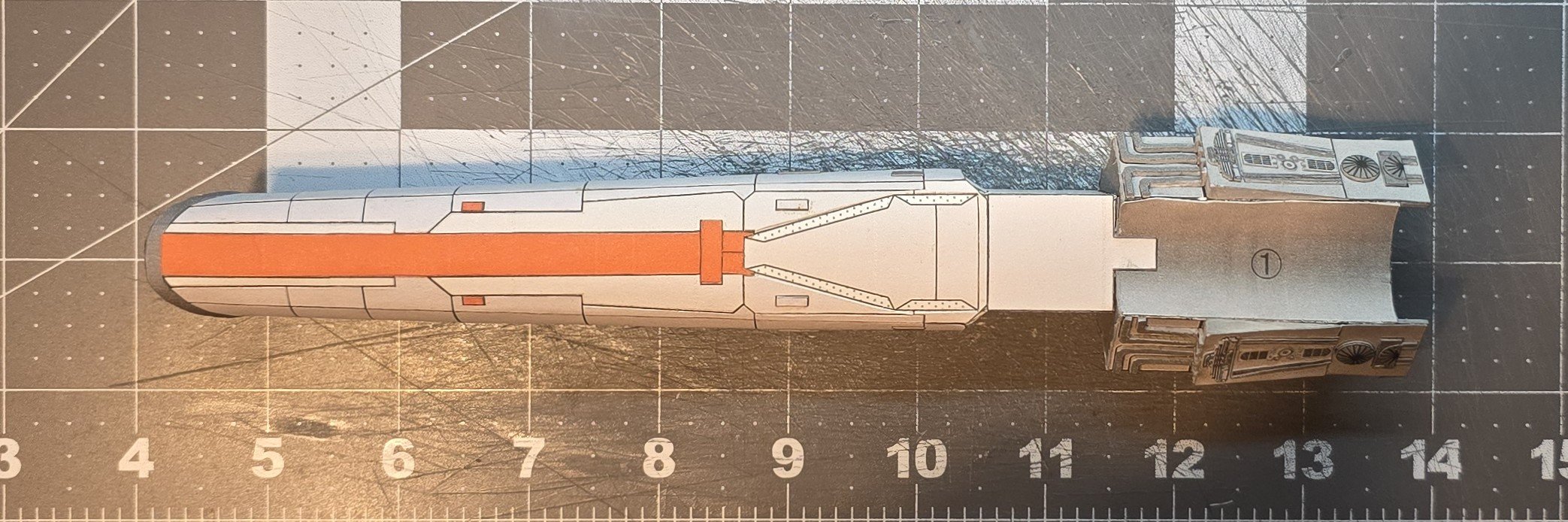

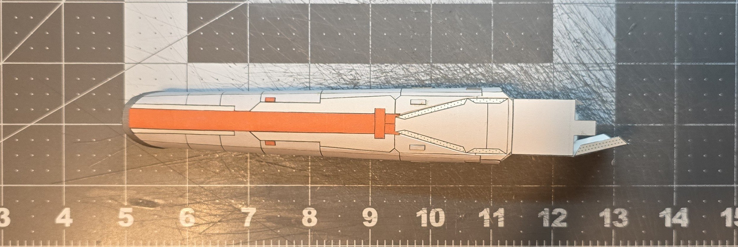

I attached the engine mounting block to the box.
Please stay tuned in to your local Colonial Broadcast Network for further updates and they happen.
