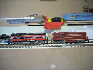

I have a proto 2k GP-7.with sound and going through the manual that came with it plus the 255 page manual from walthers.com. there is no C.V to do what you need my prodigy when it shorts the sound quits and the loco dies till the short is cleared
