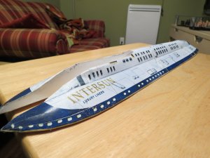

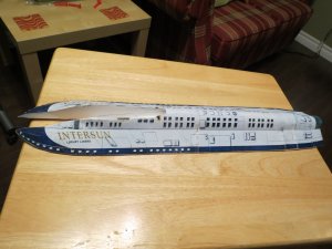

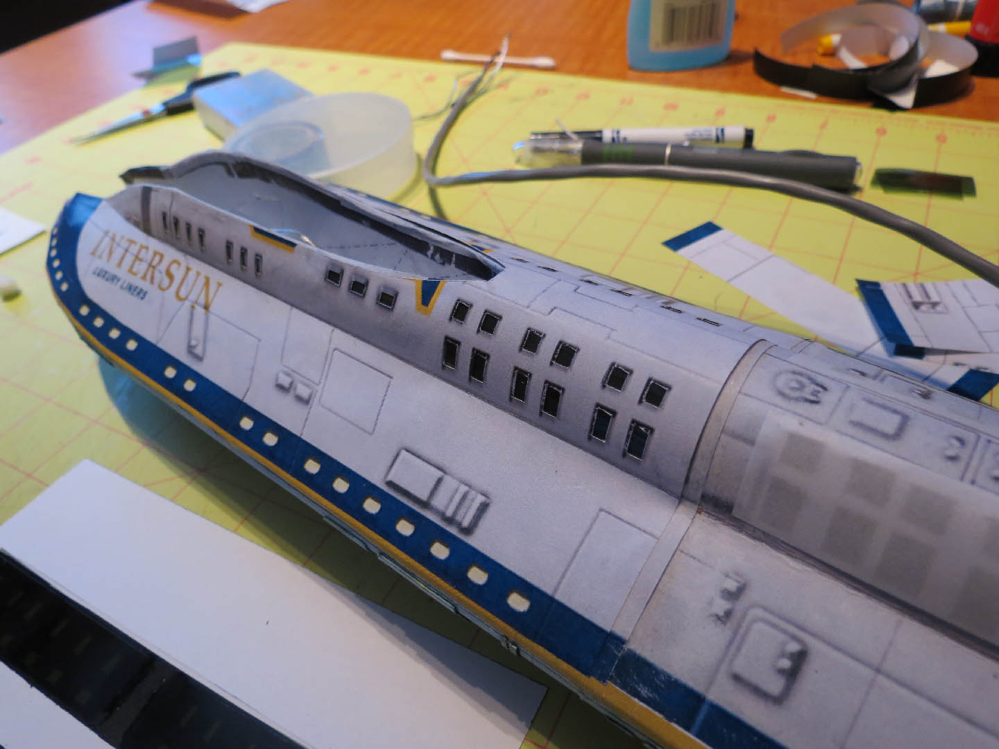

I folks,
All my summer project being completed, I can now return on this project.

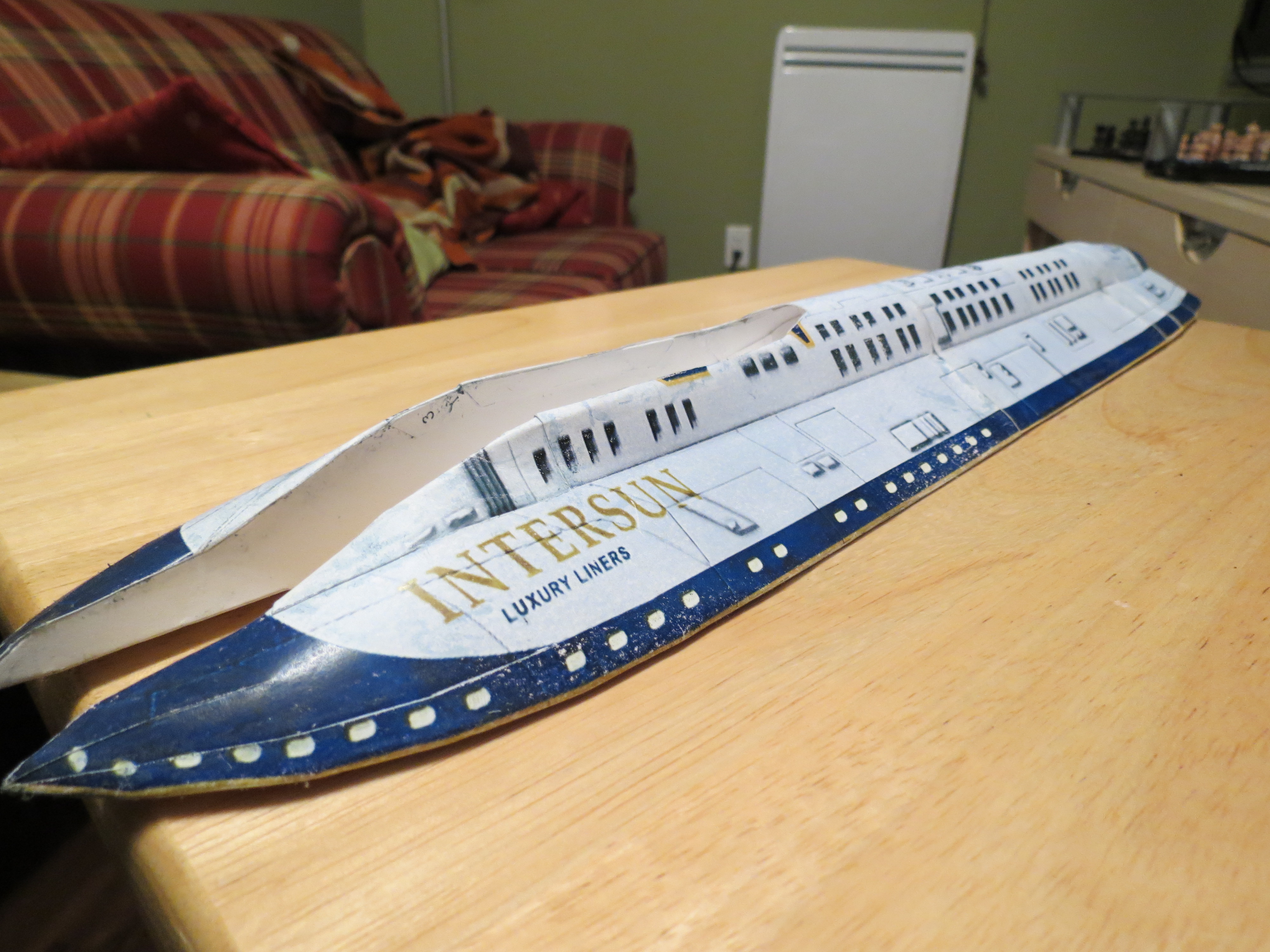

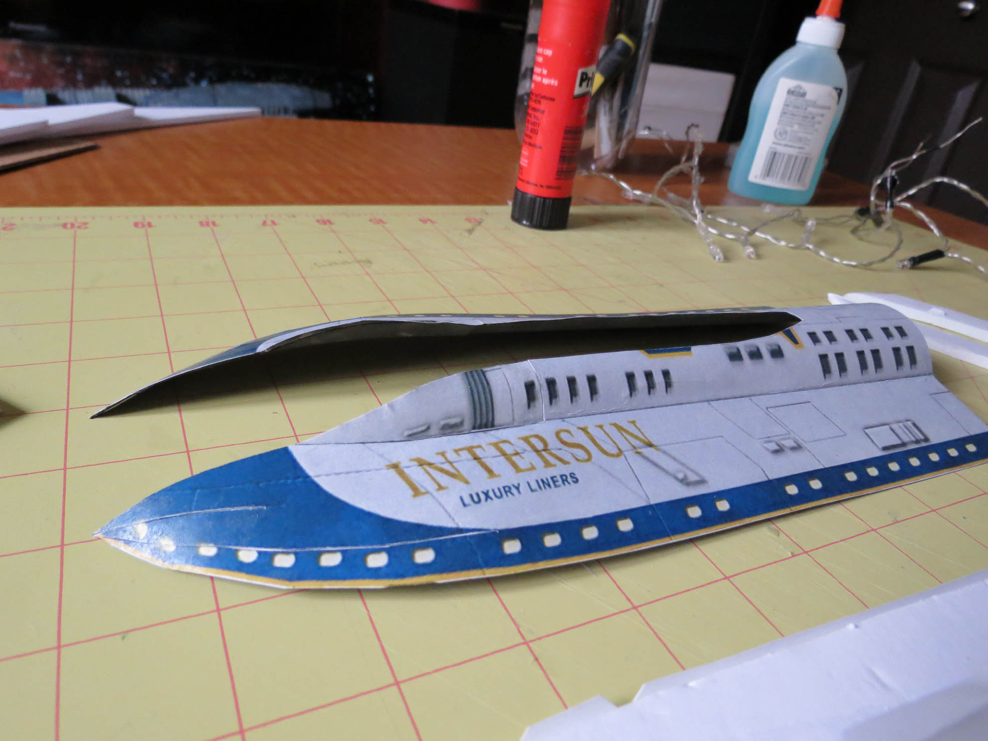

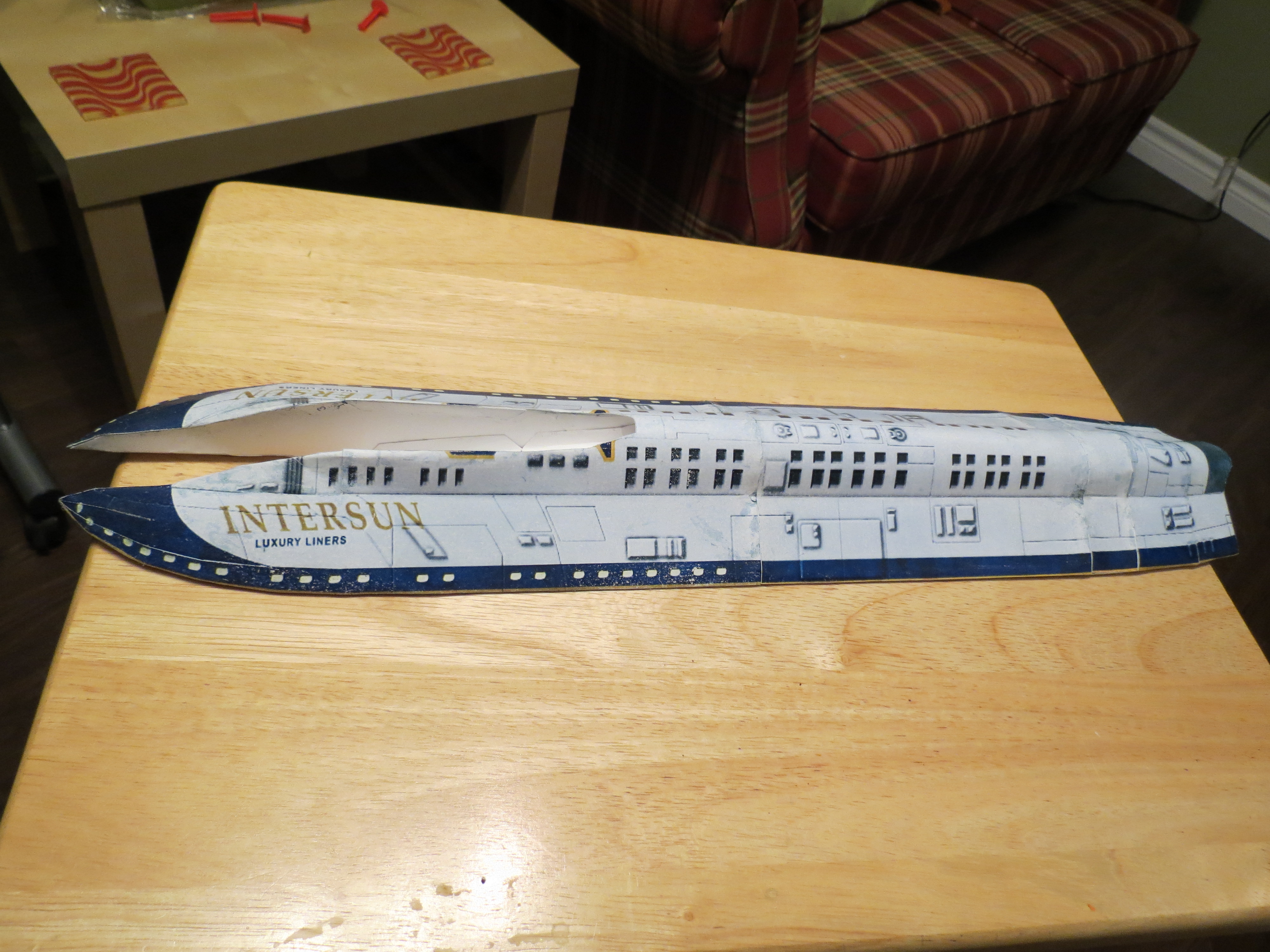

I build a quick ''upper hull'' to help me to have a good overview for the final assembly and the wiring. Next step, cutting for the windows, lights and finishing.....and assembly.
I look forward to seeing the final result

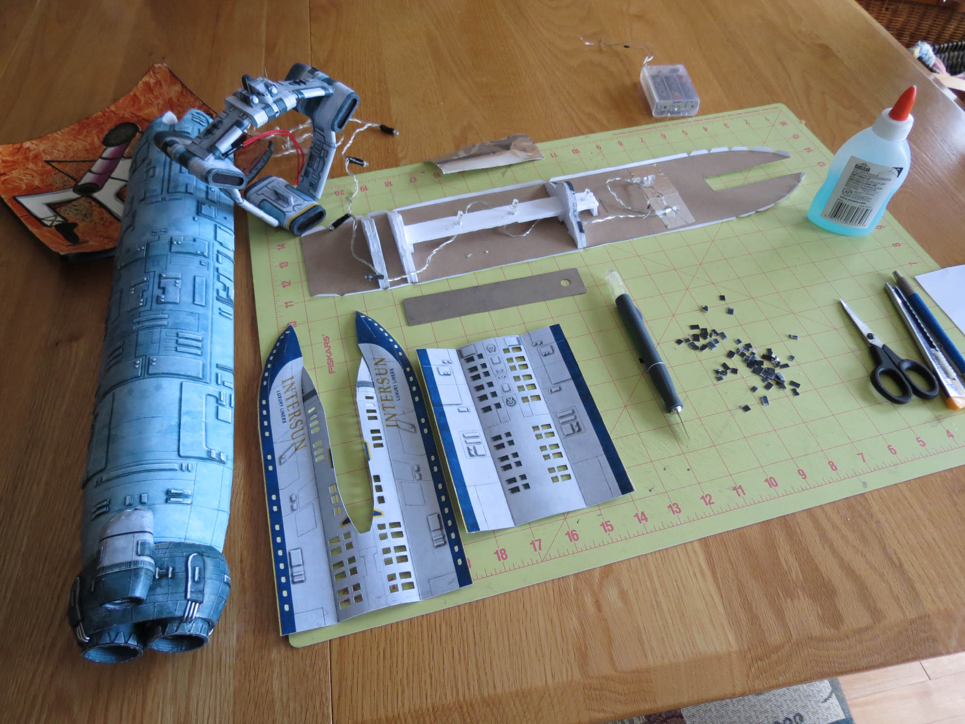

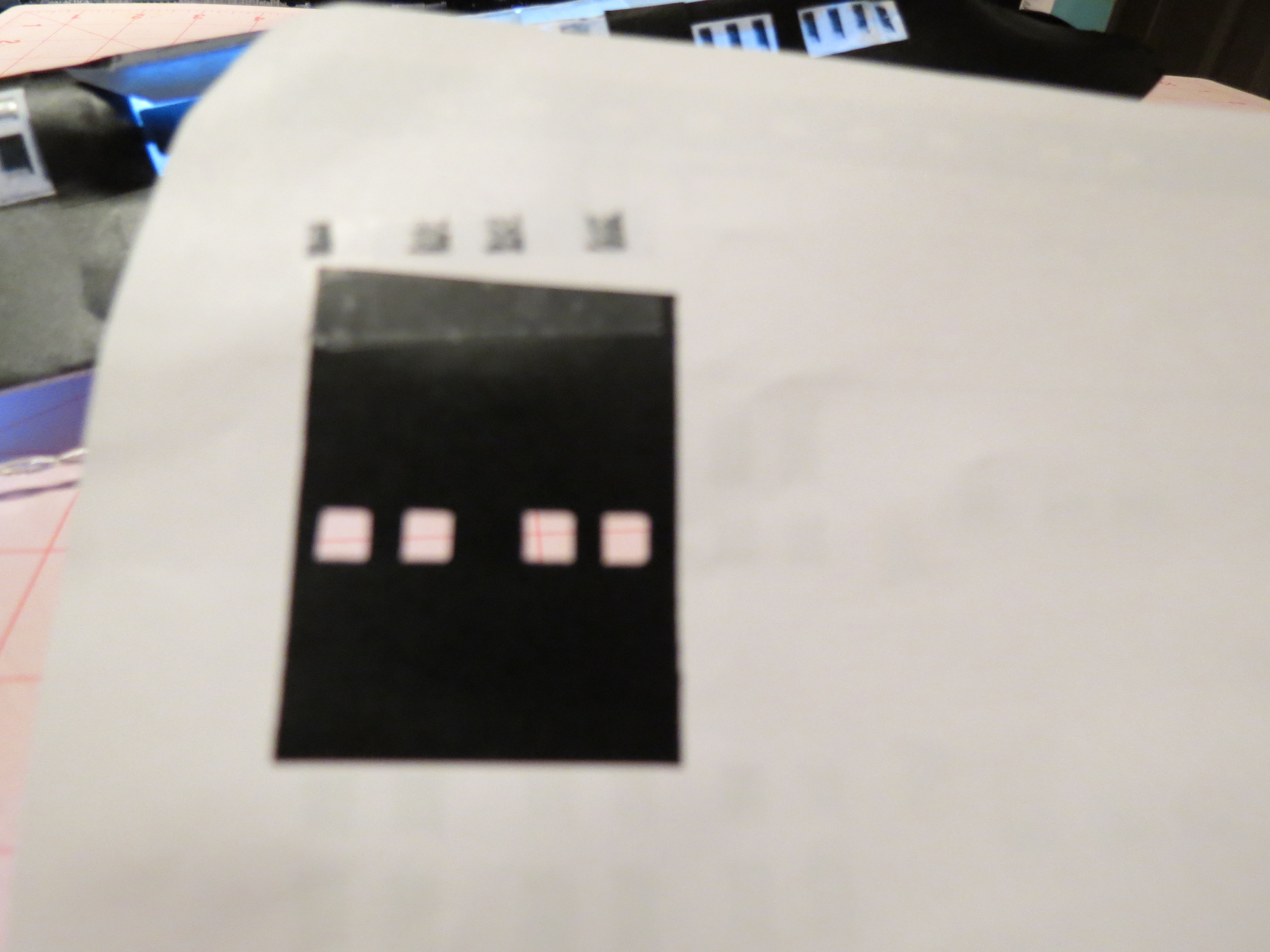

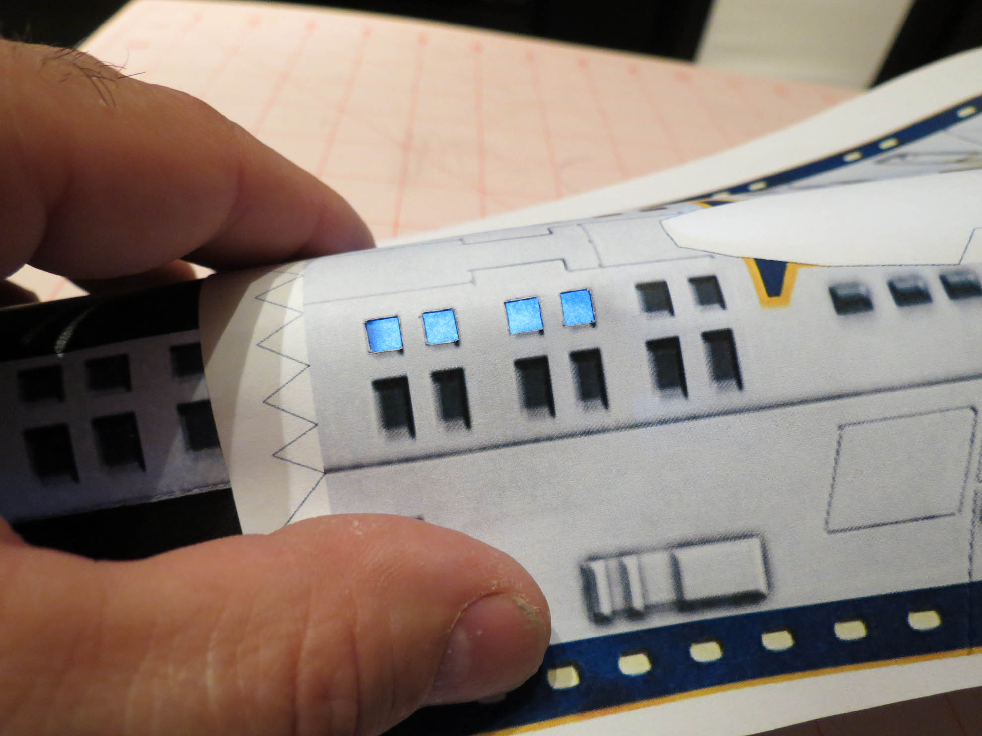

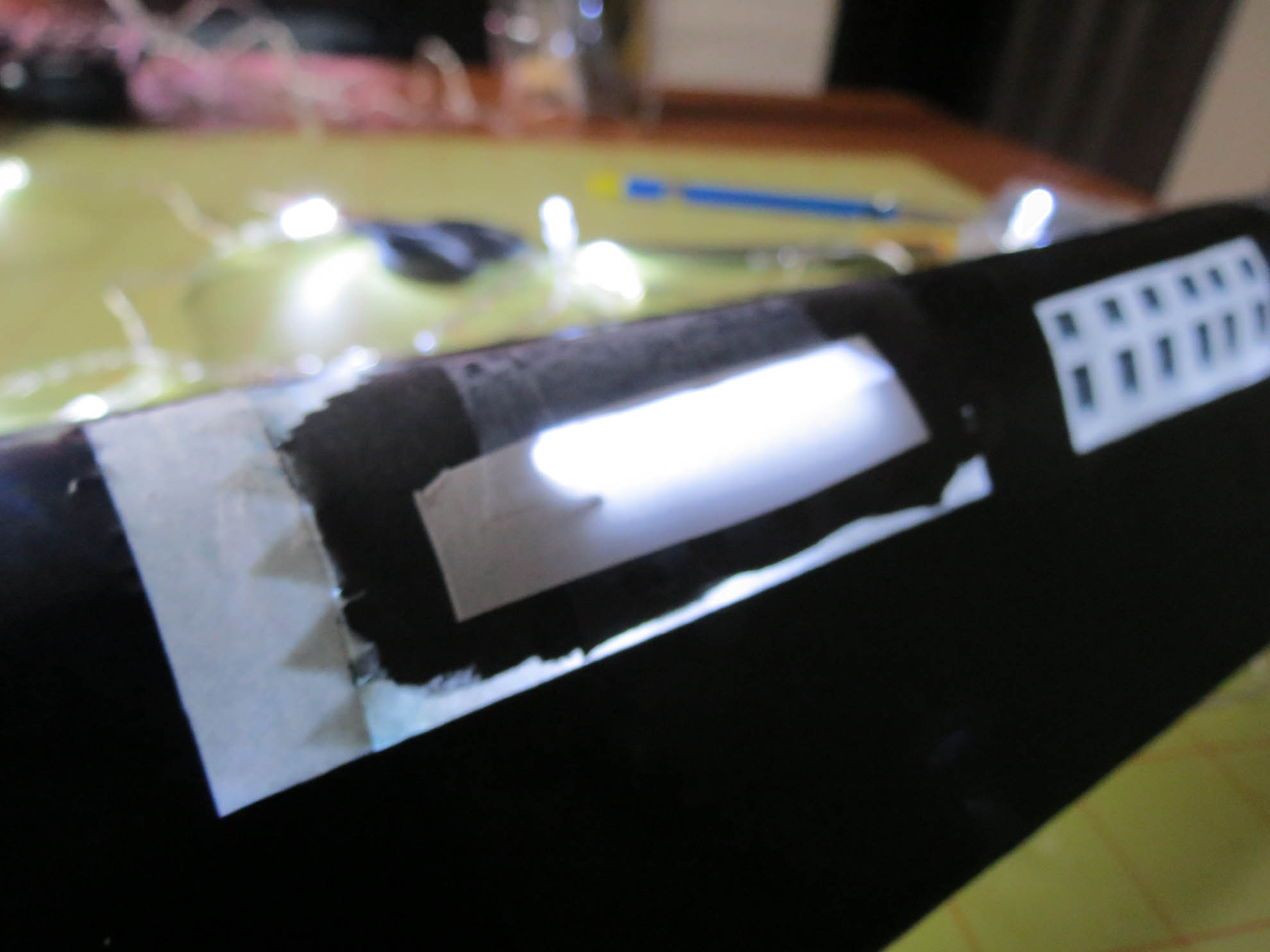

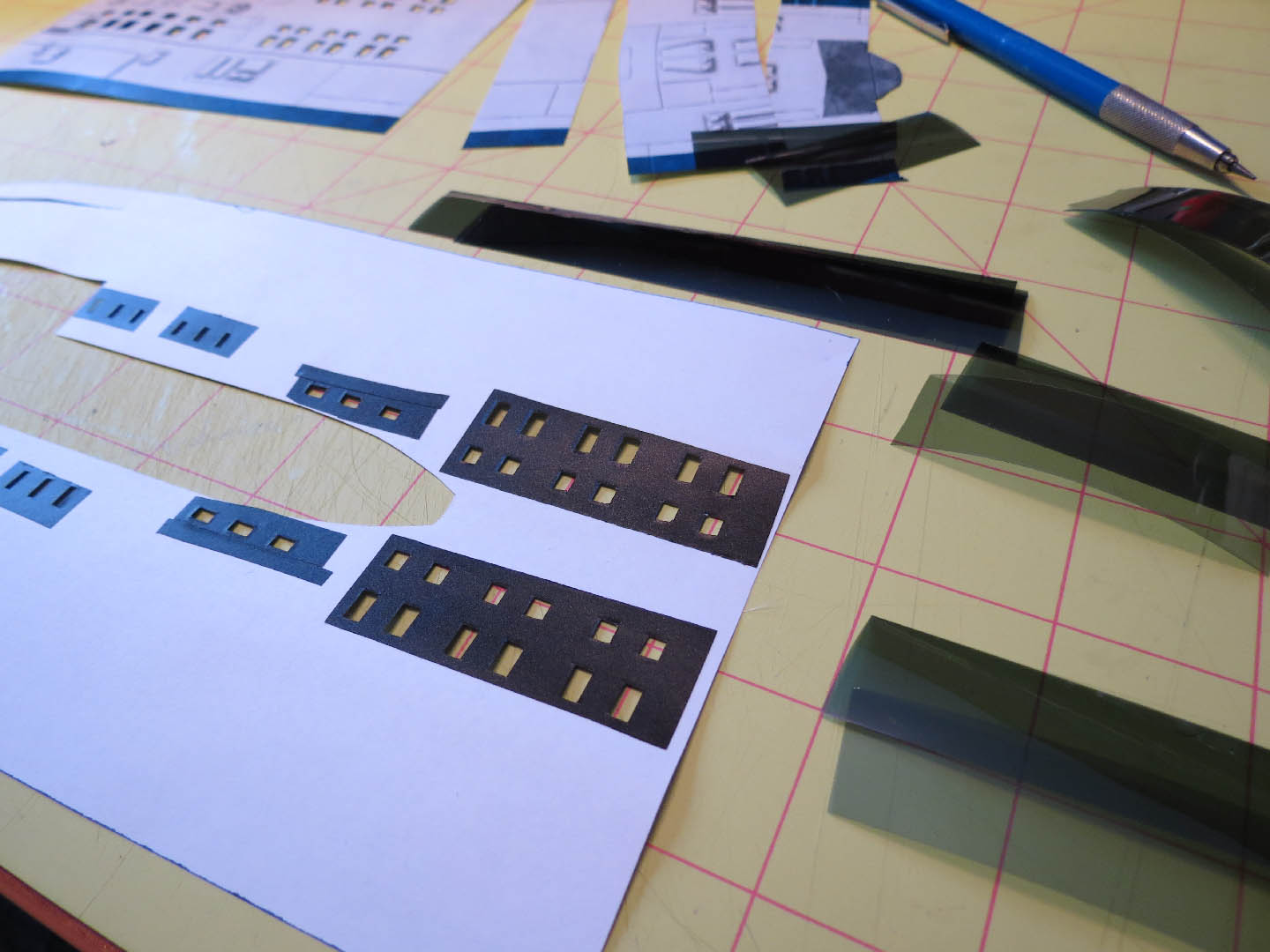

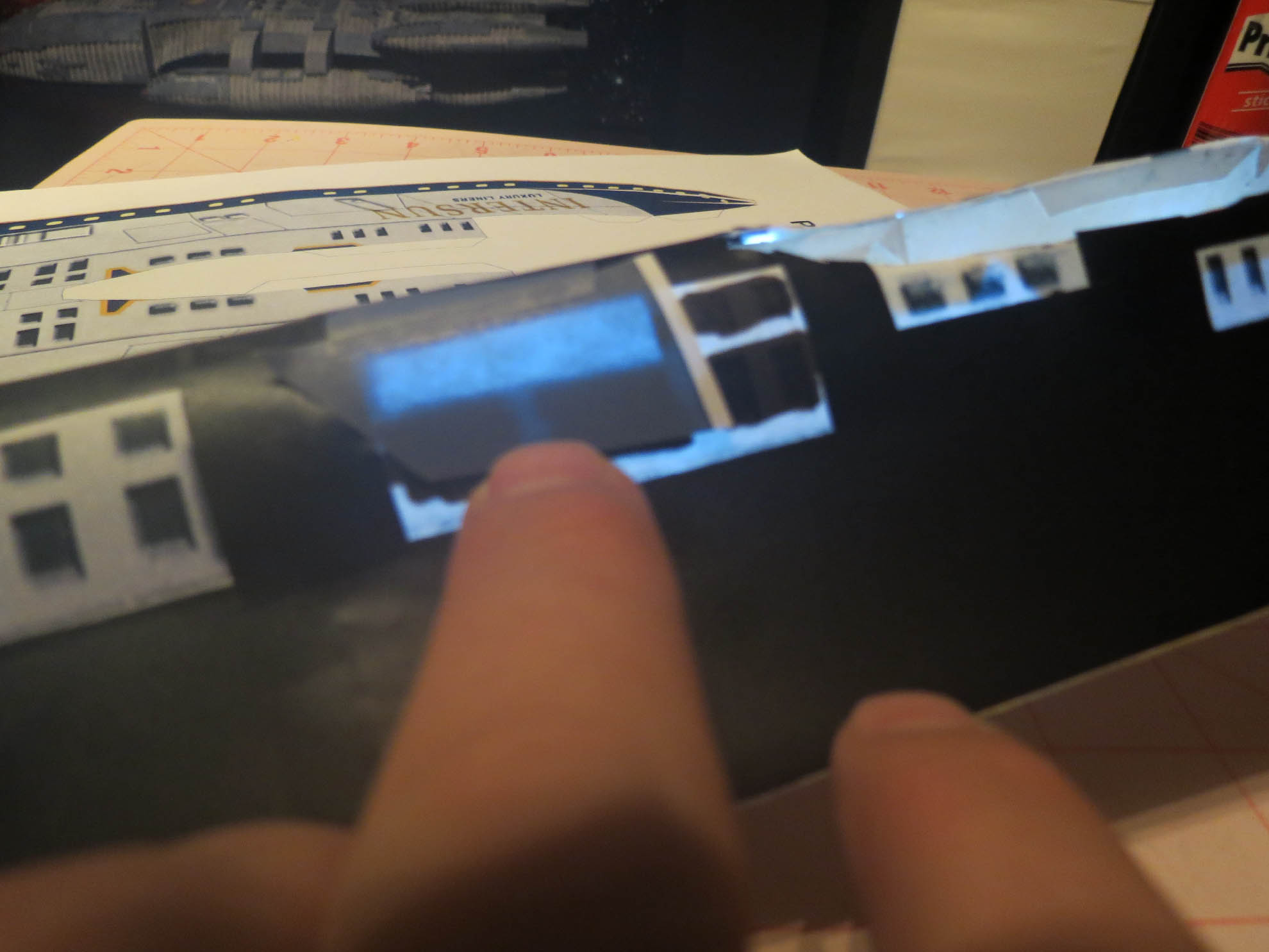

Some update,

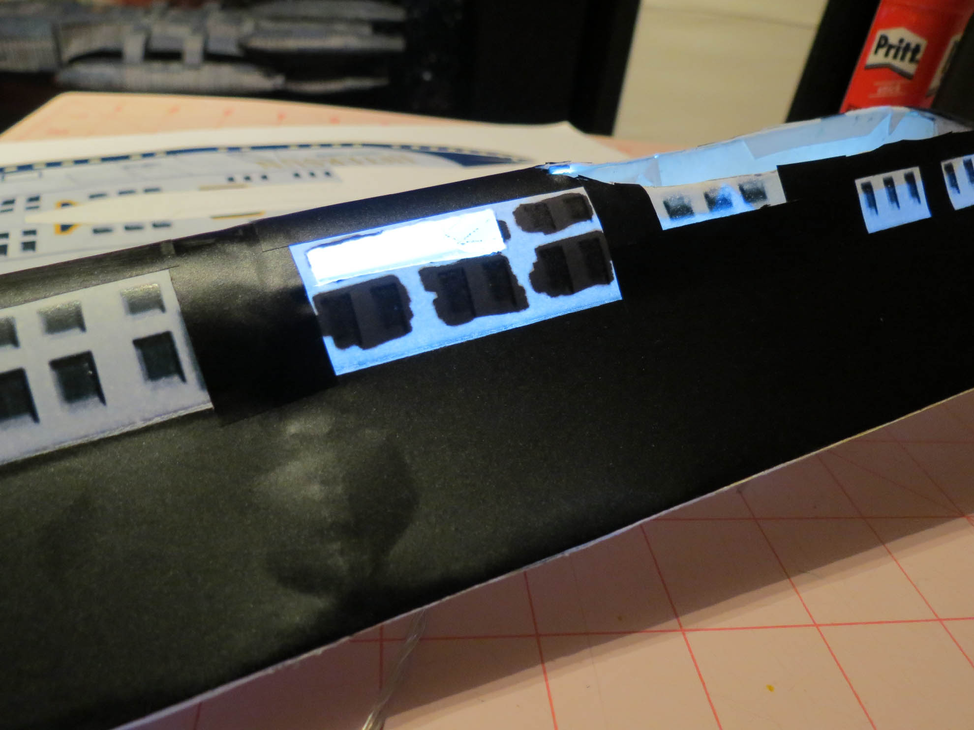

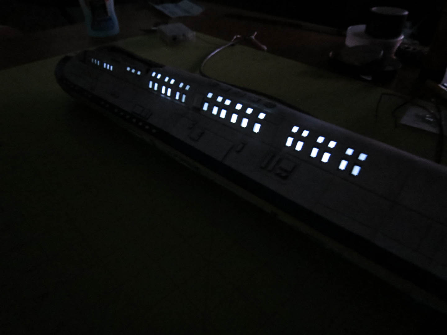

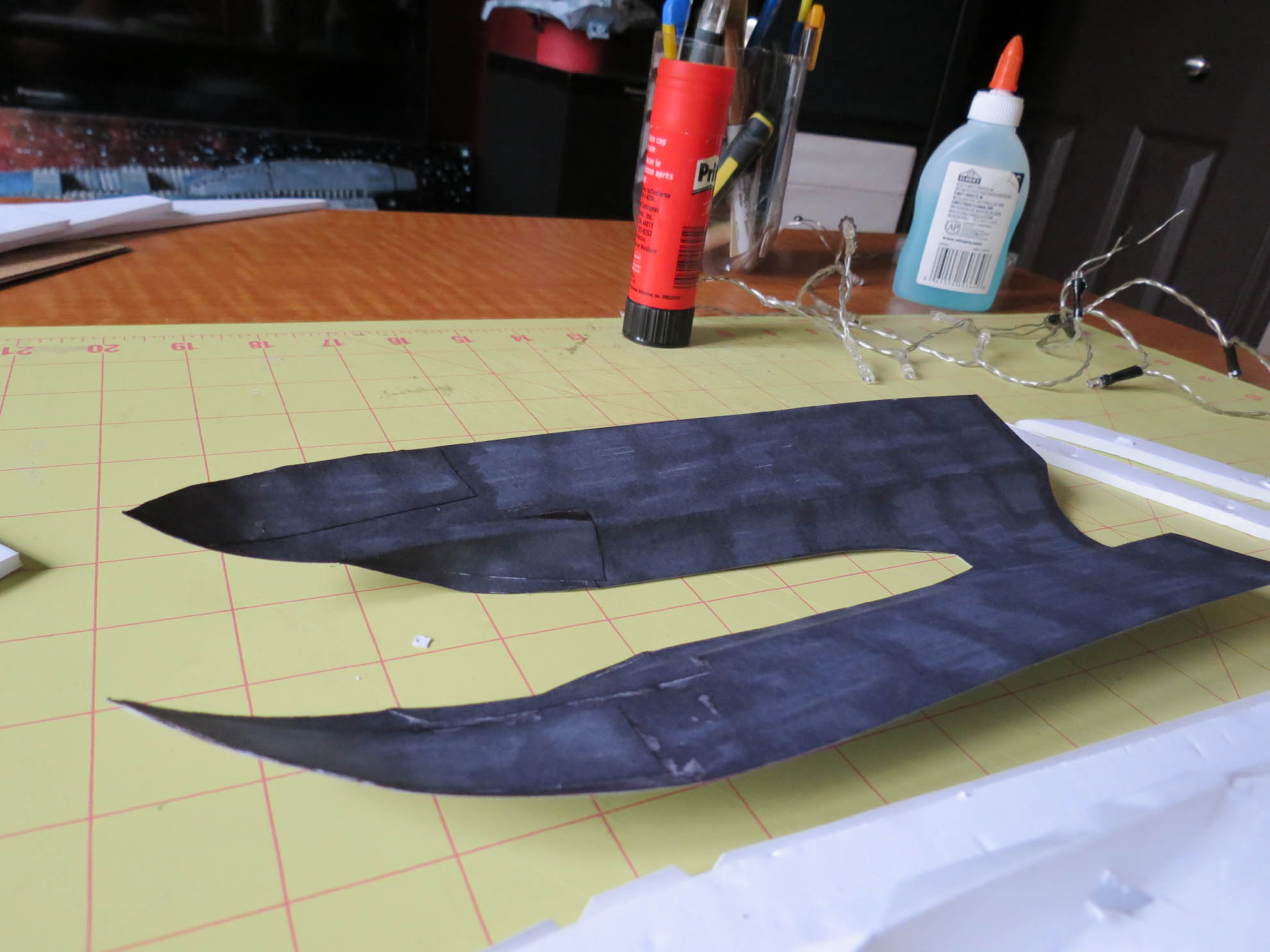

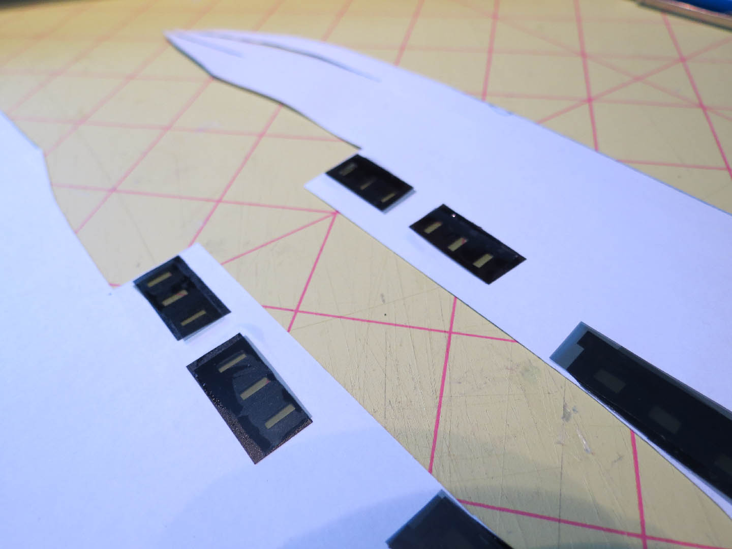

I take my quick build of the upper hull as a guide to help me find the best way for the lighting of the windows without crossing the paper.
First attempt, I put a layer of black tape, cut off a piece around the windows on the first layer, applies a layer of gray paper (and white) and put the final layer with the Windows cut. Dont like it. So, I replace the black tape with a coated of black felt-ip pen. It work !
For the real upper hull, I print the front piece on a regular paper and stick it on a thicker cardboard than I beforehand coated with black felt-tip pen. I cut all the flaps and put a piece of paper in the back for the junction of the pièces. I help me to have a smooth surface. Next step, cuting the piece on the base.

That is ingenious! I'd love to see that tip and a few step by step pics in the tutorial section. You could have saved some work by attaching some black paper instead of using the felt-tip. ;)

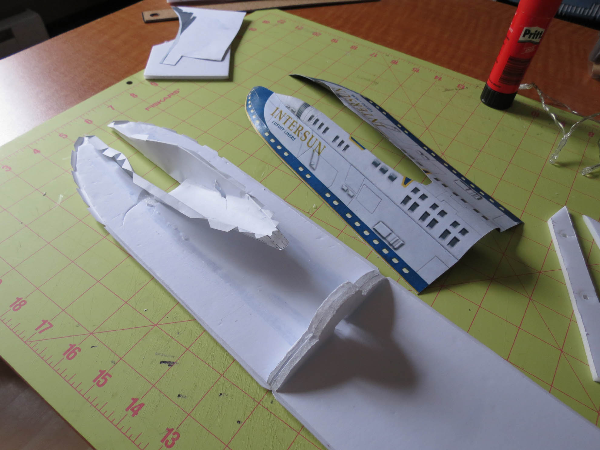

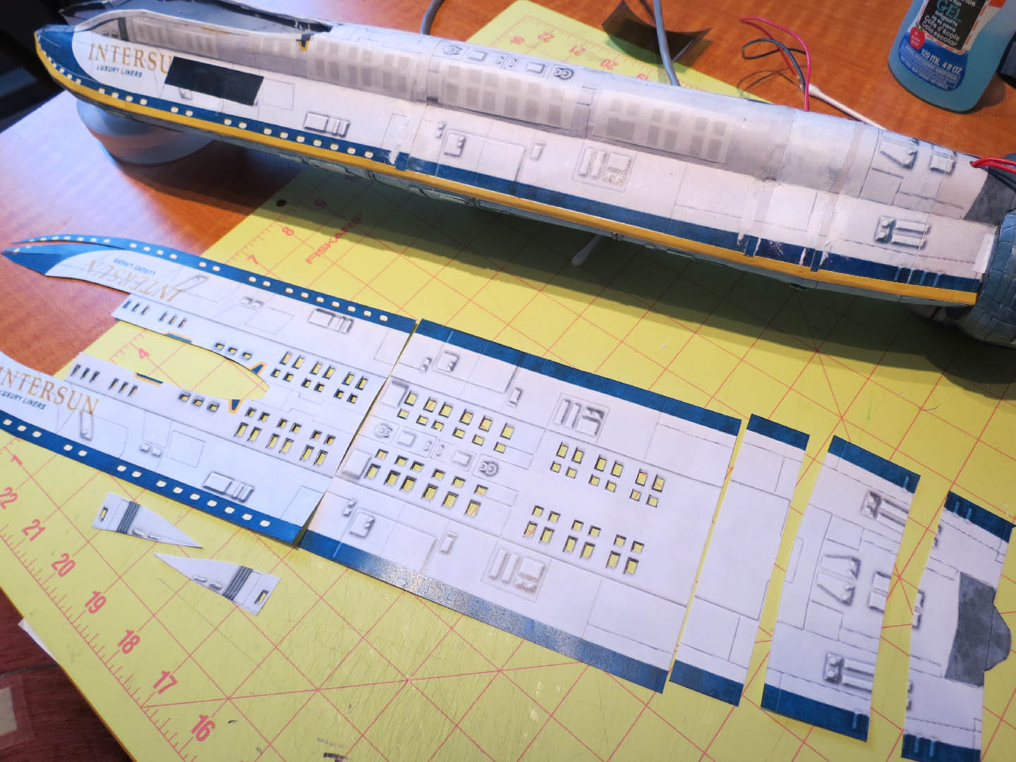

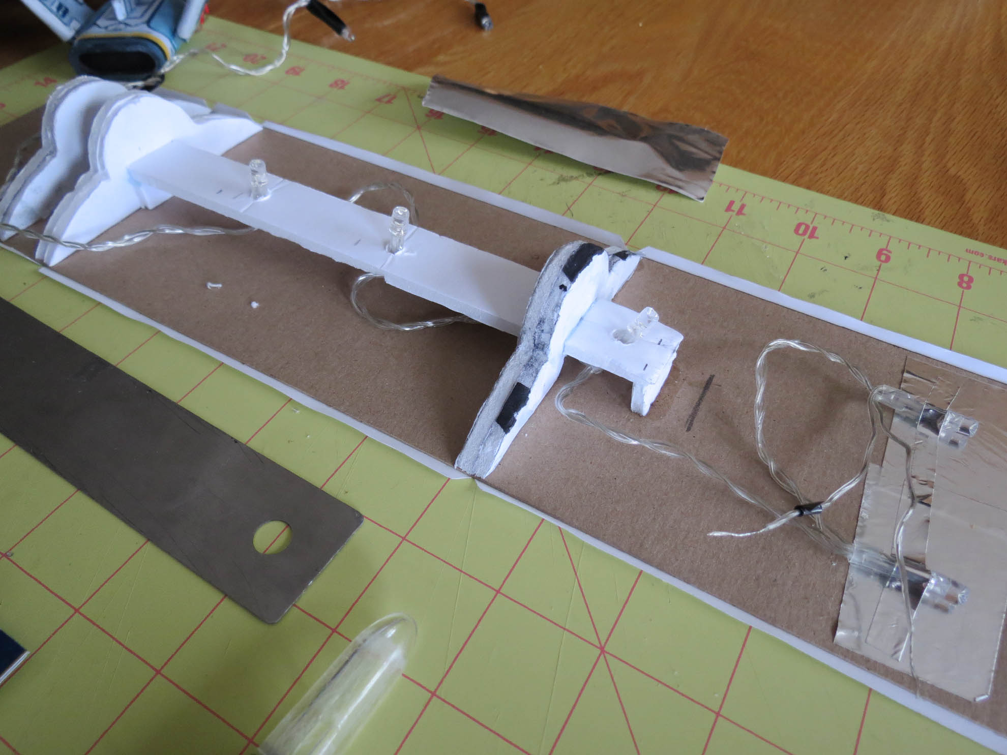

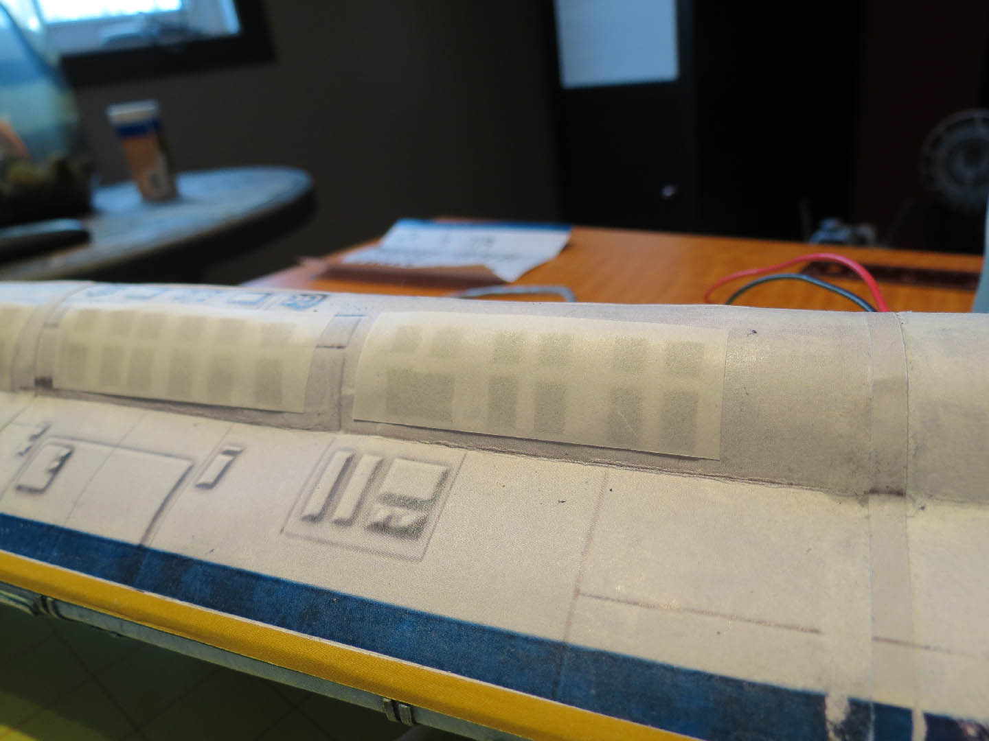

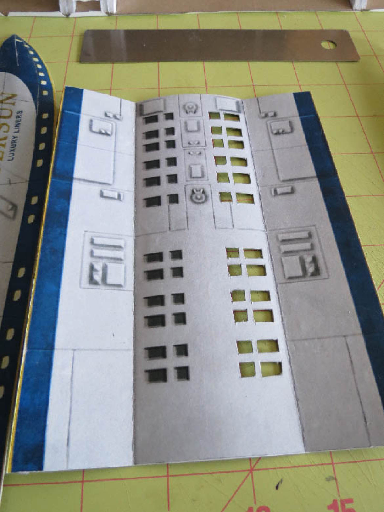

I've been doing some work on the model this weekend. I stat over the upper hull cause the thickness of the base is too thick and don't like the result (I had thought that it was a good idea). I've put a card board insted of a 3/16'' foam core. The result will be more like the model on TV.
I cut the holes for the windows on the first layer of parts 3 and 4. In the next post I will show how I assemble materials for the final result of the windows.

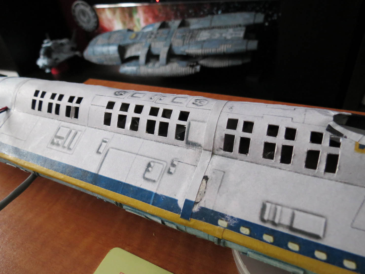

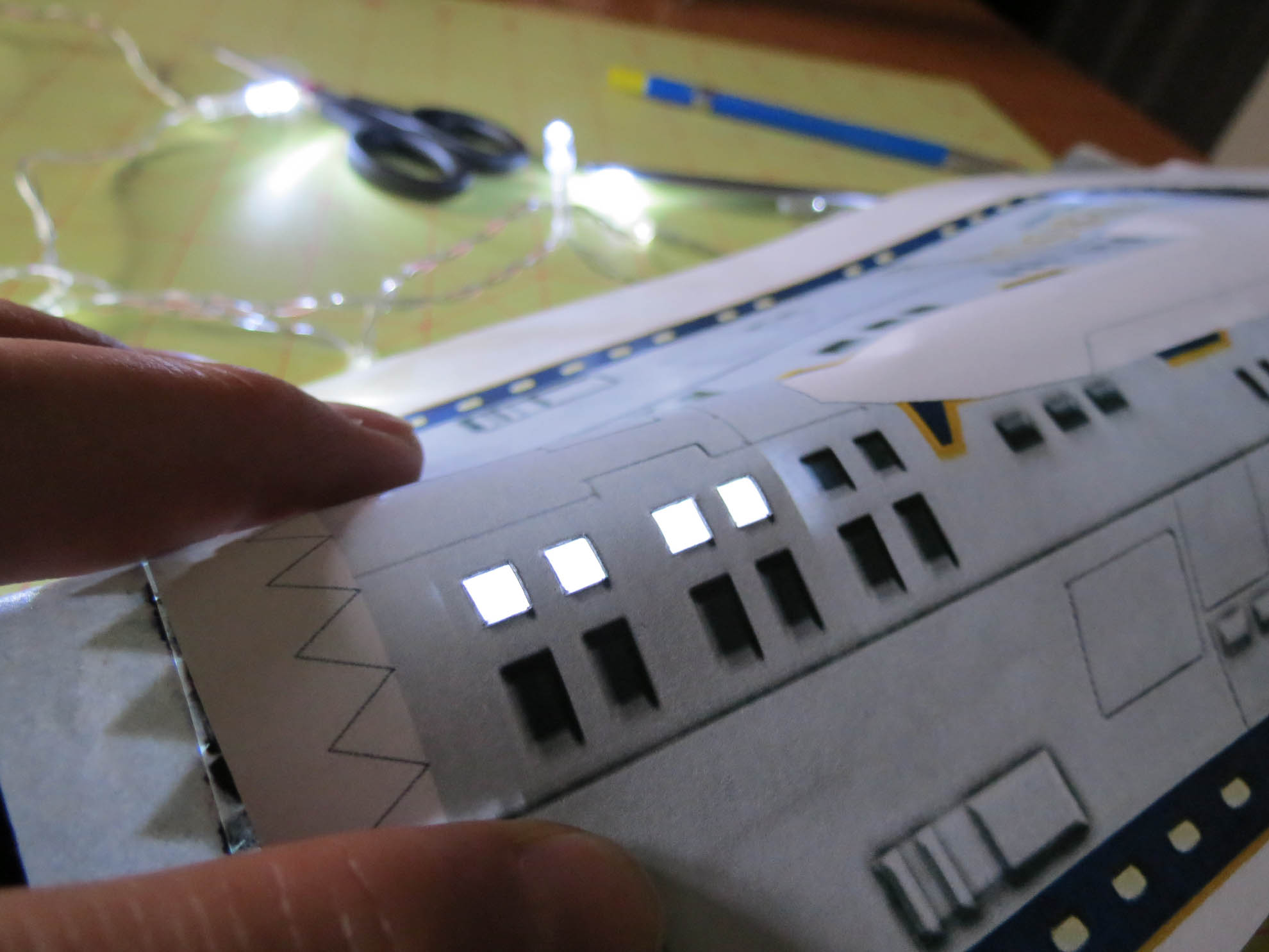

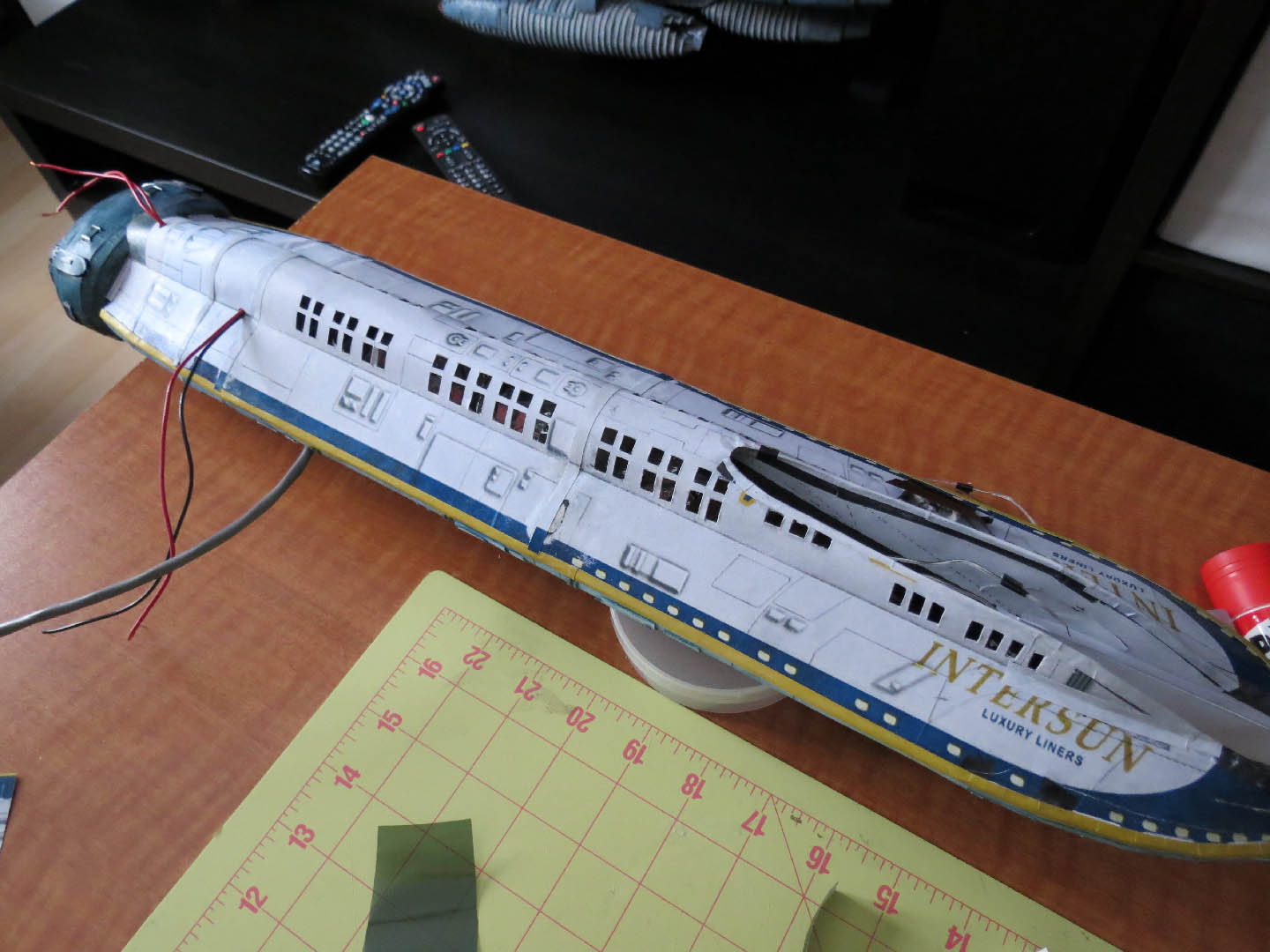

Start some final sticking and wiring to assure me that all is correct. It will be very sad if the lights dont switch on after all the parts glued together.

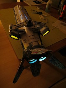

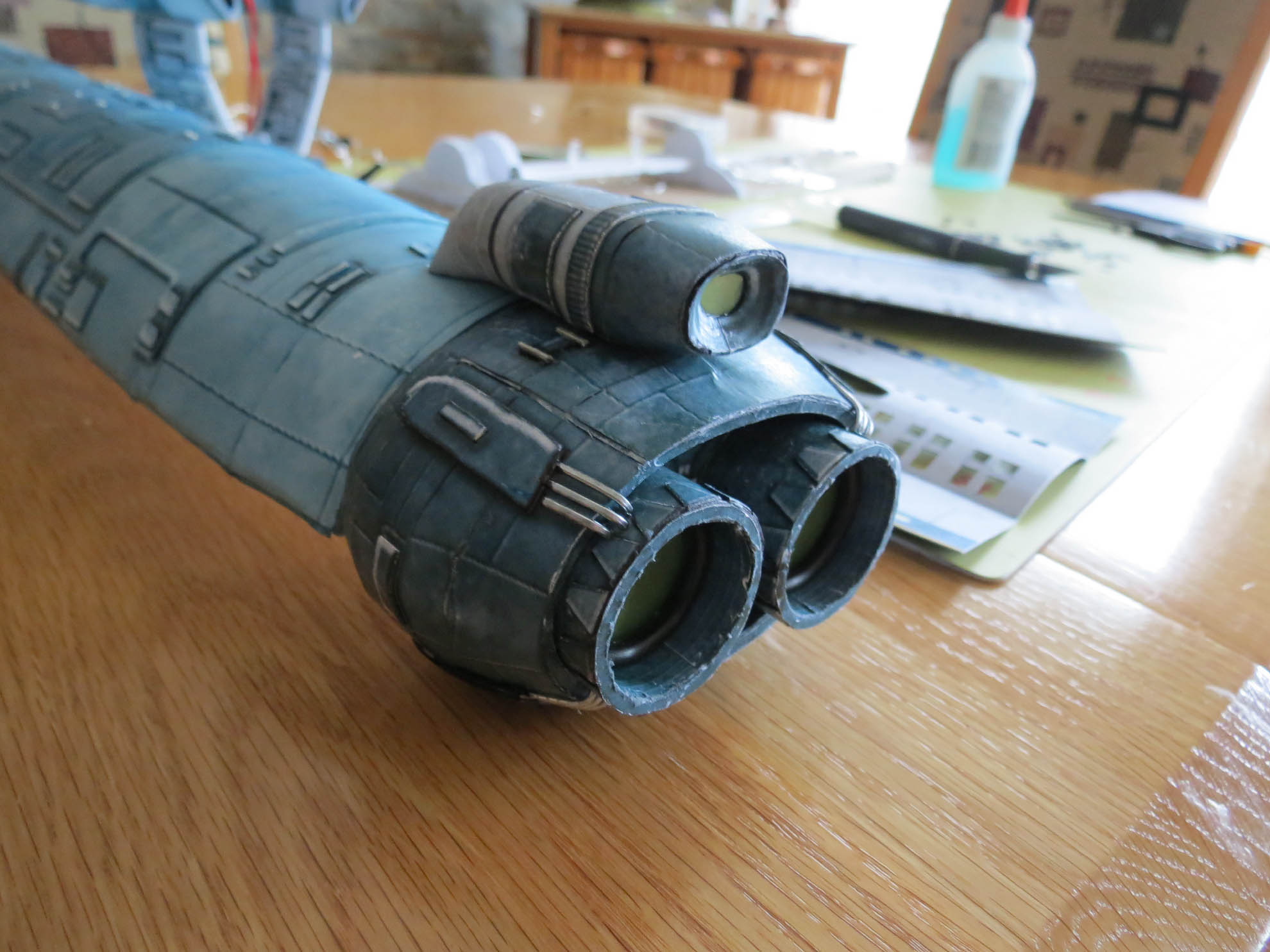

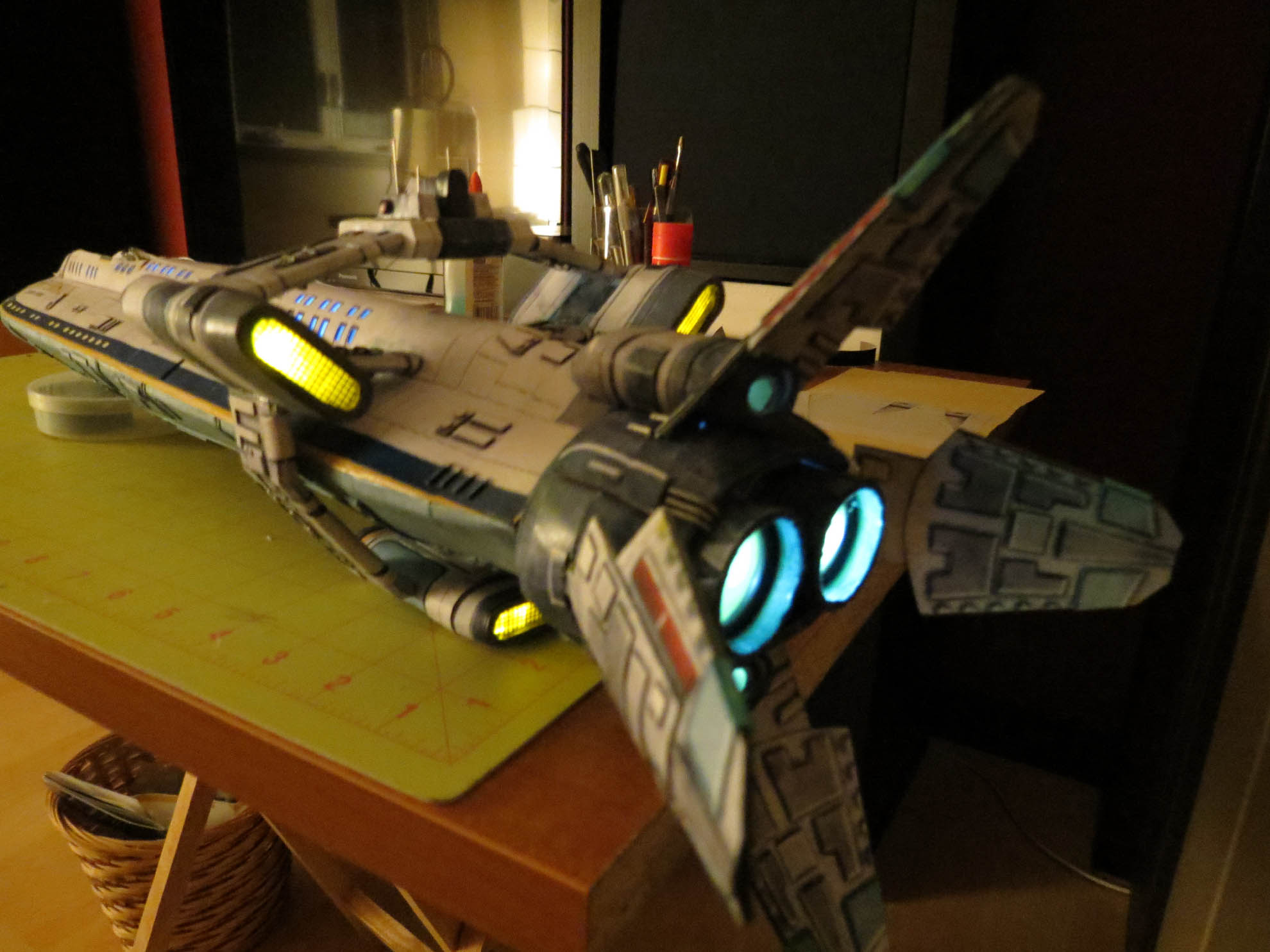

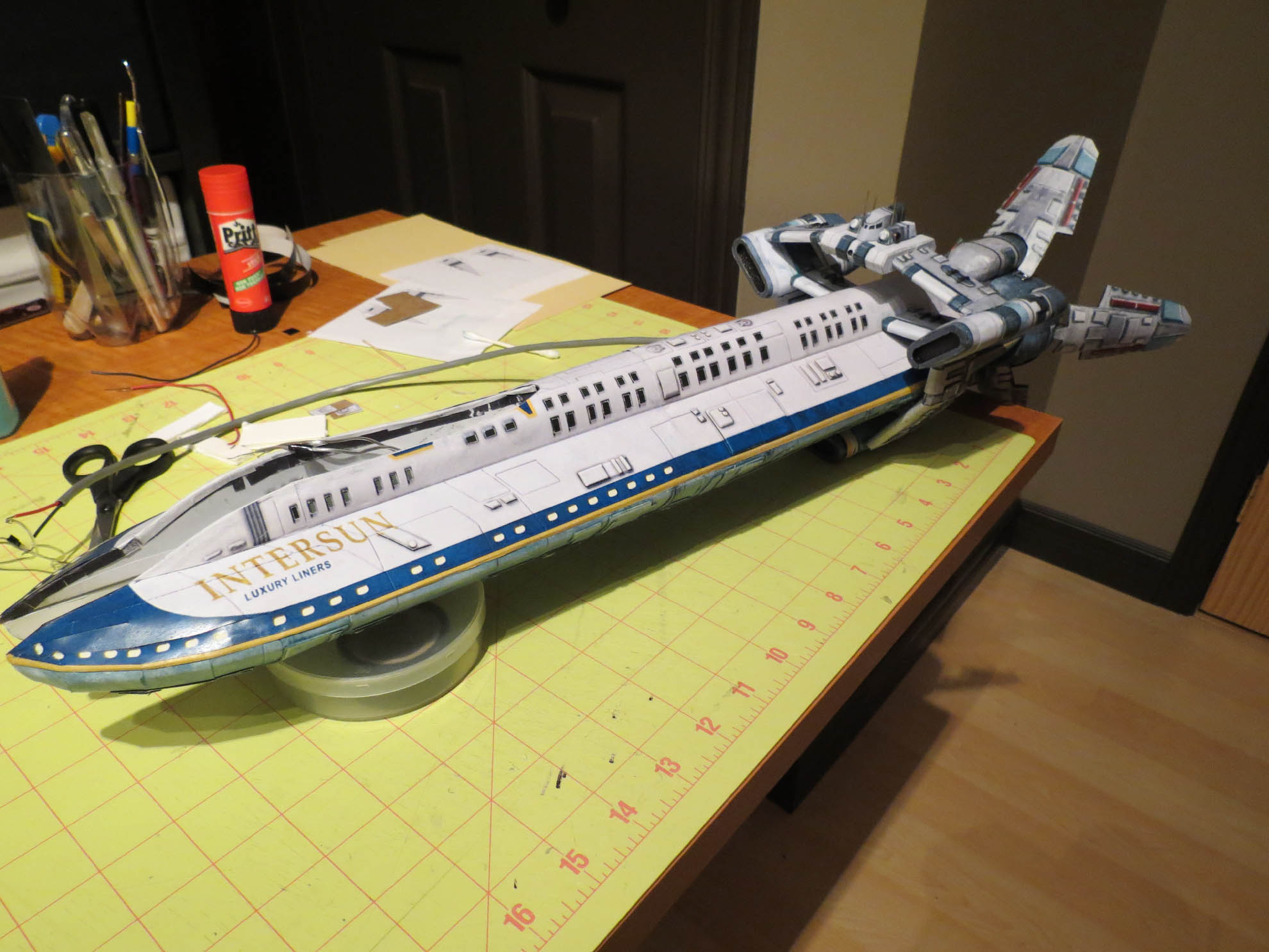

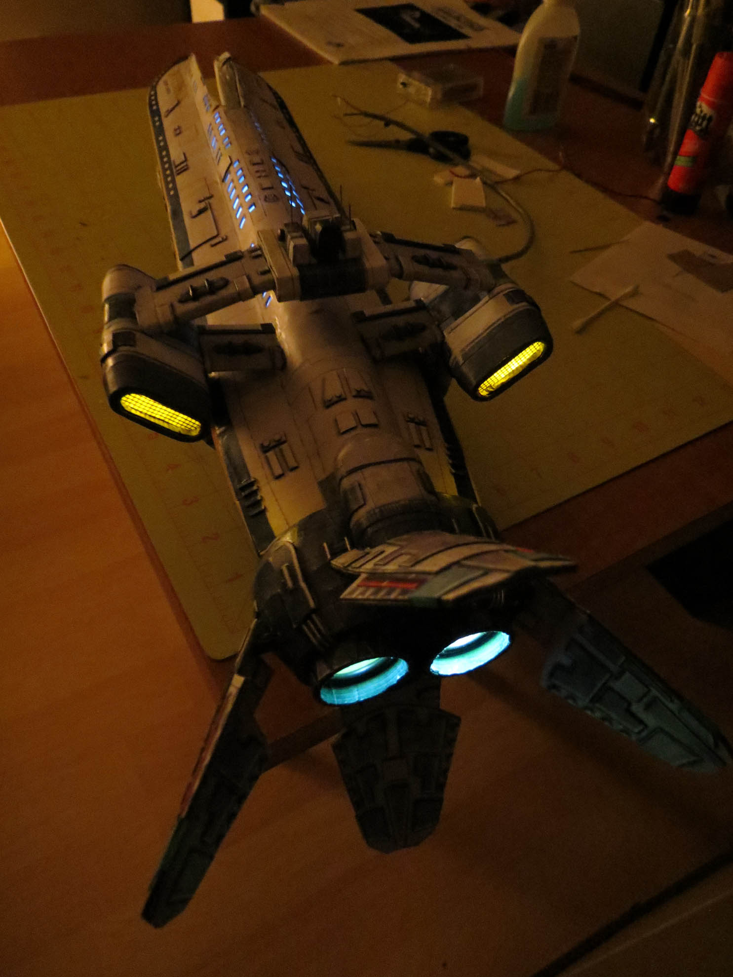

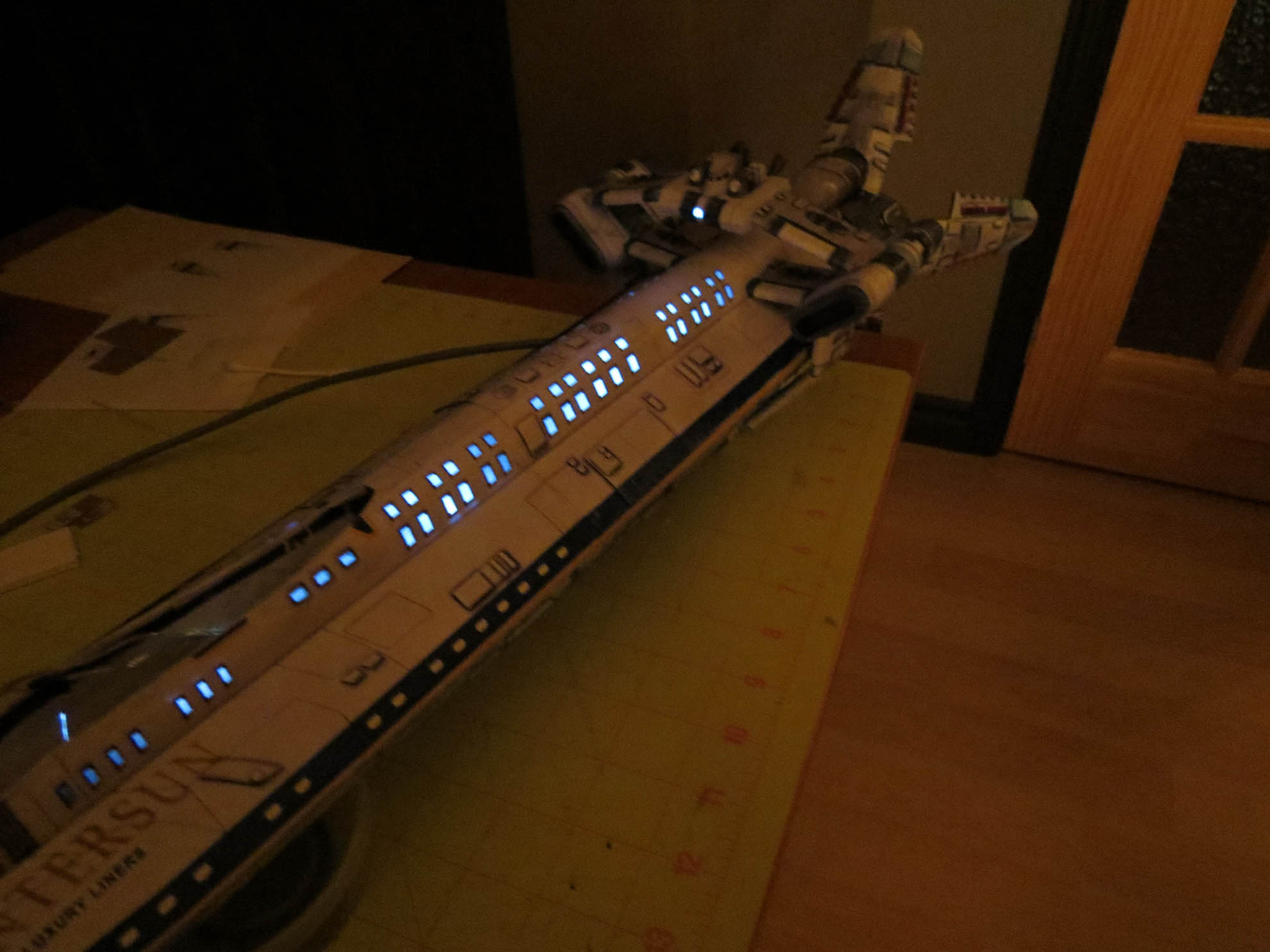

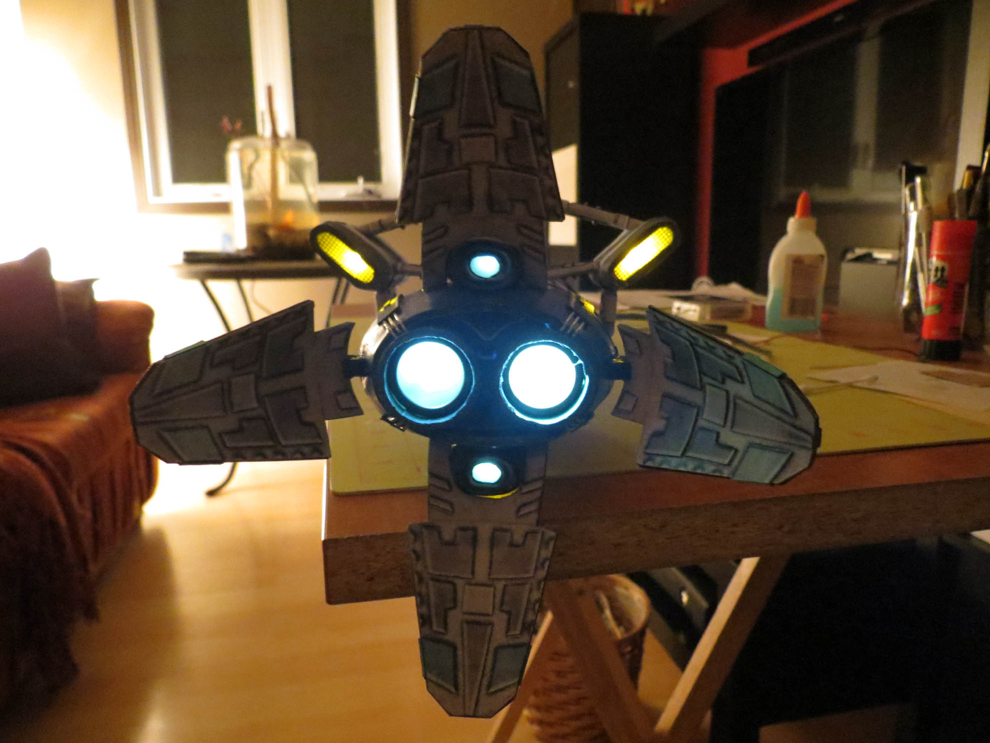

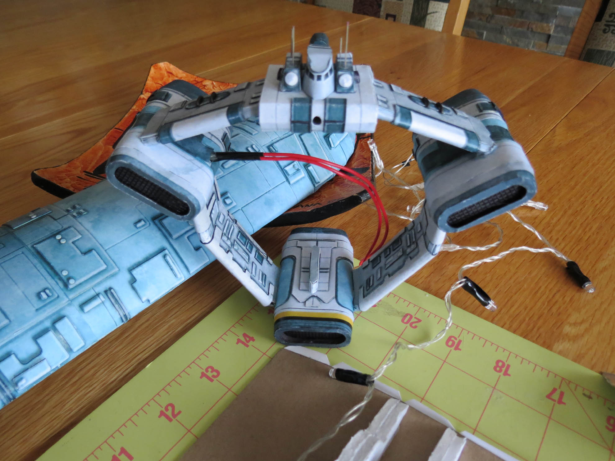

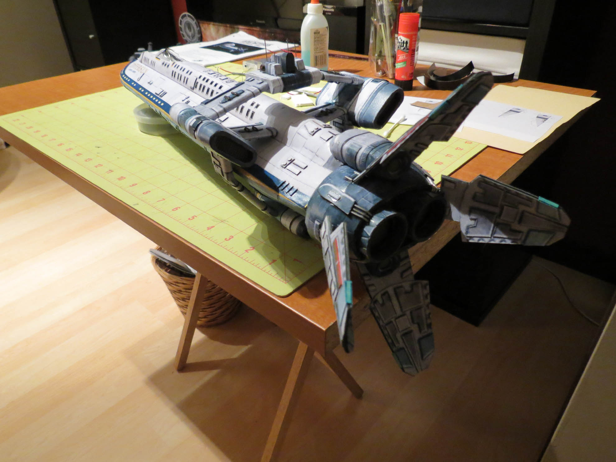

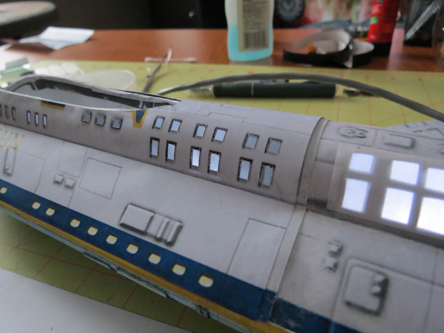

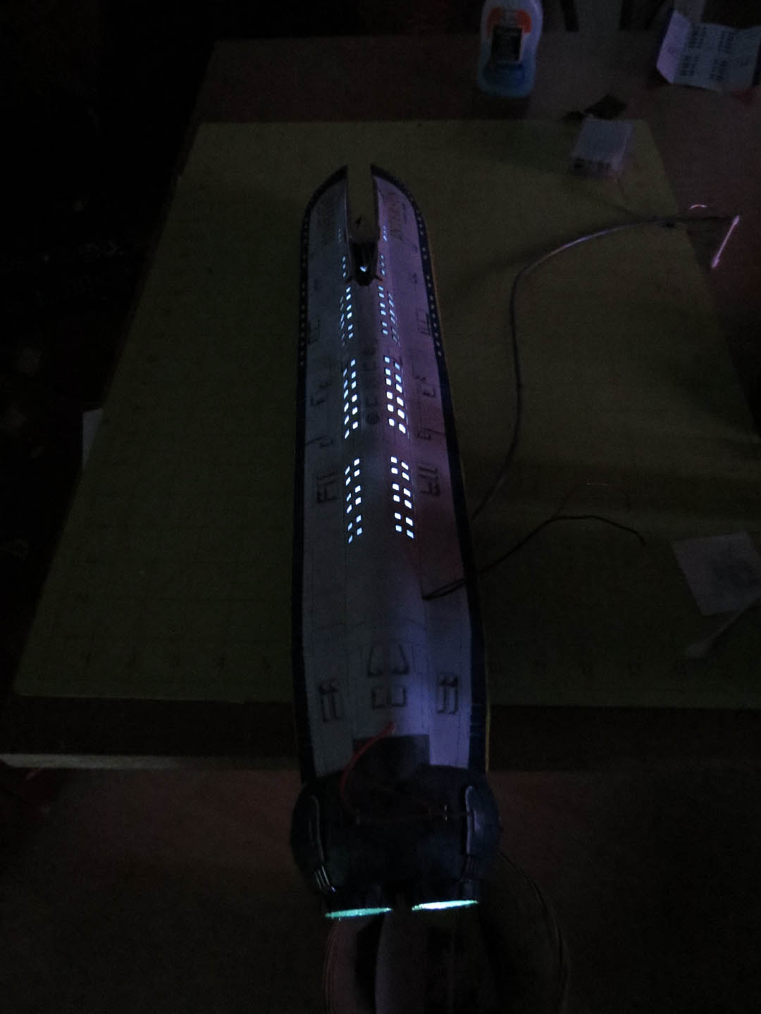

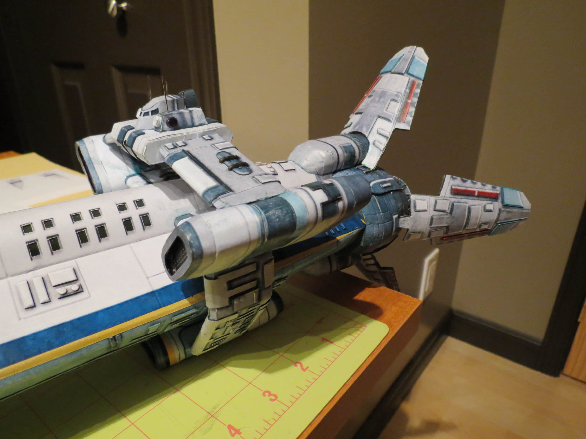

Some update
Completed the upper hull with the lights. Next step, detail the upper hull, glue the ring and the rear top engine.

To be able to post such a large clear detailed picture of a model,larger than life, and see this masterful technique is just awesome! I wish I had your skill. :)
HOLY FRAK! This is awesome! :)
