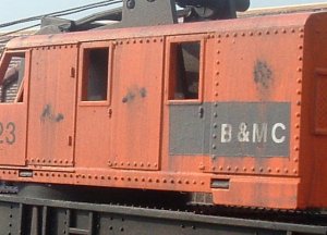

Heres the similar color method I did a couple years ago. http://www.the-gauge.com/attachment.php?attachmentid=18475&stc=1&d=1098748338 I just painted over the PC reporting marks and made it CR. I didn't even touch the PC logo. I know this is a heartache to you PC fans out there :D but a Conrail fan's gotta do what a Conrail fan's gotta do.:thumb:
