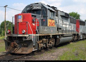

In keeping with my more modern theme, I want to take an Southern Pacific GP60 and correctly cover the SP logo/numbers with the new UP colors. I've found some pictures online that I'm using for my prototype in decal placement, but I'm wondering if I'm missing something else. Any structural changes to the shell? Anything? If this is a good and typical "patch" job by UP, then this is what I hope to turn the SP unit into.
For those that have already accomplished this "patch" job feat, do you first remove the old numbering so they can't be seen under the decals, or do you leave them to give a hint of the old numbering - further reinforcing the fact that the engine had a previous life on another pre-merger railroad? (Now, I'm modeling these in Nscale - so unless you have a magnifier, you can't even see the painted/covered over old numbering - but when you take a close-up picture, you see the old numbering under the decal.)

Herc:wave: , normally nothing new would be added, if there was anything added, it would be at the time of an overall paint job:winki: . personally, i would just add the patch right over the old lettering, though being i was a paint & body man for 17 out of 23 of the years i have been working, i can tell you in real life the old paint SHOULD be sanded before the patch is put on for better adhesion:winki: . but i have seen a few real life patch jobs that you could clearly see the old numbers under the patch:eeki: . i guess the choice is yours:toug: .
BTW, FANTASTIC pic to go by!!!
:deano: -Deano

On the unit in the picture, is there an SP on the nose that has been painted over but still shows through?
If they made any upgrades to the unit, I think it would be in the radio and any signal system (trackside pickup) to let them run over all the system. This detail would be a) too small to model in N and b) internal.
Just drop the patches right on top of the old lettering. Don't worry about the numbers matching, UP didn't. :D Also throw in some small UP initals above, in front of the numbers. It was a quick and dirty patch job usually when UP does it. A lot of units got the patch and were never painted before returning them to the lessor or retiring them.
