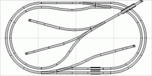

Below is a picture of the track plan. It is based on Mike Fischer's "Little Layout." The dimensions are 2' x 4'.
Ugggg...I forgot to attach the picture... Here's the track plan:

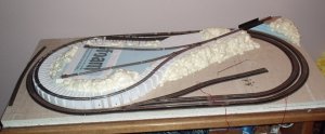

Below is a picture of the current state of the layout. I've laid most of the roadbed (Woodland Scenics). I used a combination of insulating foam, packing foam, packing foam peanuts, Great Stuff foam, a Woodland Scenics foam incline (3%), and a little piece of cardboard to construct the sub-roadbed for the branchline. I think that little bit of cardboard must feel lonely amongst all that foam.
The WS incline was worth the money. It was a lot easier to deal with than trying to create a custom incline like I did for the original Copper Ridge.
The layout "framework" is a sheet of hardboard that has two ceiling tiles glued to the top of it. This sits on top of an old computer desk. I used drywall screws (the type that have anchors that expand when you tighten the screw) as legs. This enables me to level the layout, which is important in my house because none of the surfaces, including the floor, are level.
After I finish laying the roadbed, I am going to put down some pieces of newspaper dipped in plaster of Paris over the Great Stuff hills to reduce the "bubbly" effect.
My Big Plan is to place a mountain on the left side. The mainline and branchline will run through tunnels. This was the only solution I could come up with to hide that ugly cliff on the left side. If anyone has any other ideas, I want to hear them!

Yeah, Judy, I kinda like the 2x4 module idea, myself. In fact, I have sort of a plan to expand the layout in the future, if I can obtain some more space. The little bumper in the upper-right corner can be removed and replaced with a connector to another 2x4 module. One idea I had was to continue the branchline upwards to a larger mining complex or maybe a town.
My old computer desk is made from a 2x4 sheet of plywood (with a moulding around three sides), so it's perfect for the layout.
BTW, the adjustable legs I mentioned earlier are installed on the hardboard, not the computer desk.
Rory, I've had that problem, too. The newspaper strips should work pretty well. I have also tried filling in the gaps with Celluclay or trimming the "bubbles" with a kitchen knife. The Celluclay worked well, but took a few days to dry completely. Trimming with a knife gave good control over the finished contours, but the texture that you got after cutting the Great Stuff was hard to paint over. Looked good once the ground foam was added, though.
The layout looks great. :thumb: Having the branch on an upper level adds a lot of interest.
John

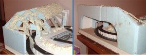

I've been working on the mountain. I hate tunnels because they can be a maintenance nightmare. I left a large access portal so I could get my hands in there to fix things. My next step is to cover the mountain and some of the surrounding area with strips of newspaper dipped in plaster.
The mountain subsurface is a grid of plastic mesh that you can get out of the craft section at Walmart. I think it's used for needlepoint or something like that. I had a little Great Stuff left, so I smeared some of that over the grid to give it a little more texture.

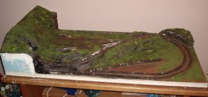

I guess the last photo I posted was lost. Here it is again. I'm going to try to get the track hooked up and get trains running this weekend, if I have time and energy.
I can run trains now! :):):)
I finished the wiring (all 6 blocks of it:D) and everything ran perfectly the first time 'round. I still have some tunnel clearance issues, though, but I'll deal with those later.
Here is a pic of the layout with the track in place. I put the control panel on the mountain on the left. Later, I will make a socket where I can plug in power packs. For now, though, the power pack is wired directly in.
My Bachmann 4-4-0 is on the upper level near the bridge (upper-right corner), to give you an idea of the scale.
Next, I plan to work on the ground cover. Everything is too dark. I got a little carried away with the black paint...
