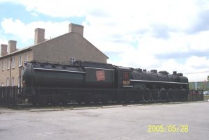

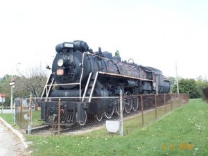

Rob here are those two pics one of 6167 taken in Guelph in 2004 and the other of 6213 taken in Toronto in 2005. I tend to plan all my trips around locations where Steam locomotives are, my wife and I were in Ottawa this summer to see a Shay running at the museum of Science and Technology, and while in the area we went over to Hull Quebec to ride behind a Swiss Steamer that runs excursions.
Tom
