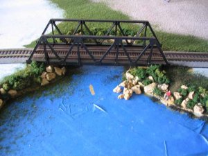

I hope you won't mind a little constructive criticism of your water. I'm not sure how much more you were planning to do on it, so if it's just roughed in, forgive me. However, I notice there is some wrinkling of the surfaces in both photos, that doesn't look like waves. The colour blue is not what people usually use for water either. Painting water is tricky, and it's a case of "paint what you see, not what you know". In other words we all think of water as blue, but a quick study of some photos shows that it is usually some other colour entirely - brown for muddy rivers to almost black for deep water.
There are all kinds of examples of water techniques here on the Gauge. Some are relatively complex, others more easy. The simplest way to get the look of still water is to paint the edges a colour that is several shades darker than your ground colour. This gives the illusion that it's wet. Then fade that colour into a much darker shade as you go away from the shore. This gives the illusion that the water is getting deeper.
Finally, cover the whole thing with a coat of something really shiny - varathane or similar. This gives the illusion that it's wet.

Thanks for the tips on the water -- we'll need them shortly. :D You can't tell from the pictures, but the blue you see is simply drafting tape that I have placed over the plywood while we are working on the bank of the lake. Once we have finished the embankment, we'll be ready to pull up the tape and get to work on the water. And, we'll certainly need your suggestions.

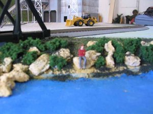

Here's another picture (sorry a bit out of focus) with some landscaping done around the rocks. We're working on the rest of the bank, so hopefully I'll be able to post some pictures of the whole thing soon. As usual, I'm sitting around on something....this time taking a pensive minute on a rock near the, soon to be, lake. :D

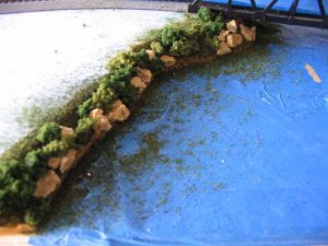

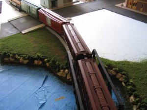

Ok. Here are a couple more pictures of the lake embankment. We painted the bank, then put our "rocks" all along the edge, then added more ground cover. We haven't landscaped the areas beyond the lake bank, so you can still see the blue foam, but all in good time. :) The second picture is an overall shot of the area bridge area.

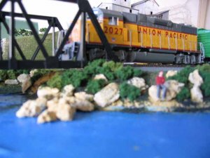

One last post of the same area with the mighty UP diesel entering the bridge. (I'm having a bit of trouble getting everything in focus in these pictures :rolleyes: -- seems the digital wants to focus on the loco and blur everything else. Can't say I blame the camera. ;) At least you can see the scale.

:confused: Val, just one more note -- what probably threw you off is seeing the rocks in the lake area. I simply have placed them there to give the perspective of what the rocks would look like having been tumbled down the embankment into the water. Probably done by that bulldozer at the gravel pit. When we're ready to do the lake, I'll lift them up, remove the tape, place them back in, then do the water. By the way, I assume I should put the rocks in the lake area THEN do the water, not do the water then put in the rocks. Yes? :confused:

It kind of depends on what method you use for the water. If you're using something that needs to be poured, you should be aware that surface tension can cause the material to "creep" up around things that are in the water. This is especially a problem with reeds and things like that.
On the other hand, if you're just applying a coat of something shiny, it would make more sense to put the rocks on after.
The first method allows you to see some of the underwater detail and is better for shallow water like a stream with a stony bed. The second method is a lot easier, but you can't see into it, so it's better for deep water like a harbour.
There are some very good threads on doing water here on the Gauge. If you do a search you should be able to find them. And then, I'd reccommend you do a couple of experiments first.

We'll be using the Woodlands Scenics water effects. I had thought to paint the plywood base, blending the colors lighter to darker as you indicate, then pour the Woodland Scenics "water" over the entire area. I thought I would place the rocks directly on the plywood bed after I painted but before I poured so that the water effects would actually pool around the rocks, creating a kind of natural flow with some surface structure around the rocks. The alternative would be to pour the entire lake area, let dry, then place the rocks, then pour again?? or at least pour enough to add some ripple effects around the rocks. We thought the first method would be the best. Place the rocks, then pour. Thoughts? :confused: :confused:

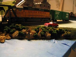

Here's another pic of me down by the lake -- pulled the other car up (yeah, I have a few sportsters) and then walked down to the lake for a moment of peace. My quiet was quickly interrupted by the local UP rambling down the track. Must be 7:00pm. Right on time. :)

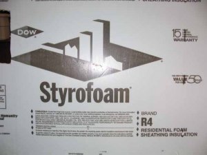

We used the blue styrofoam material, made by Dow, called Residential Foam Sheathing Insulation. I know it also comes in a pink color. The blue stuff we bought comes in a 4x8 sheet and in various thicknesses. I used 1 inch, but if I had to do it over again, I'd DEFINITELY use 2 inches or at least bond two 1 inch sheets together to make 2 inches. You can bond them together or to benchwork with Liquid Nails for Projects and Foamboard. This particular adhesive won't corrode the foamboard and it works great. Just squeeze it out, trowel it a bit to smooth it out, then seal the piece to the table or to another piece of foam! :thumb:
The reason I would use 2 inches, is if you want to have a bridge, which we did, you can carve down into the foam to make a lake, stream, ravine, canyon, etc. With only 1 inch, there is not enough depth to do too much. 2 inches would give a much more realistic look and depth. You can see how our bridge and lake area looks in this thread. I'd have liked to have had a deeper lake bank.

I went out to the garage a took a pic of a scrap piece of the foamboard that shows the make, etc. Hope this helps.
