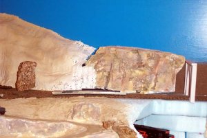

Anyways, RobL if you use the leopard spot approach for your rocks, you end up with a rock that looks like this... see below...
You can also see a transition stage of my layout where I have used WS plaster cloth covered with wall joint compound and a light coating of earth undertone has been applied with an airbrush.
