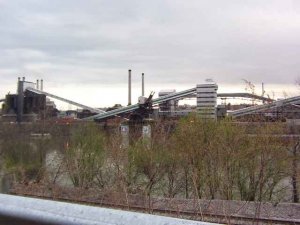

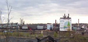

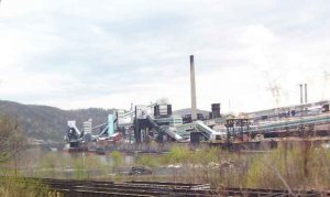

The first thing I did was take a bunch of pics. This one I used for modelling the river wall. Unfortunately, Clairton Coke was te worlds largest coke plant, and compressing it down to 5' x 2' will be a chore & 1/2!! I don't know what all to make, so I'll probably just go with structures that stand out.

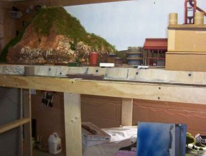

wall done
Wall is mostly done. I placed some misc structures to see how much room I have. The wall is 2" thick pink foam, cut at a slight angle, then I cut out the barge tie ups, and painted it with white latex primer. While the paint was wet, I dipped my foam brush into different shades of chalk and weathered it.
