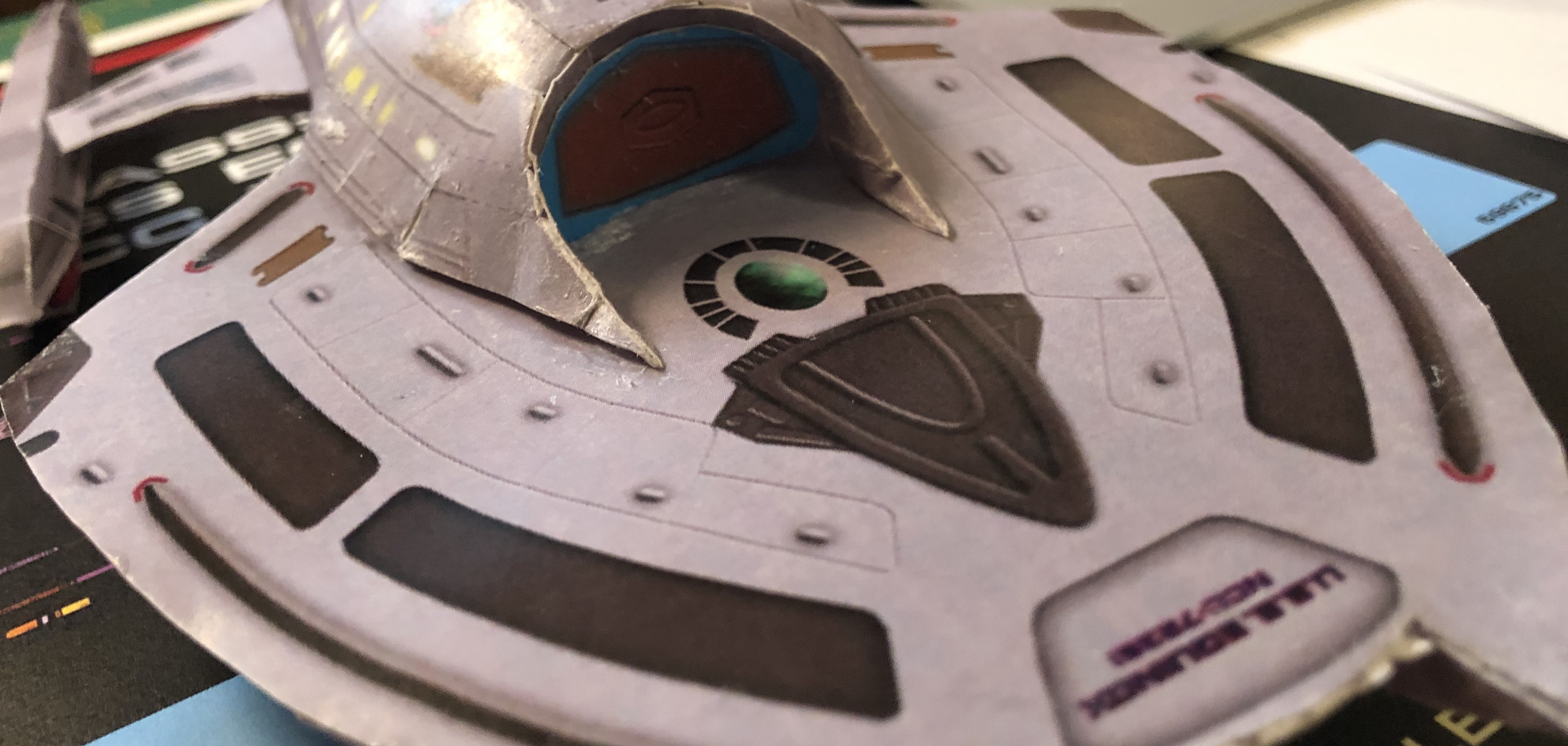

So, lets finish up this kit review/comparison...
Another difference between these kits shows how one is stronger in some areas and the other is stronger in different aspects.
The secondary deflector set in the notch in the forward hull has a better support system on the PSF kit, with accurate, red triangle details [see pic 1]. Yet the Clever kit is more accurate in the Deflector layout, consisting of both the deflector projector and focusing panel [see pic 2]in front (the PSF kit leaves the focusing pad part completely out for some reason). Its odd how the authors saw, or missed, different details.
On the hulls of the rough builds, the differences are more apparent, and the fit issues more clearly illustrated.

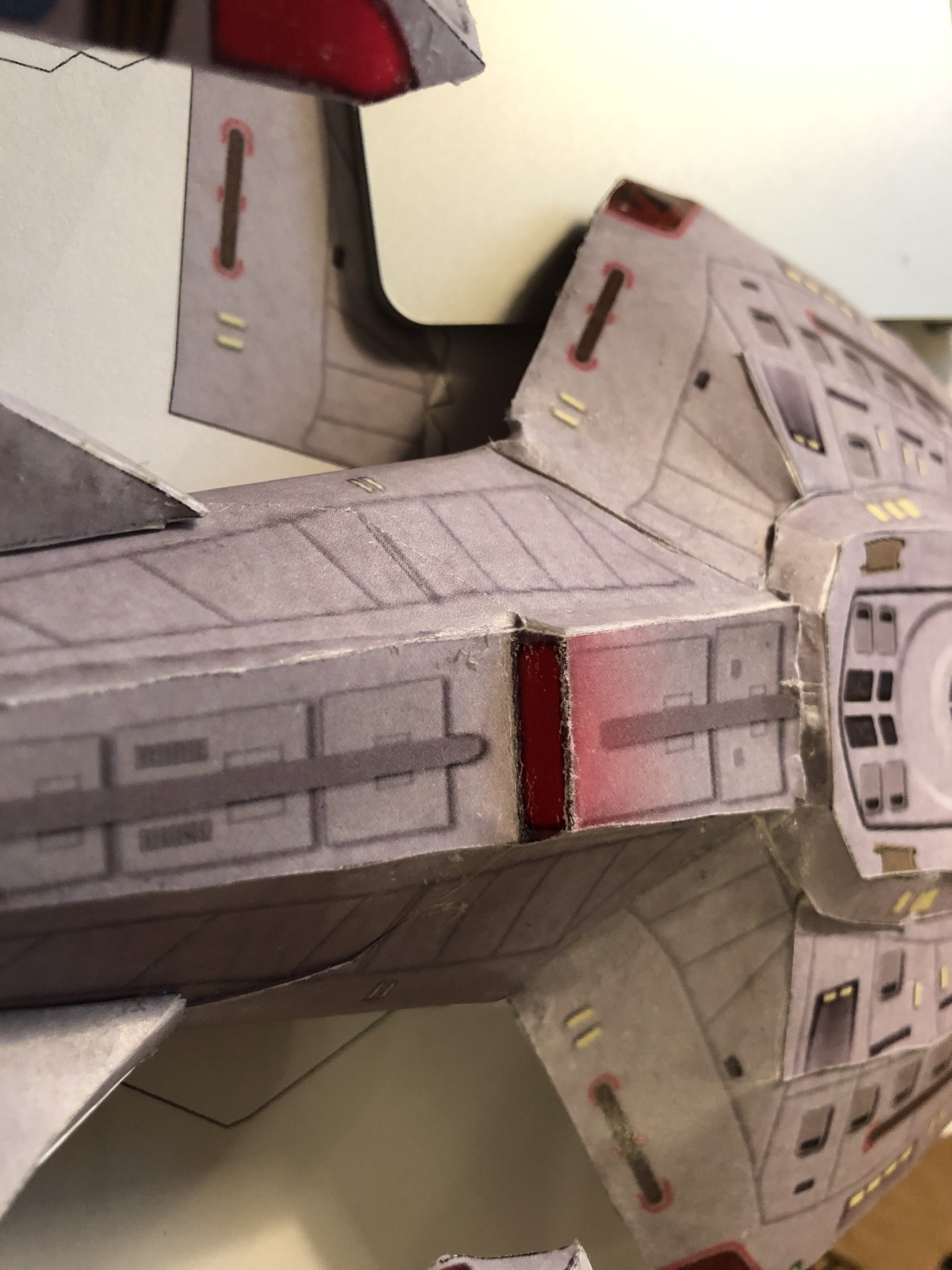

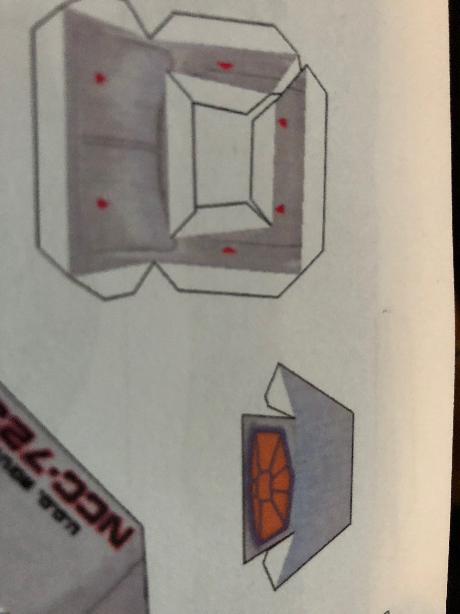

Continuing...
The Clever kit has the better fit of this notch [see pic 3], though it is a little tight and narrow a shape compared to the screen-Digi kit. Where the better graphics on the PSF kit provide a more accurate visual (with the exception of the erroneously omitted deflector pad in front of the projector), the kit suffers more fit problems, as the deflector projector does not kit in the housing easily. The notch-size in the forward-hull is better on the PSF kit though [see pic 4].
The differences between the kits are clear, where one has better graphics than the other in some respects, but is missing in others, and one fits better together in some ways but then not as good as the other. Both kits have benefits that may permit combining these to make one accurate, well fit kit.
The two kits may cover the same subject, the Nova class, but they are very different and have different positive and negative aspects.

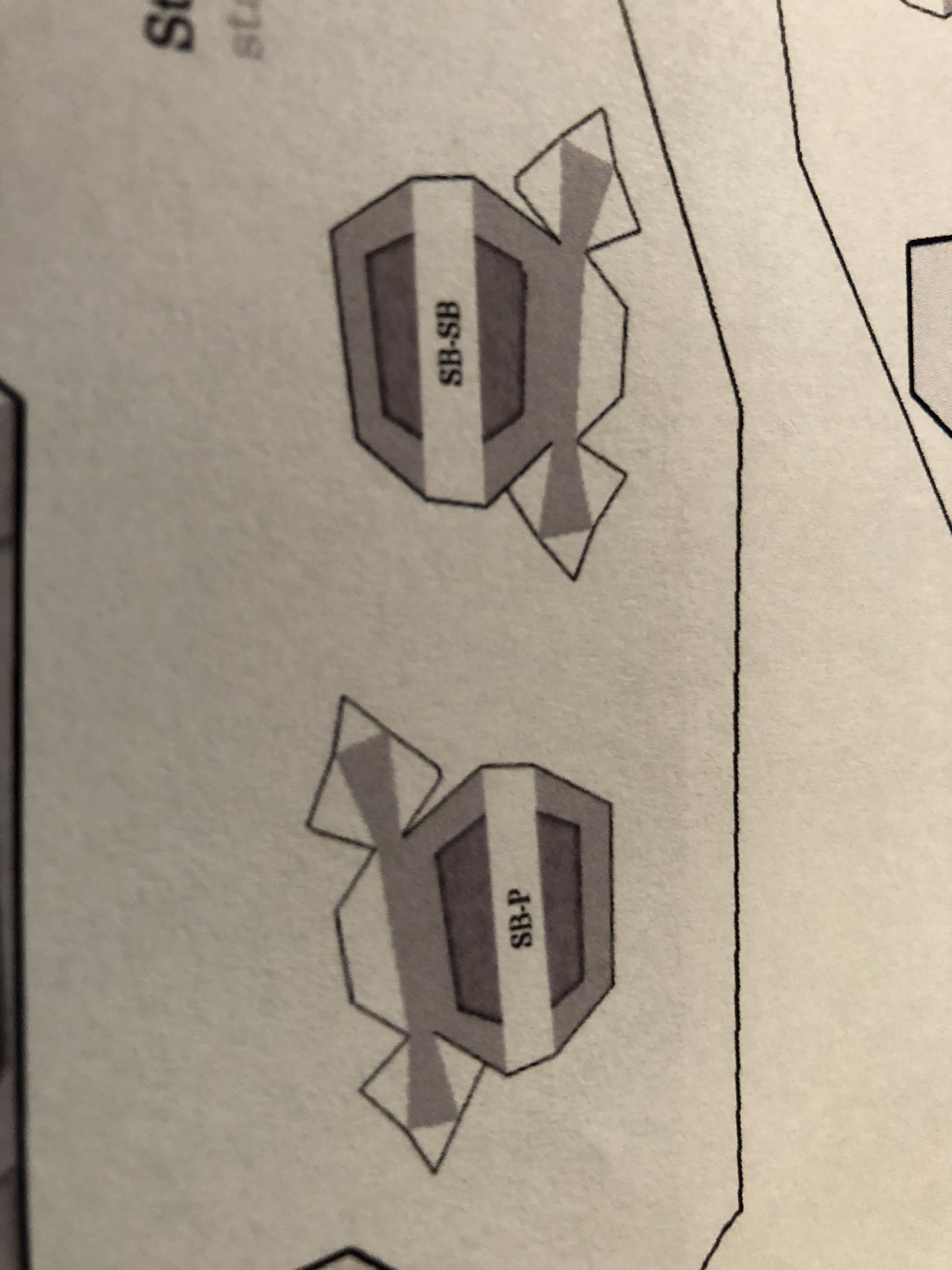

You might be seeing why I built rough-builds of these before attempting a quality, attractive final build. The lack of instructions, and potential fit problems, suggested pre-emptive experimentation.

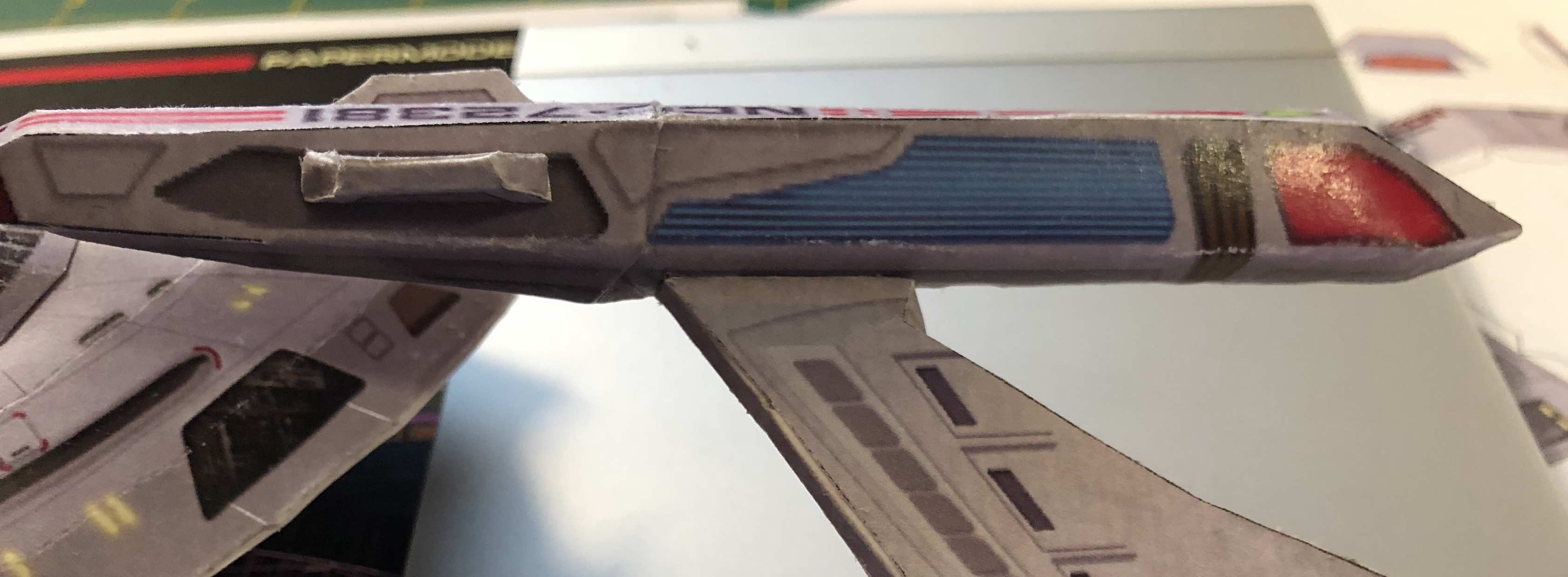

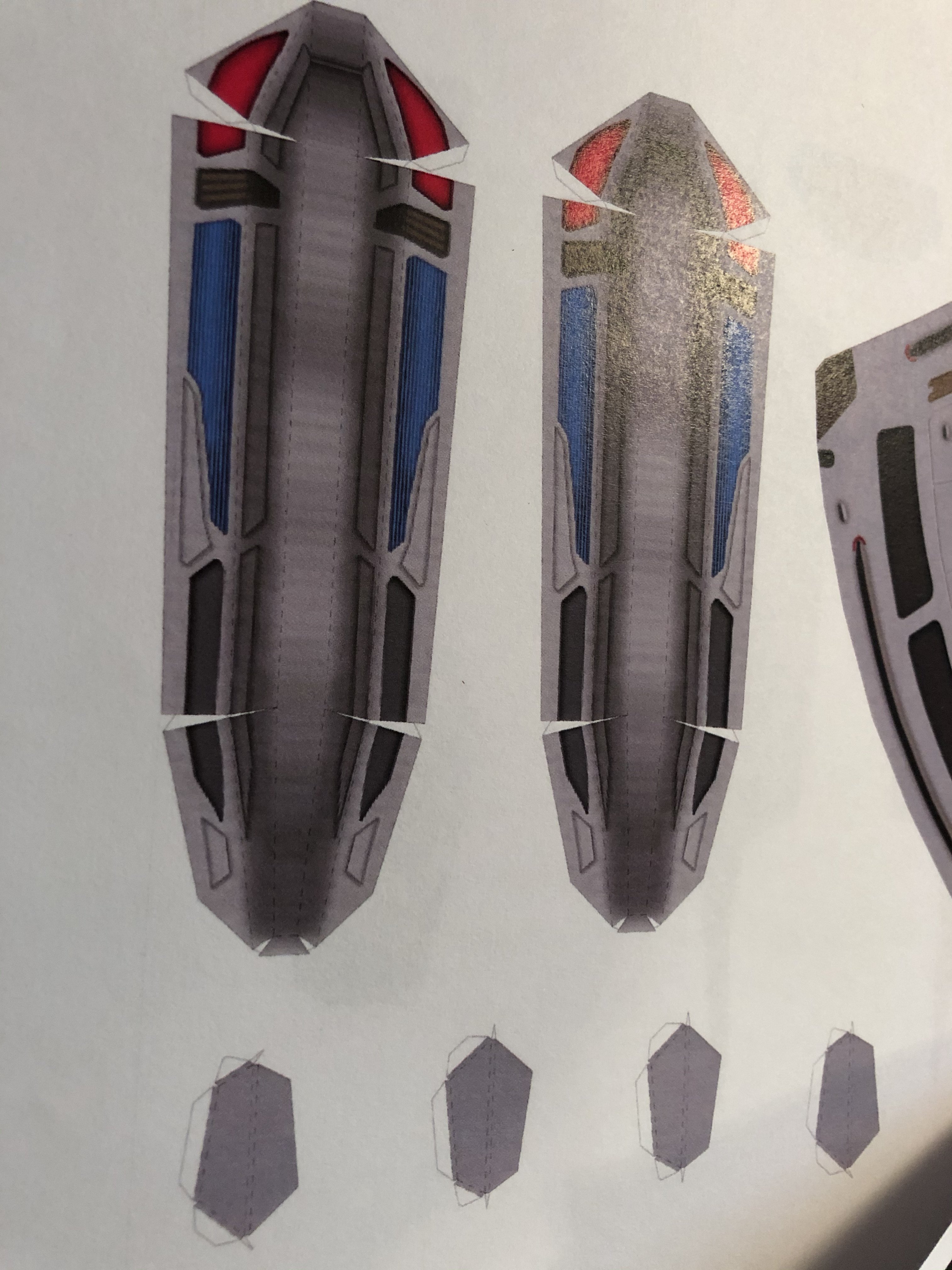

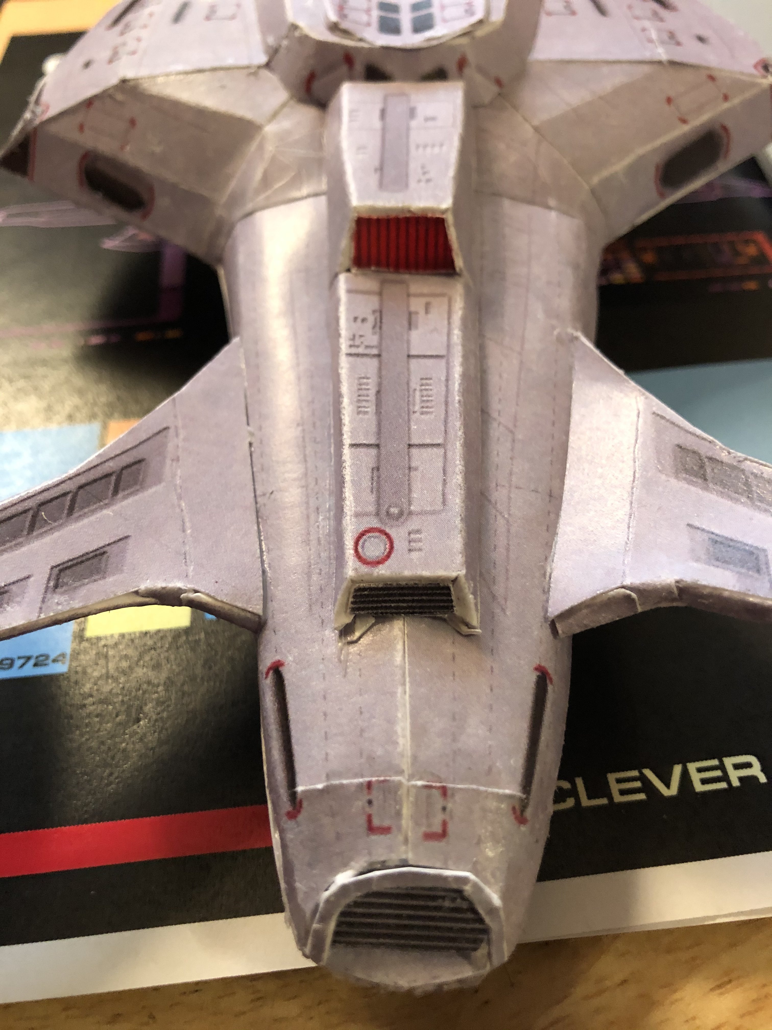

This differences extended to the nacelles.
The Engines on the Clever kit are easier to build and make cleaner assembly [see pic 1] but, though more difficult to build, the PSF shapes are more accurate to the Digi-model. Of course, if you choose to light your model, like Spaceagent does, the Clever kit’s nacelles have seems through their bustards that would interfere with lighting (the PSF kits also have very minor seem splitting near the edge of the magnatomic flux chiller, but they are less noticeable) [see pic 2]. Again, a frankensteining of these kits be be needed to produce what you desire in the end.
The rear intercoolers are more accurately shaped on the PSF kit, than on the Clever kit. Very little effort would make them more accurate on this PSF kit {see pic 3]. The Clever kit’s intercoolers are mere coloured shapes and less attractive or representative [see pic 4].
Again, there are benefits to one kit that compete with the benefits of the other kit.

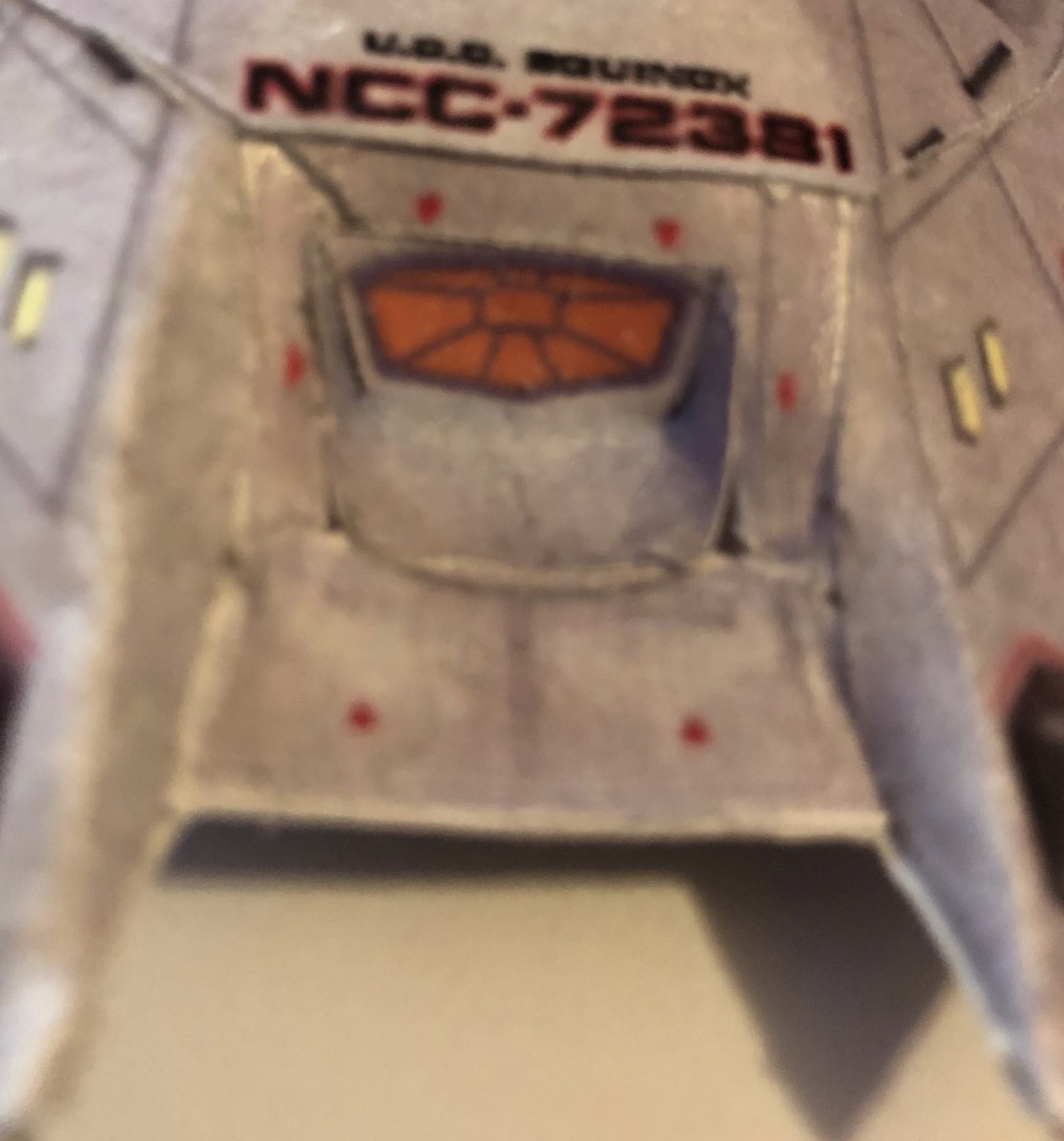

The upper engineering hull connection is different on both kits. The Clever kit does not make for a smooth connection. You would have to rig it, or you'll have this awkward gap. Its just a kit flaw.
The PSF kit is much better. It provides a flush connection between the engineering hull and the command hull, at the base of the neck. Unfortunately, there were not directions, and a single white connection spacer plate, that would have made this more effective, was not described. In my test build, the plate was left out. I believe that using the only framing pice [pic 3] would help keep these parts from separating after the hull sag kicks in. Use the plate in pic three behind the command hull, to permit your own creation of addition of structural strips to fasten these together more securely.

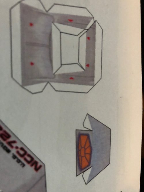

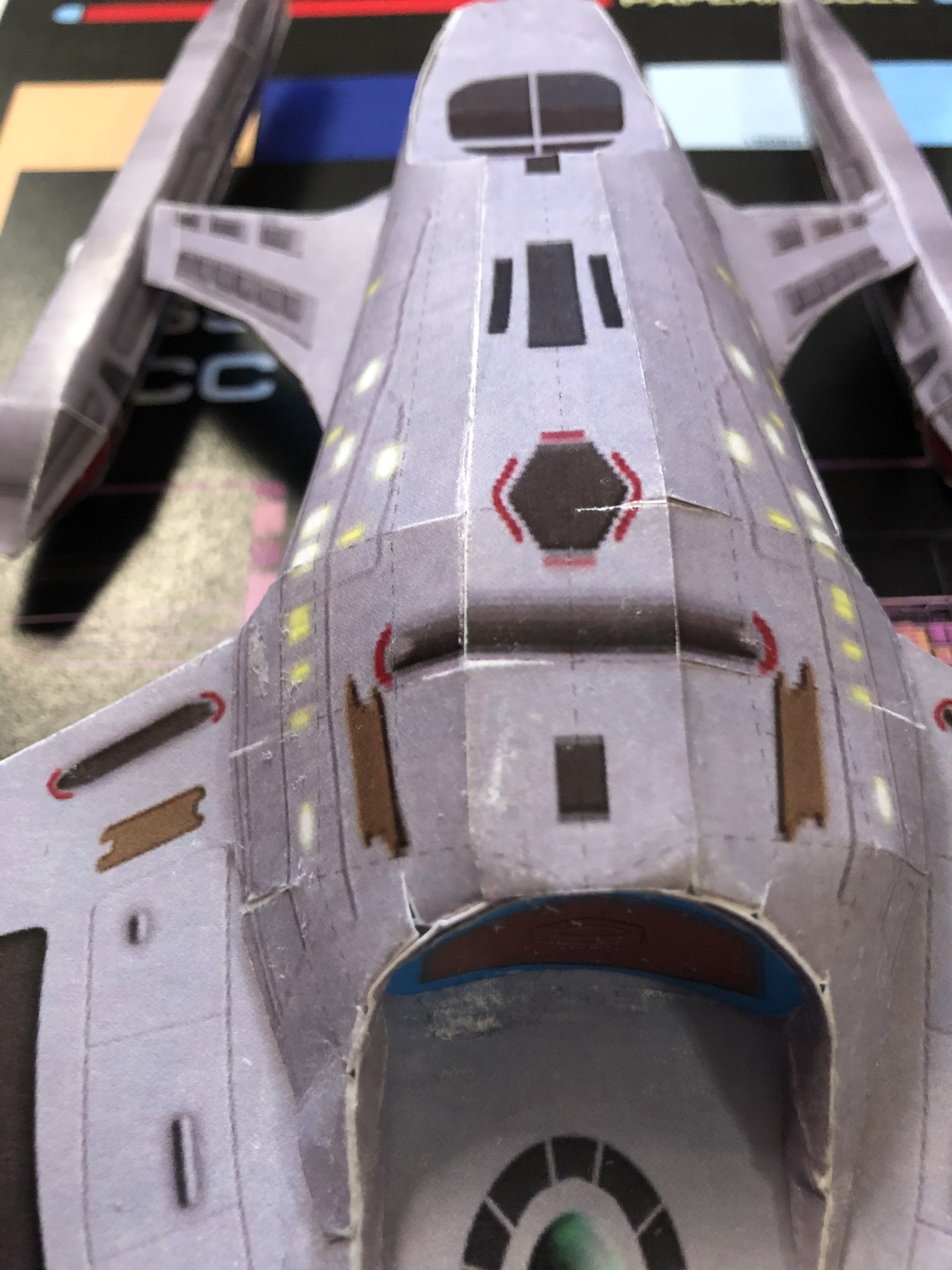

The upper impulse-shuttle decks are very different on both kits.
On the Clever kit, they are more cleanly and easily fit, as squared-off additions [see pic 1] that glue flush to the rounded deck. The PSF kit encompasses the decks as part of the lower hull fold process, instead of using two pieces, as the Clever kit does. This shaping of these impulse/bay decks is only accomplished by carefully noting this need to bend a framing-difference, as you try to assemble it (no directions makes this effort a trial and error effort) [see pic 2]. Directions here would have made the process far less frustrating. A rough-build is almost needed just to accomplish the desired shape. The good news is, if you do go through the awkward rough build process, the cleverly-thought design makes for a cleaner upper hull shape, when finished.
The impulse engine graphics are better on the Clever kit [see pic 1], as are the secondary, upper support bay doors, and the ones near the stern of the ship.
The PSF kit drops the ball in this respect, creating a glowing refection of the engine, spilling up the hull, not down in the direction of the light flow, and with little impulse engine graphics. The effect is an odd, impulse backwash! The secondary bay is neglected, with the staging area/elevator just folding over where access doors should be [see pic 3]. The aft shuttle bay doors are very poorly graphiced-out as well (and the hull shape is off quite a bit).

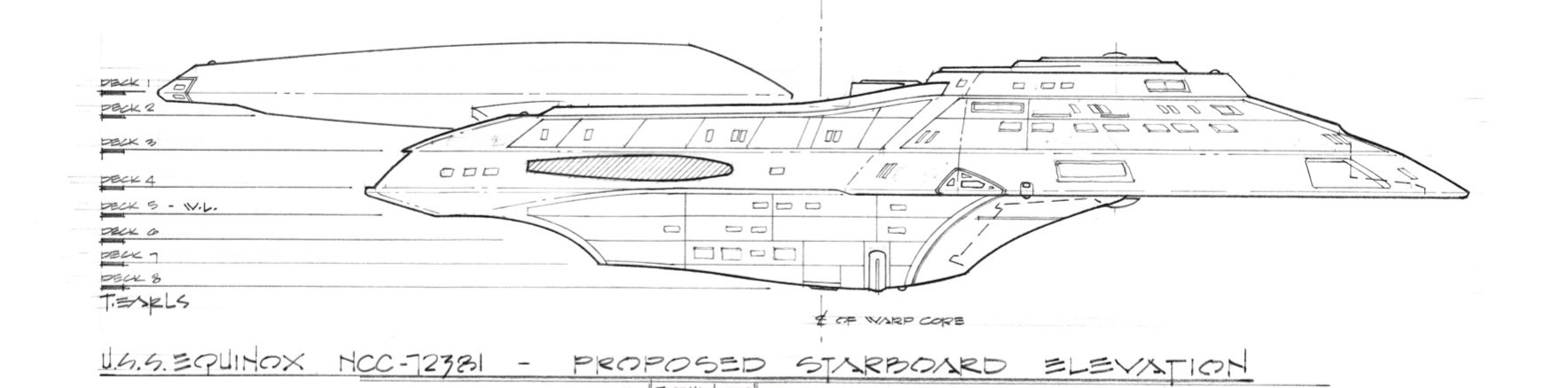

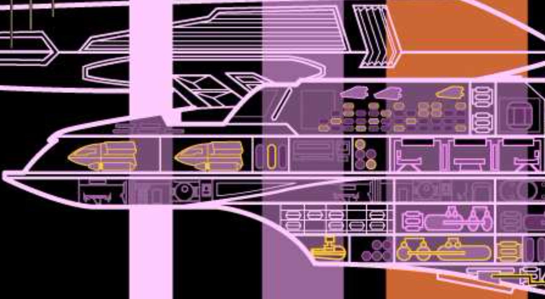

These difference in the kits allude to something that I hinted to in the beginning of the thread, regarding the shuttle bay (in TV that would have been called a tease!!). The Clever kit’s shuttle bay is better and more accurately shaped, as compared to the Digi on screen, but it lacks the darker staging area [see pic 4 for the graphic cutaway of the section & 5 for the designer hand drawn notes] between the aft bay and the mid-hull secondary bay access. The PSF does have this recessed upper bay staging area, delineated appropriately in a darker shade. This staging area is provided, at least in print (modification would be necessary to create the layering to make it look better) in only the PSF kit [see pic 3], but as noted before, this recessed staging area bends upward into where a set of clamshell doors should be placed. To build this accurately, the recessed darker ares should be moved a few millimetres toward the aft section, and separate clamshell-doors needed to be added (perhaps stolen from the Clever kit?).
If you look at the cutaway, as provided by the Clever kit [pic 4], the main shuttle bay is merely a deck tall (not high enough to stage a typical shuttle; see designer notes in pic 5) . Only shuttle pods could fit throughout the doors of the lower-stern bay, even with accurate tractor beam guidance [see pic 4]. The upper bay is even shorter than a full deck, making the entry only useful to workboxes (and very rested pilots!). However, if the staging area deck, between the stern shuttle bay and upper shuttle bay, were to lower, the secondary bay area would actually be large enough for shuttle travel. In fact, the entire area could be one shuttle adequately-sized shuttlebay, with a small stern door for tractor launch, an upper elevator staging pad, and an upper set of doors to close off when the elevator is raised flush with the outer hull.
The shuttle would land outside, onto the staging area, and be lowered into the bay and tractor through the upper bay doors, similar to an external elevator system, like the internal one employed by 1701, that was enclosed in the shuttle deck and dropped into the shuttle maintenance bay below the deck.
If this is the "in-universe" solution is as I suspect, then neither kit would work without modification. Clever's kit lacks the darker, shuttle staging elevator, and the PSF kit has it, but it is positioned in a manner where it gets bent when folding the parts properly.

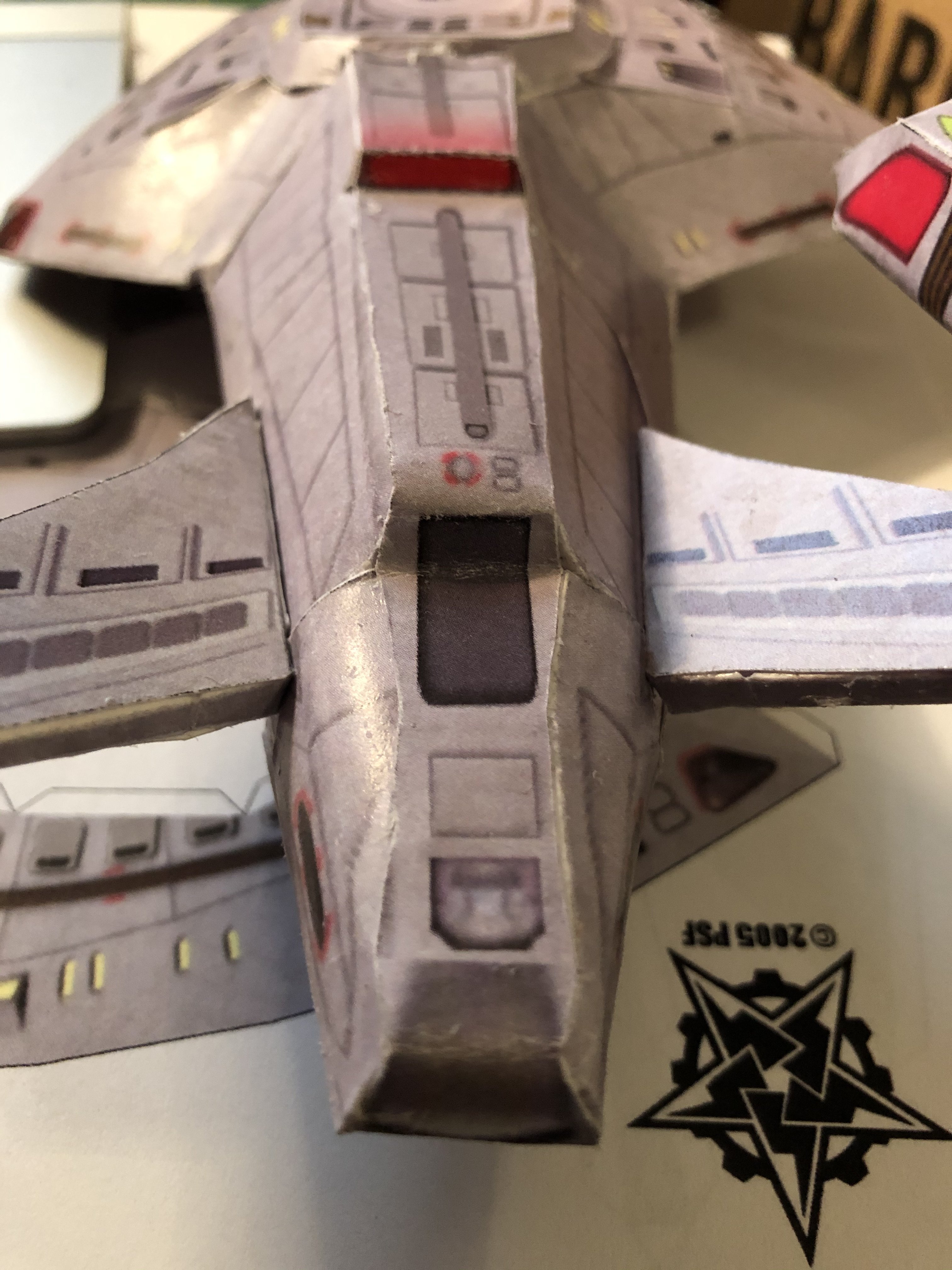

The Clever kit provides a better hull shape for the stern; it just takes a bit of experimentation to find the right shape. Play with the fold lines before trying to do a quality build, as this shaping is not easy, nor explained in any directions.
The PSF kit is easier to put together in the stern, but the final shape is a bit too narrow and too high; it needs to be broader at the shuttle bay doors.
regarding the graphics in this area...The Clever kit does not provide a between shuttle bay door staging area/elevator. The PSF kit does provide this.
But the PSF kit does not provide upper doors and the darker staining area/elevator elevator is bent when the kit assembled.
At the very least, the doors off the Clever kit would need to be match to the upper deck-bay access, covering the bent portion on the PSF.
The PSF also needs the doors off the Clever kit for the stern bay, as what is printed is not accurate or as attractive as the Clever version’s. Of course, then you’ll have to modify the PSF kit to have its stern shaped a bit differently, or choose to go with the Clever kit, but then steal parts off the PSF to make a staging elevator/pad…

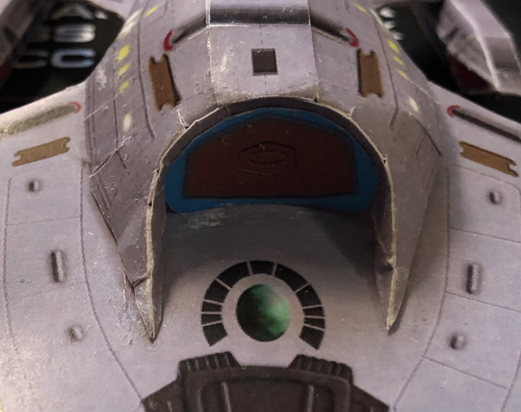

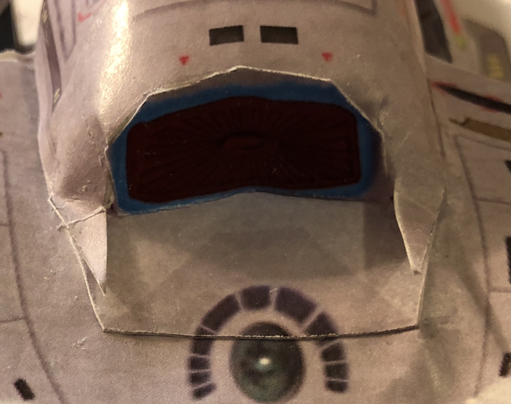

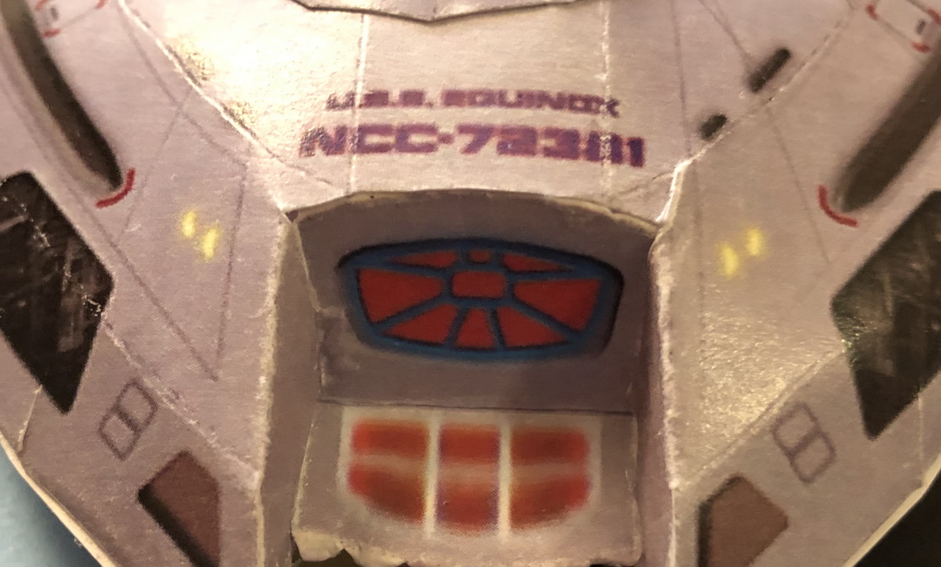

The main deflector is very different on both kits. The housing and bracing is more effective on the Clever kit, providing more shape and an inset brace that stages the deflector better [see pic 1]. It takes bit of patience and experimentation, but after puzzling it through you're able to figure out how the author planned to employ the piece. Turn it "inside-out" to brace the inner, raw fold of paper, enclosing the inner assembly.
The actual deflector graphic is not as nice as the PSF kit though [see pic 2]. There is less detail and the dish is too wide on the PFS kit! You'll have to play around, shrinking the pSF dish a bit to fit in the deflector housing of the Clever kit.
The PSF kit lacks the inner housing-curved piece that makes the Clever kit look so much better when built. Its too flat.
The Deflector assembly suffers poor fit and creates bubbling and warping around it. The forked edges of the housing that extends beyond the dish cavity is just not smooth and do not fit well, pealing up after gluing. The Clever kits assembly is light-years better. The deflector assembly on the PSF suffers many fit problems and even after playing with it, the final result is less satisfying.

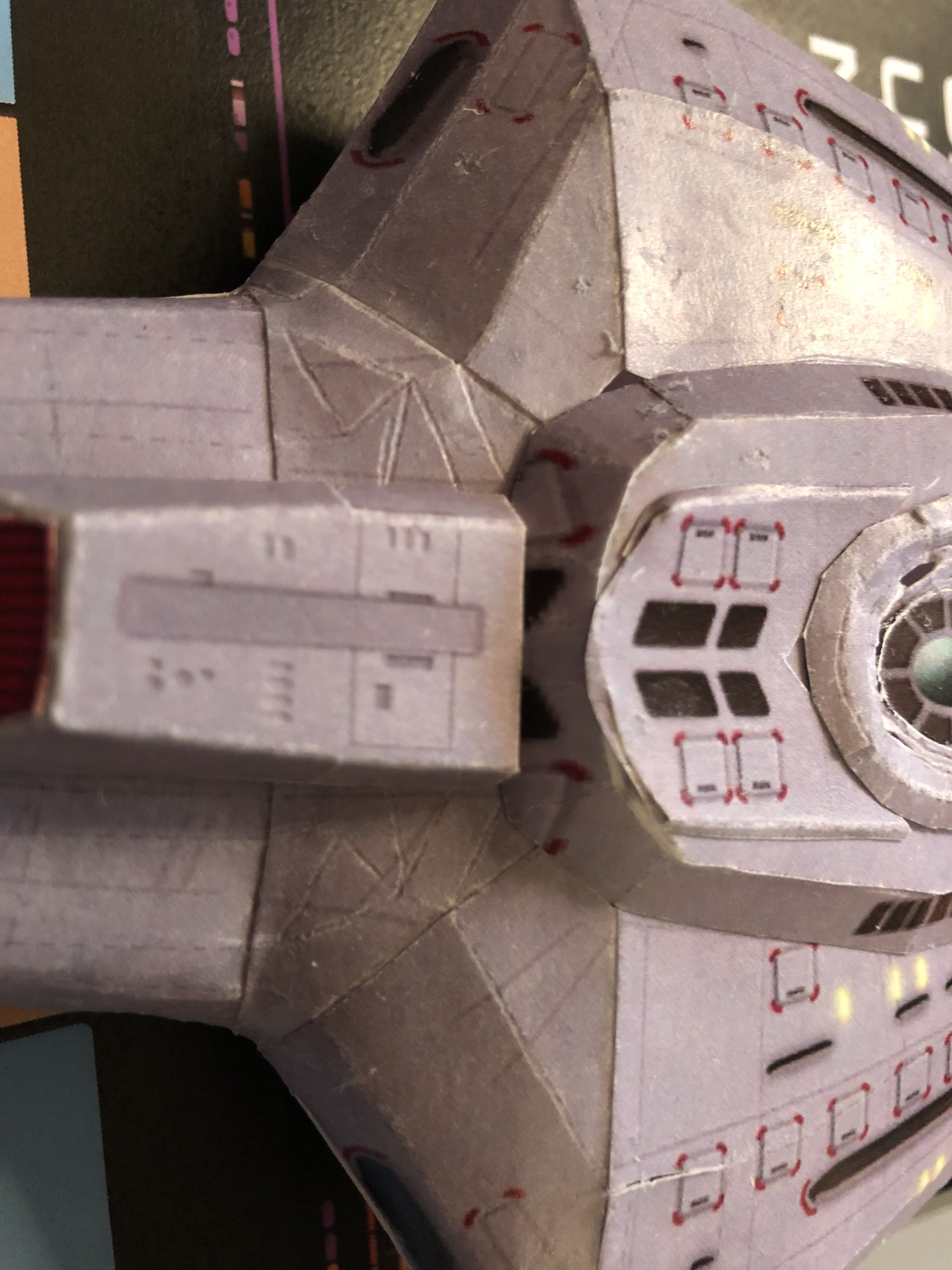

The command hulls also have challenges.
The lower, dorsal side of the forward hull, where the waverer shuttle is imbedded os smoother on the Clever kit [see pic 2]. This is a strength of the kit. The PSF kit needs some framing to hold this section from warping during the build. Part of the problem is that the deflector connection to the lower hull pulls the dorsal side of the upper-bow, creating structural warping. Compensating with framing would help, but the kit has serious fit-issues in this area. I would recommend test building with attention on how to compensate for the hulls-joining tension, possibly with cooped spacers?
