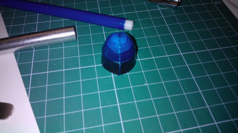

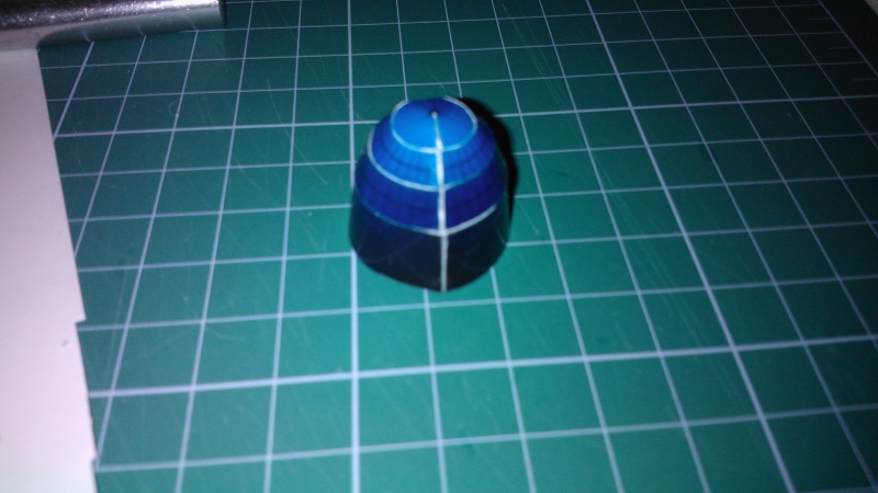

Hi
I'd like to show some "before and after" pics. I mean, before edge painting and after it. Just take a look on the improvement, but...
DON'T DO IT AFTER THE PIECE IS GLUED TO ANOTHER, unless the seam is made by edges of the same piece.

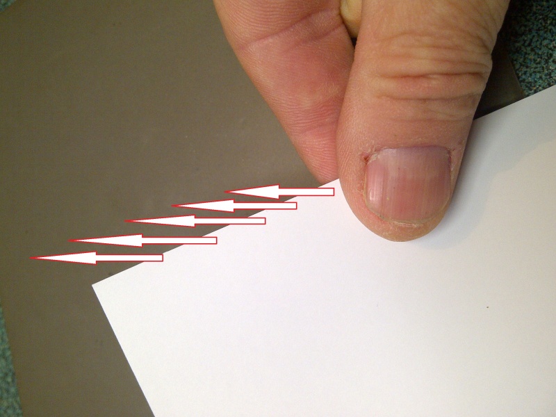

Edge colouring is important to hide the white paper on cut edges and joins.
Personally, I use marker pens and watercolours. Which type, depends on the subject, and the position of the joint.
Sometimes, I make the edge darker than the print colour, this enhances the join. Otherwise, use a LIGHTER colour than the print, if you want to 'blend' the joint. I say lighter because I have found that the glue darkens the hue slightly. I aslo colour the tabs along the colour edge too.
As you correctly stated, do not use too much water when edge clolouring with watercolour pencils. The edge soaks up the moisture real quick, and when you run the pencil along it, the action will turn the edge to mush. The technique I use involves letting the TIP of the pencil soak in water for about 15 seconds, shake the water off, wait a minute, then colour the edge. BE CAREFUL as you apply, the tip of the pencil will be soft and release a lot of pigment quickly as a paste. I then lick my finger, or thumb, and GENTLY run it along the edge to blend the pigment into the fibers of the paper. I then lick my thumb and finger and run the paper between my thumb and finger, using gentle pressure, running away from the edge. See motion depicted in the photo.
This helps to sharpen the edge and also remove any excess pigment on the print. The amount of moisture you need with your 'lick' depends on the print ink type. You want just enough to allow the moisture to pick up the excess pigment in your fingerprint, so to speak, but not damage the printed surface. The technique does work better on satin or glossy paper.
Repeat the process as necessary. Of course, you could use a DAMP cloth to moisten your fingers instead of your tongue (I walked around the city for 2 hours a few months ago, with a blue tongue. :eek:sign1)
Reload the tip of the pencil with moisture as required.
Remember, you want the majority of the moisture in the pigment, not the paper.
But, my best advice: PRACTICE!!!!! Until you get the feel for it. :cool:
Good luck, and dont be afraid to ask!! :mrgreen:
Oh, one other thing, edge colouring does add a heck of a lot of time to the build process, especially on intricate designs, as I well know with my current project: :mrgreen::rolleyes: http://www.zealotmodels.com/forum/showthread.php?t=173891

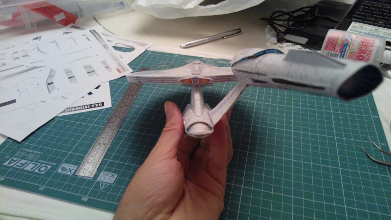

Lazy sunny day...

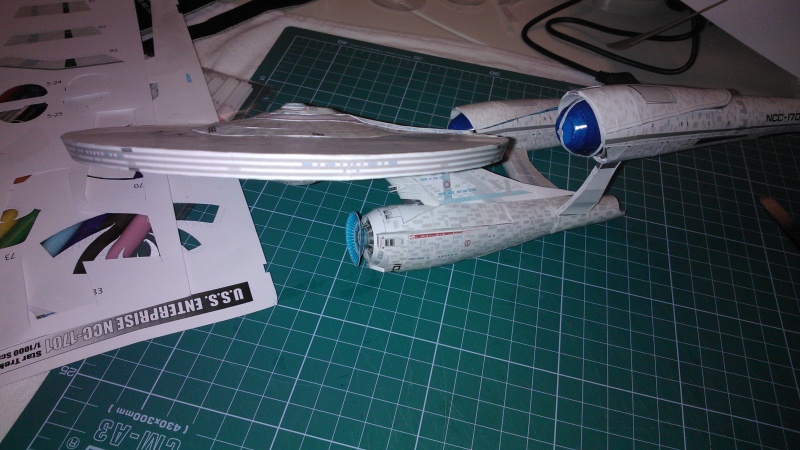

Hello,
Today I had to go out with my family. I just couldn't spend one more minute indoors:cry:!!
The thing is, I'm not very fond of Carnival:-|, so I try to keep a very low profile... But staying inside of the house for days reminds me somewhat of a jailbird!:p
Well, I managed to do something in the morning, before leaving. The attached photo shows it. Besides, remember pieces #88 and #89? They're the ones that close the back part of the outer arms (support to the nacelles).
Well, since they're REALLY thin, I decided to laminate them, in order to make their glueing easier and stiffer. For the port nacelle, no problem, since I have not assembled it yet, but for the starboard one... Hmmm...:v8: My faithful hairspray can, don't fail me now!sign1
I'll show it on the next post, if everything goes well.
Bye for now!:wave::thumb:
P.S. it's not so good, but she's a beauty, isn't she?

I understand that you are still rather new to paper modeling as a whole, but you are in fact doing a GREAT job. I can not see any problems, mistakes, or anything else wrong with it.
This model looks FANTASTIC!!!
I hope you (and your family) ENJOY yourself at Carnival.
Well done!

My friend and Mentor Rhaven Blaack,
Well, I'll give you that. It's beautiful, although I still have to line up the nacelles; one of them is tilted in relation to the other. They're not parallel yet, but they'll be.

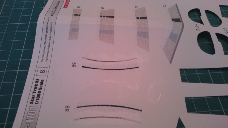

I'm doing that thing you once told me: if the piece is too small and/or thin, you can always laminate it to fulfill your needs. Problem is I only remembered your good advice AFTER I had glued it:cry:, and NOT sastified with the resultwall1.
Using my faithful hairspray can and a cotton swab, I have deglued and laminated it, and here's the pic.
I'll glue it back ASAP. Thanks for your good advice, and please, "keep it comin'"!

Thanks a lot, guys, but she's not finished yet! As I have said before: photos can be deceiving, so please take a look at it again, and you'll see that the port arm is still just bones...:rolleyes:
The great UHU02:inw: HAS designed a beautiful stand for it; I'll just have to print it again, for I have ruined it by laminating it with cardboard (2mm wrinkled) paper. Never mind, I'll have it ready by tomorrow, and will take lots of pics.
Almost there!:twisted:
yes, yes...
To close that gap in the support pylon, put a little glue in there and pinch it closed with a pair of tweezers or a clothespin.
Yes, Rhaven, you're right as usual, but I have taken the piece out in order to laminate it. I'll put it back ASAP, and your suggesstion will be carried out.

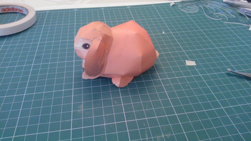

What the f...rabbit?
Sometimes you just have to put a work aside, and do other things, otherwise, everything may just go down the drain. I don't know about you, but I tend to get anxious when a model is coming to its completion, and it's inevitable to rush things up.
Well, haste brings no perfection, but the opposite. Mistake rate goes up and up, and all you can do is calm down and take it easy. Or you can do something else, and that's my case. Hence the rabbit on the picture.
It's a Holland Loop (I think) rabbit, designed by Ayumu Saito, free for download (with lots of other models) at http://cp.c-ij.com/en/
Besides, this rabbit is a gift for a girl that works as a janitor in my company, just to show appreciation for her hard work. And she's seen how amazing paper models can be, and asked me to build her a rabbit... or a cat.
I don't like cats, but do like the long-eared rodents:mrgreen:. And I promised her that I would give it to her after Carnival. You've gotta keep your promises:thumb:

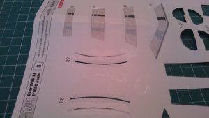

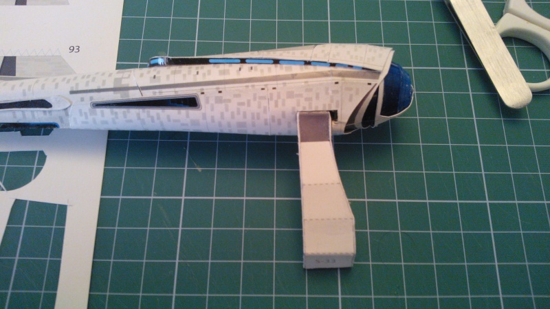

Back on track
Howdy!
We're getting close to the end. All I have to do is build the outer cover of the port support pylon (Thanks, Mentor!), align the nacelles, and build the display stand. Unfortunately, the display stand will be ready only tomorrow, after I have it reprinted.
If I didn't say it on the first time, then here it comes: you'd better fold the pieces of the outer pylons BEFORE cutting them (in my case, that's how it worked). Just like the pic below, which also shows the laminated back pieces.
You can see the folds on the paper. Please take a look.

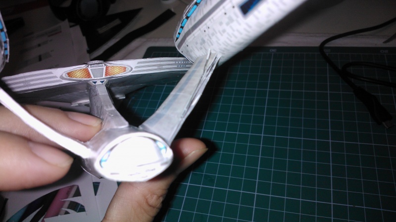

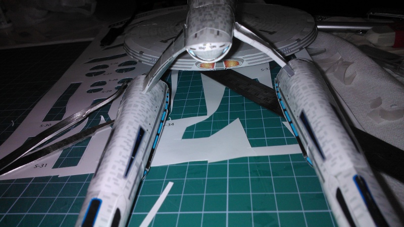

Gap
Yo
OK, gap on the starboard nacelle pylon officially closed. After laminating the piece, the results were much better than the first time. Here are the before and after photos for comparison.
The first pic shows how it was before lamination, and the second one is after it. The photos may not be so illustrative, but the closed gap now is a lot more smooth and even. Before, because of being too soft, part of the piece got "engulfed" by the two edges of the outer pylon. Besides, it was wrinkled too, creating another gap on its upper part. This has all been corrected now.:thumb:
