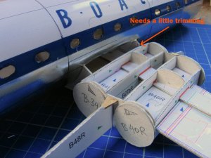

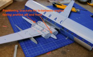

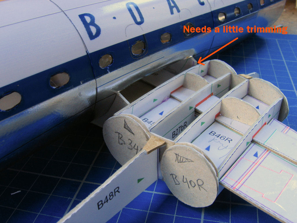

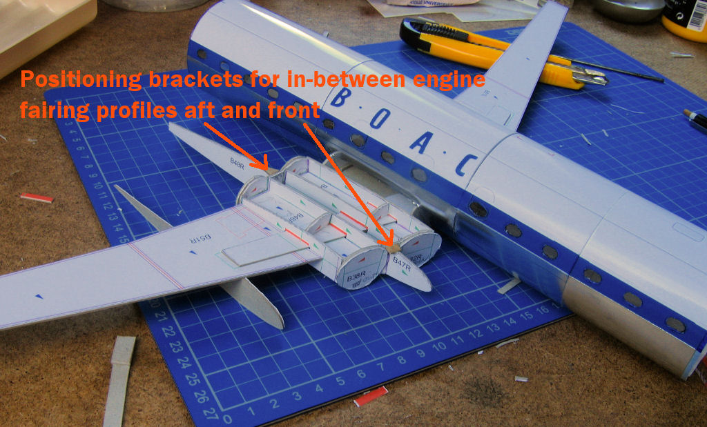

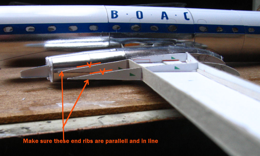

I built the Comet some time ago in the BOAC livery The fuselage is straightforwartd, but the engines integrated in the wing root are a special construction, see pic 1 where you see the root wing spars, with the first engine bulkheads attached. Then I attached the wing
planform, along which the outer wing spars are attached, nr 2 and 3. More to come

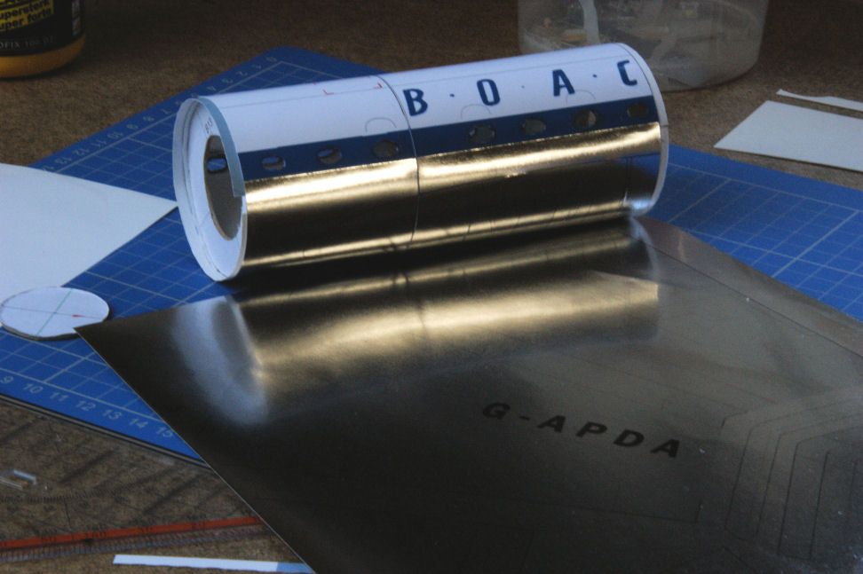

I used silver coated paper for the wings and underside of the fuselage. With Paint Shop Pro I divided the fuselage segments along the cheatline. The underside was printed on silver coated paper, and the top half of each segemt was printed on white photopaper in the colours of the cheatline. Sanding the seams would destroy the colour of the print. Maybe I should not have marked them with black feltliner, to make the seams less noticeable. Good observation!

I must comment that the blue lines on the internal structure are the positions they are intended to be cut to, if using 1mm card. In your photo the B51R is already outboard of where it should have been. It is not too late to fix this, good luck, and sorry for not providing clear instructions for it.
Reactions: zathros

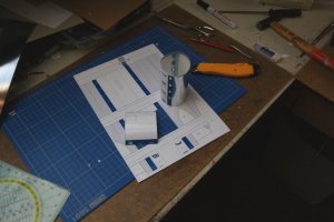

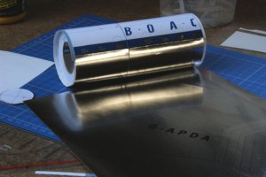

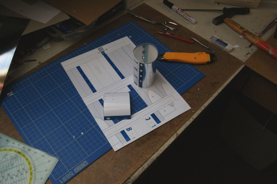

I mentioned making the fuselage of a top half and a bottom half. Here is how that works. The first pic is the part printed on normalk, white paper. I always let my local copy shop print this, their ink is light resistant (other than ink used in jet ink printers) and the colours really look nice.

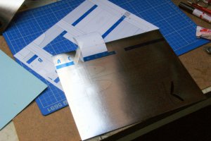

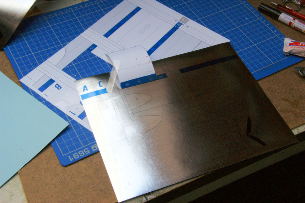

I also print the same part on silver coated paper, that I found on the internet, see pic 2. With a photo programme (PSP) I placed the the two bottom halves of the fuselage together at the seam that normally runs along the belly of the model. In that way I have one part that is the whole of the underside.

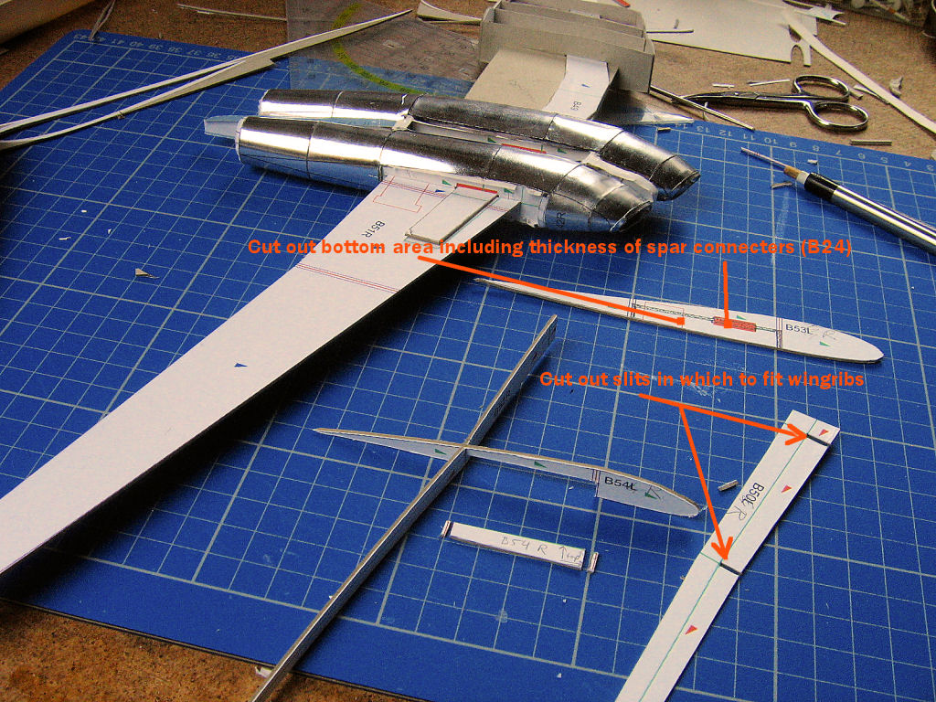

Now, I cut out the white part under the blue cheat line of pic 1. I also cut out the silver belly part of the same segment of pic 2. I then attach both parts together at the underside of the cheat line, and in that way I have a segment of the fuselage, that is correctly coloured on top and silver on the bottom, see pic 3.

I went to my local craft supply shop and bought a few chrome coloured papers, in size A-4. They call it art paper or Chromolux.
Spaceagent, what is a dollar tree in the pan section?? Sounds like I want to try that some time.
I usually get silvered paper from Hobby Lobby or Michaels' Sometimes it's even on sale. My wife buys their printed papers to change the the backgrounds in her Gecko tanks.

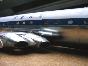

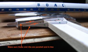

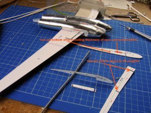

Some pictures on the wing construction, pic 1. I used a planform to keep the front and aft spars at their correct distance, and put in place the wing profiles with half way slits. That will facilitate the covering of the wing , as I will show in the next posting.

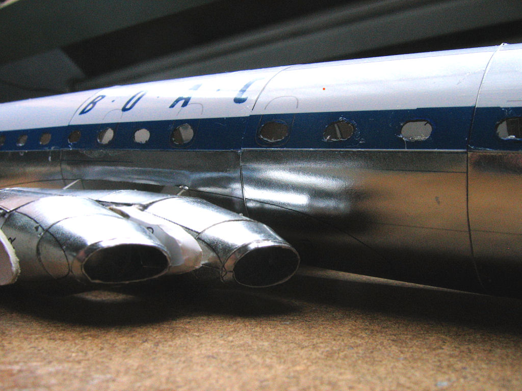

I love the way the engines are buried in the wingroots, so here is a view of the mighty engines. The silver coated paper gives a beautifull reflection.
