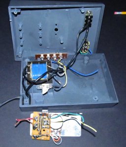

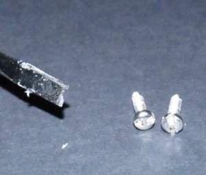

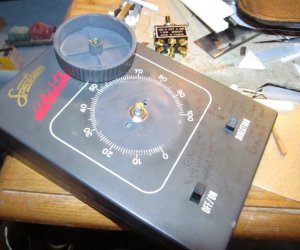

It took we a while to get to this next post. I flipped the unit upside down, and it had these tamper proof screws in it. Clearly the Bachman lawyers did not want me to open this puppy up. No matter. I could not tamper with the screws, so I tampered with a screw driver; using a grinding wheel on a dremil tool to cut a notch in the tip of a cheap screw driver. It did not work well, but with persistence it worked well enough. an alternative would have been to drill the heads off the tamper proof screws.
SAFETY NOTICE!! never open up a piece of electronics when it is plugged in. and be careful even if it is not. some items like televisions and computer monitors have capacitors, which can store an electric charge even when unplugged, one should have a pretty good idea of what is in there before opening. when in doubt, consult someone more knowledgeable on electronics than yourself .
Once I had it opened, I could identify all the goodies that were in there. One lead from the power chord went directly to the transformer, and the other lead went to the on / off switch, and then had a leg to the transformer. I left those leads intact. I would want power to the transformer, and being able to turn it off might come in handy.
On the other side of the transformer are the AC outputs. one of them goes directly to one of the AC accessories terminal. the other goes to that little glass vacuum tube alongside the transformer. That houses the overload protection. there is a bi metallic switch in there. it's normal position is closed. One of the reeds of the switch is made with two dissimilar metals, with the metal that expands the most due to heat on the inside. In an overload situation the excessive power running through the metal causes the bi metallic reed to curve away from the other contact; breaking the circuit, and hopefully preventing any damage to the rest of the circuit. we leave that thing alone, we like it. I'm old enough to remember when power packs did not come with overload protection; and you don't want to be without it.
From the overload protection switch the wire goes to the remaining AC outlet terminal. On the back side of each AC outlet terminal there was a wire that Jumpered off to the speed control and diode bridge assembly. I cut both of those wires flush with the terminal. the diode bridge/speed control unit will be mounted in the project box. I will fasten two of the wires in the four wire tether cable to the AC outlet terminal, and the other end of those two wires will fasten to the wires on the Diode bridge / speed control module that used to lead to the SC terminals (I'll provide a wiring diagram later).
The diode bridge / throttle control module also had wires running to the reversing switch. I cut those wires, and the wires from the reversing switch to the track terminals on the power pack. I left the reversing switch in the box. I won't use it ; I will use a better DPDT switch on the project box as a reversing switch. I will show how to wire it to make it into a reversing circuit later.
Having cracked open this puppy, I can see why it's got such good slow speed control. most power packs have a simple diode bridge to rectify the current (convert it from AC to DC) this has got a fancy circuit board in there, and a potentiometer instead of a rheostat. I could be wrong, but a rheostat takes full power DC and applies a varying amount of resistance to reduce the voltage. I'm thinking a potentiometer actually changes the voltage it self. Not sure about that, but what I do know is a rheostat has two terminals and A Potentiometer has three. I know how to wire a rheostat. got no idea how to wire a potentiometer, but hey; it's wired into a assembly with two wires in and two wires out; and I know how to deal with that.

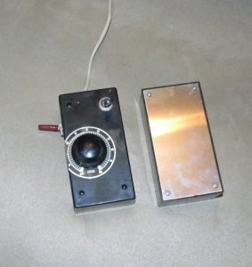

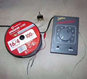

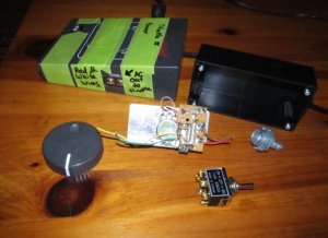

I have the power pack closed up, with masking tape, because I'm lazy, and did not want to re use those ***** tamper proof screws. the defective reverser switch has been removed along with the diode bridge/potentiometer Assembly; and the back has been taken off of the I have a big roll of indoor out door speaker wire . the wires are stranded, so they will be a little bit flexible, and it has the four conductors I need for the tethered throttle. two wires to take the AC power to the hand held controller, and two wires to carry the speed and direction controlled DC back to my electronics cabinet, an Army surplus moartar round ammo box, where one of the DC wires will attach to the common rail bus, and the other will be routed to the control panel on the dispatchers desk. these are documented in my main thread over in the logging Mining and industrial railroad section; but I will show photos of them here later so folks don't have to wander through some sixty pages of extraneous drivel to find the pertinent information.
right now routing the cable under my RR will be the hardest part of this job remaining. In my rebuild, my lowest deck is considerably lower than my previous plan. This has resulted in a decrease of storage room under the layout, at the same time the rebuild has added huge amounts of material. I have to try to feed this wire back behind all the ********, so I can fix it in one location, and test the reach of the cable before I cut it to size to ensure that the throttle will reach everywhere in the room where one might want to control a train. I love my memory walkaround throttles, but if this build is successful, this will probably be my favorite throttle, as I love good slow speed control that should be worth the hassle of dragging around 20 feet of cable.
long

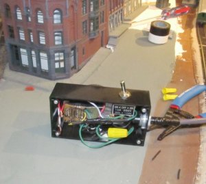

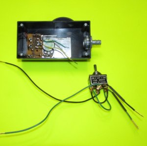

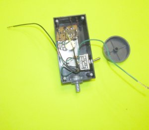

In the top photo, I have the diode bridge/potentiometer/heat sink mounted in the case with the support for the cable entry fastened into the case. The DPDT switch is wired as a reversing switch. the short leads on one end are the inputs from the potentiometer/ diode bridge assembaly. they are hooked to one end of the DPDT switch, and then cross over to opposite corner of the switch the output wires come off the middle terminals
here the components are all in the case; the black and green wires will go to the wires out of the throttle, and the AC in wires on the teathering cable will go to the nearly invisible brown and red wires comming off the diode bridge circuit board. I have the cable routed through the messy train room; so tommorow, if I have time , I can hook the throttle up to the teather cable, and hook the teather cable to the base unit, the common rail buss, and one of the throttle inputs to the control pannel. Throttle #2 is an Aristocraft radio throttle that has been flakey; and I will likey make this either throttle #1 or throttle #2 , as if this works it will likely be one of my favorates, cause I love slow speed control.

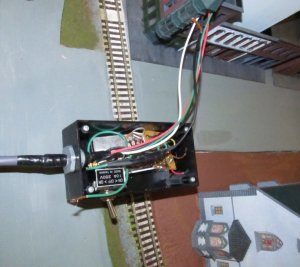

I got in a good nap after church on Sunday, and still had some time to get that firewood on the porch, and route the cable from my electronics cabinet to the end of my central peninsula. I left a lot of slack in the cable between the layout edge, and the electronics box, so If I have to re route it up down or sideways under the layout for any reason in the future, I have some slack to work with. Then I tied a loose not in the cable just inside the layout, and used a wire clip inside the lose knot to secure the cable end at the layout edge, so tugging on the cable there will not remove the slack under the layout. with one end of the cable secured to the layout near the center of the central peninsula , I unrolled the cable off the spool till I could reach the farthest edge of the layout; and then added about six feet for good luck, and cut the cable.
I striped the outer insulation off of the cable leaving about eight inches of wire hanging out the outer cable insulation. Then I fed the cable through the metal fitting at the top end of the project box. I wrapped electrical tape around the end of the outer insulation until the cable could not be pulled back through the metal fitting on top of the project case. then with the cable pulled tight against the project case I wrapped electrical tape around the end of the fitting, continuing for a short distance down the cable securely attaching the project box, now a throttle, to the cable. I stripped a little bit of insulation off the wires in the cable, after cutting them close to size. You always want to have a little extra wire in case you mess up; but you don't want a lot of extra wire, because you want to fit everything in the box.
The output wires from the reversing switch to the cable I twisted together and attached them with wire nuts. the input wires to the diode bridge and Potentiometer circuit board are smaller, and the wire nuts I have wouldn't grab. that is probably irrelevant, as at that end of the box I don't think there is room for the wire nuts anyway. I have twisted those wires together, and will solder them together, and cover the joint with heat shrink.

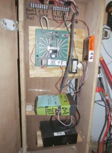

This is the inside of my main electronics cabinet. It is a Military surplus crate made to hold ammunition. I think this one is marked for mortar rounds, but I have one almost identical to it that looks to be marked for small arms rounds. I'm going to cut down the other one to hold my two GML walk around throttles,, and I will fasten it to the top of this cabinet.
The vertical gray cable is the cable to the new hand held controller. the white, and red wires are connected to the AC/ accessories terminal on the Bachman power pack's case. the blue post it note on the case has notes about what color wires go where. later I will transfer that info to the masking tape on the power pack with a laundry pen. I wasn't going to do that until I had the unit working, and was sure I had not messed something up

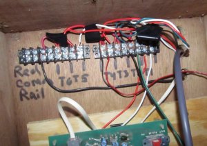

This photo shows the throttle hook up terminal in the main electronics cabinet. My control panel has 6 position rotary switches. I'm unlikely to ever have six throttles; six operators would be elbows to ***holes in my aisles, I have five throttles, only three are hooked up right now, but the cabinet, and the control panel are wired for six, in case I loose my tiny little mind.
at the throttle hook up terminal, I have spaces to hook up two wires from each throttle. across the top of the terminal strip I have red wires daisy chained from every other terminal, to create the feed to the common rail. the solitary black wire is the wire that goes out, and makes a complete circuit of the RR, feeding the common wire for each and every block. the terminal for the control wire from each throlle is hooked to a wire that goes to the back side of the control panel

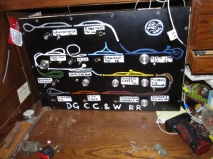

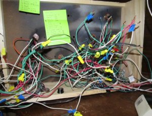

Here is the back of the control panel. this looks worse than it is. there is a terminal strip for the control wires for each possible throttle, for a total of six wires in. I have 14 blocks shown here, and will probably add one more. each block has a six position rotary switch. each of the 6 control wires for the throttles is hooked to the appropriate terminals of each block's rotary switch. the output wire from each rotary switch is routed through an on / off switch (so each block can be turned off), and then to the output terminal strip, where there is one terminal for each of the eventual 15 blocks. I'm going to re work the labels on the control panel with printed stick on letters and numbers to neaten it up. The control panel is in a very nice modern roll top desk, that was made to hold a computer
