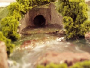

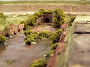

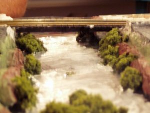

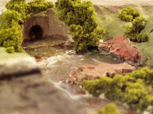

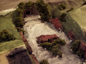

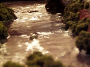

Here is the step by step.

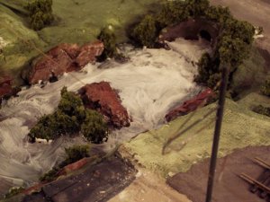

After it had all gone flat and dry.

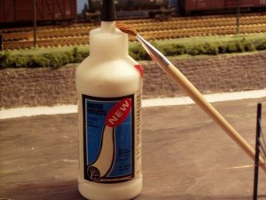

I got my paint brush and the bottle of WS water effect and got cracking.
These first pictures are of the initial application.
(big words for the start)
As you see it goes on white, boy it`s scary

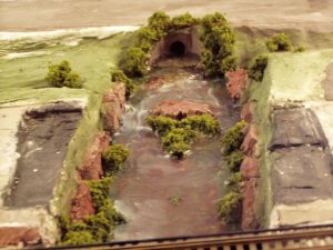

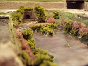

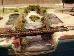

Then after 24hrs or so we have these pictures
Here are more pictures from different angles to catch the waves so to speak.
And the last pics
All that with a paint brush.

I just ordered the culverts. My little creek is going to come from off the layout and go under a road and then go back off the layout. I think that I am going to brop the creek down in the table because it is a very small space and I don' have room for a bridge + the 2 mainlines are right there so there are 2 gradecrossings right next to the mini creek. Post some pictures when I start.
Hey Chris, that WS water effect stuff really has something to it! I'll give it a try, too, when I come to put in some creek scenery.
Your creek surely looks outstandingly great! And you say, that scenery isn't your strongest point. Wow! Now I wonder what might be your strong points??? :D:D:D

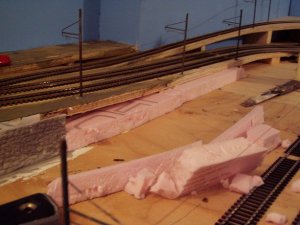

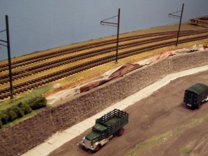

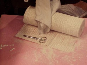

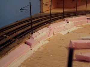

Hiding the plywood or scenery work

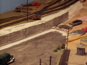

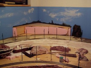

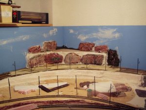

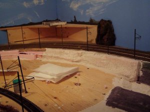

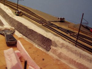

Well it`s back to basics.
Filling in and making it come alive.
I use 1" foam / inpregnated plaster cloth/ and rocks from my old Layout .

I also have a hard to reach area, this section I am thinking of making a winter scene.
First I have to "Rock it".:rolleyes:

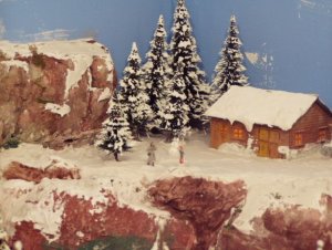

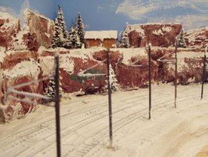

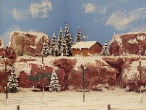

So no one is intrested in a snow scene.
Well I am so here is a 5 ft corner I just put together.
It is not finished yet

Hey Chris,
That winter scene looks great! I especially like the ice hanging over the edge of the roof. Those little details make all the difference.....I just read this entire thread:eek:.....WOW! What a project! Have you posted the track plan? How big is this LO? Keep up the good work and keep posting!:thumb:

Iron Horse said:
Can you give a simple how-to on the winter scene ? What did you use ? It looks great.
Thanks Iron Horse:)
The pictures show the corner formation with the rocks from several rock molds.
I use pollyfiller, which is mixed to a sloppier mixture than normal.
Have a small vessel of water and small paint brush ready.
Then start plastering the snow put some whereever you think a snow storm would drop it , moutain tops etc, the cabin got the overhang snow look, the snowed trees I bought two years ago for $12 canadian.
The tracks I just dumped it over in sections then worked the plaster along with a very wet paint brush so you could see the road bed.
It took about two hours to get it right with three mixes of polly filler.
After it dried I used a jewelers flat screwdriver to clear the inside rails.
Does that lot make sense??
Hope it helps Iron Horse:thumb:
