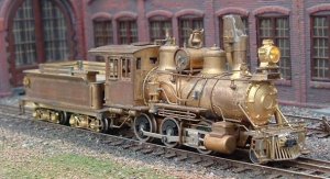

My first brass piece is all the above, cantankerous, ornery, corroded....but I wouldn't have it any other way. It's a United/PFM C&S 2-6-0 Mogul in HOn3 that I was given for helping settle a fellow modeler's estate.
