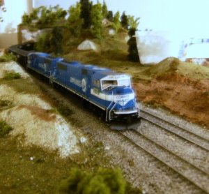

I also got a great deal on a set of SD70MACs from ebay. These are now used on my New Hampshire "Bow Coal" train.
