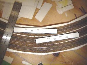

Well, here's a little bit of my experience:
My garage layout uses 15" min. radius turns and I've had 2 sd80macs meet head on and pass each other with plenty of room. I've also sent a string of husky stacks and same thing, plenty of room. The overhang is noticeable, but it's not so bad.
On another note, the same sd80mac's can pull cars around an 11" radius curve - again without problems. The overhang on that is pretty bad, but the running of the train was very smooth. If you get a decoupling on a curve, it's usually not able to be recoupled on such a tight space... I've had to "push" all the cars back onto a straight section before it would "catch" again. However, there's many factors involved here besides the curve, such as Micro-Trains to Accumate coupling, etc.
Bottom line is, I think you will be fine with your track spacing, but to be sure, I would tack down two pieces of flex track along those radii and just "push" a string of cars along both tracks and see what happens. If you don't feel comfortable, it's not a big deal to go to 1.5" spacing along those ends.
P.S. I just went to the garage and put 2 Bombardier Coach Commuter cars - one on the 15" radius and one on the next radius - 1.25" inches larger. I took a picture for your reference. This is as close as they get... plenty of room. Figure a little less room since your second track will be on the inside, instead... but keep in mind, these cars are 6.5" long! :)

Thanks Arlaghan!! That's some VERY useful information...and a picture is worth a thousand words!! How long are those commuter cars compared to autoracks? Autoracks are probably about the longest things I'll ever be running. I think they're either 85 or 89 scale feet long....don't remember which....but that comes out to 6.375" or 6.675", respectively.
I wish I could make the curves with a larger radius, but unfortunately my benchwork can't go any wider.
