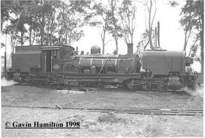

Maybe it looks a little like this.....

and a shay bolier would be WAY too small! the whole point of the Garrat was to carry as much of the weight as possible over the diving axles, spreading the weight as much as possible for lines which could only take light axle loadings (examples being most african naoorw gauge lines) whilst still allowing for the biggest possible bioler the loading gauge allowed so you should actually be looking at a full size boiler from something like a Mountain or Mike otherwise its NOT a Garratt!
to give you an idea of the boiler size - this is a Welsh 2ft 6" gauge re-patriated Garratt known as an NGG16 class. the size of the boiler is obvious when you see the size of the man in the cab in comparison.
