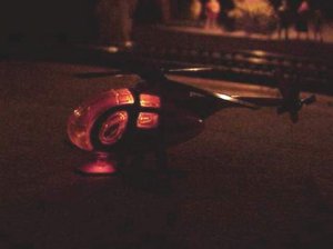

Well, I finally got my first LED street lamp made! Then I attacked the helicopter and here they are. Am I learning or what? Thank you to all for your knowledge that you have pasted on this site. I may be slow, but I am getting it done!

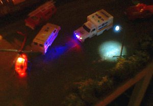

LED Lamp
Thank you again for your good words every one.
Pitchwife, Someone on this site ( HO scale trains) left thier link to thier own site and it was there that I learned about the LED lamp poles. I don't remember who it was thou!
Any way here is a drawing on what I did.
I also played with several resistors ( 4.7k 1\4 watt down to 3.3K 1\4 watt) and found that the 3.3K ohm resistor worked the best for me, good and bright!! The LED's are 3.8 volts.
After I completed construction of poles I taped off the LED itself and spray painted the poles and the LED "leads" a light gray color. That was it!
I power all my goodies with a 50 amp, 0 to 15 volt DC power supply.

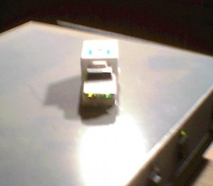

lighted transport wagon
Ok, I went all this time. I took my EMS transport wagon, ripped it apart, then added lights under the hood. I installed 4 LED's ( 1 of each - bl,rd, yel and green)that all flash simultaneously with a flash rate of 10 fps. So tell me what you think!
The second photo shows the green and yellow as both on, but thier not! :thumb:
