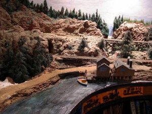

Here in South Africa we have some very very hot sunshine that ruins our Cars (auto's ) so someone came up with a material called " Shade Cloth " a fine mesh nylon type material
I make up an armature of card board strips cover it with shade cloth push in a lot of "umps and ollows " which it retains, mix up a batch of Dry Wall plaster, with a dash of dishwasher liquid added ( Helps retard the plaster drying ) carve out some rock faces ,paint on a coat of earth coloured poster paint whilst its wet and its what I call easy scenery as seen in the photo :) :) :)
