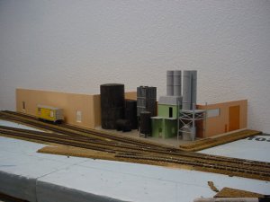

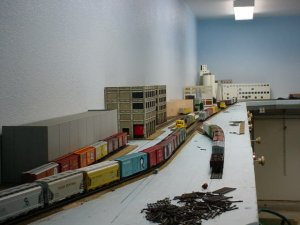

Here's a pic of the building and another shot of my long shelf. The industries are taking shape!

Your layout is looking good. I really like those buildings your making. I wish I had room for something like that. Isn't putting those ties in a pain?

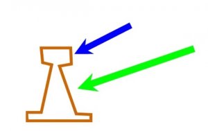

Another question for you: The little bit of rail I painted today, I found to be real easy. The paint brush would fit right in the groove on the side of the rail. I did not paint the side of the top of the track. I included a drawing of what I am talking about. Where the blue arrow is, I did not paint. Where the green arrow is, I did paint. Really I should paint the entire side, but it sure was easy to just put the paintbrush in the groove and go. A
Any thoughts on not painting the side of the "top" of the rail? It looks okay to me.
