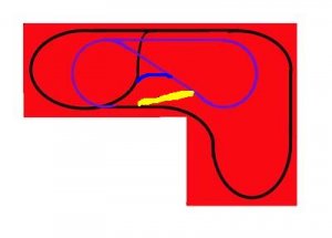

It's been a disapointing day for me. I suppose I need to be more patient. I have my entire track laid an spiked down and about 40% of my terrain is even built. Whats the problem you ask? I didn't give it much thought until doing a little reading up on wiring and realized that my track layout is reverse looped!
Here is a basic draw up of my layout.
The track lines shown in black are the upper level of the layout and the incline / decline part of the layout. The blue track lines are the lower (ground level) tracks. As you see I have a problem with the reverse loops. I really don't feel like flipping switches and what not. So, I imagine I'll start ripping apart all the terrain I have already laid out that will be in the way, and start laying a second row of track. Pretty disapointing.
I'm not familiar (obviously) with the different options for running reverse loops but a couple Ive read require you to flip switches which is not what I'm looking for. I wanna be able to sit back and watch the trains roll by. Maybe I'll check into that DCC after all.
Just what I was looking for zedob! :thumb: I actually think I'm going to get the AR-2 model which would allow me to pause the train if I like. You saved the day for me! I was just about to start ripping things apart...like I said..."I suppose I need to be more patient". It's a good thing this happened though. Now, before I go any farther, I'm going to review my plans for the layout and make sure I don't hit anymore hang ups along the way because of lack of planning well. I'm just glad I don't have to tear anything up because it would have been a total loss. My road bed is glued down and the track joints are already soldered. It would have been a mess. Doubt I could have salvaged much. Whew!! Thanks again.
After further research I decided to order the VSC Realroads "Majic Motorman". It's about 120 beans but I figured that it would be well worth it since I don't have to worry about sensors to change the polarity and thus not needing to worry about the placement of the sensor. since. The Majic motorman automatically senses polarity changes in the track and reverses it. It also has inputs for sensors should I decide to add a stop along the way inside the loop. Sounds like a winner to me.

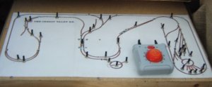

Wired for DC, with 36 switches which control the 36 blocks and also the direction of travel. This way I can have 2 trains going opposite directions on one controller, while the Yard man can maneuver with his own controller, he has only 16 block switches.
NOTE: as soon as I can afford it, I will be replaceing the Bachmann transformer.... I do not like it's "control" over the locomotives.

You only have one reverse loop that I see. The left leg of the "Y" in the upper middle of your layout. Just disconnect it, or change the bottom switch of the "y" into a crossover and connect the other end of the track coming from the upper left up with the lower right portion of your middle loop area. Just be careful which way you connect it up, it should be so that a train going counter clockwise on that middle loop goes on a switch that leads back up to the old left leg of the "y".
The only other area that might be a reverse loop is the far upper right which looks like the upper part of the loop almost touches the lower part of that loop. If instead that area is joined by two switches, just remove them and have the lower part of the loop be a seperate track.
I hope my verbiage is understandable...
take the purple track with the reverse loop so inside connecting tothe same track over, connect it to the dark track in one of the spots I drew in. hope this pic works.
or learn to wire the reverse loop so that it works for you.

Maybe these pics will help you guys understand my layout a little better. It would be hard to understand the first image I posted unless I was able to make it 3 dimensional. Okay, lets see here...... Pic #1 shows the track layout outlined in colors. The green lines represent the Upper level of the layout and the incline/decline part of the track. There is a red line that covers part of the green and this is where the trestle bridge will be and is part of the first loop which is about 11" above the the lower level (sorry about the pole in the way, imagine it's not there, my basement is small). The purple line represents the lower level of the track and has the second loop in it and another turnout that traverses through the mountain and to the rail yard (Rail yard not pictured) . The second picture shows the track without the lines but with two red dots with green arrows pointing at them where the trestle bridge ties into the track and shows how it spans over the lower level track. I apologize for the mess and I hope it helps you guys better understand how it is laid out. Basically the track has a loop at both ends. One loop is on the ground level the other loop is on the mountain and the rest of the loop will be the trestle bridge. Hope that helps.
I think I pretty much have the wiring figured out. Using Realroads "Majic Motorman" I simply follow the diagram below. Looks simple enough.
I see the advantage of the reverse loops in your plan. They provide a nice long mainline run and a way to have continuous running. Good luck with the Majic motorman. Tell us how it works out.

Zedob, then you would not want to control my layout...
Sure I would. I like lots of switches and buttons. It makes anything look that much cooler:D . I just don't like to wire them.:p
Nice panel BTW.
