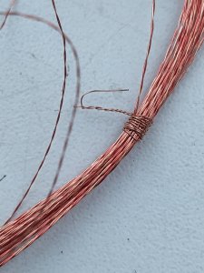

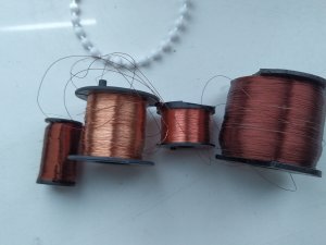

To connect smd LEDs, I use awg35 (~ 0.14mm) or awg38 (0.1mm) magnet wires (enameled wire). There are even thinner wires, but they break easily. These wires are easy to buy with a small spool or you can get it from an electromagnetic relay. A big plus of these wires is that they already have insulation, but tinning is a little more difficult.
If you find wires with different colors of insulation, it will be even better and more convenient in the assembly process, you don't have to look for a cathode and anode.

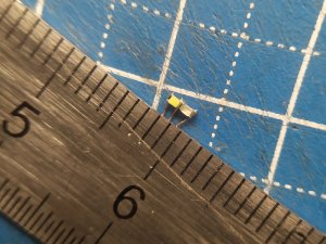

Also, to solder SMD LEDs, you need to have a good magnifying glass and a thin soldering iron tip.
An example of my soldering of paired 0402 LEDs for the wing navigation lights and strobe of a 144 scale airplane plastic model.

I have 3 colors of enamel, transparent, red and dark brown. This helps to determine which wire to connect to where, without resorting to determining the cathode and anode after laying the wires in the model. when the model is almost assembled and a huge number of wires come to one place, it is very difficult to understand them.
This is how the wires look in which the cathode and anode are clearly visible.
