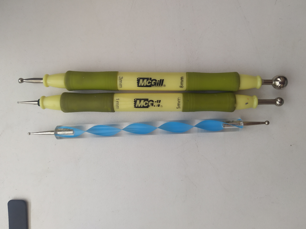

For me, when building uhu02 models, UPM Color Fine 190 gr paper is ideal. It has a thickness of 0.19-0.22mm, it is suitable for laser printing, and it molds very well. This paper is very similar to the paper used by publishers.
II use Apel D3 PVA glue, it is very high quality, transparent, and very fast drying glue. I also use cyanoacrylate adhesives in liquid and gel form.
It is better to use X-Acro or Olfa knives. I also advise you to search McGill - Paper blossoms tool kit. I use 1 mm for a perfect straight folding lines, all other diameters for forming rounded parts.
Reactions: cecilmeyer
There is a cheaper alternative to McGill tools, this is the nail stylist tool. They paint patterns on the nails. But they are not so comfortable in use if you do a lot of folding lines, and tip diameters only up to 2 mm.
Thanks !!!
Another tip, I use a whiteboard sponge and a tube to shape the cylindrical parts. You just need to roll the part on a soft sponge.
I also recommend finding leather punches. For super small diameters are suitable: reusable medical needles and metal tubes from broken RC helicopters

It is the ideal kit for forming complex parts. Only I'm not sure about black tools, they look like plastic ones and won't work as they should. I have the ones with the blue handle. And wooden tools are very similar to nail stylists tools.
