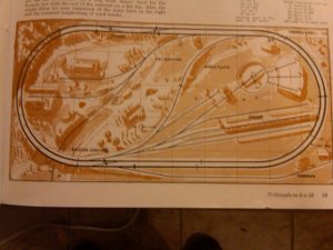

my layout
hope this helpse fred.

Here is my guess at gapping for the reversing section (gaps in both rails at the points in red). Power for the reversing section comes through the Atlas Controller, and nowhere else. Power for the rest of the track likely comes from the Atlas Controller, and then through your block selectors (usually Atlas Selectors if using Atlas components).
After studying the track plan, optimum location of the gaps (or insulated rail joiners) depends on several factors:
  • the reversing section must be longer than the longest train you will reverse. The train must be totally in the reversing section when you change the direction on the main. You can extend the reversing section around the inner loop to make it longer. You can use less of the inner loop curve to make it shorter.
  • if trains will be following each other on the same loop, you need at least 4 electrical blocks on the loop. If there are only 3 blocks on the loop, then the following train has to stop and wait for the train in front to clear the next block.
  • electrical blocks should normally be a little longer than the length of a normal train.
  • whether you use power routing turnouts or not determines whether separate blocks are needed for the dead end tracks (spurs). Atlas turnouts are NOT power routing.
The above is why I strongly recommend a book on model railroad wiring. To make your control system as flexible and trouble-free as it can be means you have to understand the "whys" of gaps and blocks. Teaching you the "whys" is beyond the ability of short (or even long) posts on a thread like this without some other reading by you. The Atlas book is the cheapest, and has specifics on the Atlas Controller, which the other books do not.
