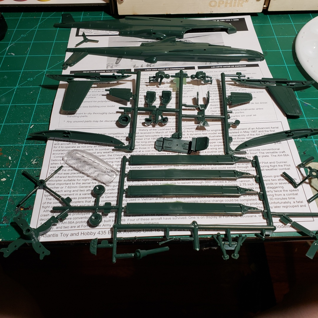

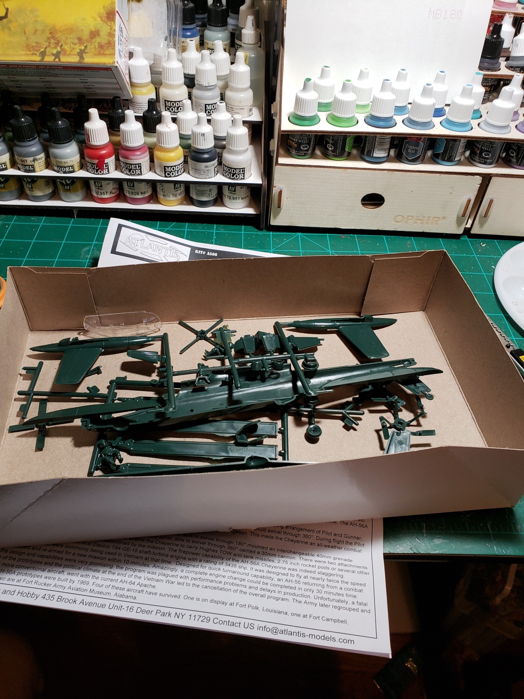

What's in the box,
2 sprues of a green plastic, I loose rear propeller, 1 loose clear canopy, instruction sheet, decals, and an advertisement for IPMS.
This is a repop by Atlantis of the ancient (early 70's) Aroura molds. Atlantis salvaged the molds, cleaned them up, and are reissuing the kits.
knowing this, the level of detail in the parts, and amount of flash present on the sprues is accepable.

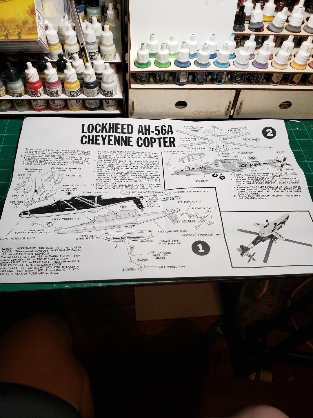

front page of instructions with a b&w copy of box art, and a brief history of the subject.
Instruction sheet folded out.
I will say that I am not a fan of these one page, exploded drawings as instructions... but I can understand, it's supposed to add to the period appeal of the kit.
The back of the instruction sheet is the decal placement guide, with pics of the finished model to show where they go.

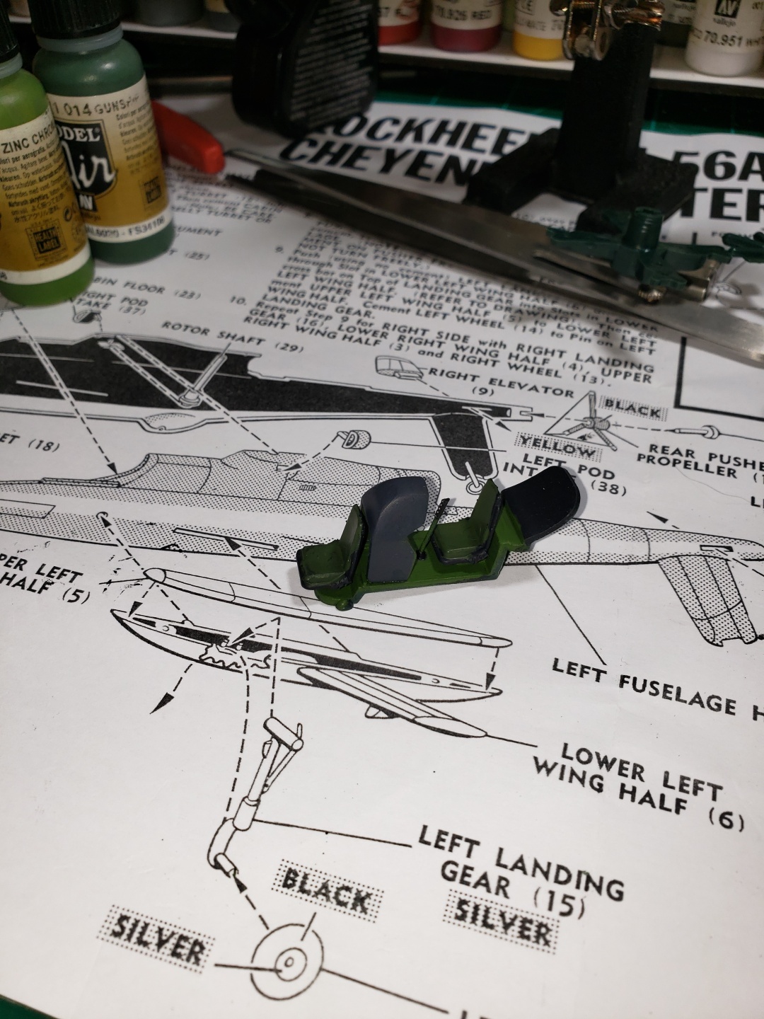

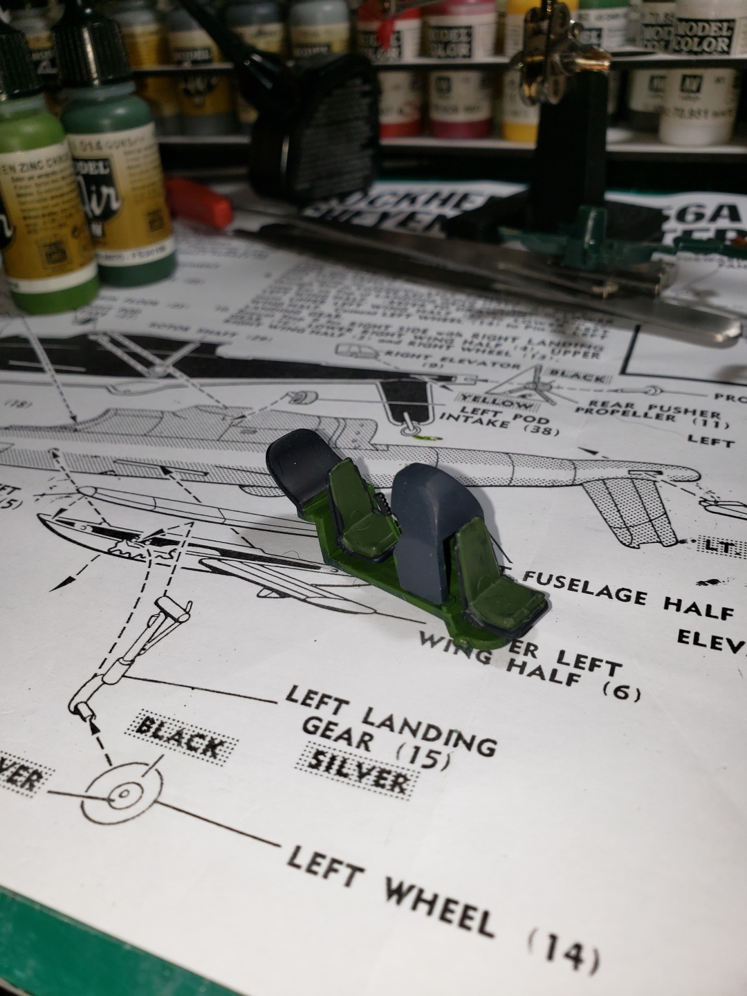

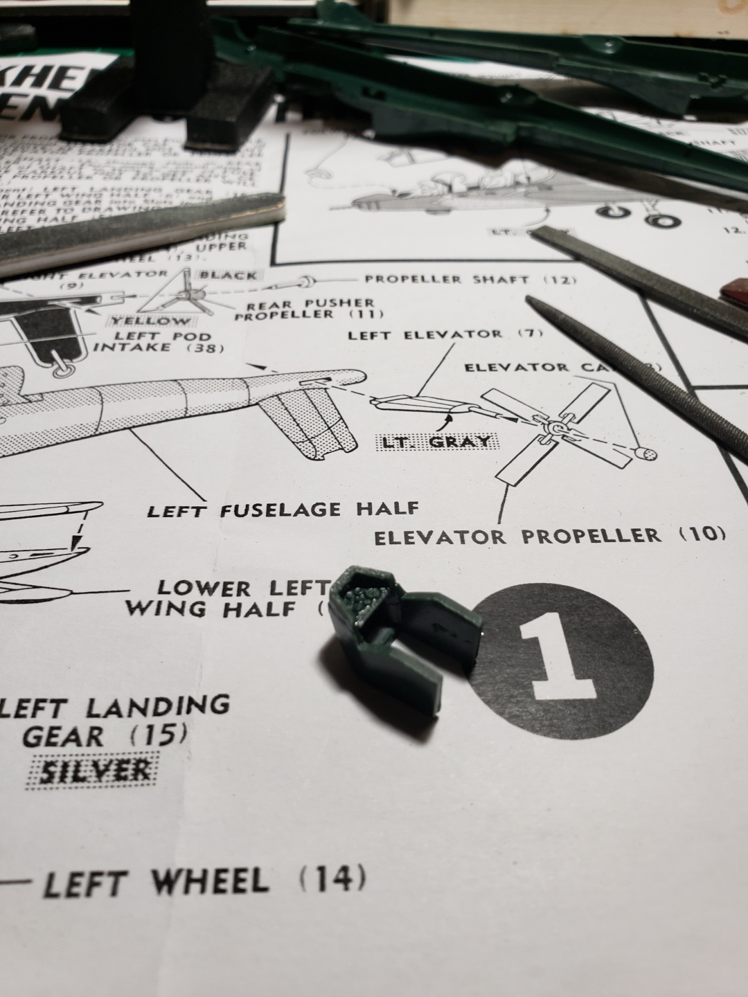

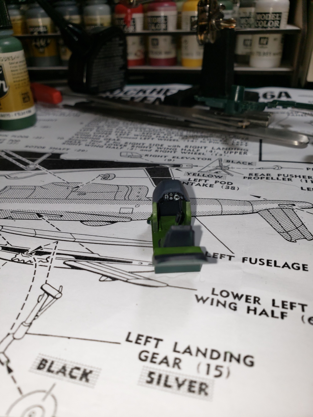

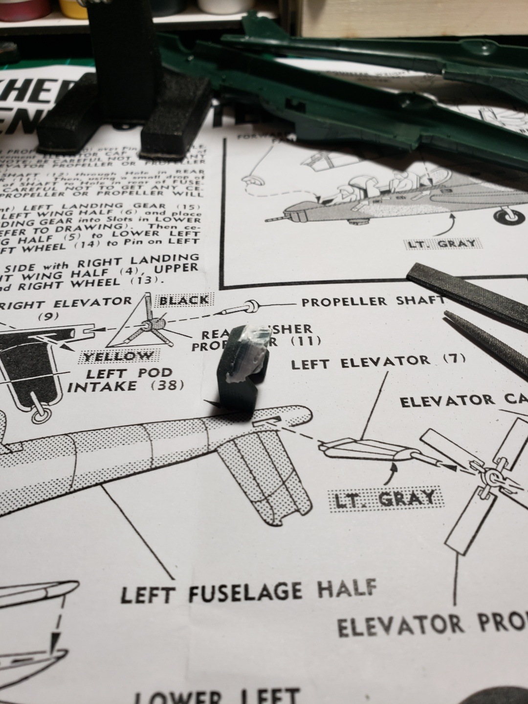

Got he cockpit tub assembled,
20200716_170002_resized.jpg 20200716_170007_resized.jpg 20200716_170013_resized.jpg

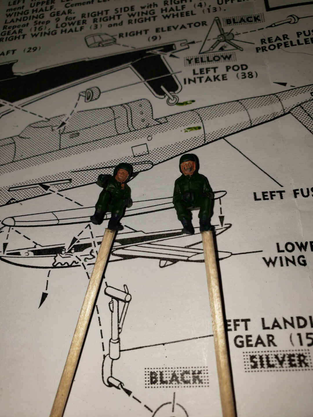

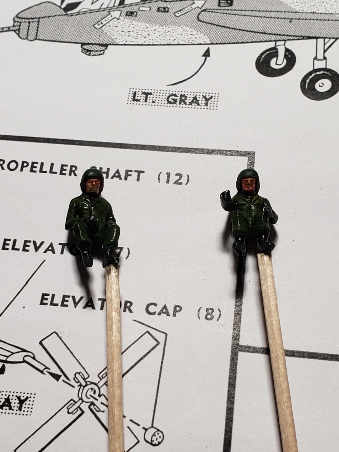

working on painting the crew,

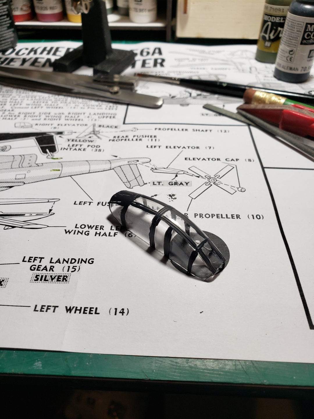

first color (inner) on the canopy, it has 2 ejector pin marks, but I'm out of plastic polish, and no funds to buy more right now, so they stay. :(

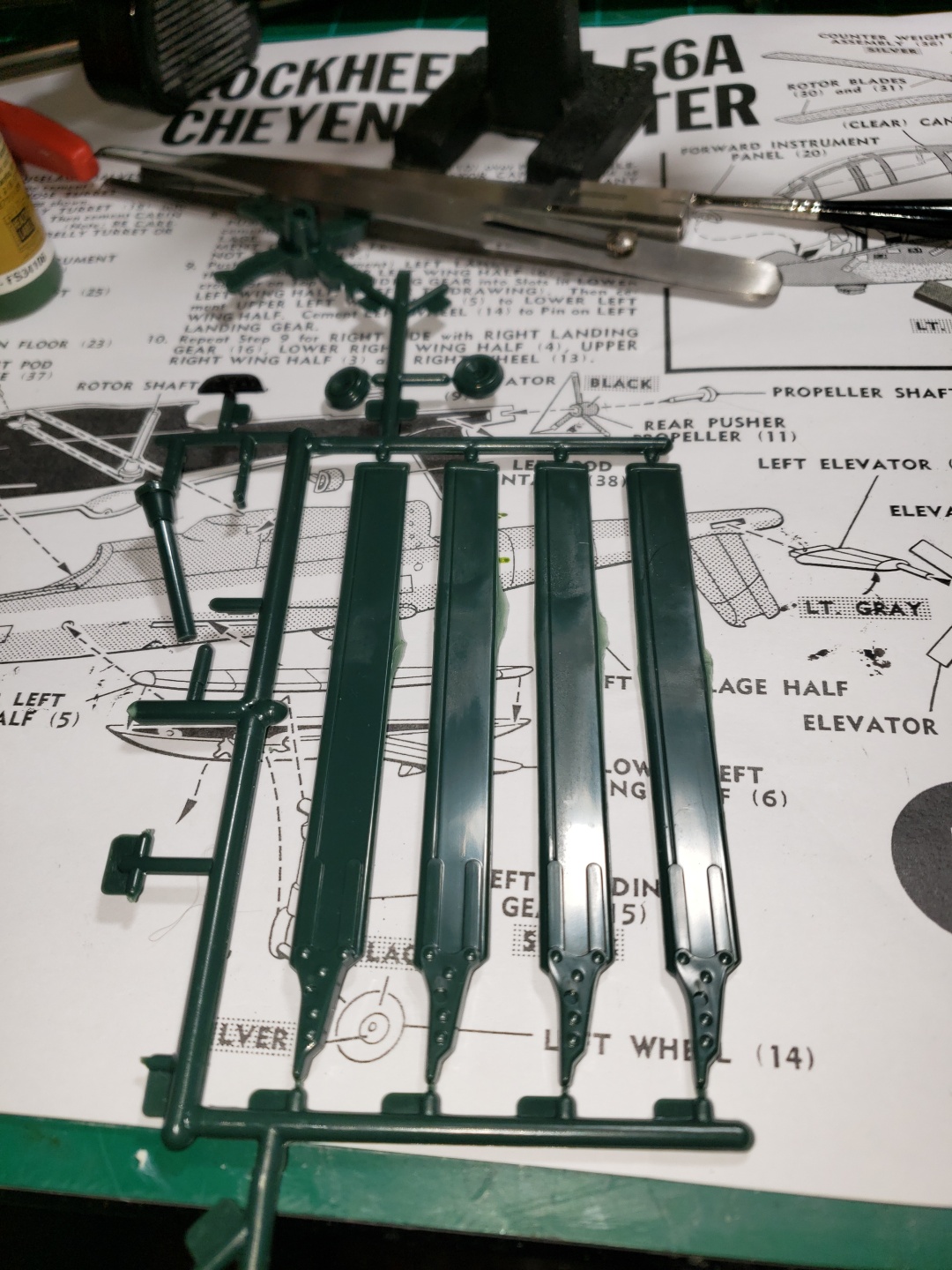

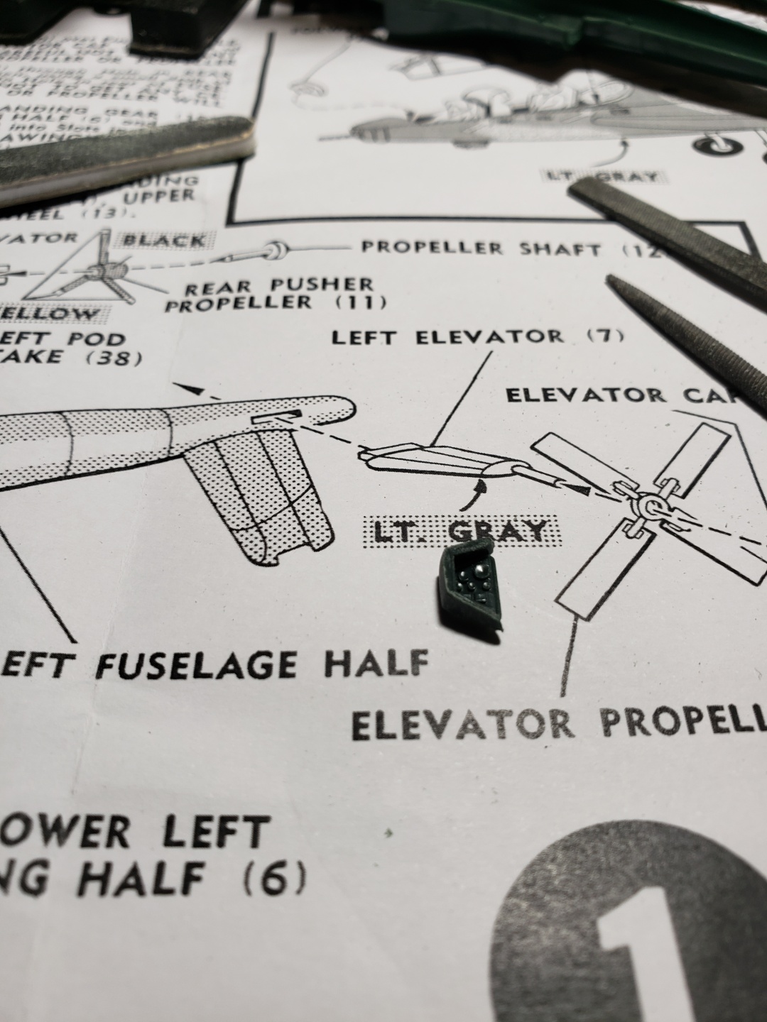

You can see the flash on the rotor blades, but it can be easily trimmed off.

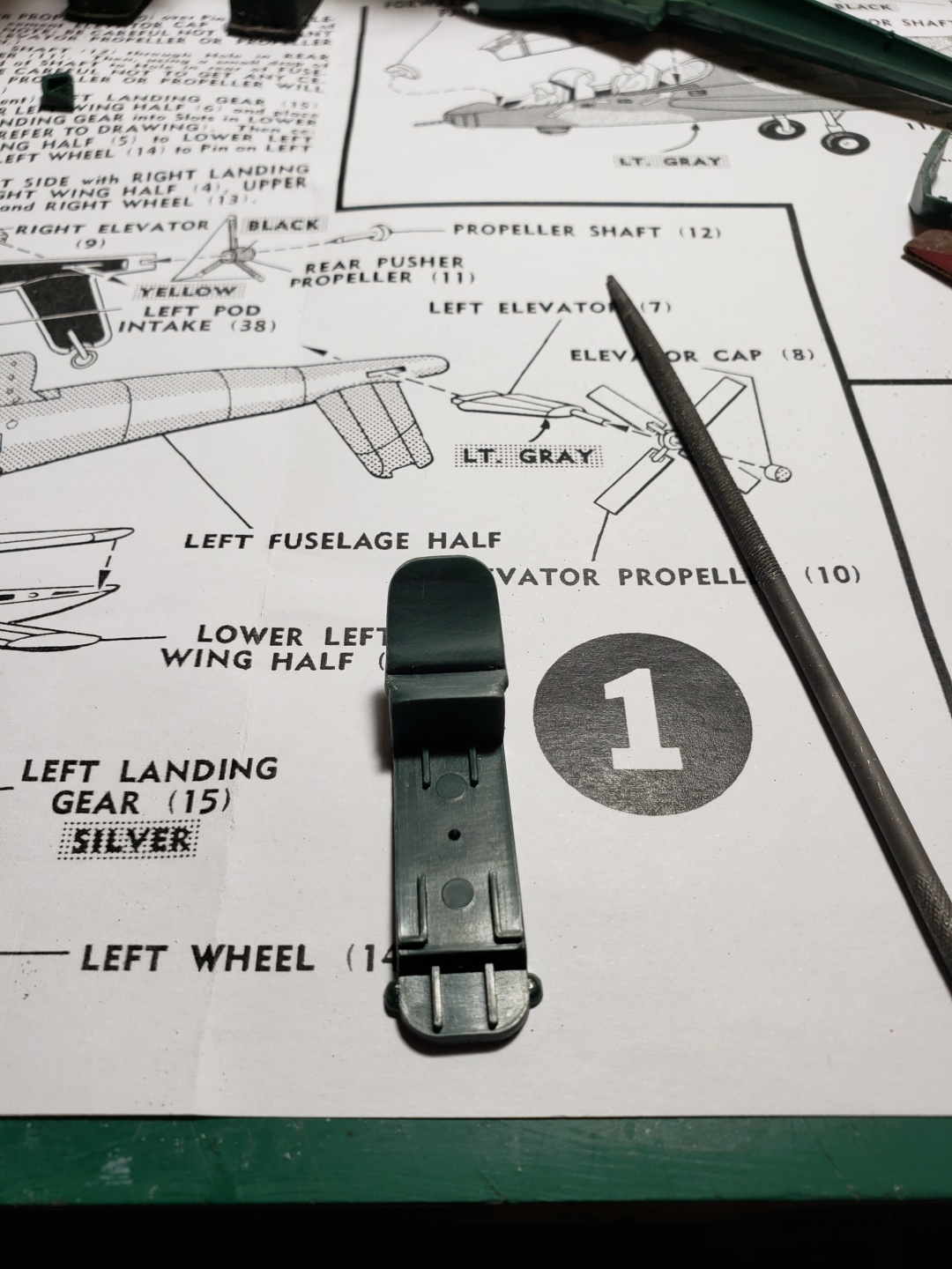

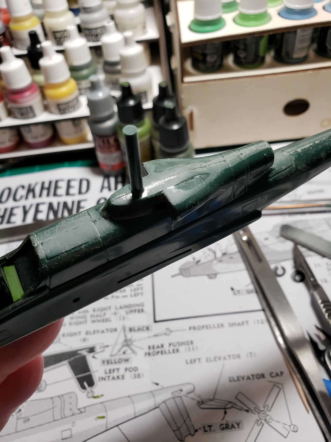

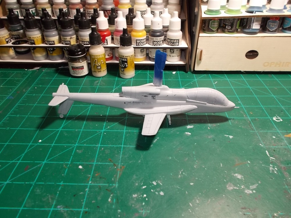

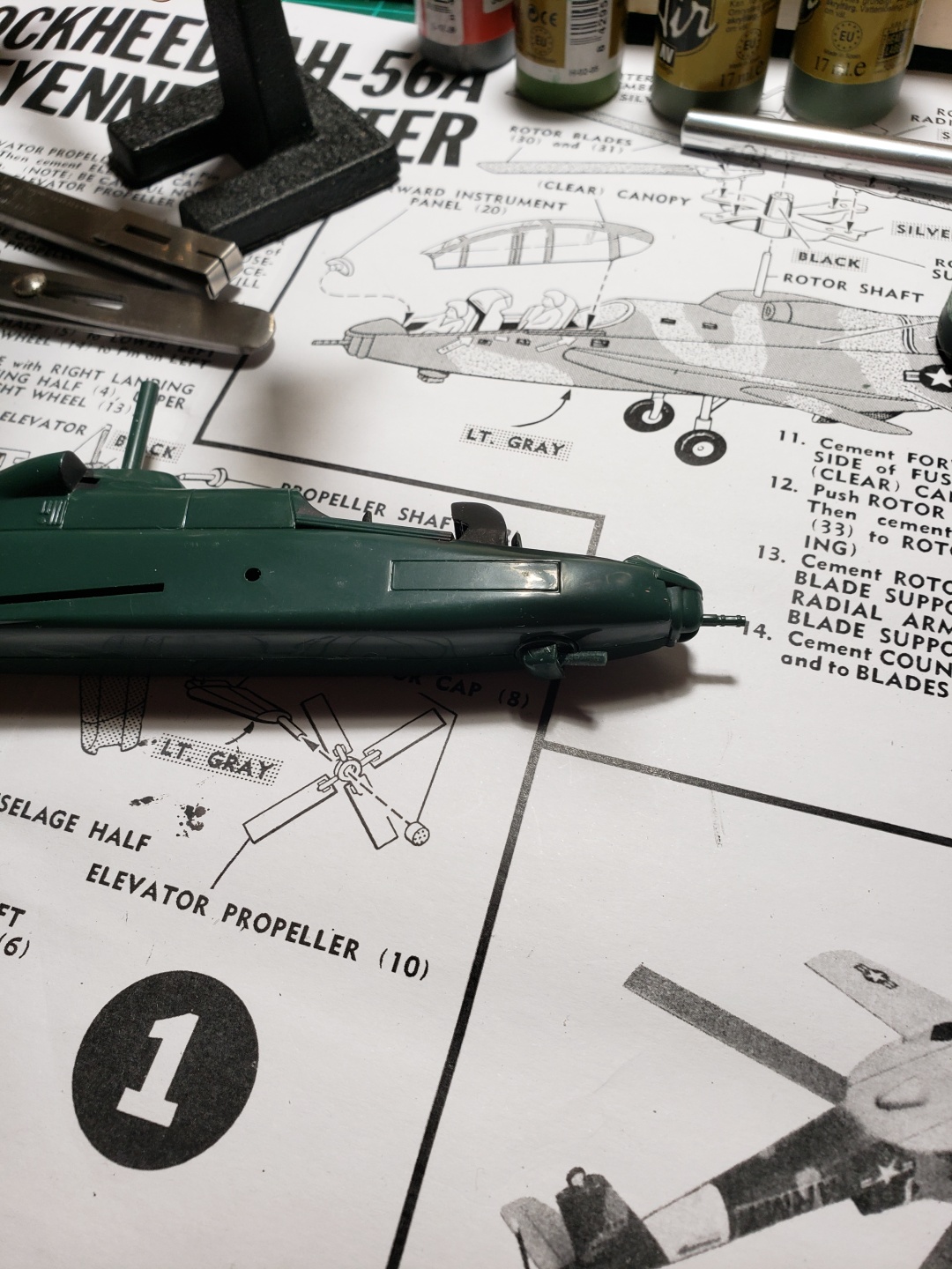

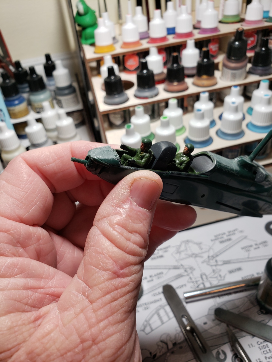

I got the fuselage closed around the cockpit,
trapped the chin gun and belly turret ( The belly turret didn't have the 30 mm gun, so I added it.)
Crew figures coming along (I hate military pilots... too much green)
I Used blue painters tape to mask the canopy, I'm out of Tamiya tape, so I used what I had on hand.

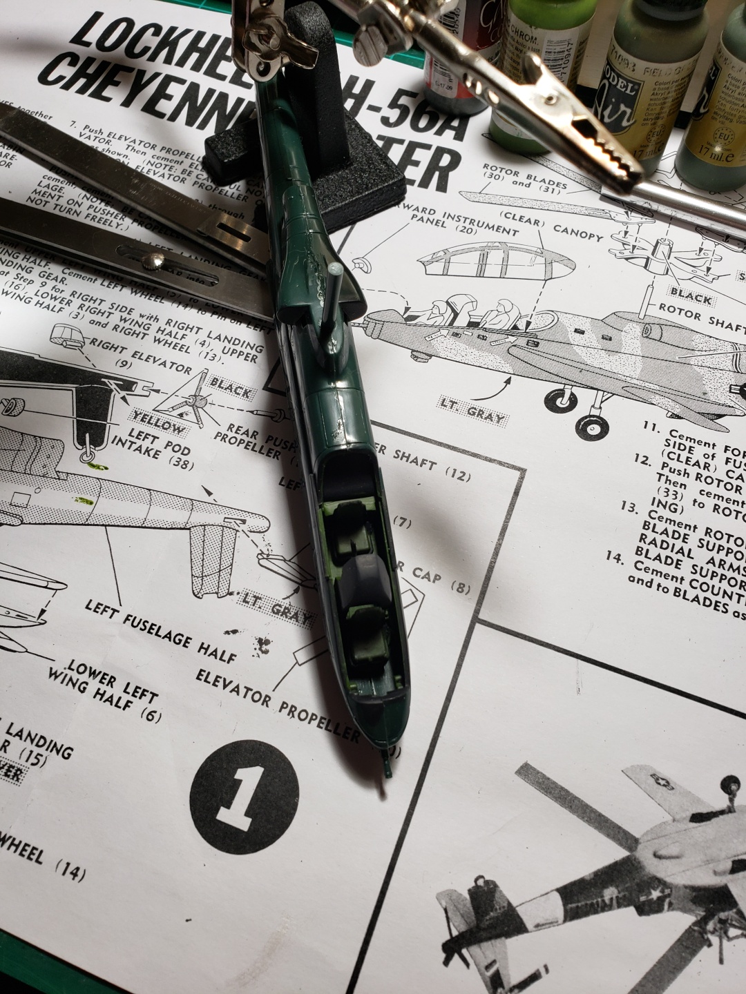

Added the finished crew to the cockpit and started sanding seams.
The first sanding showed where filler is needed
just a couple spots on the belly to be filled.

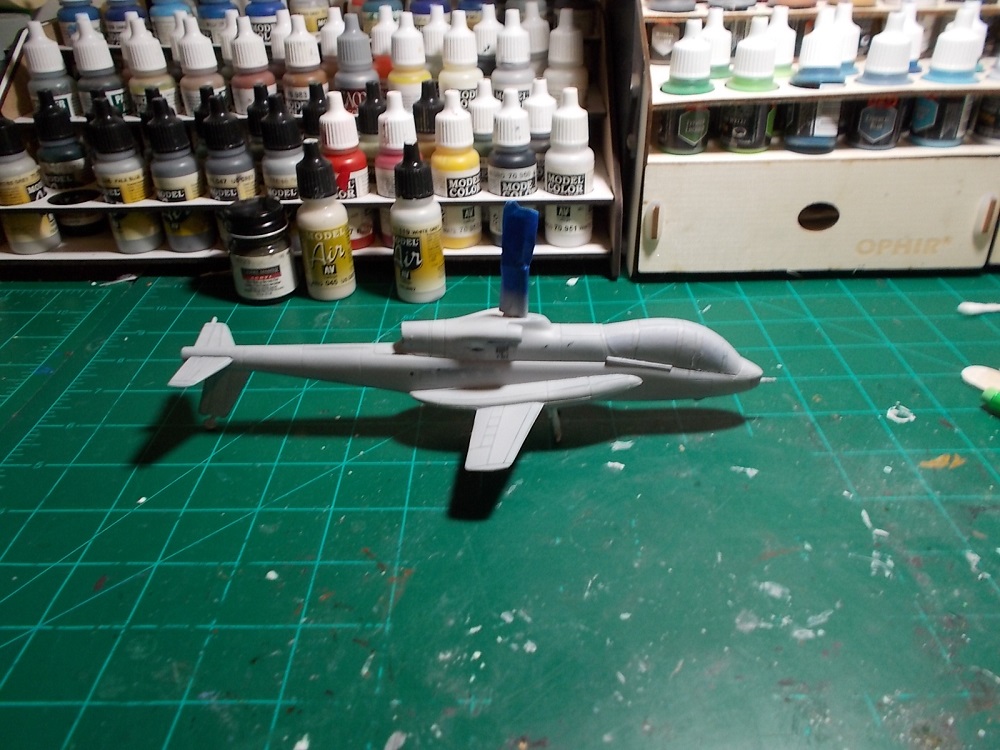

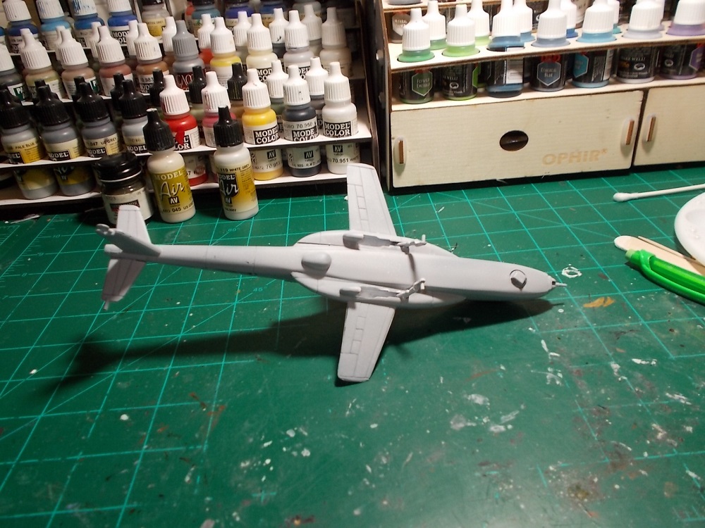

Wings installed, overall primer sprayed, a few spots sanded again, next step will be color coats tomorrow.

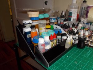

Might be papercraft? I used a sheet of foamcore to make a couple new racks, one for my larger Pill Bottle storage for basing supplys, and a smaller one to extend my paint storage.

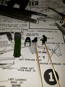

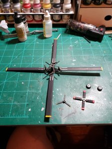

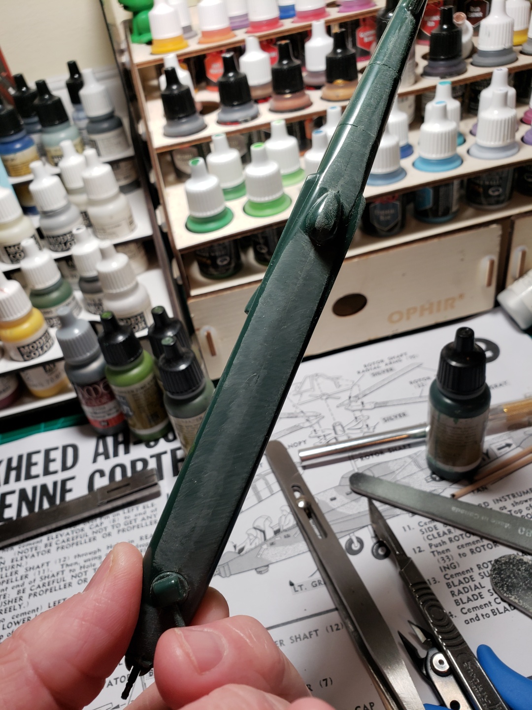

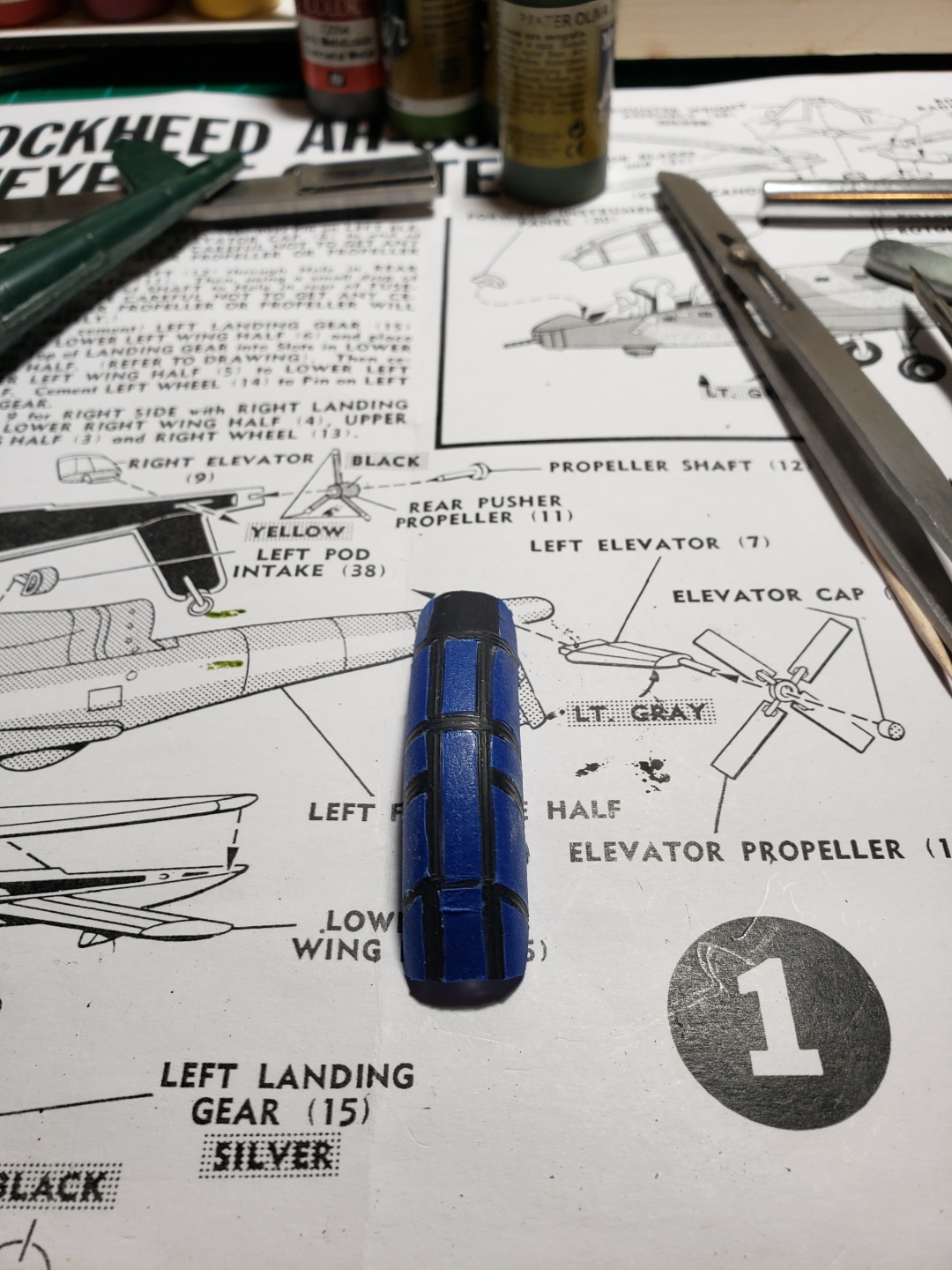

Too humid to airbrush acrylics today, so I did all the brush work on the rotor's and wheels. Main rotor assembled, and painted, anti torque rotor painted, pusher prop painted, and wheels painted.
The rotor safety stripes were patterned after prototype 1, which is one of the ones with no 30 mm turret. but I'm gonna due the three color camouflage, as shown in the instructions. Just to add some visual interest. The counter weight and harmonic balancer are out of scale, but acceptable.

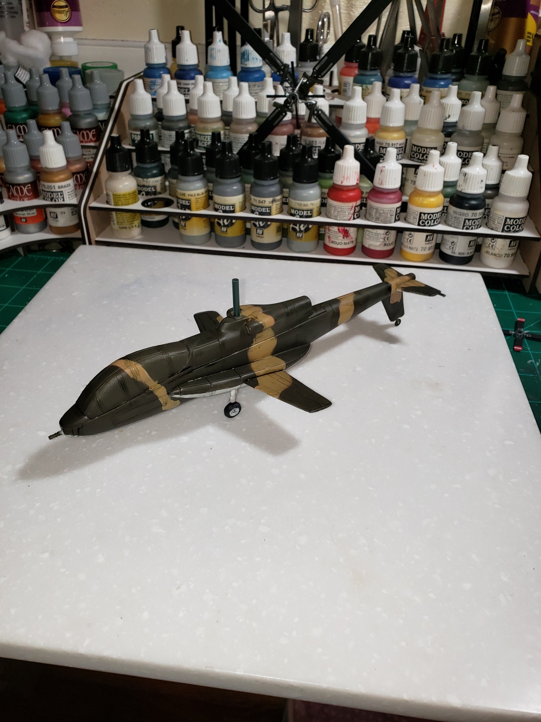

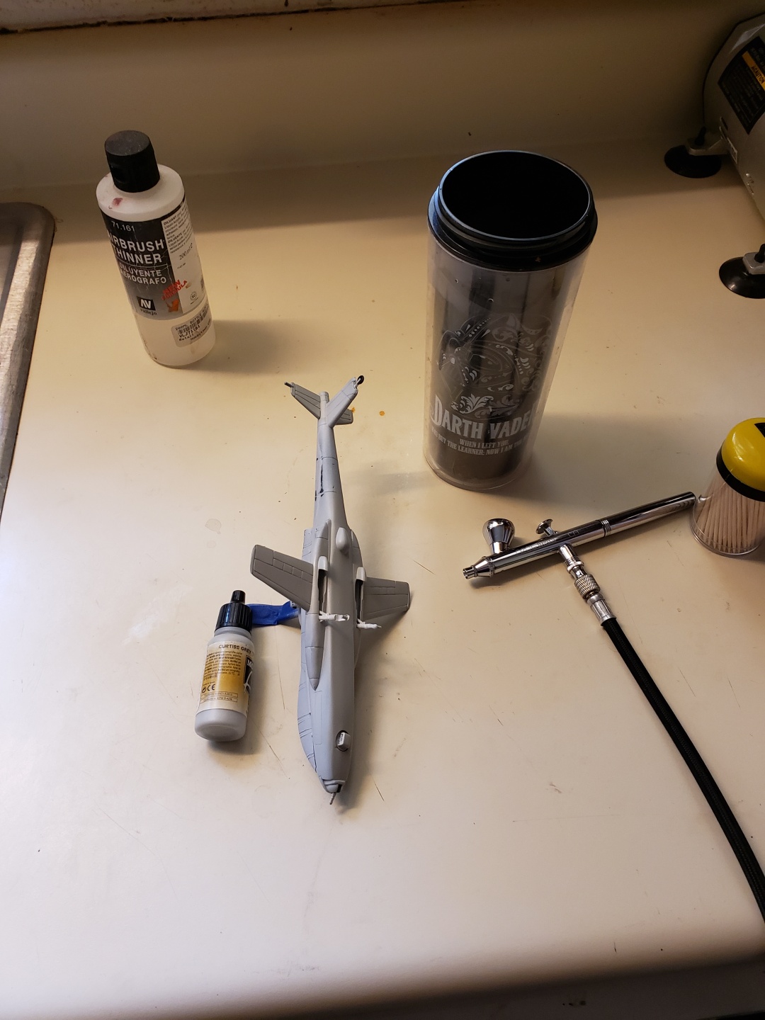

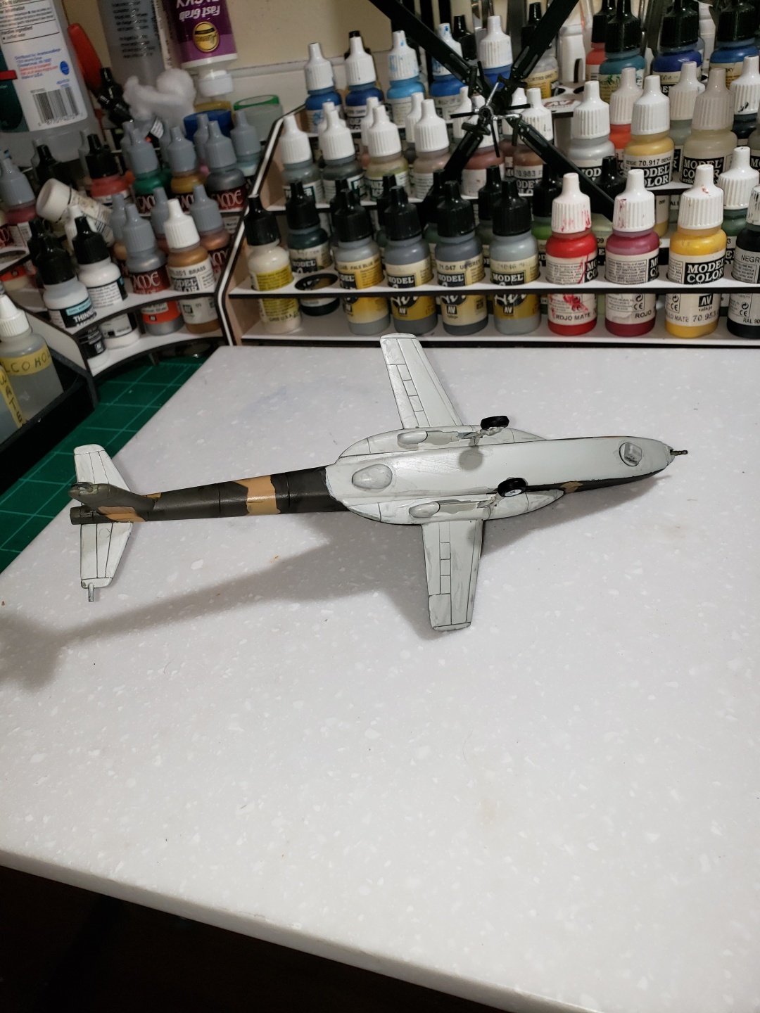

Airbrushing colors today, the bottom light grey applied,
20200722_105118_resized.jpg Coffee always helps, especially in my Darth Vader cup...

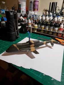

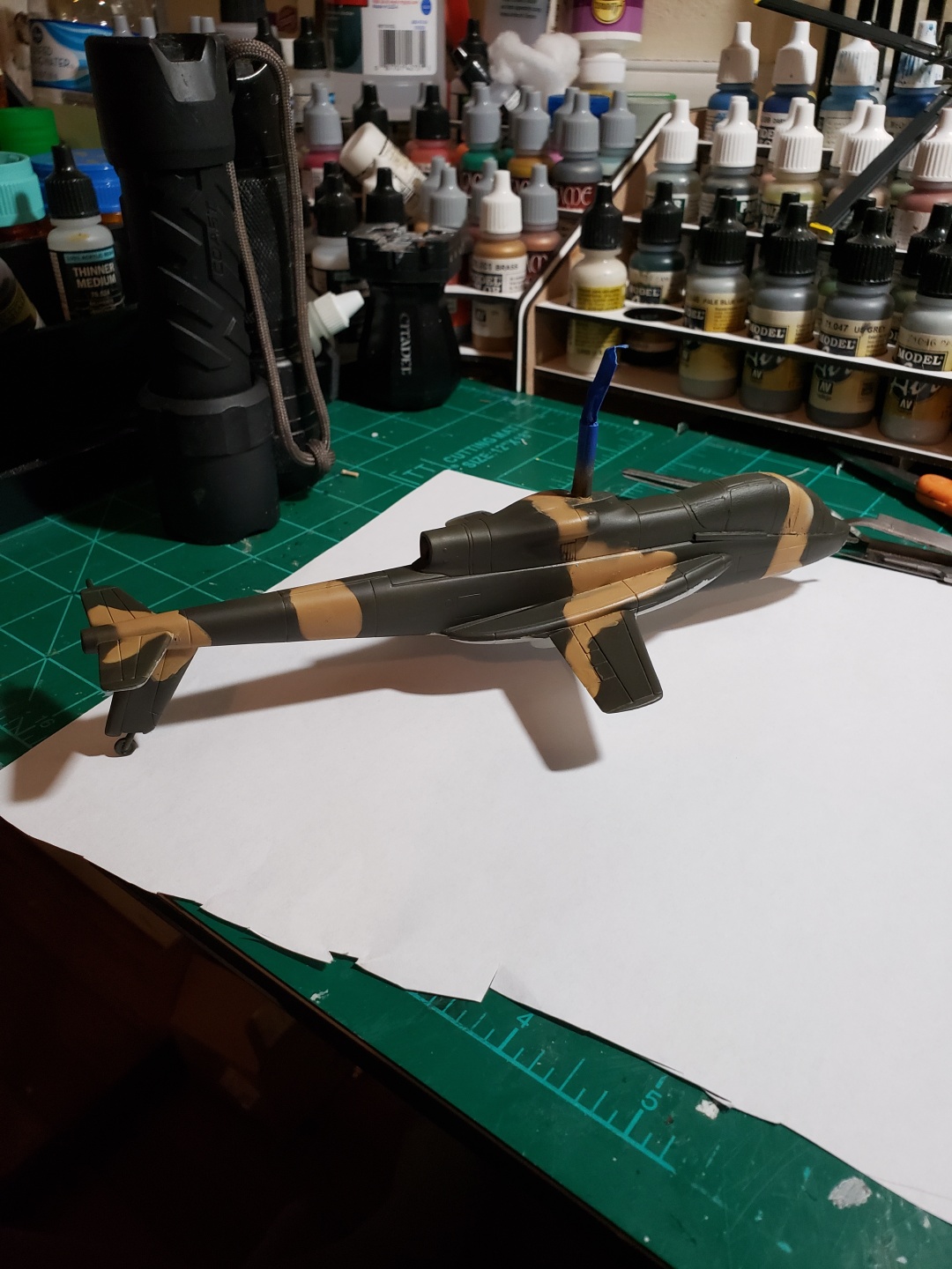

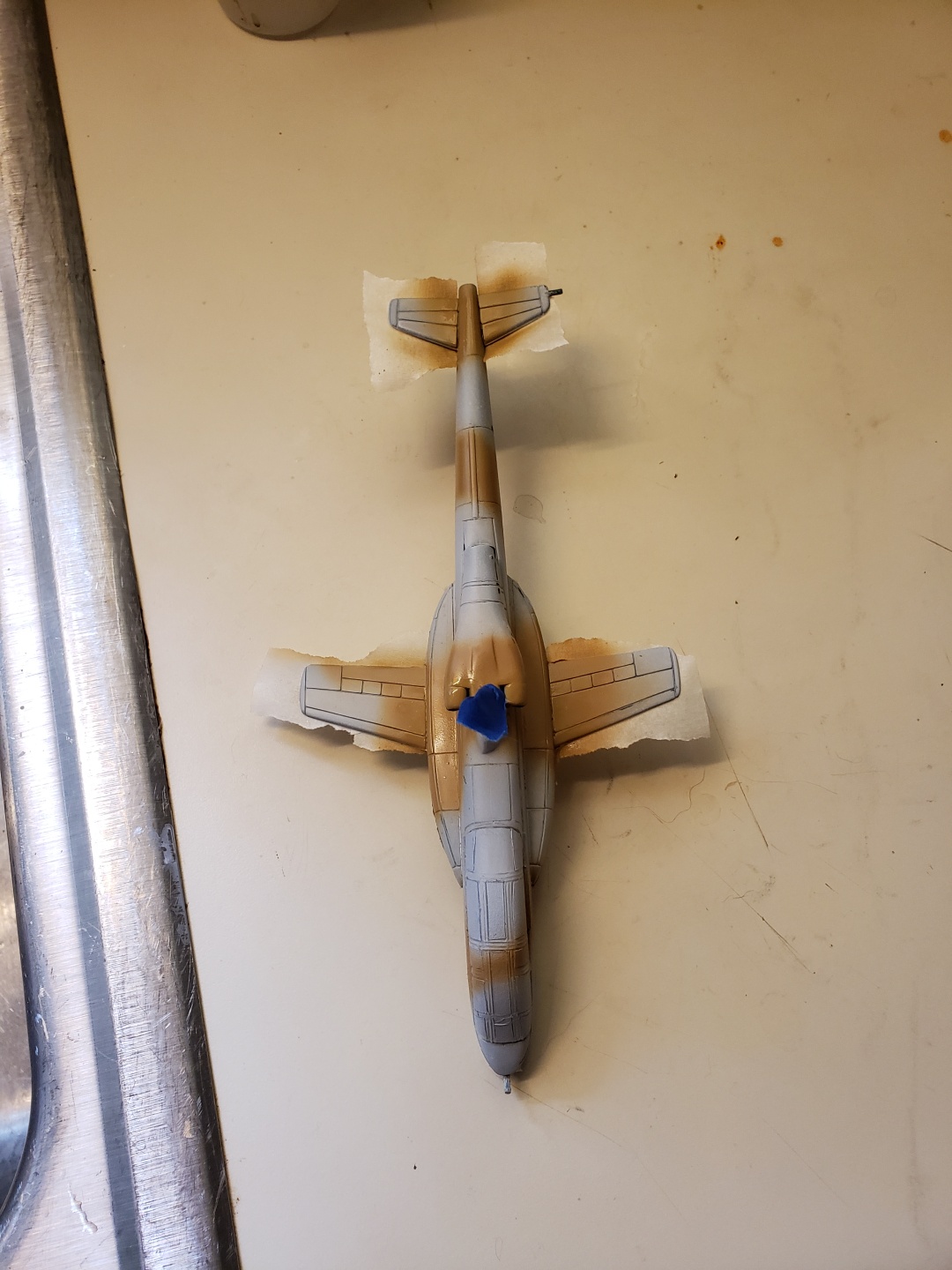

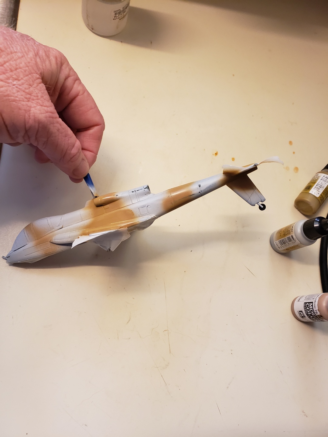

Bottom grey masked off and Tan applied.
20200722_150023_resized.jpg 20200722_150030_resized.jpg The tan color is a mix of Cork Brown, and Panzer Dark Yellow. I am out of Desert Sand. The tan color is sprayed sloppily, the green will define the edges. Gonna try a trick I used to be good at, to make feathered edges, instead of hard edges for the camouflage pattern, You cut the pattern out of paper, then stick them too the model with a rolled piece of tape, or "Blue Tack". This will hold the mask just above the surface to be painted, and let a controlled amount of over-spray onto the 1st color.
And for any who may not know, you try to spray from light to dark, it's easier to cover a light color with a darker color.

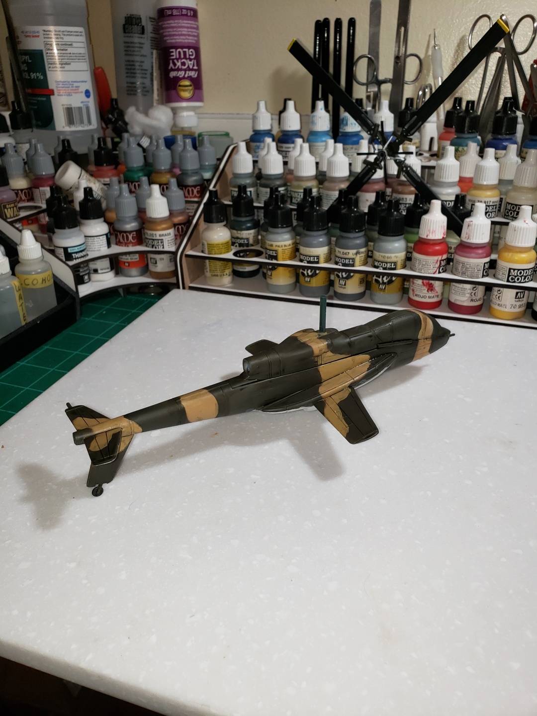

Not a great result, but not too bad. The green bled under the mask in the hard 90 degree corners of the model, namely wing root and such. So there will be some touch up to do tomorrow.
The hard part will be mixing that tan color again... Ohh well.
Touch ups done, and a was applied to give the panel lines some definition, and dirty it up a bit.
20200723_132355_resized.jpg 20200723_132408_resized.jpg 20200723_132416_resized.jpg
