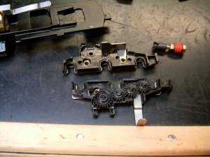

Back to the missing gear subject , I got 6 replaced the missing one and the other one that looked chewed up a littel . put it back in and it runs great . so I have a systen that is fine for now here is the picture of the box shy the gear .I do not think any one swaped out any parts .they just forgot to put in in .could have been produced on a monday friday .payday or even after lunch Do they still have liquid lunch breaks or are they Disco nap's

Interesting..Glad you got it running..
BTW..The reason I feel that engine was tampered with before you bought it is because I seen it before when I was working part time in a hobby shop.
I did look closely at the box and it seemed to be new .the corners were in good condition and the foam that held it into place was fine.the box it was sold in is blue with a picture on it ,and the hoby store is new in the last year ,nothing looks to be older than a year old . now when and who he got his stock from I have no Idea .it could be a pre DDC ?
I do not notice any DDC hook ups,
