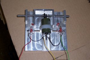

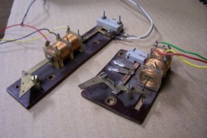

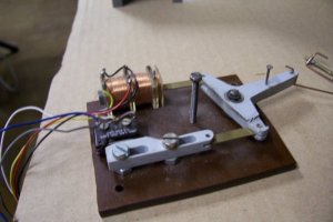

Hi Nick,
I have been busy with this hobby for many years now and I also say,"A dollar saved is a dollar ernd.
I build my oen wissels annd switch motors, I have had a few missers but I kept at it and I kept getting better, and the thing is I gust used what I could find, I would go to tjhe elektrical dump store and buy motors for $0.50 and I would buy them all at once, about 12 to 15 of them, and from these motors I would make my switch motors.
I would switch them with a DPDT switch, because my switch machines would turn them self's of when the wissel reached its end point, for this I used micro switches, one at each end and I added one to change the currant of the frog or to change a signal.
When I first started I bought radio coils I think you call them, rewound them so that thay could withstand about 20 volts for a short time to see if thay would burn out, and then connected them to a 16 volt trafo and used push buttons to switch them.
Here are some photo's of what I have made over the years.
Photo's under paperklip.
Erne.

Hi Nick,
You think it's expencive in America, I went to the hobby shop and arsked the price of a solenoid switch from peco and thay arsked €20.00 for one,(about $20.00), and all it is, is two short peaces of small pipe amd some wire, and if you want to change currant for the frog I also had to buy a switch witch I could mount on the solenoid, that also kost €11.00.
The ones I make my self, kost me €1.50 and about 2 hours work. and it dose exatly the same.
regards Ernest lafleur.

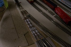

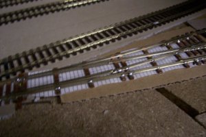

Hi guys,
Here is a photo of one of my wissels I built, I got the tip's from a story in the modelrailroader, Sorry I don't know witch number it was, I have been making these wissels for a while now and don't need instructions any more.

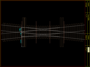

I draw the wissel I want with a cad program and print them out 1:1, that way I can tryout if the wissel will fit where I want it to go, and make changes if I have to.
About €4.00 and +/- 4 hours later I have the wissel I want and need.
This way I have made from a Nr#5 wissel to a Nr#10 curved wissel witch is about 60 cm long.
These wissels are the best I have had yet and I am glad I found that artical in the Model railroader
Ernest.

Ernest again nice work have you tried to build a double slip wissel (switch) .
Hallo Jim,
I have made a drawing of one, two actualy, a llarge and a small one but I have not built one.
I have converted some Fleishmann doubbel slips and thy work fine now, I changed the guide rails by making the gap smaller.
One of these fine days I will try to build one.
Ernest

Excellent work Ernest, very well done. I also make my own switches, I get the templates from a company called Fast Tracks, a company here in Canada that makes all sorts of jigs etc for making switches. They also have on their site a section where you can print off switch templates on a 1 to 1 size and are NMRA standards. One question that I have is, looks like you use metal bases, how do you insulate everything , I also have to add a switch to route power to my frogs..again well done..Ron..
Hi Ron,
This company you wrote about, thay have a web site, and an E-mail addres, would you send me those addreses please, I would like to see what thay have in stok.
No Ron it's not metal bases, It's strips of circuitry board whitch I cut my self, then stik these strips on the drawing at kritical points and then solder the rail on these strips,
When the switch is finished, I grind the kopper away so I don't have any conection between the plus and the min.
The rest I place strips of balsa wood, when it is painted and I have layed the ballast, you can not see that some slepers are koper based.
