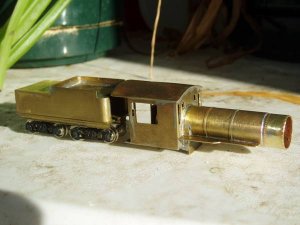

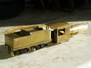

A few mentioned that they would like to see more photos of my projects and rolling stock. Here is one of the oldest projects on my workbench, a model of Magma Arizona #4 that I started long before I joined the gauge. I hadn't worked on it in years, but recently have been working on it again. Plans were published in Gordon Chappel's book "rails to carry copper" and in the Narrow Gauge Shortline gazette back in the early 80s. Unfortunately, I lost my photocopy of the plans, and need to make it to the library and re-copy before I can resume work!
I've been making it out of brass mainly using files, a rotary tool, and an 80w pencil soldering iron.

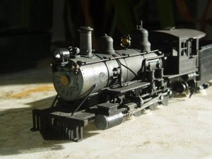

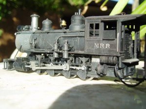

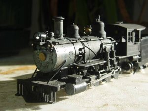

And here is my only operating steamer (the shay is out of service for reworking, and the other 2-8-0 needs new drivers). This is a roundhouse 2-8-0 kit. The engine has been detailed, but havent gotten around to detailing the tender yet. I still need an engine crew (currently unpainted on my workbench) and need to figure out how to install a headlight.

For installing a headlight, how much room is there in the smoke box, and how easy would it be to disassemble the headlight? You could take the headlight off and take it apart. Install a grain of wheat or grain of rice bulb in it. Run the wires down between the headlight and the mounting bracket, and then through the front of the smoke box at the very top just above the bracket or even tightly against the bottom of the bracket between the 2 braces.
the smoke box is a solid chunk of pewter. I'd have to drill all the way through.
Kevin

Do you (or did you) have a plan for getting the running gear for #4? It seems that finding the right drivers is by far the most difficult task in scratch building steam locomotives. Are you using 0.005" thick brass as an overlay with the rivet details...or have you had access to a riveting tool? It is good to see people scratch building steam. I have a few such projects on the horizon...probably a DSP&P Baldwin 2-8-0 which was a sister to the D&RG Class 56 engines.
yeah, I am using thin brass with embossed rivets as an overlay. I am using a turned nail in a pin vice to hand-emboss the rivets one at a time.
For the running gear, I havent decided yet. You can get c-16 driers from precision scale. They are costly and two inches oversize. You can also still get drivers from athearn (the old MDC drivers). They are 4 inches oversize. Or, I could try and find n-scale ones and widen the gauge. Sometimes, there are hon3 drivers on ebay, but they usually go for $$$. I am willing to live with oversize. I also have considered making my own drivers and using NWSL tires. I would probably make one driver center and then make a mold of it and cast it with pewter. Then I would press the tire on the center.
