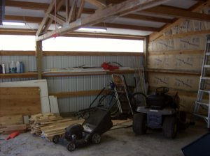

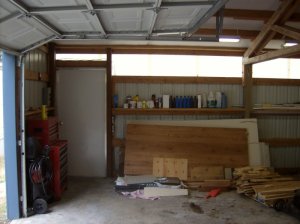

Thanks Russ, that is what I was wondering. And, if you look at the pics I posted, there is a 2x8 running along the center of the walls that I will have to trim down to 2x4. Looks this will keep me busy for a while.

Russ, if you look again, there is what looks like a shelf along the middle of the wall. It's a 2x8 on edge. It sticks out about an 2" when I hold a 2x4 against the wall.

I just looked, I didn't notice the "shelf" until I saw what looks like an extension cord laying on it. Don't try to cut it down to match the 2x8s that are mounted against the wall. Put a 2x4 leg under each end for support, and cut it @ 3 1/2 inches out from the 2x8s. Then you set your blade depth on your circular saw to cut notches the depth of the 2x4 studs where ever the studs go. When you set up your stud wall into place, run screws into the studs from the cut down 2x8 at an angle and it will act as a stiffener for the studs as well as a fire break.

Do you mean I should notch the 2x8 to fit the studs? I am having trouble visualizing what you mean.
Loren
The other 2x8's are mounted to the wall on edge. That means they stick out from the wall 1 1/2 inches. If you try to trim the 2x8 shelf down to the same thickness as the other 2x8's, you will end up with a 2x2. If you cut it length wise to leave a 2 x 4 sideways against the wall and try to mount studs against it , they will not be flush against the other lumber on the wall. What you want to do then is notch the now 2x4 board for each stud to allow the studs to be screwed flush to all of the lumber on the wall.
I hadn't thought of 2x6 studs, but it might be less work. In that case you would need to cut 5 1/2 inch x 1 1/2 inch notches on 16 inch centers in the 2 x 8 shelf. You could put some really thick fiberglass bats in for insulation as well.
That 2"x8" is either a lateral stiffener for the wall, or it's a shelf. If it's a shelf, simply remove any of it that's in your way. If it's a stiffener, don't notch it at all, as its strength will be compromised (the same reason why you can't notch the bottom edge of a joist). If the latter is the case, simply build your 2"x4" stud wall inside the inside edge of the 2"x8". Tie the new wall to the 2"x8", and, if you're going to add insulation, block the space at the top and inside edge between the new wall and the existing exterior wall. Use a Hilti gun to fasten your bottom plate to the concrete floor.
Alternatively, you could build a 2"x4" knee wall below that 2"x8", using it as the top plate, then build a short wall to set atop the now-supported 2"x8". Make the inside face of your 2"x4" wall flush with the inside edge of the 2"x8", and again, Hilti the bottom plate to the floor.
Edit: After looking at your photos again, and re-reading what I've written, I'm convinced that those 2"x8"s are stiffeners (they seem to be on all of the walls), so I would neither notch nor remove them. I think that my second suggestion is your easiest and cheapest solution, too, and would give you an extra 3 1/2" of floorspace. ;):-D

If you look at the pics on page two, there is a 2x6 running above the windows. I was going to fasten the wall studs up to them for strength, but not build the room any higher than the truss. So yes, I would cover the windows with insulation.
