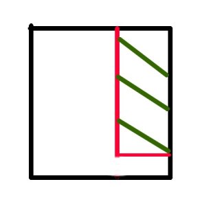

For example.. Leave the "Left" side of the garage for the car, close off the right side for the trains..
I have a 10 X 10 workroom, which is a converted garage. the 10' door isn't really insulated. I use 1 electric ceramic heater... It takes about 10 minutes to heat the room. If you get 2 of them you should be fine. ALL newer models have a tip switch, when they start to tilt (10 - 15 degrees) like when I knock it over :D It shuts off immediately! The insurance company recommends them....
Only other thing you have to decide, is how big to make the area and where to put the door. And remember - you can have the door open "in" toward the trains or "out" toward the garage door or the car.....

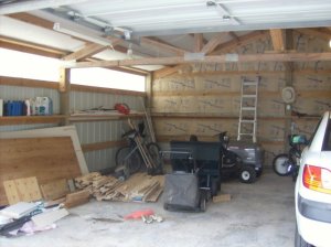

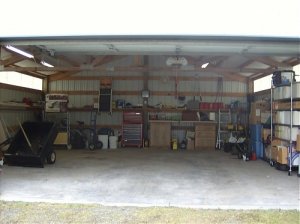

Here's a couple of pics of what I have to work with.
The area on the left is where the trains will need to be. There is a man door in the near left corner where that door is leaning up. I figure I can go 20' on the left wall, and out to that center beam, about 11'. The garage door track is 7' from the floor, so I think I could put a ceiling underneath the track and then raise the ceiling beyond that so it's not so cramped in there. What do you think?

If your door goes up into a track that is 7 feet above the floor, you could install a stud wall right behind the garage door and a lower ceiling below the track with the ceiling going higher just past the end of the track. If you use a pocket door in the wall for access to the train room you won't have it swinging into the car or the layout space. I think you could possibly get a layout room 12' x 23' in that area!
A seven foot ceiling isn't bad. That is what I have and it is less to heat. Mikey has been to see my layout. I don't know if he remembers the low ceiling or not.
Les
If the door tracks are at 7 feet, he would end up with a ceiling height at the door end of 6 feet-6.5 feet. That isn't too bad if he is under 6 feet tall. If he is 6 feet tall or over, he might want to pad that part of the ceiling with foam rubber.
Thanks for all the replies. After due consideration ( and a lot of measuring and thinking ) I am going to wall off the back of the garage. That will give me a 24 'x 8' area that will be 7' high. And leave me some of the shop area to park the yard tractor and stuff.
