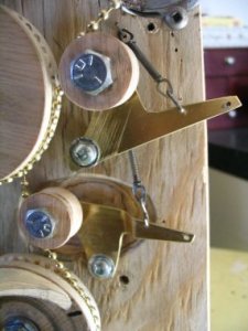

I am making an animated scene. I am making my own drive mechanism. I bought a motor that is already geared to 40 rpm. I made gears with a hole saw, use a bolt for an axle and lamp chain to connect the power. I cut a saw cut around the wooden wheel and used a diamond ball bit in my Dremel to carve the sockets for the chain. There has to be an idler arm to keep the chain from going slack on the out feed side of the drive wheel.
Not that hard to make. I can take power off the end drive wheel in a variety of ways.
TC :thumb:

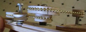

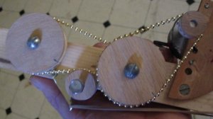

Are you using idler wheels to keep tension on your belts? I have found that using an idler wheel is the best way to keep just the right tension on the drive belt/chain. I am not using bearings in my wheels, but if there is a lot of belt tension I would think a bearing would be necessary for reliable operation. I am using 1 1/2" and 2" bolts so that my wheels turn on the smooth shaft of the bolt instead of on the threads. (sort of a bearing, well, less friction anyway.)
With the chain I am using it is a good thing my motor turns so slow. I don't think it would work well for a high rpm motor. Your O ring belts would be perfect for higher speed orporation. You wold have to build a simple transmission. You can reduce speed quite rapidly going from the smallest pulley on the motor to a much larger pulley with a small pulley glued to the side that would then run a large pulley and so on until you get the rpm you need. (I suppose you already know that)

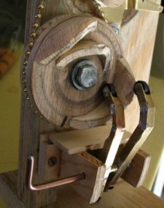

Anyway, I'm including a pic of the idler wheels on my current mechanism. Also a pic of a cam wheel that will operate stuff in my scene. The cam wheel turns clockwise. There are leavers on the end of the brass arms that you can't see in this pic. To see the thing in action in a short video, go to:

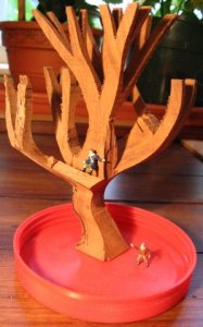

Thanks, Andrew. This is for a peanut butter lid challenge I am working on. My theme is a tree house with kids and dogs playing. This machine will make some of the kids move.
I will post more pix once done. Here is a teaser.
TC :wave:
