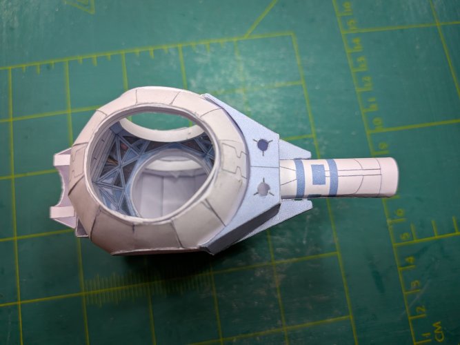

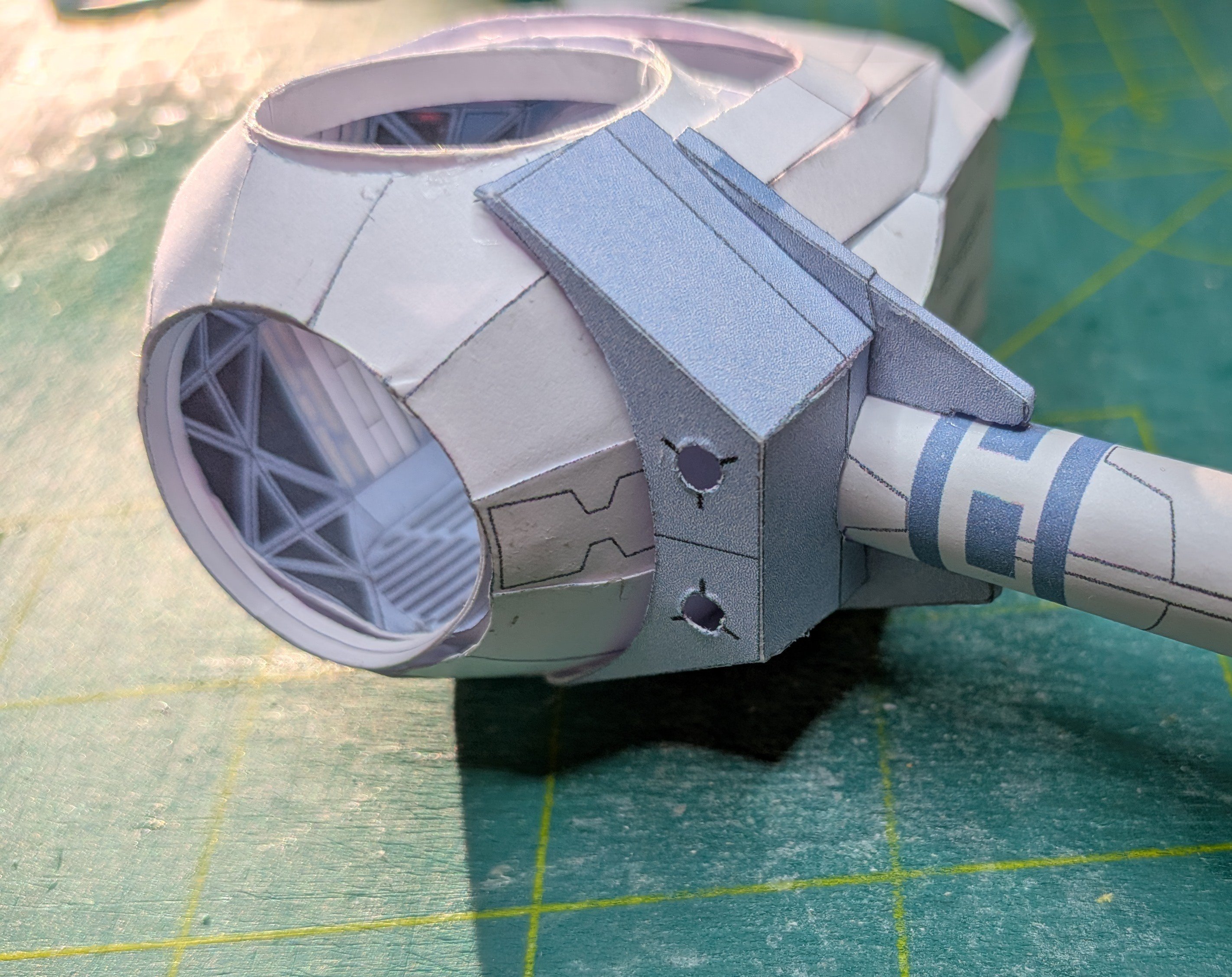

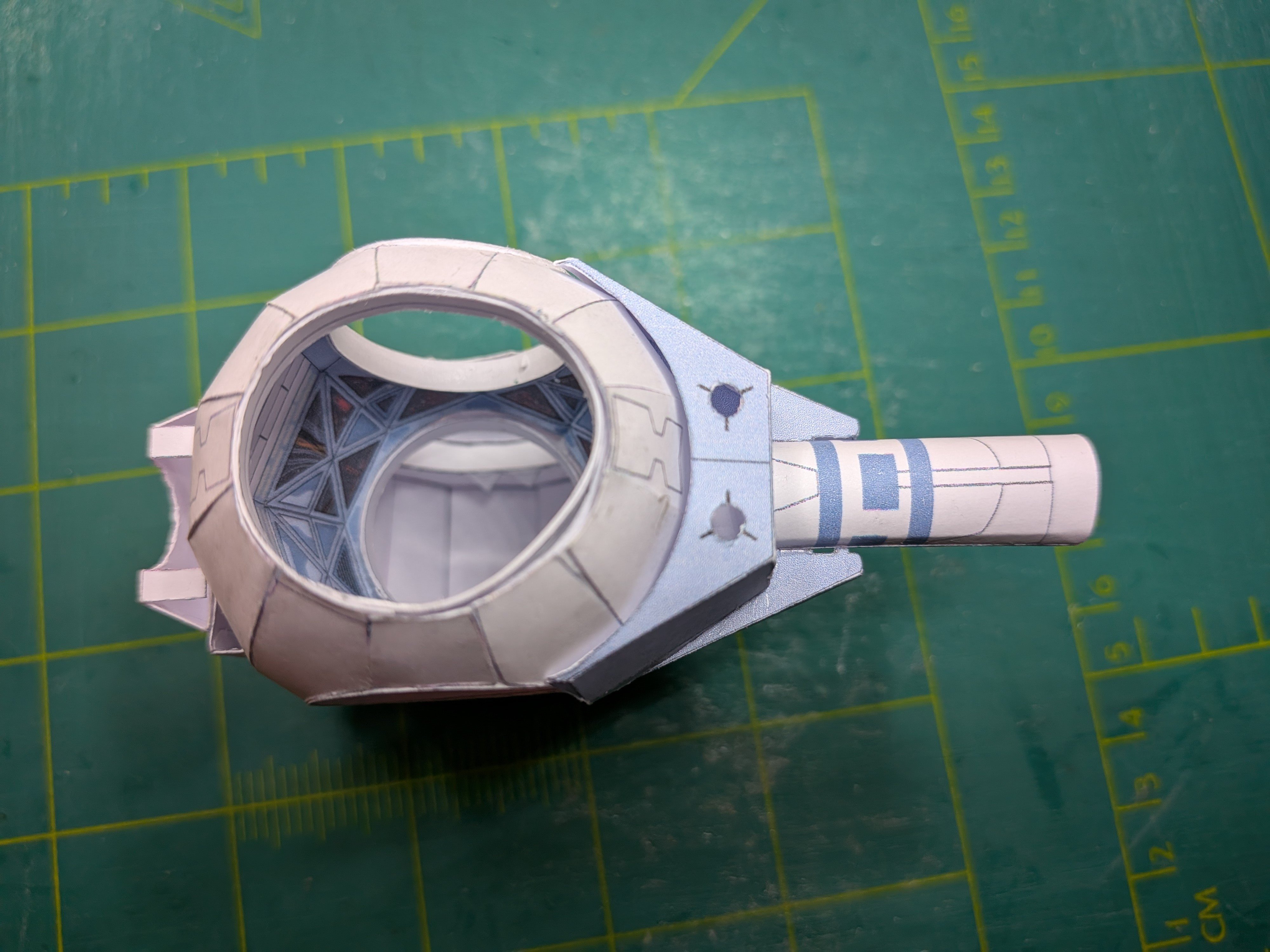

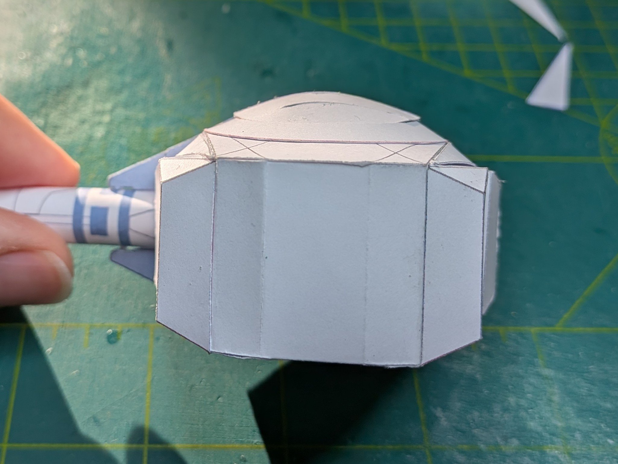

Still fighting with the interior to get it into the sphere. It needs some adjustments to fit properly. Main issue is the fitting around the front, rear, top and bottom hatches.

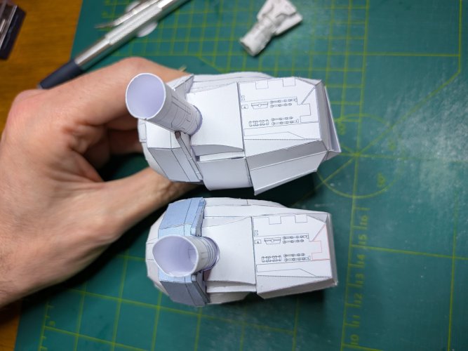

The front view is the show maker. Here I have todo some extra work to make the spgere gap disappear.

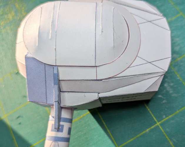

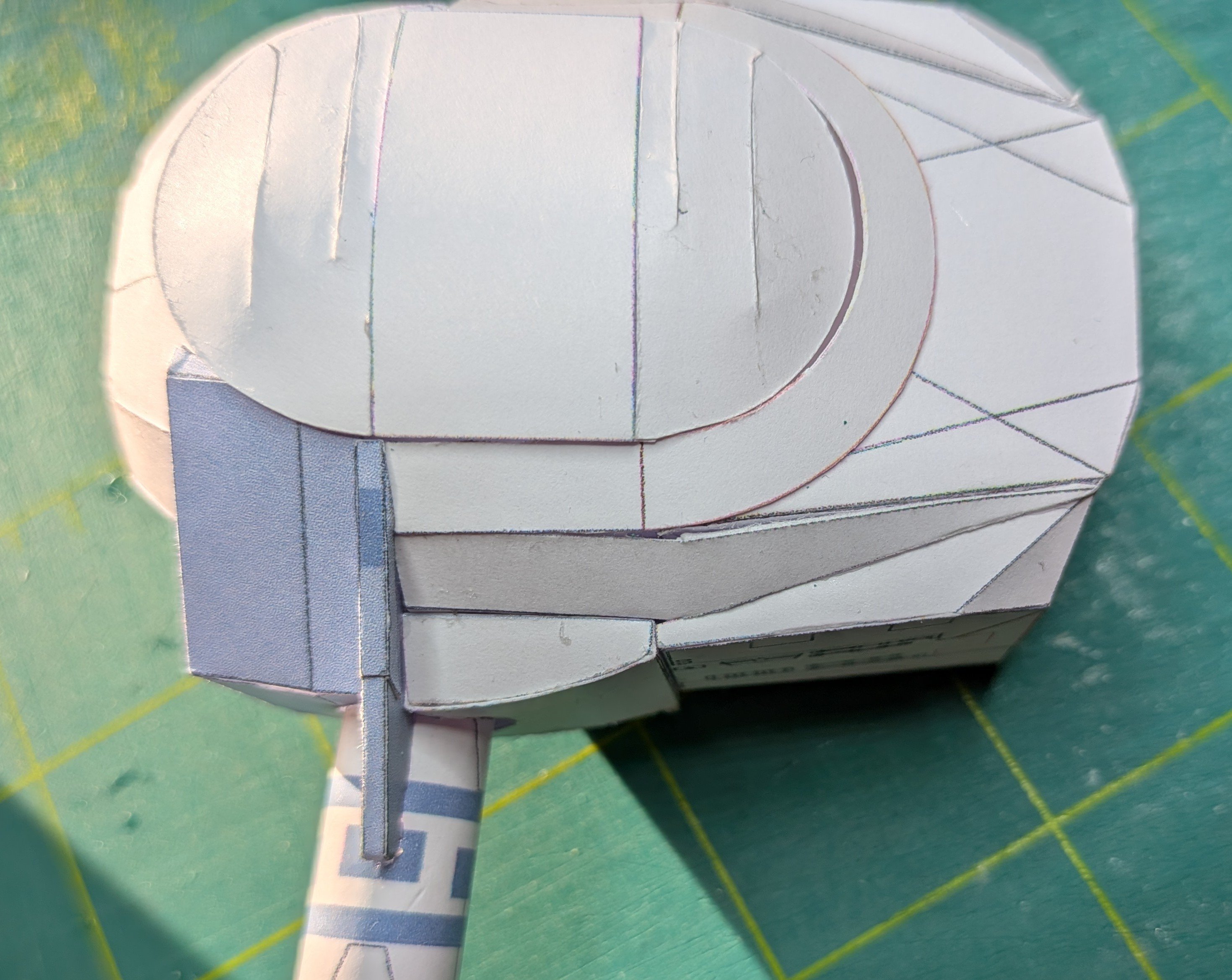

And the side view with the pylons Here you can see a big gap that needs to be closed. Oke its not the best picture to see it, but it is there.

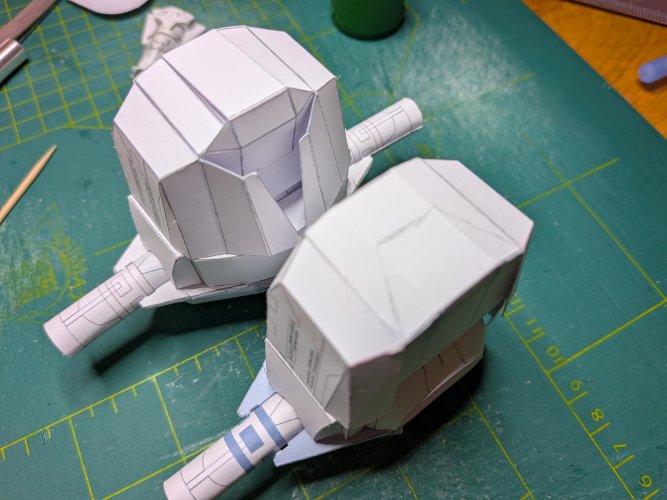

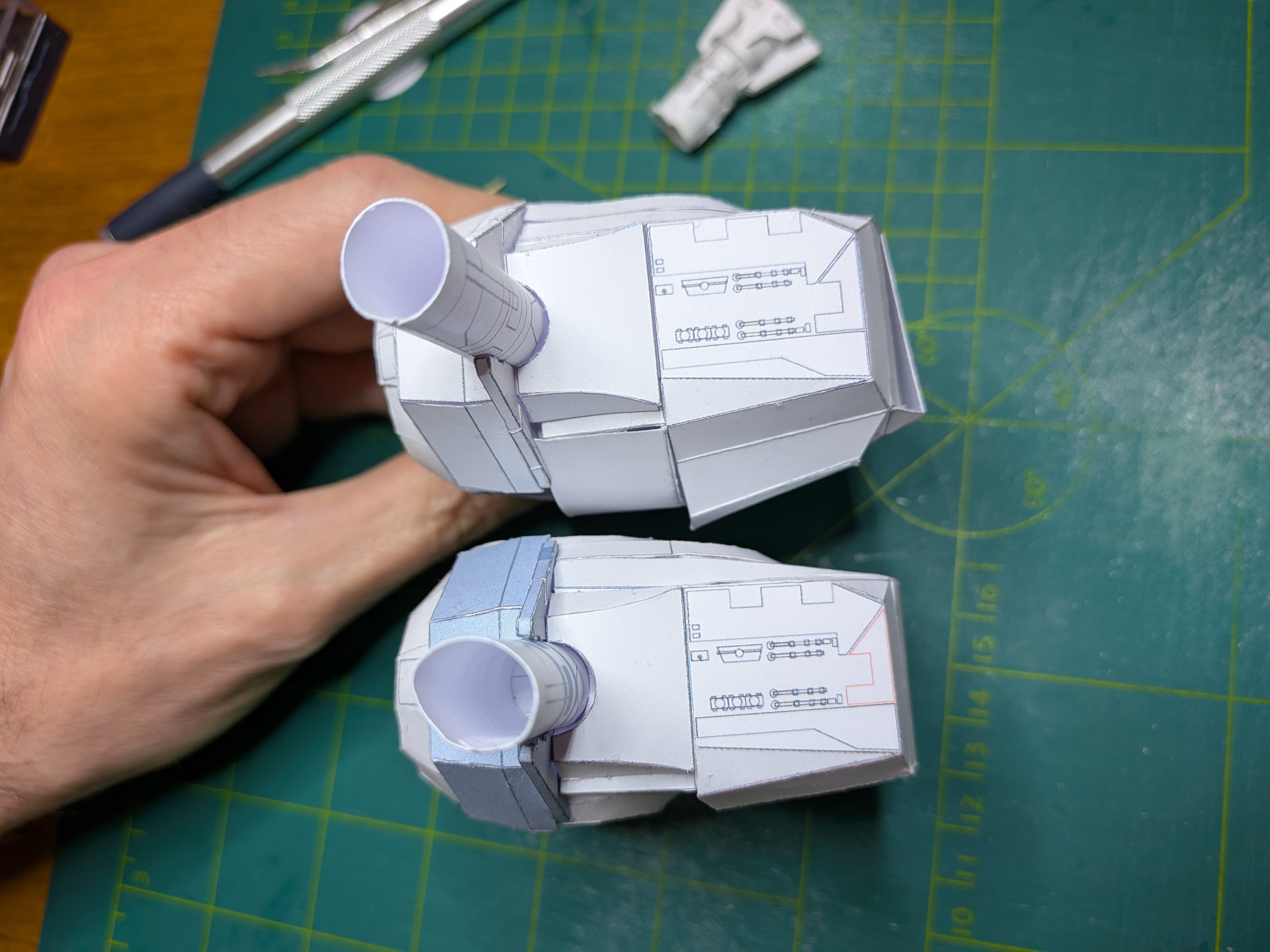

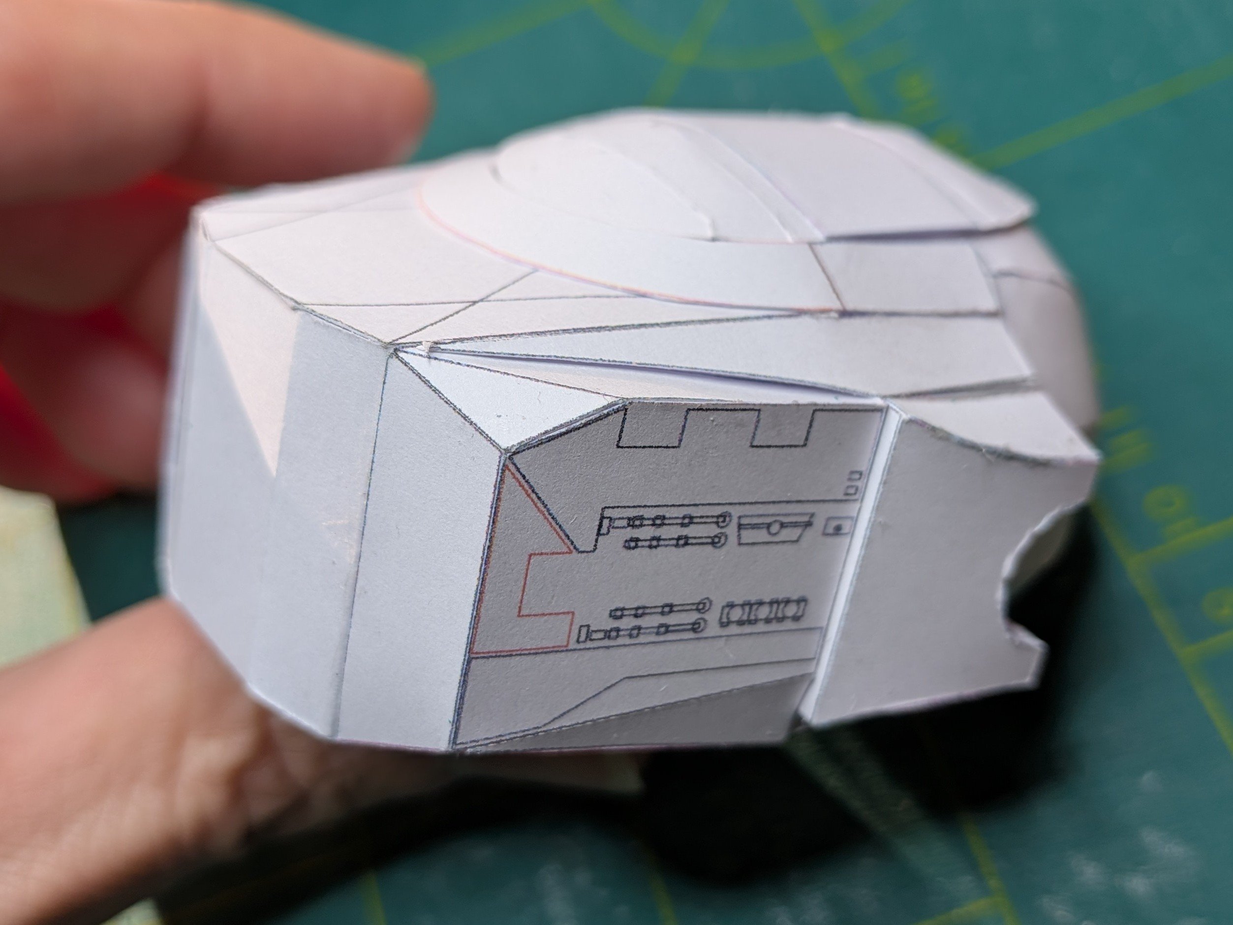

The back and the side of the hull is looking good also some minor adjustments.
Overall Im still not ready to make the final template.
Michael, when I have to close a gap without a CG model I use paper strips or triangles to determine the approximate shape. Cut off a few triangles, rectangles, whatever, move them as close to the neighbouring face as possible and tape them to the part with the gap. Start with one. Take the next and put it next to the first one. Continue all the way round until the gap is well closed. Then detach the face with the strips attached, flatten it, trace the shape and see if it fits. Repeat the procedure above till the gap is closed. Then scan the part and refine the graphics.
Thank you RF, its more a construction error from my side. I forgot to update some parts after I had changed the dimensions of the rear hull.

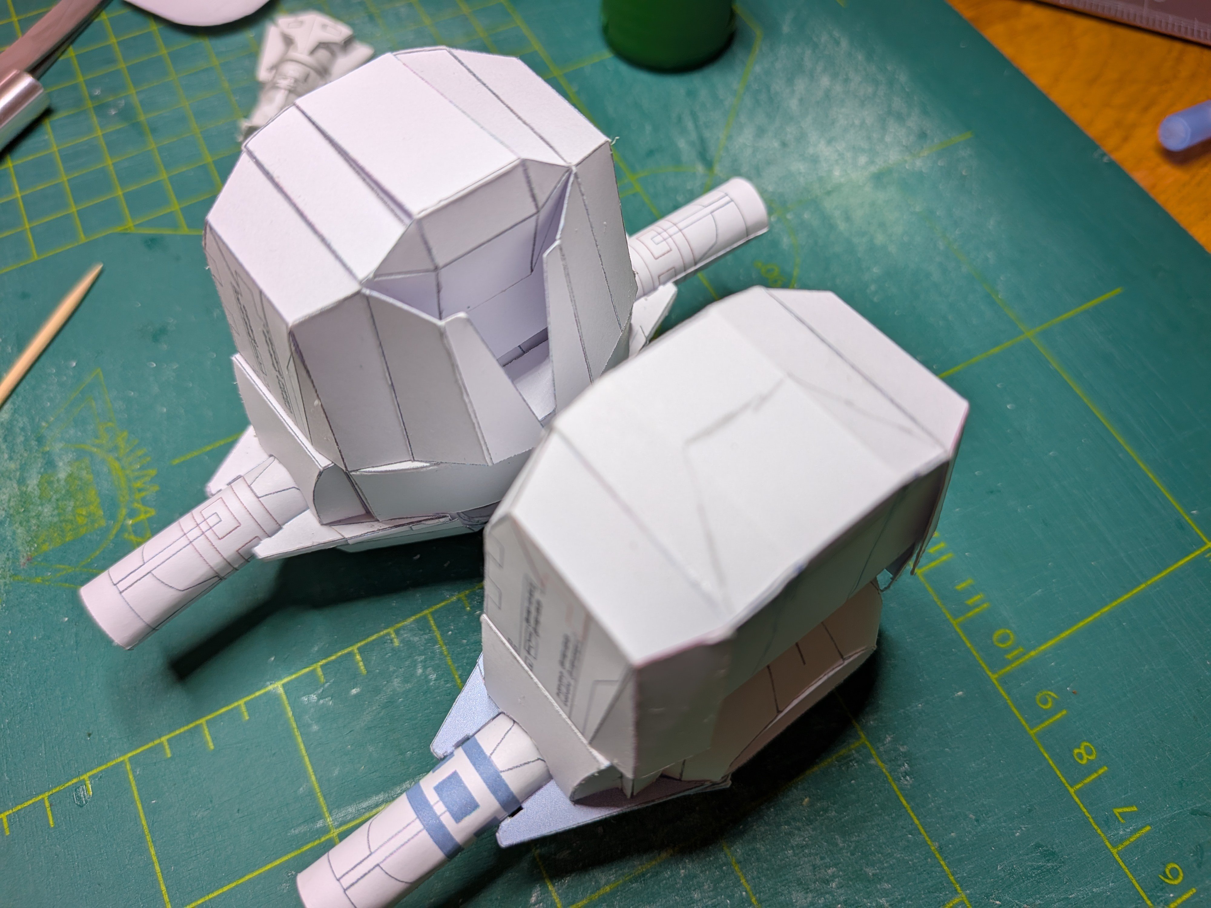

It's been a while but I have worked on updating some parts during the past weekends. I started again with building the sphere, interior and the rear hull so fingers crossed and hope that this are the last adjustments.

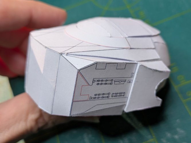

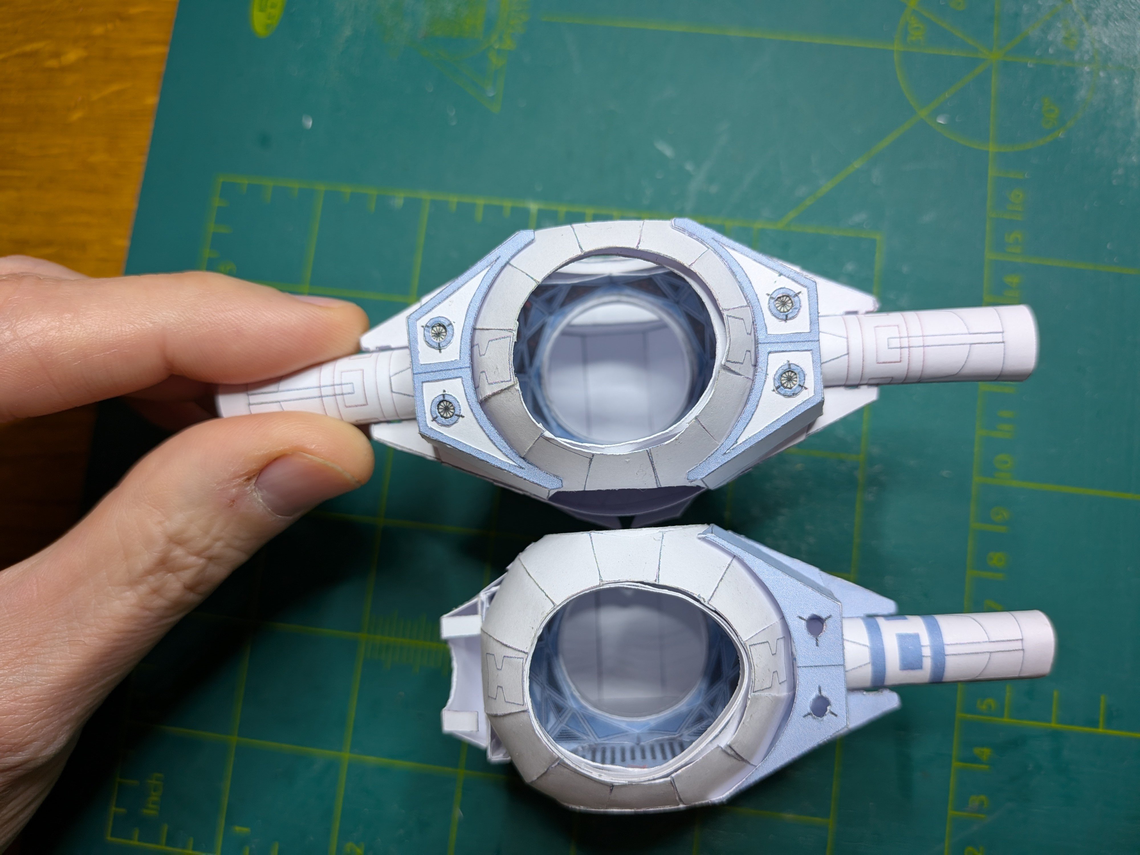

And here we have a new update.
Fixed the gap around the pylons. It needs some minor attention and then its perfect.
Also the gap at the font is fixed. I noticed that I have to shrink the interior with 5% to close the sphere correctly. Now I have only a gap at the side where I closed the sphere.

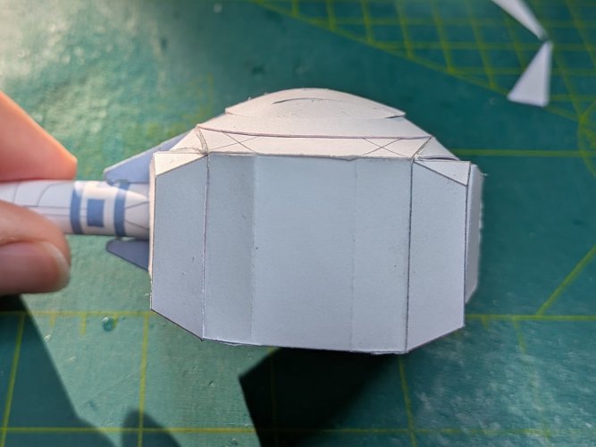

I added new parts at the rear and here its work in progress.
I miss judged the complexity off this model but I will solve all the issues that I encounter. Lets start creating new and update parts.
