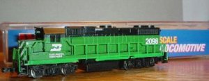

I have a Lifelike engine just I won on eBay. The thing runs like a striped ape but it has a screech in the motor that makes my spine curl and the dog runs for the other room. I've pulled it apart, cleaned it, lubed it and put it all back together. It still has that high pitched screech that would make a Japanese schoolgirl jealous.
I've got another Lifelike that runs nice and quiet with no problems and no screeching so this isn't a brand bashing thing. I just want to know how to get rid of that God awful noise.

cannon what model is it?
It's Life-Like part # is 7841 and it's a GP-38

I'm not sure if this is what you're talking about, but here's a REALLY rough sketch I did in paint. I don't think this is a can motor but I could be wrong. It powers both trucks however.

N scale and I didn't see any U joints.
It looks pretty well attached to the frame.
Well I have not had one of thoes apart- it looks like there should be a worm gear at each end of tha motor shaft- Is there some sort of cover at the tower were the worm would drive the gears to the wheels?
There should be bearings (bushings) at each end of the motor- make sure there is some is some light weight oil on them.

OK.
Did that.
I thought it had quit until I put the weights and the shell back on. After that, it went nuts again.
If it doesn't make the noise with the shell and weights removed, then it sounds as if the problem lies with either the shell or the weights. The body shell can amplify drivetrain noises, but I think part of the drivetrain may be contacting either the weight or the shell. Try it with just the shell on, with no weights. I'm not at all familiar with this loco, but some things to look for are: is the body shell facing the right way on the frame? Are the weights in the proper ends of the body shell? Were the weights glued into the shell? If so, has the glue joint failed, allowing the weight to drop down slightly, perhaps just enough to come in contact with the drivetrain? I know that some of this sounds pretty obvious, but locos can get assembled improperly at the factory.

I had the exact same problem with two of those engines. It was so loud in fact that my wife ran into the garage to see if I was ok because she heard it in the living room. I called our club's engine guru and he brought the oil. He found it was the gears inside of the boxes. From your diagram, take the tops off of the two black boxes above the trucks (it is usually just taped on) clean out any dust and lubricate in there, after that the screech was gone.

I've done that and it's still whining like crazy.
Of course, the weights sit right over them so I wonder if they are pusing down on the boxes and causing the gears to rub.
Off to experiment some more.
Were you able to get the covers off that cover the gear boxes over each drive trucks? See any dirt- grease or whatever- if you got the covers off look at the tops of the covers, the side that is facing the gear and see if it has worn marks in it. I think Jesso has got you going in the right direction for a fix. Keep us posted, You will get it fixed, just keep trying.
