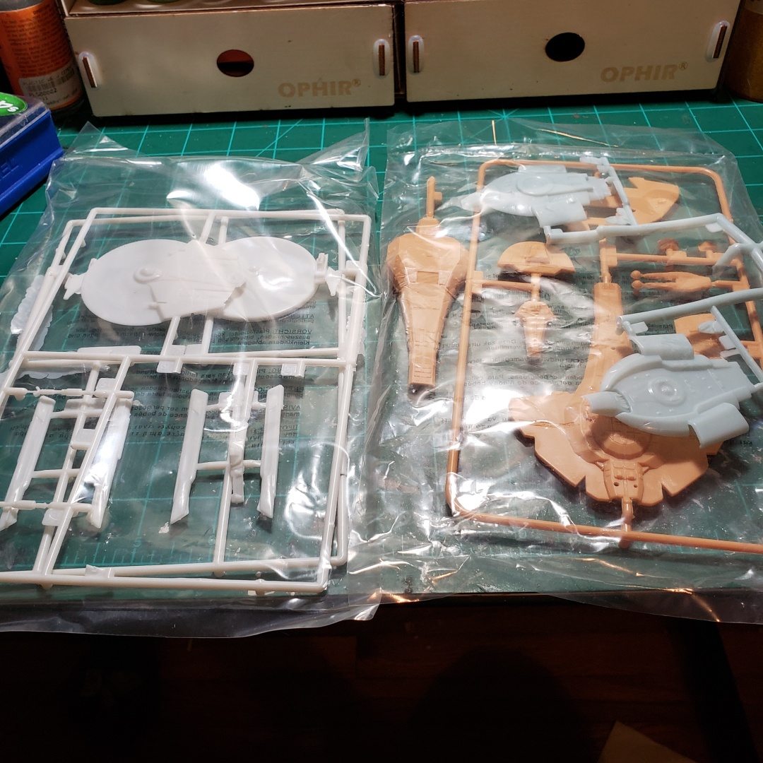

open up the box,

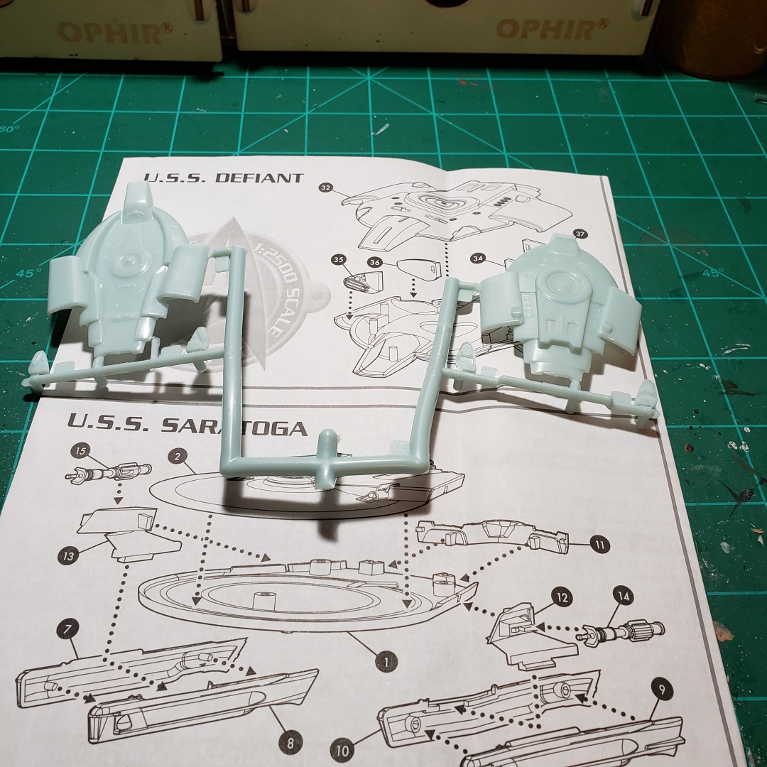

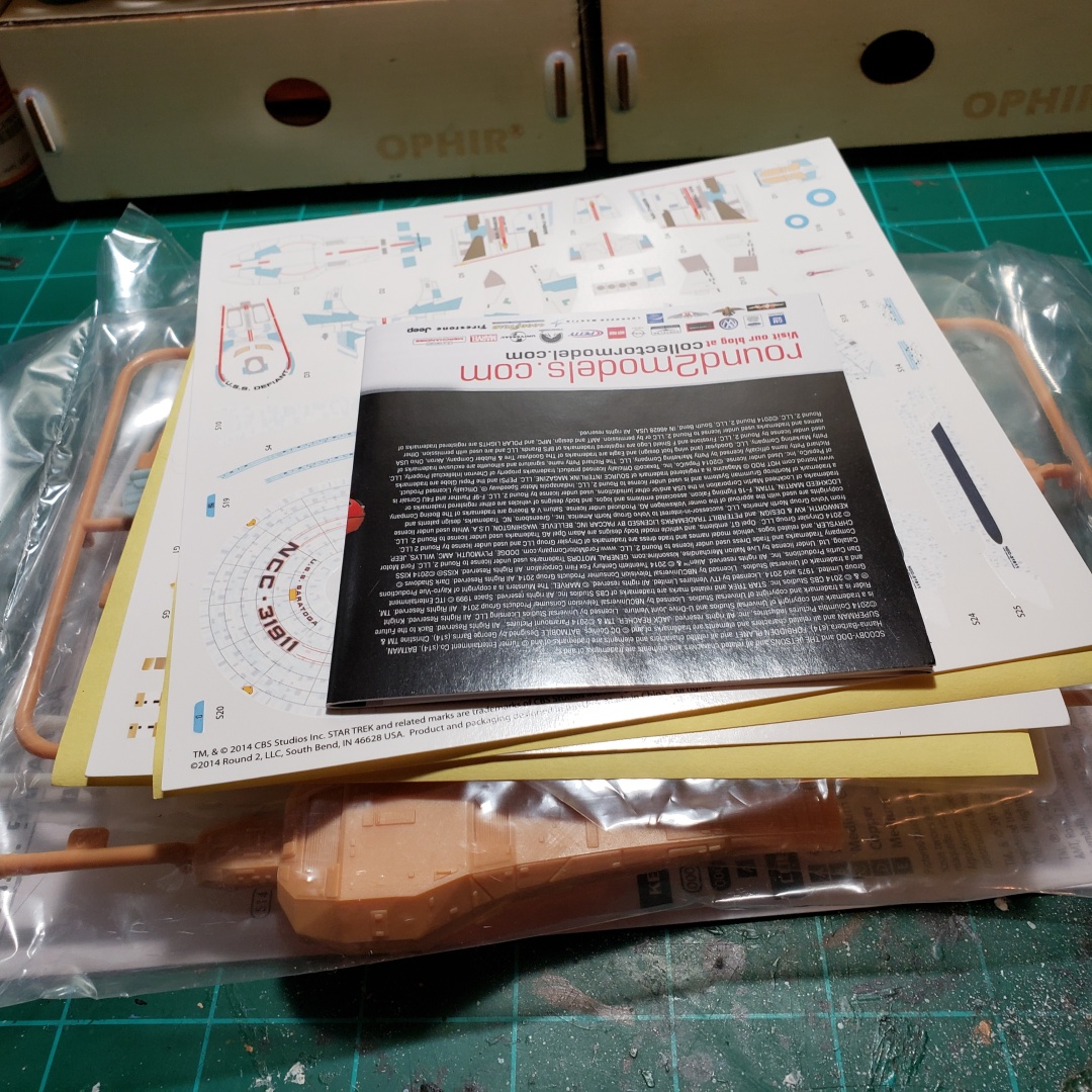

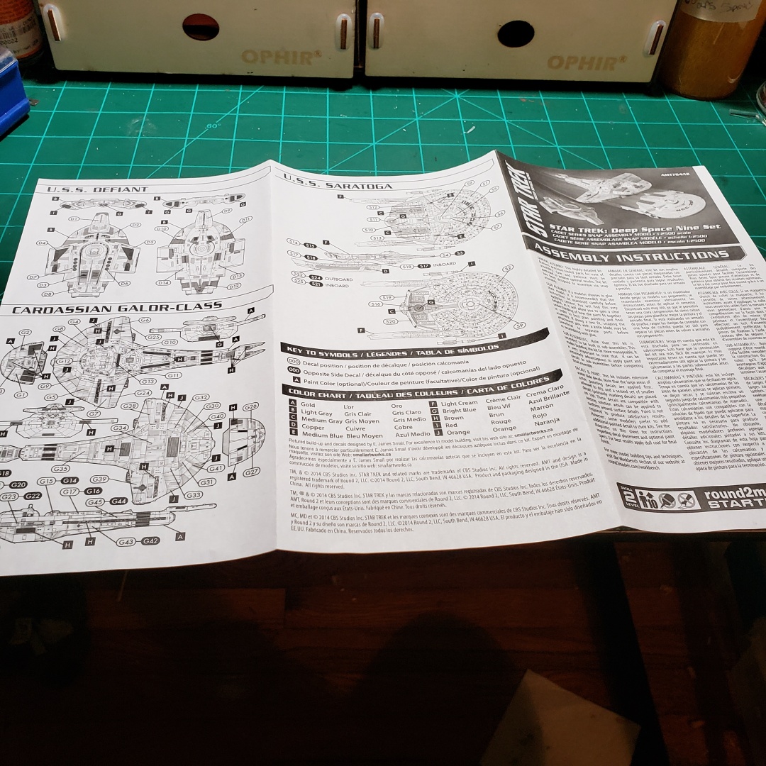

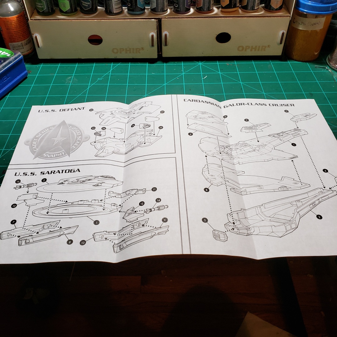

the decals,20200429_145834_resized.jpg and the instuction sheet, assembly20200429_145859_resized.jpg

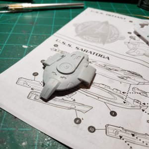

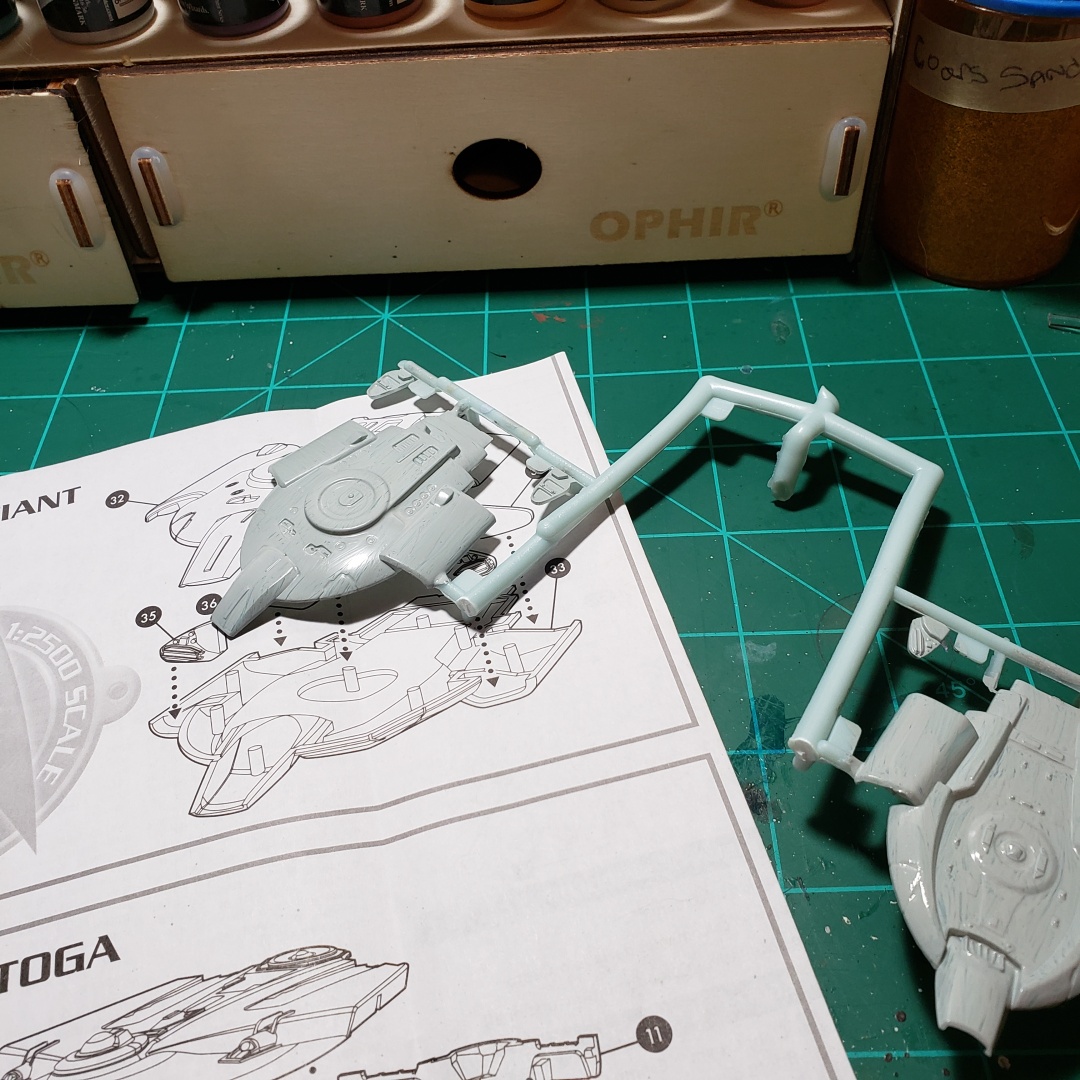

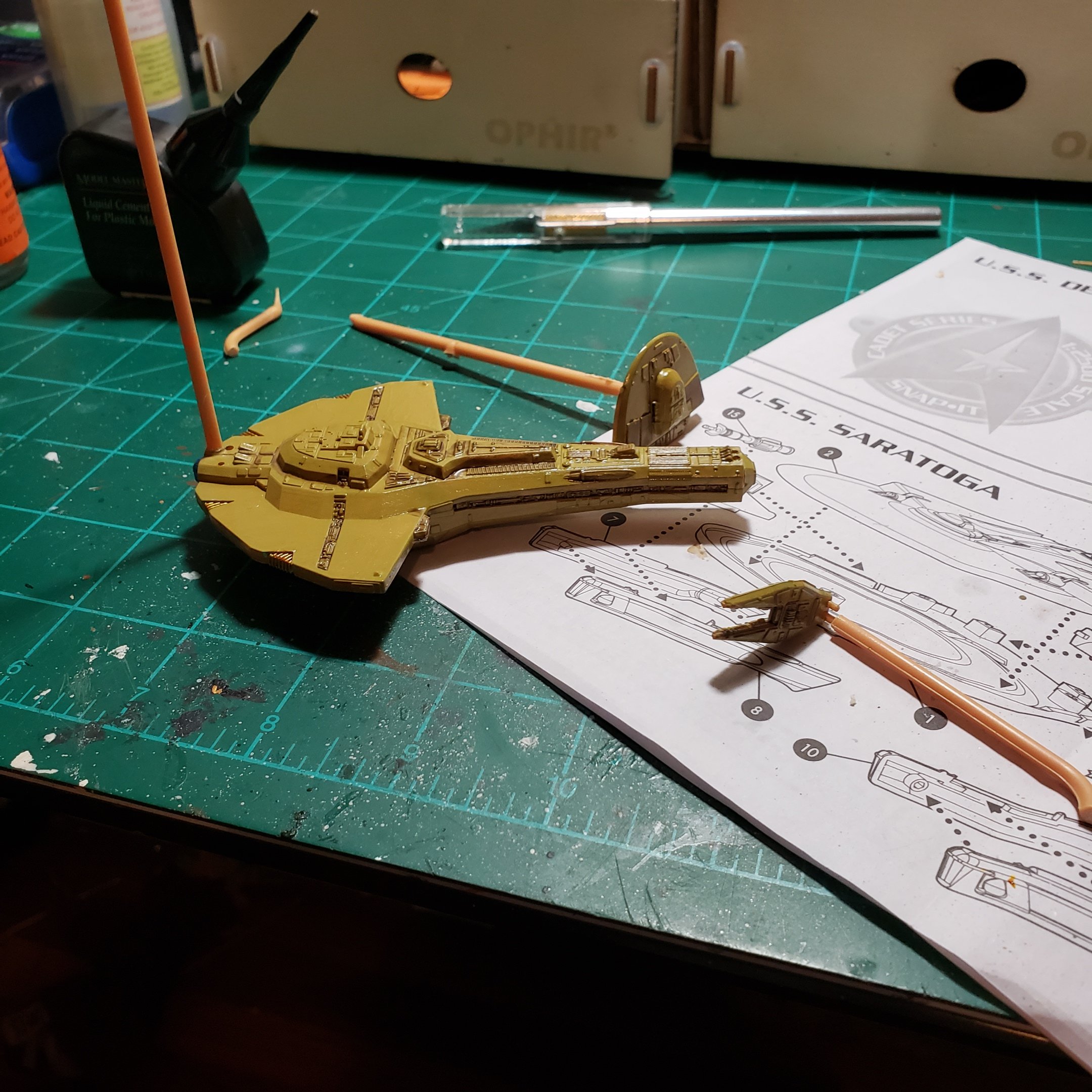

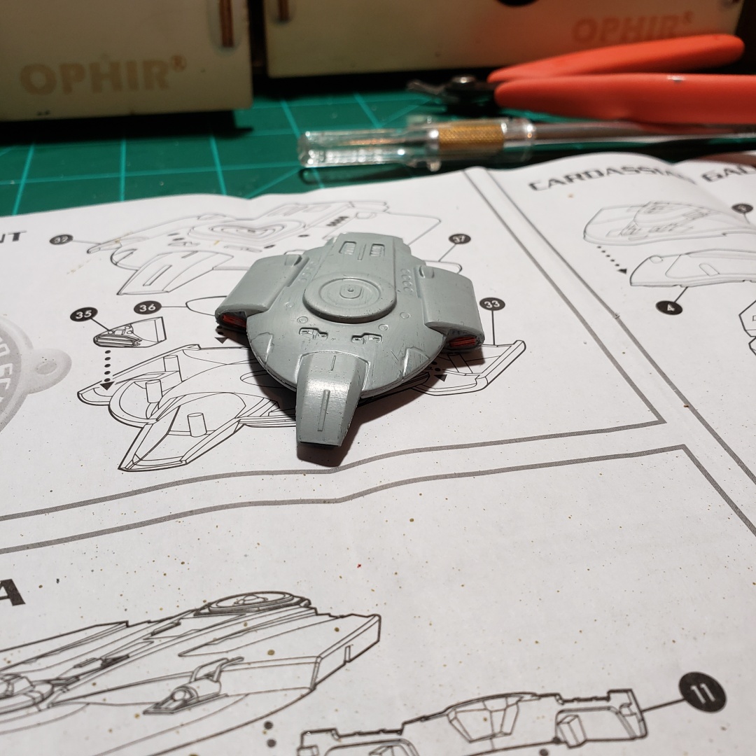

The little bitty Defiant is all of 6 pieces, 20200429_150236_resized.jpg and painted a pale blue grey, it's bad when the assembly drawings are larger than the kit parts.
Reactions: micahrogers

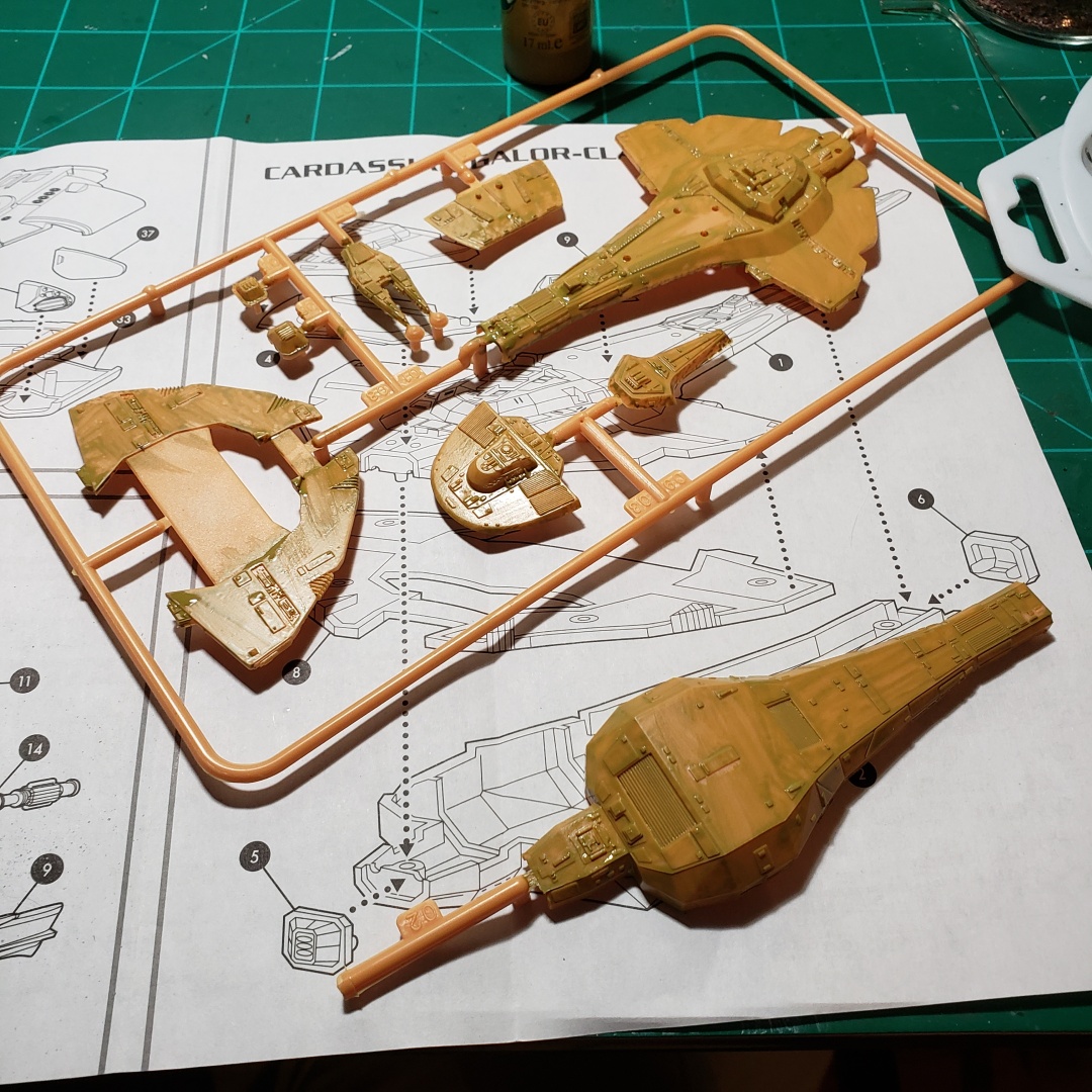

The kit comes with "Wallpaper" decals, the Saratoga top and bottom saucer are 1 decal. The Defiant has more, and the Galor has a page to itself.

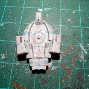

I got the top decaled, 9 separate pieces, the decals are thin and rip easily. I use a 2 step decal solvent, Micro Sol, and Micro Set, you apply Micro Sol to the place the decal is going, then once the decal starts to settle down, you apply Micro set over the decal to help soften it.
This picture is between applying the decals, and applying the Micro Set over them. The next pic will be after the Micro Set dries.

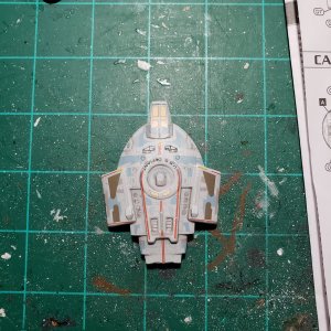

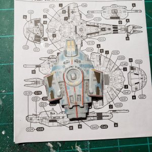

Notice the look of that place now after a days drying, all nice and tight. and the bottom decals applied, but you can still see the setting solution on the surface.
You can see how the decal is all lumpy and bubbled, all those will soften and conform down as the Micro Sol works on the decal.
