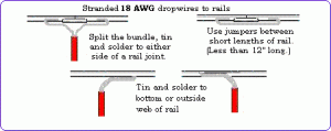

Try getting a small pair of needle nose pliers to the rail joiner and giving a little squeeze. This should crimp the rail-joiner and re-establish electrical contact with the rails.
I'd only bother to solder rail joints between sections of rail that are small. [Less than 1-foot long] Instead of soldering the rail joiner, I prefer to solder a small jumper wire between sections of rail.
The other reason to solder rail joiners is when you need to use multiple pieces of flex track to complete a curve. Putting together 2 pieces of flex track with a rail joiner and trying to curve it tends to result in kinks at the joiner.
