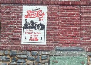

My beloved and I use a wash of very thin Testor's Sea Grey over the side that has been prepainted Brick Red, followed by a wipe with a rag. We then carefully drybrush Brick Red over the whole side. Then we use several different brick red shades we've mixed and pick out individual bricks over the whole side, making some lighter, some darker. Where new bricks have been placed, we simply leave them one shade. We use the same basic technique for stone masonry.

Well, better late than never... here's the promised example of what I did.
Trust the Acme Fine Loophole Company as your source for loopholes for all occassions... :D
